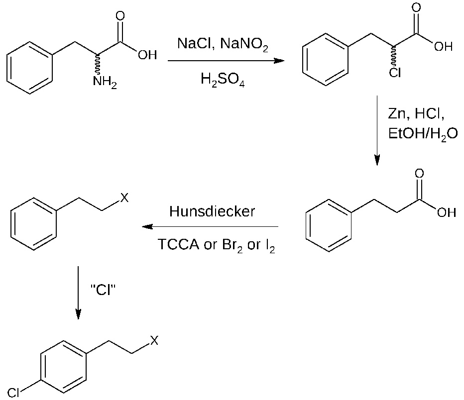

Two new drafts for the second part, the first for p-chlorophenylethyl halogenide the second for p-chlorophenylethylamine. I dont suggest any specific chlorination for now, nor do I comment it, at least for now. :D
part2.1.jpg - 61kB
part2.2.jpg - 58kB
EDIT:
After I had a closer look at the first suggestion, it's a bit overcomplicated, so I made another draft:
part2.3.jpg - 71kB
The first step is taken from the literature, where NaBr is used (90% yield for phenylalanine). I speculate NaBr may be substituted by NaCl which hopefully works too. For the chlorination the procedure posted by Assured Fish may work good here, a closer look at the original publication reveals for isobutylbenzene yields of 72% para, 2% ortho, and 1% disubstitution (75% conversion). Fairly good! The substitution performed by AgCN is described in the literature, but I have to find a good source first. The decarboxylation hopefully works freely as known for similar structures. The literature source for the last step is described in my previous post and can be found here.
[Edited on 16-5-2017 by Alice]

@Alice
Thanks for the correction, looks like a protecting group of succinimide/phthalamide is the best way to go about it then and it could still be accomplished in 2 pots.
A small note though Alice regarding your first suggestion, the hunsdieker reaction requires the carboxylic acid to be converted to a silver, lithium or thalium carboxylate first, I also am pretty sure it has trouble proceeding on saturated alkyl carboxylates, it would be better to decarboxylate and then diazatize the amine followed by reaction with the halide salt to get the desired alkyl halide.

Alice
Posts: 111
Registered: 11-5-2015
[*] posted on 17-5-2017 at 03:01
Quote: Originally posted by Assured Fish
@Alice
Found a comment from Nicodem on a very similar problem. He mentioned protonation of the amine may be sufficient. This may have implications on the type of chlorination reaction to be chosen. (Link).
It may work better for unsaturated acids but I don't think it's limited to such cases. Honestly I was just looking if it works for aliphatic acids but didn't read into details. See The Degradation Of Carboxylic Acid Salts By Means Of Halogen - The Hunsdiecker Reaction:
The greatest utility of the Hunsdiecker reaction lies in the preparation of aliphatic halides, and most of the investigations of the reaction have been in the aliphatic series.
Anyhow, I discarded the first route more or less, as like mentioned, it's a bit overcomplicated. About your second point, not sure if the reaction on primary amines works as excellent as the one I found. I remember there are some issues with alkene and alcohol formation.

CuReUS
Posts: 928
Registered: 9-9-2014
[*] posted on 17-5-2017 at 05:59
Quote: Originally posted by Alice
Selenium and especially tellurium are easy to aquire OTC as far as I see.
really ?:o
I also am pretty sure hunsdicker has trouble proceeding on saturated alkyl carboxylates
actually,the hunsdicker reaction gives excellent yields for saturated acyclic and alicyclic compounds.It gives shitty yields for aromatic COOH's

Posts: 2926
[*] posted on 9-6-2017 at 12:49
On the subject of heterocycles, I thought of a way to use 2-aminothiazole in order to avoid using other sulfur compounds. Unfortunately, I'm not sure how to synthesize 2-aminothiazole, although I don't think it's too hard. For the direct synthesis you can make a bromoacetaldehyde synthon via the reaction of a vinyl ether with Br2 IIRC.
Anyway, step 1 is a Mannich reaction, step 2 is just the addition of p-chlorophenethyl iodide to the nitrogen.
Step 3 is ozonolysis: my guess was that alkylating the nitrogen makes thiazole lose its aromaticity, meaning the alkene can be oxidized. The resulting dicarboxylic acid should eliminate to the thiourea.
capsazepinethiazolium.png - 18kB
