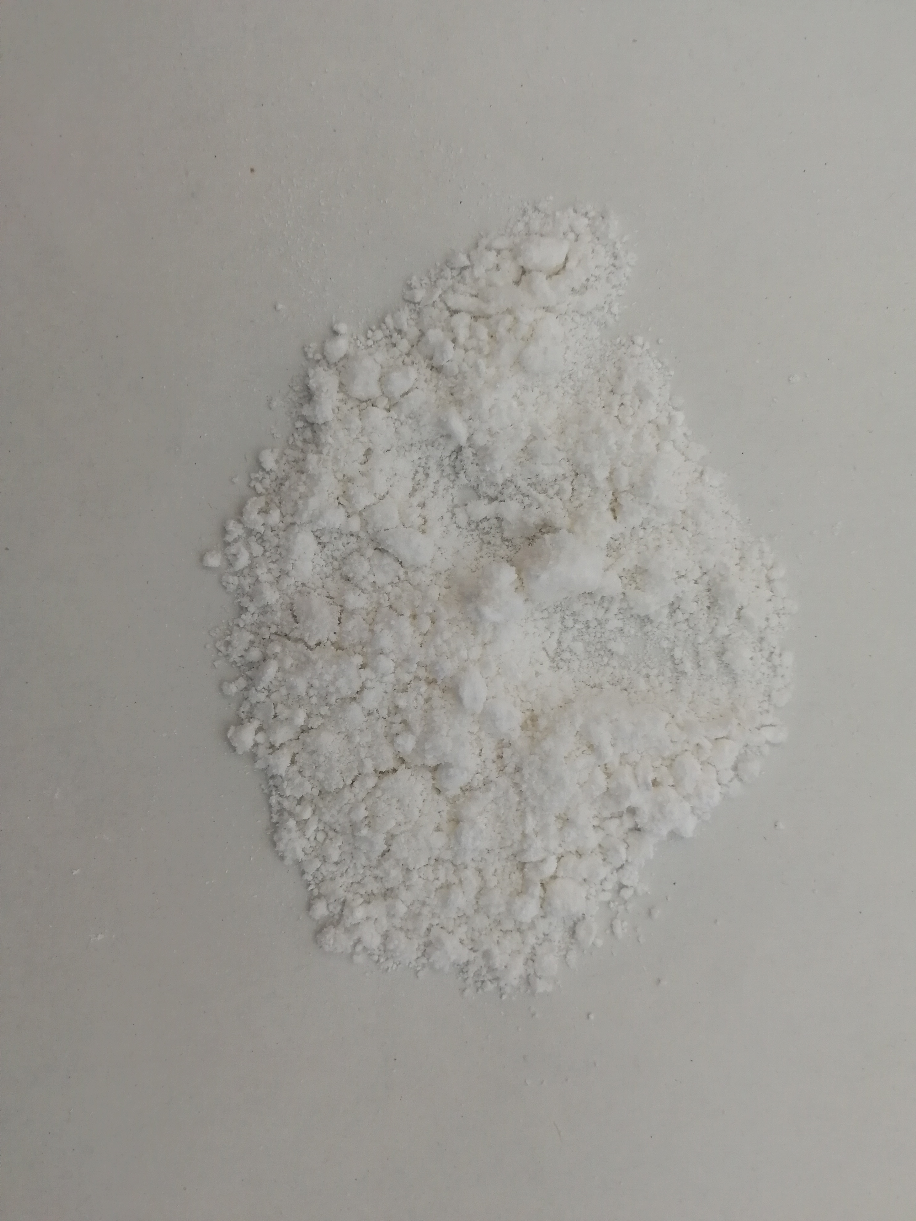

Im back doing chemistry after a long pause, let's hope it lasts. I need Sodium Sulfamate for an experiment and since Sulfamic acid is unavailable anywhere near me i decided to make it myself by this reaction:
2 NaHSO4*H2O + CO(NH2)2 ---> 2 Na(NH2)SO3 + 3 H2O + CO2
Materials:
23 g Sodium Hydrogen Sulfate Monohydrate (Pool pH-)
5 g Urea ("Gentle" road salt)
~100 ml Dihydrogen Monoxide (Home brewed from tap water)
~ 20 ml Acetone (Technical)
Procedure: The Sodium Hydrogen Sulfate Monohydrate was placed in a 100 ml beaker and melted on a hotplate. As soon as the material was completely molten Urea was slowly added with stirring and the mixture turned into a foaming paste. No odor of ammonia was present but a slight smell of sulfur dioxide. When all the Urea was added and thoroughly mixed in 60ml of distilled water and a nickel coated magnet was added as a stir bar to dissolve the crude product. The solution was then boiled down to ~40ml and allowed to cool in a fridge.
The now precipitated product was vacuum filtered as a slush and washed twice with distilled water and twice with acetone and allowed to dry on a piece of paper.
Result:
Because i do not know any good way to test Sodium Sulfamate i tried burning it in a test tube: The result was a Ammonia - Sulfur Dioxide smell and water vapor. No discoloration was observed of the solid. This is the best i have as characterization.
Really though i doubt the product is very pure, but i can think simple way to improve purity. Guanidine sulfate is a likely byproduct formed from excess Urea and Sodium Sulfamate which could be removed simply by washing the product in alkali. Guanidine is also why i added the Urea to the Sodium Bisulfate in small portions so no local spots of high Urea content are created. The hard part is removing Sodium Sulfates which have fairly similar solubilities, how could i do that?
Here is a picture of the product.
IMG_20180317_103337.jpg - 2.1MB

[*] posted on 17-3-2018 at 06:39
I'm still not convinced that what you have is sulfamic acid. I would think that ammonium sulfate would be the likely product of your reaction, since you used sodium bisulfate monohydrate:
2 (NaHSO4*H2O) + CO(NH2)2 = Na2SO4 + (NH4)2SO4 + CO2 + H2O
Could you attempt converting it to sulfamic acid, and checking the melting point (which should be 205 °C)?
You could also test solubility, see: https://pubs.acs.org/doi/abs/10.1021/ja01199a503
[Edited on 3-17-2018 by Metacelsus]

[*] posted on 17-3-2018 at 10:24
Im not convinced it is Sodium Sulfamate or Sulfamic acid either but i am leaning on Sulfamic acid now because when i tried washing it with Sodium Hydroxide it pretty much instantly dissolved and the solution was acidic when i was boiling it down.
I doubt it is Ammonium Sulfate because it is so soluble i would never be able to precipitate it the way i did. However i did smell ammonia when i added the Sodium Hydroxide but not much needs to hydrolyse for a strong smell to be produced.
Anyway ill redo it soon but i am out of vacuum filter papers for the cold filtrations.
And no it is probably not soluble in Ethanol.
Sulfamic acid 12.8 wt% in water at 0 deg C; 17.57 wt% in water at 20 deg C; 22.77 wt% in water at 40 deg C; 0.1667 wt% in formamide at 25 deg C; 0.0412 wt% in methanol at 25 deg C; 0.0167 wt% in ethanol (2% benzene) at 25 deg C; 0.0040 wt% in acetone at 25 deg C; 0.0001 wt% in ether at 25 deg C Kirk-Othmer Encyclopedia of Chemical Technology. 3rd ed., Volumes 1-26. New York, NY: John Wiley and Sons, 1978-1984., p. V21 950
From the thread: https://www.sciencemadness.org/whisper/viewthread.php?tid=25...
I doubt the sodium salt is more soluble seeing as it is an ionic compound.

[*] posted on 19-3-2018 at 06:56
I think you need to characterize your product better.
Quick ways of differentiating between sulfamate vs. sulfate or bisulfate:
Barium sulfamate is relatively soluble in water, so aqueous BaCl2 is a good spot check for sulfate contamination. CaCl2 should work too.
Silver sulfamate is also soluble, whereas silver sulphate is only slighty solube.
