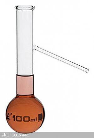

Retort vs distiling flask (vertical neck w/y downward angled side arm) - differences?
So I am wondering if there is much difference between these two items. I was thinking of making an adapter that can fit onto a flask with 1-3 necks and then a vertical shaft that has a narrow downward arm coming off of it, like in the picture of the distilling flask, except that it would be 2 pieces.
retort.jpg - 7kBdistiling flask.jpeg - 9kB

There are still heads/thermometer adapters that do the same thing, with three joints (one for a condenser or bubbler tube), but I haven’t come across one with just a narrow tube. But anyways, there isn’t really much different, the one on the right is just the modern version of a retort IMO.

The item on the left is a reaction flask and integral air condenser. Typically in the old days used for distilling high temperature boiling or corrosive liquids such as sulphuric acid, nitric acid and mercury because it’s all glass.
The item on the right is a reaction flask with integral take off side arm. Typically in the old days a bung with a thermometer would be inserted in to the top to monitor the temperature of the distillate or the contents of the flask depending on the position of the thermometer bulb. The side arm would be attached to a condenser with an other bung.
I am gobsmacked you have not seen pics similar to the ones below in old books.

I used to own a decent sized side armed distilling flask. Perhaps a 2000-3000 ml unit.
In days of yore, such items were dirt cheap. Not so nowadays. You can still buy 'em, but they are spendy. To my recollection, within the last year or so, one of our members obtained one constructed of Quartz..... For the purpose of distilling Sulfuric Acid, etc..
On occasion, I heated mine with a Bunson Burner, and thereby steam-distilled benzene/water out of a reaction mix.
I don't know that I would have attempted that, with regular jointed glassware.
Probably not.
Well sealed, it seemed pretty safe for distilling flammable solvents. Though of course, not ether.

For bumpy distillations or high temp ones at reduced pressure where the impurities are of close BP to your target product you can put a fractional column in there too. That way if it does bump then it goes up and down the column and not over to your pure product. You can get more control of it with a column in there too imo.

Nah these aee not inferior their just specialized. If you want to torture glassware say for distillation of sulfuric acid you cant beat an air cooled retort that is one piece of glass.. Nothing esle stands up well to high temp distillation because you get seized joints and shit
For h2so4 distillation i would like a pear shaped retort i can do direct flame heating on for the first run. I got super paranoid about glassware cracking when i did it, i used a hempel column as a condesner and a j joint but everything seized up with vacuum grease and i was banging on it with a rubber hammer and a gas torch to seperate it.
I think i put a fan to cool my air condesner but with a boiling point of 337c you probobly want to use a air heater to cool it to maintain some kind of reasonable gradient of temperature. I was paranoid about glass cracking. It should be vacuum distilled but purifying a gallon of drain cleaner is industrial chemistry imo at least for the first pass. I like using a blowtorch with the air holes mostly clogged to make a gentle flame that waves around the glass

I think you could do short path distillation at temperatures below the boiling point of the mixture with a retort. Distillation flasks have more options than retorts, but generally speaking, you probably don't want to buy either for chemistry use unless you can get an exceptionally good deal or have a specific application. (For example, I have a standard taper quartz distillation flask for distilling sulfuric acid.)

I use both retorts and distillation flasks. The former I use mostly for nitric acid, and also as the first stage condenser for sulfuric acid (injecting hot, not precooled H2SO4 vapor into a water-cooled condenser = bye bye condenser).
