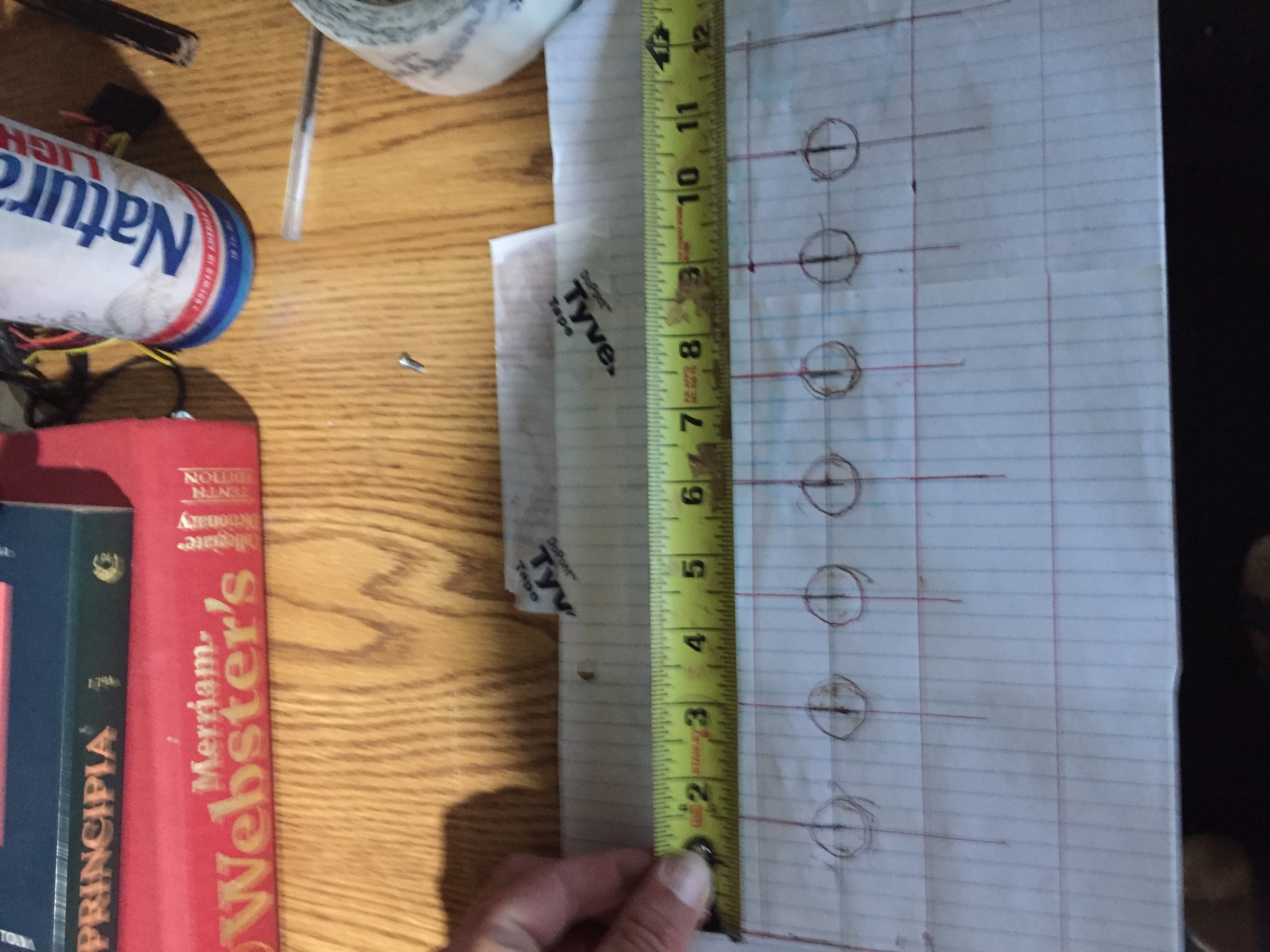

[*] posted on 20-7-2018 at 14:51
9C36E0E1-463F-40D9-B6F4-8B0253920ABA.jpeg - 1.3MB
Here’s a layout for ya. Didn’t have a board to do it with. The holes are roughly 5/8”. I had to use a socket extension. It was as close as I could get to 16mm, which I now is the diameter of a lot of test tubes. As you can see, the holes are 1.5” from center to center. It seems like it would be a big rack after I laid
it out though.
I don’t know why my pictures come out sideways
[Edited on 20-7-2018 by ELRIC]
