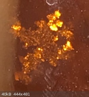

Tetrahydrofuran Peroxide in a Glass Bottle
Sorry but this is the best pic I could get of some of the crystals that remain in this bottle that once contained THF and has now completely evaporated to dryness. There are a few more tiny crystals in the bottom and, with my luck, some all up in the cap threads.
Assuming there was 250 mL of THF in here and, say, 100 mg of THF peroxides remaining, how dangerous would you say this is? Could I safely open this behind a board with tongs or some other tool? SHOULD I just for the sake of curiosity? Is it so dangerous it’s not worth it? If so, should I shoot it with a gun from far away to dispose of it? Should I even put this in a car to transport it to said shooting location? Or should I just bury it? I’m leaning towards the latter.

I doubt that you made THF. How do you know it is what it is? Have you tested?
According to this "THF peroxides have not yet been detected by experiment".
Also why risk? If it is unknown or first time you are dealing with this, consider it dangerous. Test for explosiveness.
He said that the bottle once contained THF, which has since evaporated to dryness [assuming by leakage]. I assume that's how he has a guess of what it could be.
Was it clean THF? Maybe not so volatile some thing that was dissolved in it? Could it be some something like BHT?

It was reagent grade or better THF “stabilized with BHT”. I guess it could be that.

Screw it. It’s probably BHT but it’s a glass bottle vs my fingers or at the very least my pride. I’ve decided it shall be shot with buckshot. I may upload the video somewhere.

THF hydroperoxide formation is like ether hydroperoxides in terms of safety. They tend to be safe until they are concentrated. The previous posts showed cases where the peroxide was dissolved in thf, not pure peroxides. I. Therefore, it is safe when dilute, but dangerous when concentrated. If its not BHT then you might lose your hand.
