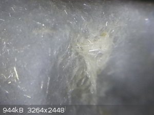

Hello,
I wanted to report my results so far of decarboxylation in mineral oil and ask some advice on workup. I like detail, so sorry:
rxn:
10 g of tryptophan powder was added to 105 mL of light (fischer) mineral oil and 5 mL (R) carvone in a 250 mL round bottom flask with a metal stir bar and heated with a fiberglass insulated mantle. A claisen adapter was fitted to the flask and a thermometer placed in the center of the oil. In the other neck a nitrogen line was added and the flask flushed before heating; this was haphazardly done and some oxygen probably got through.
As the temperature increased to 90c the oil was a frothy cream color. At 135 condensation of some sort was seen on the upper layer of the flask (not hot enough to burn). At 170 the flask got slightly darker. At 200, it was noted that the tryptophan was still present, and the mixture was still foaming. It took ~30 minutes to get to this point, and the temperature was held for another 30 minutes, never rising above 205. During this time, the tryptophan disappeared and the mixture got darker. The heat was stopped after the tryptophan was consumed and the flask turned a deep red. After cooling, the flask turned back to a cream color.
a/b extraction:
After cooling in the fridge, a dark oil settled at the bottom of the flask. the mineral oil above it was tossed and dark oil mixed with a final volume of 100 mL of 5% boiling acetic acid and filtered into sep funnel. The aqueous layer was like orange juice, and the black goop was extracted in batches until further addition of acetic acid resulted in a clear aqueous layer.
5 mL chloroform was added and shaked resulting in a clear organic layer with black goop at the boundary between it and the aqueous layer. Organic layer was tossed and repeated with 2 ml chloroform.
5 mL more chloroform added to aq layer and sodium bicarbonate added until pH was 8 and fizzing was mild. **Only a little bit of stuff crashed out at this point.** When removed via sep funnel, the chloroform was black. Further washing with chloroform was less black.
2.5g of naoh was dissolved in 10 mL DI water and added resulting in a final ph of 12. The solution turned milky white and and brown stuff came out of solution. This is probably the goop that was supposed to come out with the bicarbonate.
after:
After chilling in the fridge for a few days, many white fog-like crystals formed above the brown gunk, and was filtered via buchner by simple pouring (gunk stuck to bottom as cake, soluble in acetone) and washed with cold naoh. These crystals looked white-tan until being squished with filter paper to aid dryness by me, where they became a yucky tan-brown.
MP was done on some nice looking white crystals (closeup picture attached). Some melting at 103c, a little bit of melting 103-120, and then some brown goop stayed solid.
So I now have some gross looking mash that is drying, and a bunch of pieces of filter paper that may have absorbed tryptamine via crystals or oil and I do not wish to throw away. Where to proceed from here? I have many solvents available, so I was thinking re crystallization, but I also wanted to try sublimation since it is a fun technique.
-ChemGirl

Hi chemgirl. Nice first post, and welcome to Sciencemadness.
It looks like you managed to get some impure tryptamine. Did you gey any weights of the product?
If your final wash of the crude tryptamine was with sodium hydroxide solution, the product is going to be contaminated with sodium hydroxide and/or sodium bicarbonate. This is why the final wash is done with ammonia usually. If ammonia is not available, maybe a small amount of ice-cold water would work.
I always found recrystallization of tryptamine difficult. Feel free to try and report back. Heptane is supposed to work well. If you have access to a good vacuum pump that pulls a stronger vacuum than an aspirator, I would recommend vacuum distillation through a short path. It's fairly simple and makes for a reliably pure, crystalline product.
[Edited on 23-1-2017 by Crowfjord]
chemgirl
Posts: 4
Registered: 22-1-2017
[*] posted on 24-1-2017 at 17:05
thanks for your kind words, Crowfjord. The yield in the weigh boat is pretty abysmal, 0.55g. I am salting out the remaining aq solution and am getting some product back from all the filter paper, but the overall yield will probably be less than a gram. There certainly was plenty of junk produced in the reaction, and if I were to repeat this I would try harder to get an inert atmosphere.
I will let you know my final yield and what I do for further cleanup.

0.55g from 10g tryptophan is pretty abysmal. I've done this a few times in the past, normally I get a 50%+ yield, generally higher. I've also tried flushing the system with argon (rather haphazardly, was not totally inert) and putting an air lock on it (a step I see you omitted). With the airlock/inert atmosphere it nearly eliminated the red oil and I even had crystals forming (within the oil mind you) in the flask after the reaction cooled. I have unsuccessfully tried to short path distill it resulting in decomposition.
I have recrystallized it from heptane, which is difficult as it only dissolved at a rate of ~1g/100ml and it's difficult to even do that, but it did result in rather pure crystals. The MP was slightly depressed and still had a slight smell of carvone so it wasn't pure, but another recrystallization or two should get you to 113C or w/e the proper melting point is, but then 2-3 crystallization is so much work I never bothered.
Yes.
I was relying on the stream of nitrogen greatly displacing the oxygen; I see now this was not a good idea. By airlock, do you just mean keep the setup sealed? Can you elaborate?

An airlock is usually a bubbler with mineral oil employed as the liquid, which allows gas to escape the system without letting air back in through small fluctuations in pressure. They can be in the shape of a sideways S, among other designs. Airlocks are also used by brewers to allow carbon dioxide to escape the fermenter without allowing air in.
I don't think oxidation would have caused such a low yield. I'm wondering if the large proportion of carvone employed (about 50 mole percent) had anything to do with it. Some irreversible amine alkylation products may have formed, or some peptide polymer products, due to ineffective stirring. I have wondered for a while why enone are supposed to be better alpha amino acid decarboxylation catalysts than ketones. Maybe 1,4-addition becomes more of a problem with high catalyst loading. I would suggest trying again with a much smaller amount of carvone, somewhere around 0.25 to 0.5 mL, while making sure to stir the mixture well throughout the reaction.
