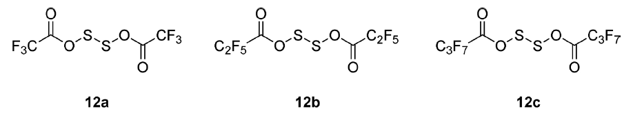

Posts: 721
Registered: 16-3-2015
Mood: dooM
[*] posted on 22-4-2015 at 03:24
You don't need the S2Br2, you need a SBr2 if you want to make anhydride.
What would drive the reaction towards yielding Ac-O-S(=S)-O-Ac ?
I've found some answers in the article "Dialkoxy disulfides and their branch-bonded thionosulfite isomers"
DOI: 10.1080/1741599342000202176
"12a–12c synthesized by Wang [46] in excellent yield (>90%) are included for completeness (ROAg + S2Cl2, under vacuum). These compounds are thermally unstable and decompose readily to form the anhydride, SO2 and sulfur [47].
Carboxydisulfides.png - 20kB
[46] Wang, C. S., Pullen, K. E. and Shreeve, J. N. M., 1970, Inorg. Chem., 9, 90.
[47] Denham,W. S. and Woodhouse, H., 1913, J. Chem. Soc., 1861."
They say the -O-S-S-O- isomer is the most stable one.
And here's a pic from that doc, though it describes slightly different compounds.
Disulfides rearrangement.png - 59kB
I was unable to find the 46 reference ( Wang, C. S., Pullen, K. E. and Shreeve, J. N. M., 1970, Inorg. Chem., 9, 90 ), but the 47 is available - https://www.thevespiary.org/rhodium/Rhodium/Vespiary/talk/fi...
And also this, written by one of the authors of the previous article https://www.thevespiary.org/rhodium/Rhodium/Vespiary/talk/fi...
Although those are way too old.
