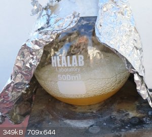

Once the brown fumes (mild) were produced, checked the flask (it was covered with aluminium foil) and there was again foam. pic 4.
When /I thing) that concentrated nitric acid was finally destilling, there was a lot of foaming. it did not reached the top, but 75% of the flask was
with foam (pic 5)

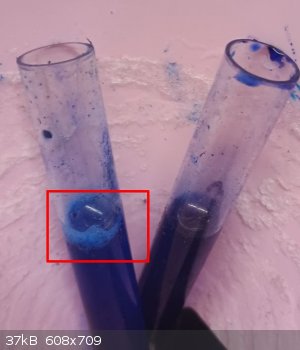

1) cristallized some KNO3 (dissolving a random amount , filtering trough cotton, and once some cristals were made, removed (the orange... solution)
and dried the cristals
On testing both (putting in a test tube and shaking), original KNO3 vs filtered KNO3, no much difference was seen,
but then read: that adding methylene blue and using PP test tube, there is a qualitative test (paper attached) for surfactants.
So I took tip of the spatuta of powder methylen blue, added to each PP test tube, shook them and compare. A distintive difference, even after 10
seconds was seen. (Pic)
So the problem was not the bisulfate but the KNO3 (which wasn't like Woelen's prils, but like sugar consistency)
So will try again with the "cleaned" KNO3 if better results.
