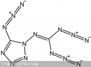

Synthesis of 1-Diazidocarbamoyl-5-azidotetrazole (C2N14)
So, for quite a while now I‘ve been wanting to try making some 1-diazidocarbamoyl-5-azidotetrazole, commonly referred to as “azidoazide azide“, as it’s one of the more chemically interesting energetics in my opinion, and it has quite a reputation of being the most sensitive one out there. While the second claim has pretty much been disproven by YouTubers like ReactiveChem and Explosions&Fire [1][2], for being completely heavy-metal free I still consider it to be quite an impressive substance, and kinda wanted to see for myself.
IMG_8487.jpeg - 174kB
Fig.1: Chemical structure of C2N14

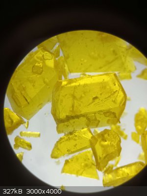

20230530_162940.jpeg - 566kB 20230530_163056.jpeg - 327kB
Fig.5-6: The product under the microscope

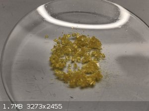

20250201_202715.jpeg - 211kB
Fig.10: the collected crystalline isocyanogen tetrabromide

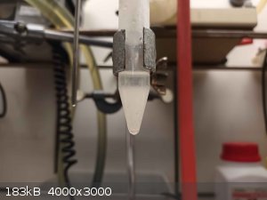

20250202_131332.jpeg - 166kB 20250202_172816.jpeg - 183kB
Fig.12-13: The reaction mixture before and after the addition of the water

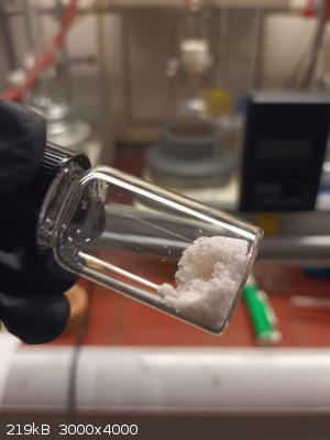

20250129_172542.jpeg - 219kB
Fig.17: The collected slightly pinkish crystals of triaminoguanidine hydrochloride

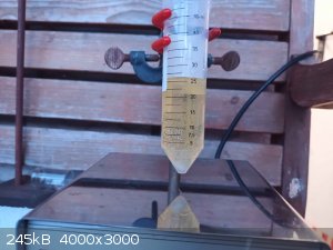

20250131_164400.jpeg - 274kB 20250131_172543.jpeg - 245kB
Fig.20-21: The mixture before and after the addition of the base
