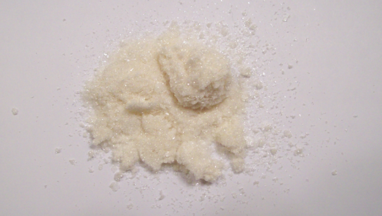

Recently made tris(hydrazine)zinc nitrate (ZHN). It is a very shiny, glittering compound (every crystal glitters) with a beige tint. I made it by mixing Zn(NO3)2 aqueous from zinc and nitric acid, with conc. aq. NH3 which was added until the Zn(OH)2 precipitate redissolved and the liquid took on a light yellow color to form a clear solution, then added about the same volume of 55% N2H5OH and boiled it on low boil until crystals started appearing where the boiling was stopped. Then let it crystallize, washed it several times with alcohol. The compound is also mentioned in Gmelin.
It is an insensitive initiator, it hasn't exploded in any heating tests done on small amounts, like over a flame, in flame directly, etc. It doesn't even flash like tris(hydrazine)nickel nitrate (NHN) does. But it does burn very fiercely, very nicely actually even though it leaves behind a lot of white ZnO. It burns splendid with an interesting bluish-white-orange flame. Sprinkling it onto aluminum foil and wrapping this up into a fuse caused it to burn completely to the end when one end was lit. It does have some energetic properties, but needs to basically be blasted itself.

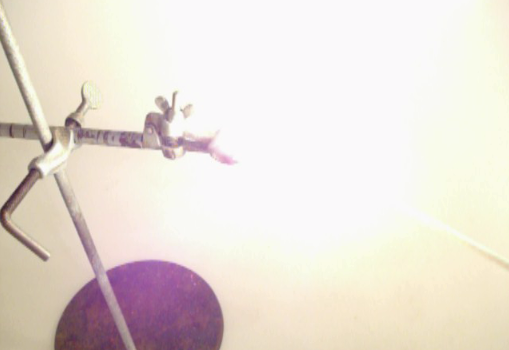

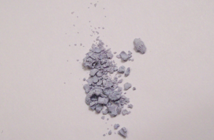

Here are a few deflagrations of the aforementioned hydrazine compounds:
Tris(hydrazine)nickel nitrate (NHN):
nhnpic.png - 495kB
Deflagration to heat and flame:

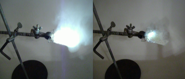

Tris(hydrazine)zinc nitrate (ZHN):
zhnpic.png - 600kB
zhndef.png - 358kB
The same aforementioned fuse of ZHN is also in one of the videos above. It burned to the end. I'm not sure how reliable it is yet though. And around 30mg of the ZHN intermixed with about 30mg Ag2C2.AgNO3 into a small pile on an iron plate gave a very loud report on contact with a long wooden match flame (originally Philou's idea to mix the nickel salt with acetylide complex).

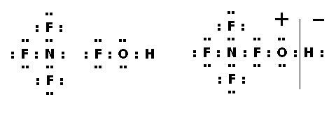

Random Idea
Hypofluorous Acid (HOF) CAS 14034-79-8
Formed much the same as the Chlorination of water H2O + Cl2 => HOCl + HCl
except it only forms on ice and is only barely stable at cryogenic temperature.
If mixed with Nitrogen Trifluoride may perhaps reform as
TetraFluoroAmmoniumoxyhydride (NF4OH)
The Lewis structure is perfectly satisfied manifesting a TetrafluoroAmmoniumoxy
cation and hydride anion.
