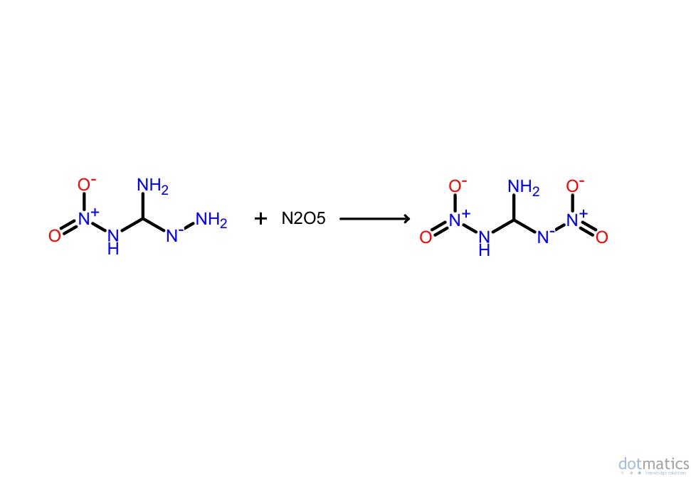

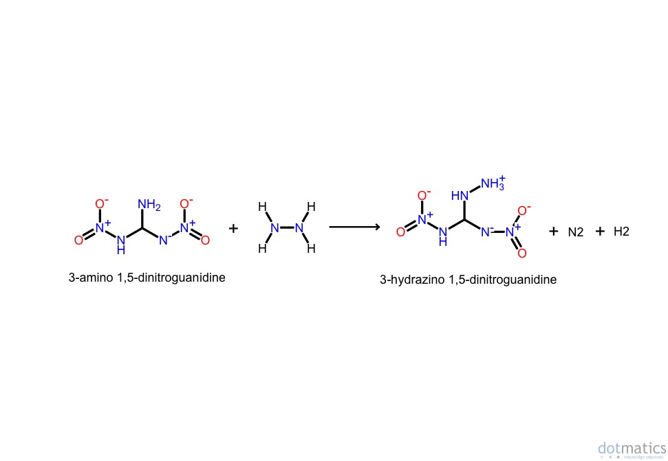

These should make it clearer. If the following compounds do exist, they'd be spectacular explosives.
image.jpg - 30kB image.jpg - 37kB
I believe that I screwed up the NH3: it's meant to be NH2, meaning that it takes NH from the hydrazine, yielding gaseous ammonia.
[Edited on 22-5-2016 by glymes]

N2H4 will react as a base with the two acidic -NH-NO2 groups and will more likely not make the compound you want.
Hydrazine DiNitroGuanidate or Dihydrazine dinitroguanidate are for sure interesting to investigate.
PH Z (PHILOU Zrealone)

Quote: Originally posted by glymes
NO2-N-(C-NH2)-NH-NH2 can form salts. The azide (NO2-N-(C-NH2)-NH-NH2-N3
2. I also believe that NO2-N-(C-NH2)-NH-NH2 can be nitrated with dinitrogen pentoxide in chloroform, as suggested in Klapotke's paper:
NO2-N-(C-NH2)-NH-NH2 + N2O5 --> NO2-N-(C-NH2)-NH-NO2 + H2O + NO2 + N.
This would also be able to form salts, such as 3-amino 1,5-dinitroguanidium azide.
3. I also believe that NO2-N-(C-NH2)-NH-NO2 can be hydrazinolysed in the same way as (1) where the NH2 group is hydrazinolysed to NH-NH2 and free ammonia gas.
NO2-N-(C-NH2)-NH-NO2 + N2H4 --> NO2-N-(C-NH-NH2)-NH-NO2 + NH3.
This could again form salts, such as 3-hydrazino 1,5-dinitroguanidium azide.
4. I also believe that NO2-N-(C-NH-NH2)-NH-NO2 may be able to be nitrated with N2O5 in chloroform in the same way as (2) in the following:
NO2-N-(C-NH-NH2)-NH-NO2 + N2O5 > NO2-N-(C-NH-NO2)-NH-NO2 + H2O + NO2+ N
This may also form salts such as 1,3,5-trinitroguanidium azide, which would be extremely explosive due to its high nitrogen content and high oxygen balance.
5. If diaminonitroguanidine is synthesised and it can be protonated twice, it may form salts such as diaminonitroguanidium diazide, NO2-N-C-(NH-NH2)-NH-NH2 2N3, or CH6N12O2. This would be extremely powerful also.

I also theoreticise that nitration cannot go on for ever: it may not be possible to force a second nitro- group onto 1-hydrazino 3-carbonyl 5-nitrourea, even with nitronium tetrafluoroborate.
All wrong again
1°)ANQ can only form salts with very strong acids. HN3 is way to weak .
2°)Why nitrate ANQ (made from NQ) to get DNQ what can be made directly from NQ (and that is what is written in Klapote's paper...but yes of course you can't read)
A dinitro(amino)guanidine would be even more acidic than ANQ and so formation of an azide is even more elusive.
3°)DNQ won't hydrazinolyse, it will form a (di)hydrazinium salt.
Here also no HN3 salt possible!
4°) Trinitroguanidine TNQ is only theorical at this date, it will be super acidic vs DNQ and so forming a HN3 salt of it...you know the song now...
5°) If you have chance DANQ or DANG (diaminonitroguanidine) and that it is basic enough then maybe one HN3 will fix on it, certainly not 2.
Here also you forgot 2 protons NO2-N=C-(NH-NH3N3)-NH-NH3N3
