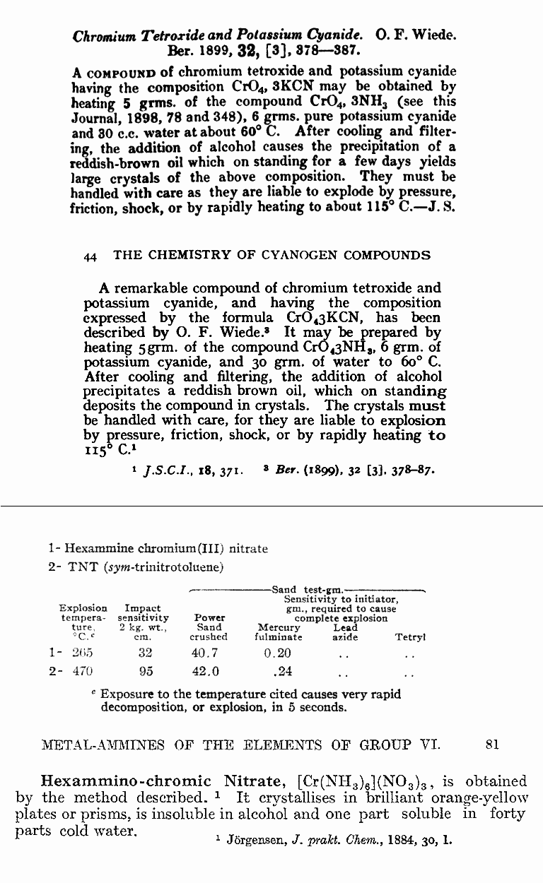

For some time I had the notion that a complex with Cyanide can serve
better as fuel than Ammonia based types , but being an anion itself hinders
the prospect of binding with oxidative anions such as Nitrate. I have become
aware of a long forgotten ( it would seem ) compound of this type. The
oxidizer functional group is Chromium IV oxide , CrO4 , which remarkably
forms a double salt with Potassium Cyanide. The temperature of explosion
is a bit low , and may prove to be too sensitive for general application , but
serves to show that compounds of this type can serve as the first charge
in a compound detonator set off by flame or electric element.
It is described in the following first two citations here _
Chromium Teroxide + KCN Hexanmino- chromic Nitrate .gif - 79kB
The third citation above is an excerpt from Explosive Properties of Metal Ammines
www.sciencemadness.org/talk/viewthread.php?tid=1778&page...
featuring the commendable properties of another Chromium based complex
Hexamino Chromic Nitrate which is as powerful as TNT with a sensitiveness
to impact like that of RDX , making it very suitable for use as the base of
a compound detonator with the above compound if that proves capable.

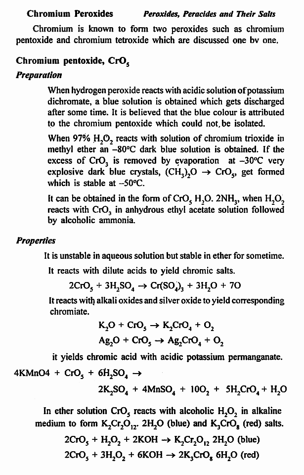

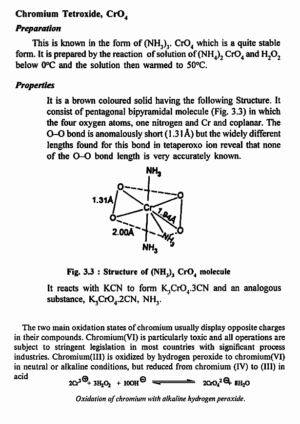

The following are excerpted from here _ Inorganic Reaction Mechanisms
http://books.google.com/books?id=jGvRKef2pZIC&pg=PA145&lpg=PA145
CrO5.gif - 50kB CrO4.gif - 38kB

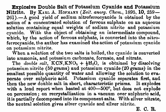

The immediate problem that arises is the disparate solubilities of prospective
salts , making it likely that the cyanide typically less soluble than the nitrate
will precipitate separately from solution. Despite these issues there is in fact
one known double salt of this type , KCN • KNO2 , as described here _
KCN.KNO2 salt.gif - 28kB
The presence of retained water tends to inhibit explosive propensity and in
this case is difficult to remove by ordinary drying procedures. Anhydrous
solvation may provide a better product. The solubility of KCN and NaNO2
are within a 10 percent of each other at room temperature.
