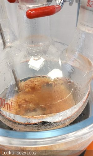

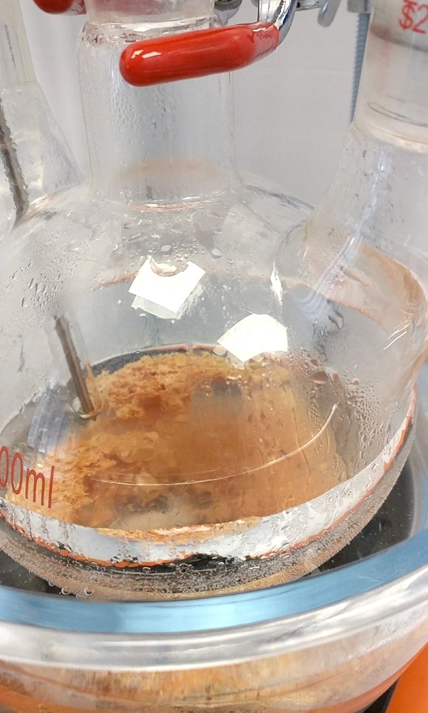

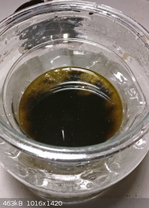

I prepared and recrystallized the double displacement reaction produce.
The initial concentrate from the metathesis was just plain chunky black syrup. It was first suctioned dry from any residual water, and then dissolved in hot water and was left for crystallize and finally put into ice.
pb-rec1-2.jpg - 463kB
First recrystallization did bring out the yellow-brownish crystals. I did not actually take a picture from the mother liquor.

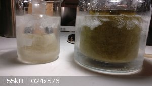

P.S. Piranha solution cleaned the clogged brown-gunk-impinged frit filter to a perfect condition.
pb-rec1-1.jpg - 155kB

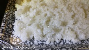

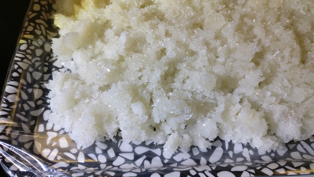

After second recrystallization it was already much more pure.
The third recrystallization was enough to finalize the process, and shiny, white crystals were a result. No pics from third rec as well, because I accidentally deleted the pics.
pb-rec-final.jpg - 247kB

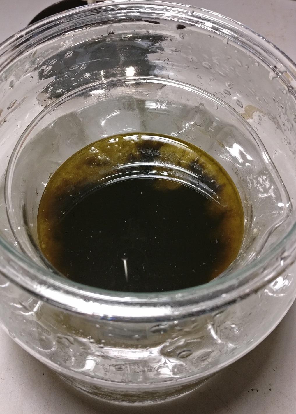

I also made a second batch just for fun from reagent grade GAA and PbO. The reaction kinetics were PITA, but it resulted in a crystal clear solution, which is left for crystallize.
crater1.jpg - 180kB
The solution apparently did not want to crystallize on it's own, so a seed crystal was dropped and then it turned into ice within a minute and heated up quite a lot.
I uploaded a little clip of the seeding.
