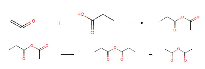

When Ketene is scrubbed with fatty acids higher than acetic acid such as propionic acid or butyric acid and the like, the mixed anhydride of acetic acid or of a homologous acid and the higher fatty acid is formed.The mixed anhydride on heating rearranges and the separate anhydrides of both acids form.By distillation these can be separated.(same will be happen by reaction of methyl ketene with GAA)
4.jpg - 24kB
[Edited on 31-7-2019 by Waffles SS]
