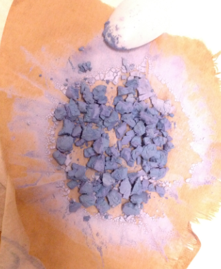

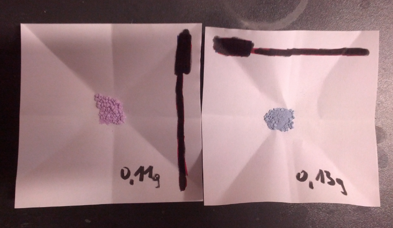

Nickel Hydrazine Azide
Recently I made both Nickel Hydrazin Nitrate and the azide.

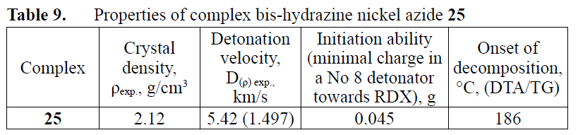

Everything I know about the relatively unknow Azide compound I get from these papers and the following patent.
Attachment: Green Energetic Materials.pdf (1.3MB)
This file has been downloaded 1277 times
Attachment: Synthesis and Characterisation of Metal Hydrazine Nitrate, Azide and Perchlorate Complexes (1).pdf (651kB)
This file has been downloaded 1579 times
Bis-hydrazinenickel (II) azide ([Ni(N2H4)2](N3)2, 25) is the further lead-free candidate for the replacement of LA in primers [40].The mean size of green colored aggregates of complex 25 crystals is ~80 μm. The temperature of ignition of complex 25 is ~193 °C (5-s delay). The thermal decomposition curve of complex 25 comprises two stages. The activation energy of the first stage of decomposition of complex 25 is ~142.6 kJ/mol, whereas that of the second stage is ~109.2 kJ/mol. The non-hygroscopic complex 25 is insoluble in water, alcohol and ether, and is readily decomposed by both acids and bases. Complex 25 had sensitivity to impact equal to 35% in the drop-hammer test (mass of the hammer 10 kg, height 55 cm), whereas PETN had sensitivity to impact equal to 100% under the same conditions. Hence, complex 25 is a safer compound than nickel complex 24.
quote.PNG - 31kB
I don't know why they say it has green crystalls. Because:
https://www.google.at/patents/CN101618866A?cl=en&dq=Nick...
The resulting azide is dark blue polycrystalline nickel hydrazine, in between the particles 66nm~102pm ...
Below are two pictures of this compound.
The first was taken when it was drying and the second one is
Nickel Hydrazine Nitrate in comparison two Nickel Hydrazine Azide
4.PNG - 320kB 6.PNG - 721kB
