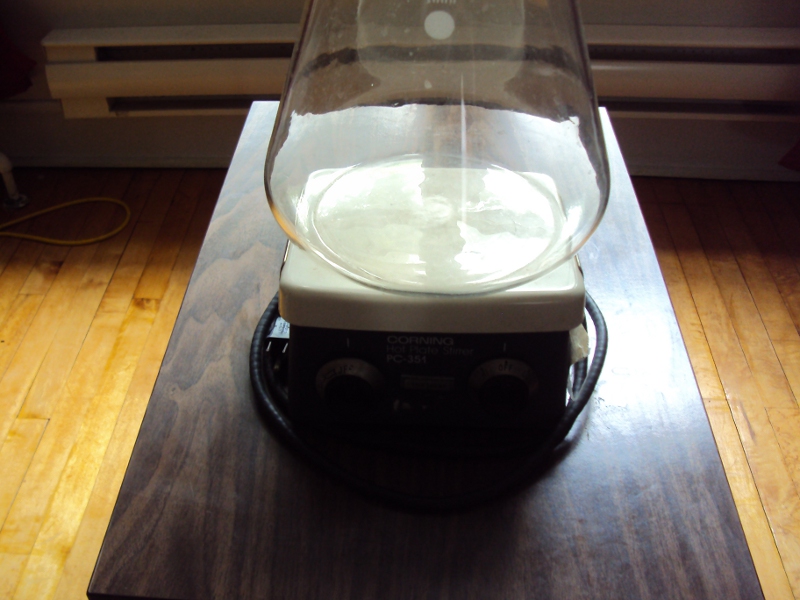

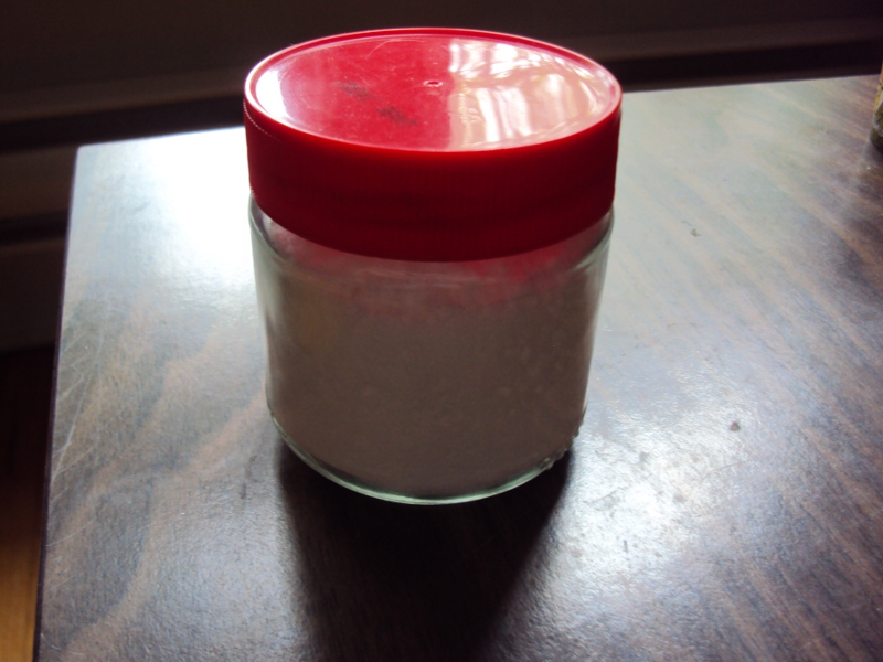

Here is a picture of the stirrer-hotplate with the 5L erlenmeyer sitting on it, you will need to imagine it in action. Also the bottle holding my 81.5 grams of freshly made Hydrazine Sulfate.
Sirrer Hotplate and Big Earl.JPG - 235kBDry Yield.JPG - 232kB
