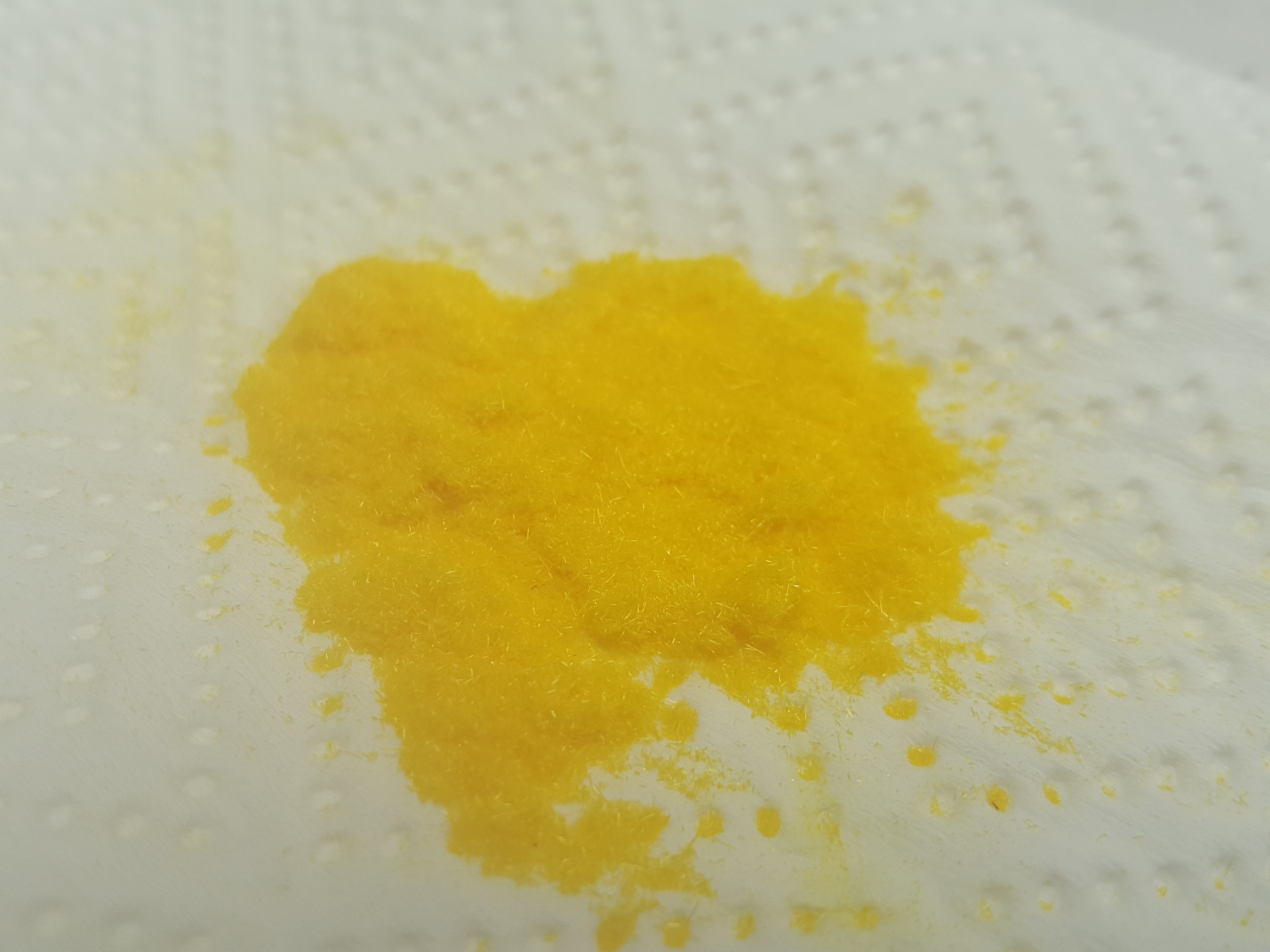

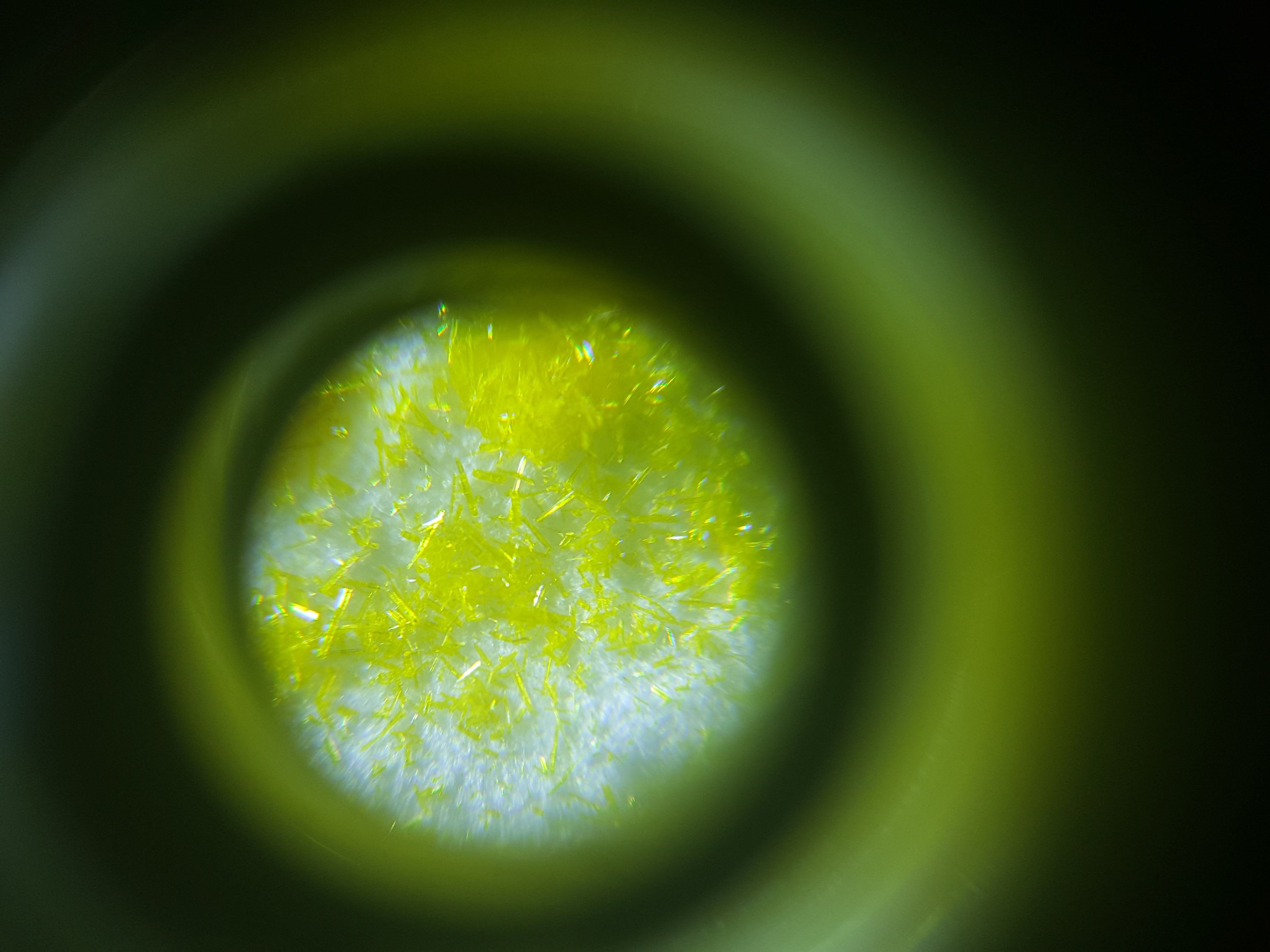

Strontium picrate
I was inspired by neonpulse experiment with cesium picrate on the previous page that I decided to try and make strontium picrate.
I made a thick slurry of strontium carbonate due to the insolubility problems and added it with a dropper to boiling hot picric acid solution until
neutral.
Nothing crystallised when room temperature was reached and still nothing after chilling in the freezer. Strangely, I poured the strontium picrate
solution into a fresh evaporating dish and it instantly started crystallising on the sides and was filtered soonafter.
Its looks very similar to potassium picrate with the crystals needle-like structure but slightly darker in colour (see uploaded photos).
I was unable to intiate it with shock or friction at all.
When ignited it burns similarly to potassium picrate very fast with a slight crack leaving black residue behind. It emits a deep red colour when
ignited or exploded which proves the existence of the strontium cation. When confined in foil and heated in flame it explodes with a loud report.
I will have to try the barium version.
It doesnt take fire from a fuse really at all though or only partially burns if it does.
If this was not an issue, considering the low sensitivity I think it would be a suitable more colourful replacement for the colored Mg flash
compositions for firecrackers which usually get washed out.
Photo on bottom shows about 50mg strontium picrate confined in foil and heated with a flame exploding.

Quote: Originally posted by greenlight ![](images/xpblue/lastpost.gif) | I was inspired by neonpulse experiment with cesium picrate on the previous page that I decided to try and make strontium picrate.
neutral.
[Edited on 15-7-2017 by greenlight] |
Nice...Greenlight that makes RED Lights ![:D](./images/smilies/biggrin.gif) ![;)](./images/smilies/wink.gif) ![:)](./images/smilies/smile.gif) ![:P](./images/smilies/tongue.gif) ![:cool:](./images/smilies/cool.gif)
Great info for picrate lovers and picrate information, thank you...
Lithium may also find uses for the red color...
You experienced the overfusion effect...the compound is into sursaturation state...and a sudden temperature change or a scratch/dust into a glas
recipient may induce fast crystalization...
Instead of carbonate you could also have used the hydroxyde....what must be slightly more soluble...but the advantage of the carbonate is that it
fizzes showing there is stil some picric acid...and the excess carbonate is easy to observe and to separate from the picrate salt.
PH Z (PHILOU Zrealone)

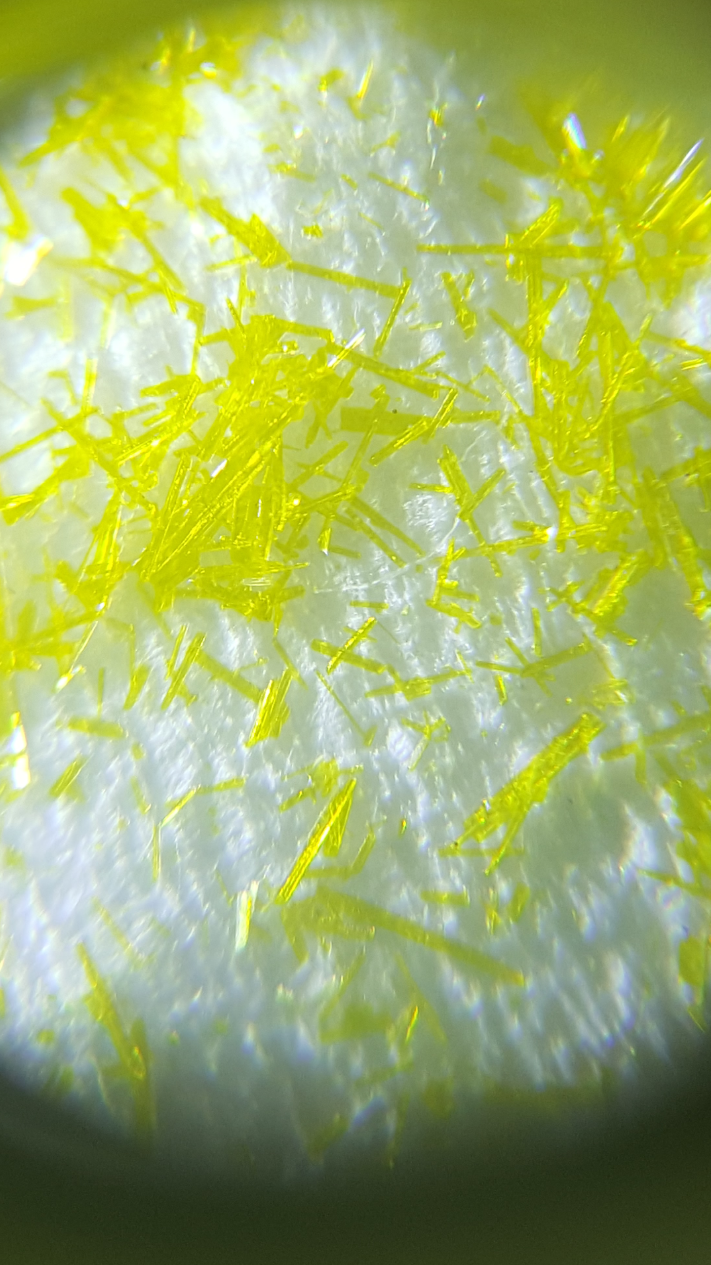

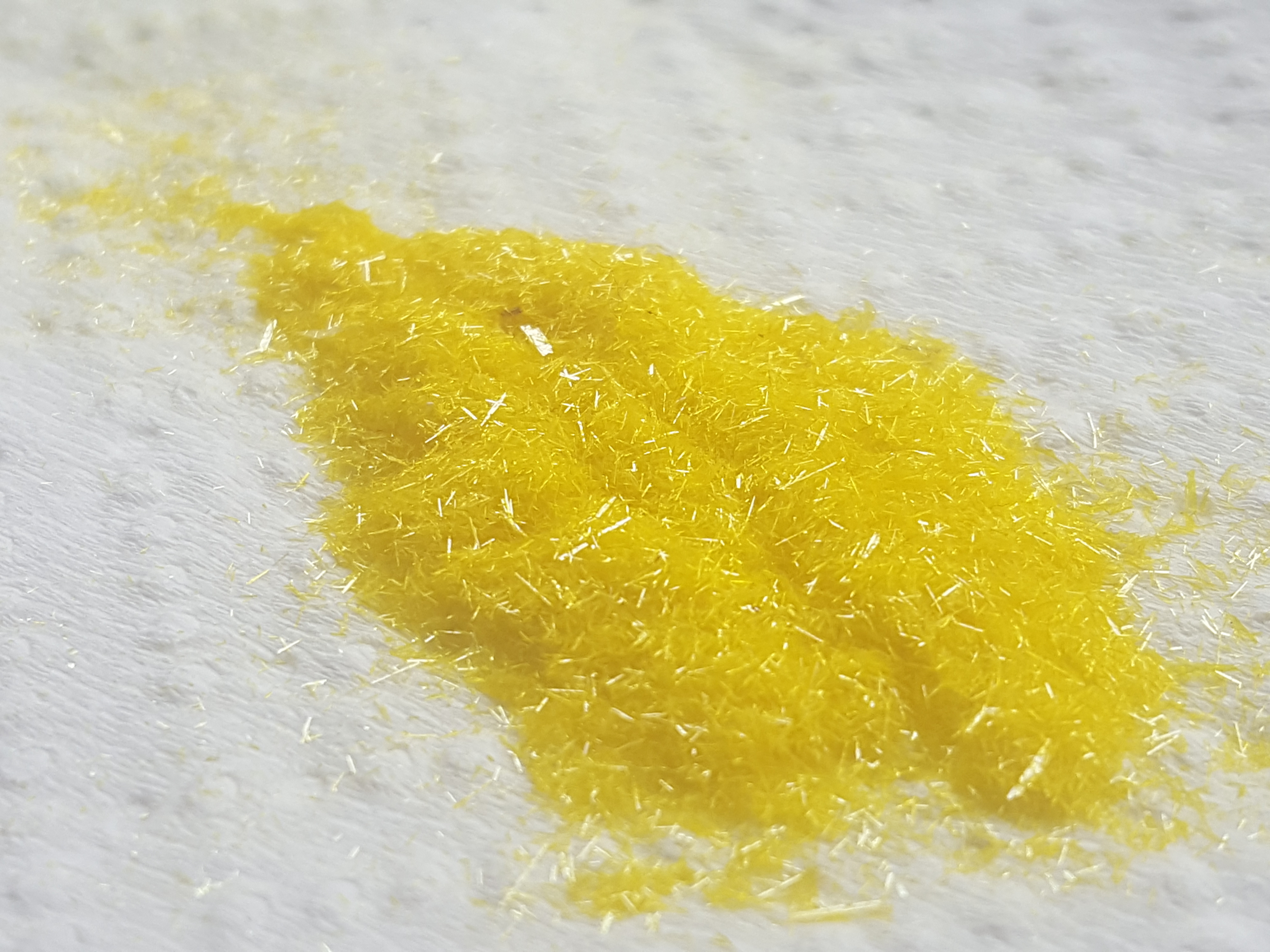

Barium picrate
Thanks LL and Philou
[/rquote]
[/rquote]
Here I will try make the green light haha![:D](./images/smilies/biggrin.gif) ![:)](./images/smilies/smile.gif)
I used the same synthesis method as for the strontium picrate and the same overfusion effect happened when I crystallised it.
The crystals are much finer smaller needles than the Sr salt and leave the same black soot behind after being burnt which seems to be common for
picrates.
It is insensitive to friction and shock the same as the strontium picrate.
Although the green colour is not as strong as the Sr picrate it makes up for it in power and brisance when confined.
Unlike the strontium picrate, the top crystals of a small pile first melt and then initiate the whole pile with a loud whooomp when ignited with a
flame.
It cannot be initiated without first going through a melt-phase of the surface.
It takes longer to explode when confined in foil because of this as well.
The report is louder than Sr and the foil is reduced to smaller pieces even under slight confinement by making a small Al foil cup it explodes loudly
blowing a hole in the bottom and unravelling the whole top.
The amounts used were the same as the tests with Sr picrate.
The left picture is confinement in foil under the same conditions as the Sr salt and the right picture is burning of an small unconfined pile
