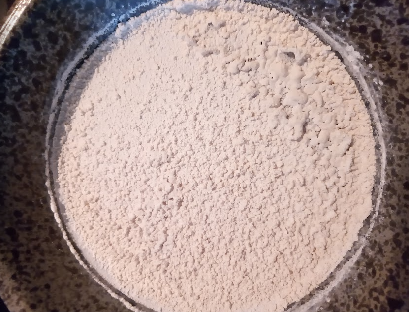

So finally I got around to do this.
I thought I'd combine the two methods in the write-ups above with the best yields: pyridine as solvent in the first step (with glutamic acid and phtalic anhydride), and thiourea + DMF in the second.
I purchased the first reagent, phtalic anhydride, from a seller in Ukraine before the war. The glutamic acid I made myself from commercial Monosodium Glutamate. I also made the pyridine through decarboxylation of niacin with copper carbonate as catalyst. The DMF and the thiourea were both purchased from one of the excellent vendors on this site.
1. 14.95 grams of phtalic anhydride in the form of flaky crystals was mixed with the same amount of glutamic acid in a 3-necked RB fitted with a thermometer and a reflux column. 100 ml of pyridine was added.
And already here I messed up. I had measured up 100 ml of conc HCl and 150 ml of dH2O to use later in the reaction, and in a moment of confusion I added them both to the flask. I don't want to talk about it.
White smoke was generated when the HCl was added, and the flask was put into a heating mantle in a fume hood.
Temp was raised to 115 C and kept there for 100 mins. When the heat was turned off and the temperature began to decrease, white precipitate was formed in the solution. PH was checked: 2.
The flask was then kept on an ice bath with stirring for 2 hours, before the precipitate was vacuum filtered and dried.
Yield: 17.3 g of white, sparkly crystals, which should be like 64% of theory. Melting point 192-194, to my utter joy.
2. The intermediate N-phtaloyl glutamic acid from above was mixed with 15.3 grams of thiourea in the same 3-necked flask.
50 ml of DMF was added.
The reaction mixture was heated to 167 c and refluxed at this temperature for 1 hour. The smell of sulphur from the thiourea mixed with the smell of DMF degrading to dimethylamine was really something.
Heating was turned off, and at 110 C 60 ml:s of dH2O was added and refluxed for another 30 minutes.
After cooling, the flask was transferred to an ice bath and kept there under stirring for another 30 minutes, after which the flask was refrigirated for about an hour.
The greyish-pink precipitate was vacuum filtered and washed with 60 ml of dH2O, then refluxed with 60 ml ethanol for about 20 minutes.
Filtered again, wsshed again with ethanol and water, and then dried. It was now perfectly white and sparkly.
Yield: 12.5 grams.
So I ran the first reaction in a strongly acidic solution by mistake and I was afraid I had ruined it, but the melting point checked out. The second reaction was textbook though, except for not recrystallising from DMF. The resulting sparkly, free-flowing pristine white powder seemed clean enough though.
Bioassay was made with 400 mg:s but gave no noticeable effect. So maybe I messed it up anyway?

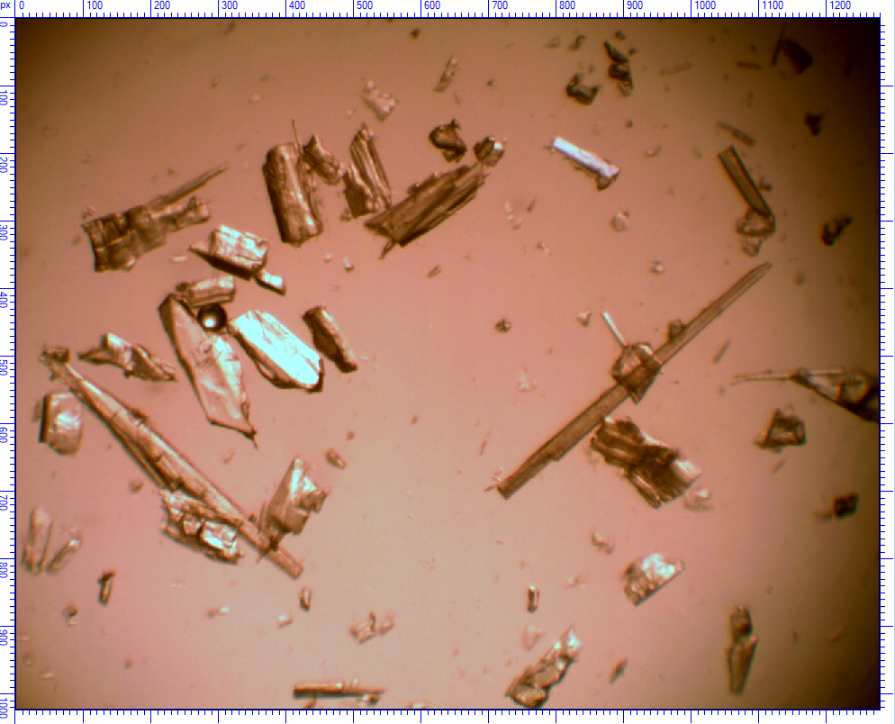

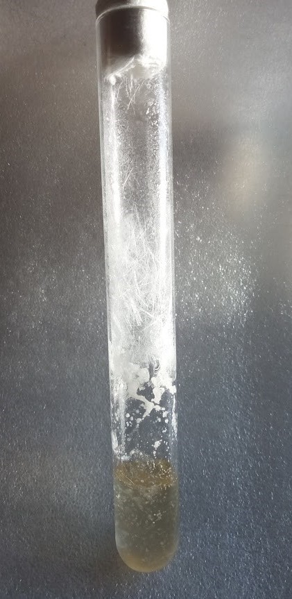

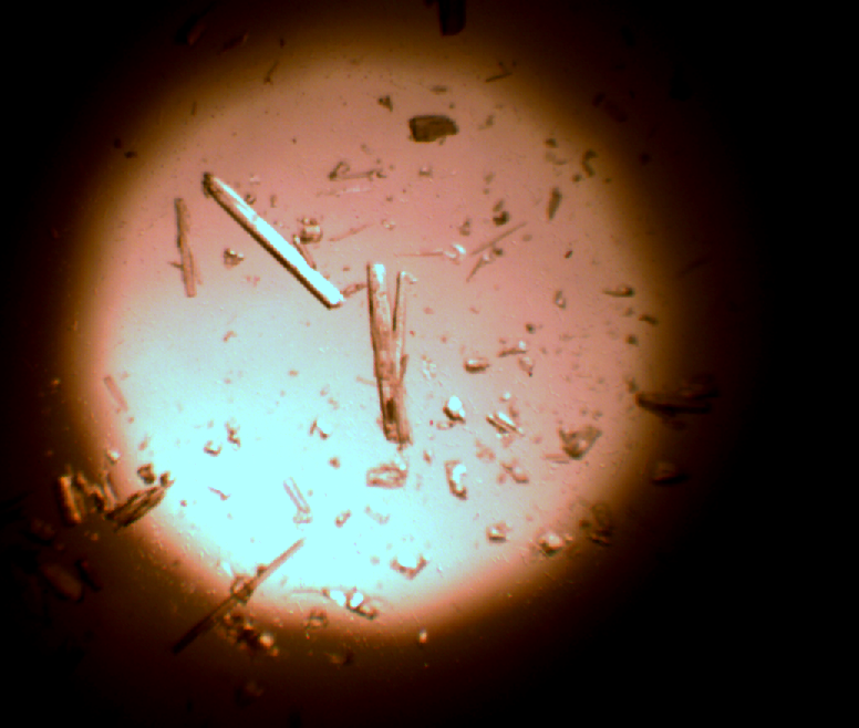

My take on the failure to produce a bioactive end product is that I'm actually looking at a crystal mix predominately consisting of phtalamide. I performed a recrystallisation from DMF which gave me 9.5 g:s in return, but bioassay failed again.
The melting point of phtlamide is like for thalidomide a good bit over 200 C (238 for phtalamide, 270 for thalidomide). I haven't tried the melting point yet. It's a bit of a hassle for me to do that with these temperatures since I don't have a melting point apparatus yet. But I'll get around to it.
I'm planning a second recrystallisation from DMF, and this time basify the solution even more with ammonia to dissolve the phtalamide. We'll see what my yield will be from that. Probably catastrophic, but right now I just want to get something functional out of this.
If that doesn't work, I have to run with the suspicion that my self-synthesised glutamic acid is faulty somehow. Possibly also the pyridine. In that case, I will revisit this synth with confirmed, lab grade reagents.
I will make this work.

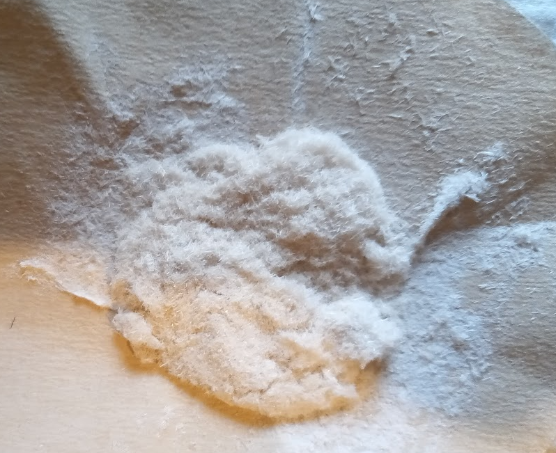

No, I haven't gotten round to it yet. I'm waiting for lab grade reagents to try and exclude all the possible impure or faulty ones.
I did try to clean the product I have several times through recrystallisation from DMF, but to no avail.
Also, next time I'll go back to the original patent method using ammonium acetate as a nitrogen donor. I figure it's best to go to the absolute basic and then work my way from there.
Pyridine + phtalic anhydride + L-glutamic acid in 115 C.
Then Phtaloyl Glutamate + ammonium acetate in PEG400 and a bit of DMF at 160-180 C to get the product. I'll probably run that reaction really long also, to get good conversion.
As soon as I get something functional out of this I can start elaborating for yield.

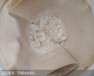

Preparation of N,N-phthaloylglutamic acid
I have attempted the solvent-free procedure detailed by Tsjerk, I have been successful in the preparation of thalidomide, although my yields were relatively low.
I have completed a write-up detailing the preparation of the N,N-phthaloylglutamic acid intermediate, it is attached as a PDF.
My yields were consistent with the 54% reported by Tsjerk.
The write-up for the preparation of thalidomide is on its way :)
Please let me know if I've made any mistakes, or anything, all comments welcome!
Thanks for reading :)

my results
L-Glutamic acid was prepared from Ajinomoto MSG, according to the procedure outlined on the OrgSyn page (note 4) with the use of activated carbon for high purity.
N-phthaloyl-DL-glutamic acid was prepared by heating an intimate mixture of phthalic anhydride and L-glutamic acid in an oil bath as outlined in the post by Tsjerk earlier in this thread.
Experimental
5.25 g N-phthaloyl-DL-glutamic acid and 1.55 g thiourea was dissolved in 20 ml warm methanol. This solution was poured into a porcelain dish and the methanol evaporated in a well-ventilated area with the aid of a hairdryer. The dish was then further dried in a stream of hot air (70°C). The solids were finely ground using mortar and pestle, and placed in a large (25 x 200 mm) borosilicate test tube, the top of which was plugged with a ball of toilet paper.
The bottom sides of the test tube were gently heated with a hot air gun until the powder at the side just started to melt. The tube was then placed in a porcelain cup in the microwave oven (600W) and heated in short bursts of 10-30 seconds. The contents started to melt, bubble, water vapour and gases evolved, which judging from the smell included ammonium sulfide. For that reason in between the short bursts of heating the test tube was taken outside, the paper wad removed, and the foul smelling volatiles released. This was repeated until the liquified contents became orange in colour.
The tube was allowed to cool down and the contents inside solidified. When still warm to the touch (but not hot) 30 ml methanol was added, which caused the solids to break up easily. After filtration, washing with cold methanol and air drying 1.60 g (33%) thalidomide was obtained.
Thoughts & remarks
The yield is indeed slightly better than when urea is used, but I don't know if that is worth dealing with the stench evolved. It did bring back pleasant memories of childhood, when we used to buy 'stink bombs' which were glass ampoules with an ammonium sulfide solution inside. Once we shattered one under our feet inside the driving bus on a school trip, I distinctly remember a raging busdriver and inadequate ventilation on the bus, we had to suffer the foul atmosphere equally as our classmates but thought that was worth the joke. :D
Anyway it's the same substance, and I suspect in about the same amounts as in such a stink bomb ampoule. On this scale I don't think it's dangerous with adequate ventilation, but it's not very pleasant either and such odor could certainly draw attention. Something to consider.
mixture_porcelain_dish.png - 741kB thalidomide_crude.png - 292kB
Recrystallisation
1.60 g crude thalidomide was dissolved in 8 ml DMSO with gentle heating. In a roundbottom flask fit with condensor, placed in a warm water bath on a hotplate/magnetic stirer, was placed 30 ml methanol and the contents were heated to 45-50°C. With good stirring the thalidomide in DMSO solution was added dropwise to the methanol, and after addition the solution obtained was left stirring at that temperature for 50 minutes.
Contents were then poured into a beaker, flask washed with 10 ml methanol and added to the beaker. On cooling to room temperature crystals started to appear. The beaker was then placed into the freezer for 2 hours, and a mass of fine needle-shaped crystals had formed, which were filtrated and washed with cold methanol.
after air-drying 0.91 g thalidomide (presumably as the alpha form) were obtained, 57% yield based on the crude thalidomide
thalidomide_recrystallised_alpha-form.png - 1.1MB

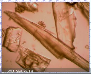

A preparation of the recrystallised thalidomide crystals was made for viewing under the microscope. The following pictures were taken at 40x, 100x and 400x magnification respectively.
thalidomide_recrystallised_alpha-form_40x.png - 674kB thalidomide_recrystallised_alpha-form_100x.png - 1.5MB thalidomide_recrystallised_alpha-form_400x.png - 1.6MB

[*] posted on 10-4-2024 at 05:07
An intimate mixture of 5 grams phthalic anhydride and 5 grams L-glutamic acid (finely ground together in a mortar with pestle) in a large (23 x 200 mm) test-tube was heated in an oil bath at 145-150°C for 30 minutes. Here's a picture taken from the post-reaction mixture cooled to room temperature :
IMG_20240410_075517.jpg - 97kB
At the bottom the melt turned into a glassy solid, this is chiefly our product N-phthaloyl-DL-glutamic acid. There are still some white particles present through the mix, consisting of the precursor products.
Same for the white crust on the sides of the tube above that, this is because the volume of the powder mixture is about twice that of the melt.
Then above that you see large pretty needles of phthalic anhydride that sublimated from the mixture, and water droplets formed during the reaction.
