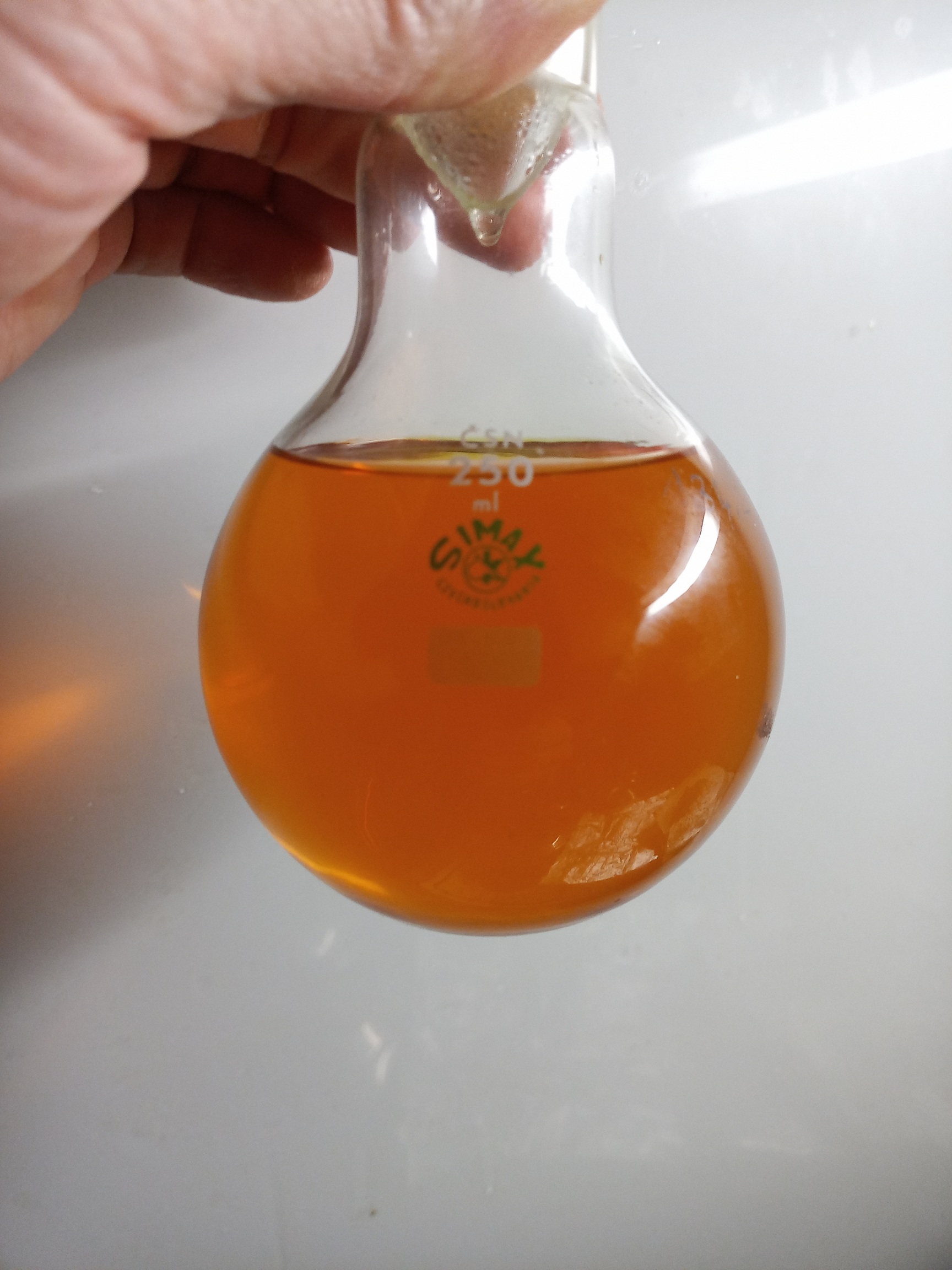

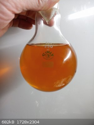

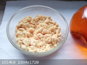

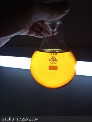

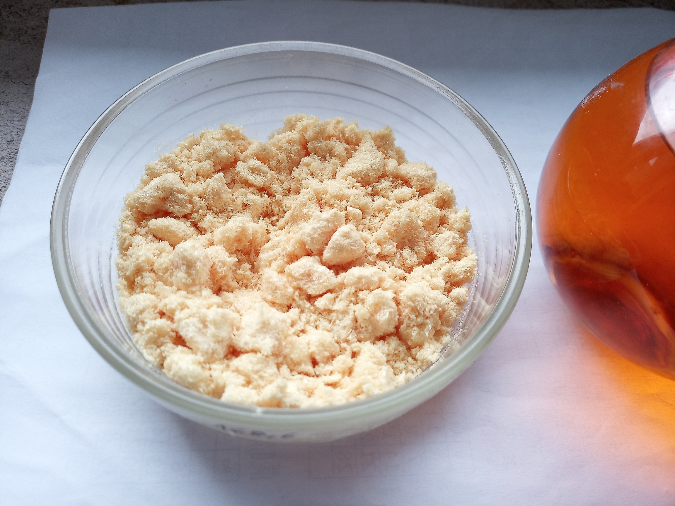

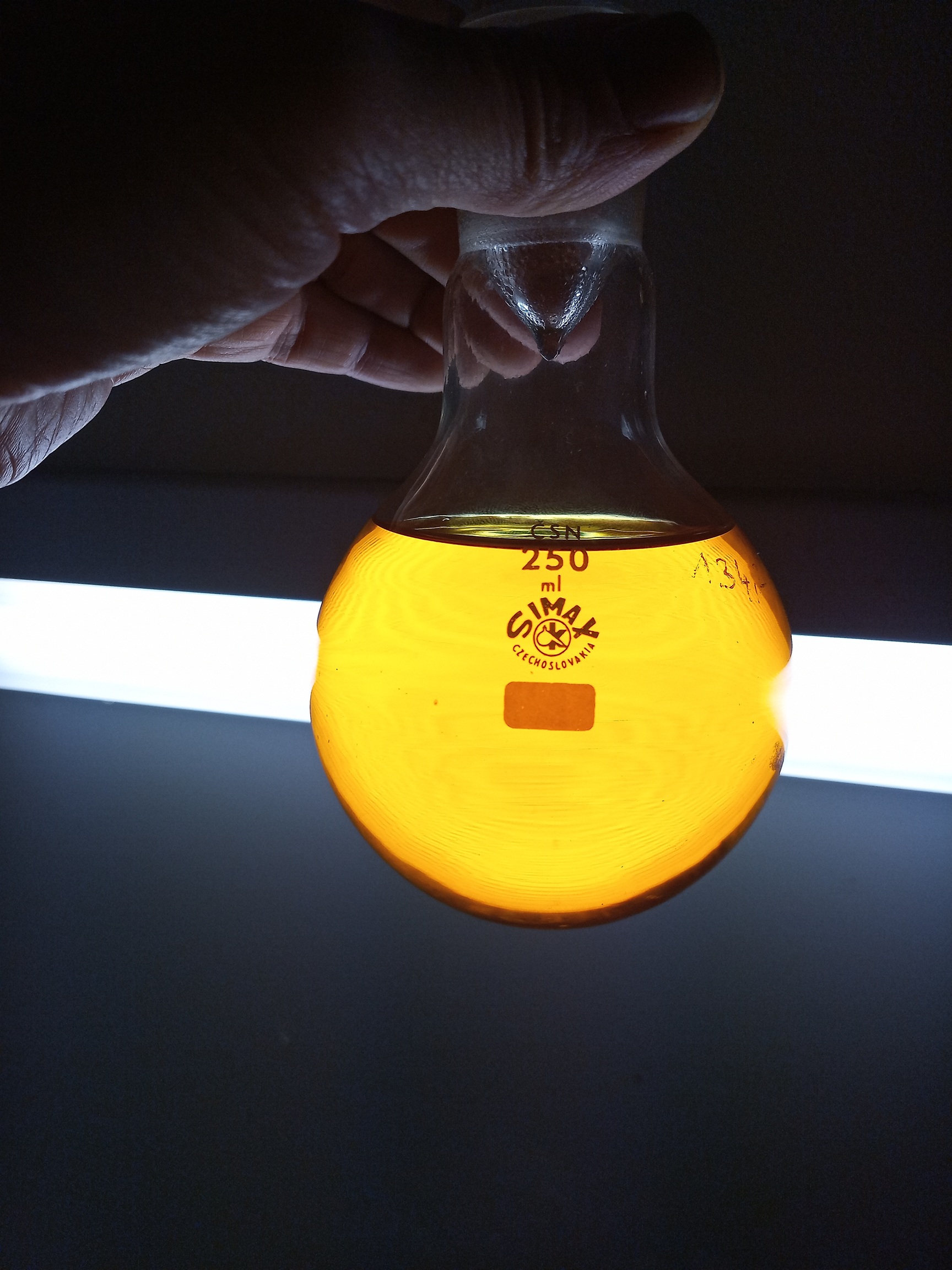

Recrystallization from methanol works, here how I did it. As m.p. is quite low, I did not dissolve in boiling methanol, just in temperature below m.p. to prevent oiling out.
Crude product 44,0 g was dissolved in 200 ml of methanol after warming in 60 C water bath. Then it was let to cool down slowly in the water bath. It crystallizes unwillingly so the solution was touched by a tip of glass rod, glass rod removed from the flask and there was tiny amount of solid product in few seconds as methanol evaporated quickly. Tiny amount was scraped from the glass rod into the solution when its temperature fell to 30 C and then it was let undisturbed at room temperature (previous attempt when it was stirred resulted in a mass with very tiny crystals and almost no mother liquor). After few hours it was transferred into 10 C environment and later outside (winter time) at 0 C when it was let overnight. The next day mother liquor was decanted as much as possible (no loses of product, crystals adhere together, weight of mother liquor 130,1 g), then crushed by glass rod (around 20 ml of mother liquor appeared at this phase), transferred into sintered funnel, flask washed with 20 ml of fresh 0 C methanol and added into the sinter, vacuum filtered outside at 0 C. Then 30 ml of 0 C fresh methanol added, crystals stirred with glass rod and sucked outside at 0 C using hand pump and then for few minutes inside at 20 C using water aspirator vacuum pump. Weight 30,5 g of after scraping from sinter, then air dried in a dish for 1 day (after half a day the weight already stable without decreasing), weight of dry product 28,8 g. Mother liquor was left in freezer at -18 C with seeding crystal for 1 day, there is a little of crystals of the product.
1-nitronaphthalene seems to be more soluble in alcohols than naphthalene, about twice better. I found only solubility of naphthalene in methanol and ethanol, not the nitronaphthalene.
200 ml of methanol is 5 mols, extra 50 ml 1 mol, so 6 mols of methanol used totally.
Solubility of naphthalene at 0 C is 0,010 mol naphthalene + 0,990 mol methanol. 0,018 mol naphthalene + 0,982 mol ethanol.
https://srdata.nist.gov/solubility/sol_detail.aspx?sysID=59_...
If only 80% of naphthalene was nitrated and 20% stayed unreacted such amount of methanol is capable to keep unreacted 0,05 mol of naphthalene (from starting 0,25 mol) dissolved. But there was no scent of unreacted naphthalene in the crude product. The scent is very nice, hard to describe. The closest similar scent is 2-nitrophenol, but nitrophenol scent is not so good, too much artificial and chemical. The scent of 1-nitronaphthalene is like natural and very pleasant, without anything artificial (even it does not occur in nature). It is very different from nitrobenzene or 2-nitrotoluene, much weaker and much more pleasant.
crude product dissolved in warm methanol, side light and trans light
IMG_20260226_180927_2_sm.jpg - 682kB IMG_20260226_181017_2_sm.jpg - 816kB
recrystallized 1-nitronaphthalene and mother liquor (there is still estimated 30-35 % of the product in the mother liquor)
IMG_20260302_104927_5_sm.jpg - 1014kB

Posts: 1134
[*] posted on 3-3-2026 at 11:41
thank you Axt for valuable link and solubility data
the data for 95% ethanol - also necessary to cool down to 0 C as at 20 C the solubility is still quite high... or use diluted ethanol with water (but then higher risk of oiling out instead of forming crystals)
interesting also nitric acid you posted - solubility is very low, but I saw few mg of crystals which formed from the spent acid after cooling down (I posted a picture, they grew downwards from floating solidified crude product, they were much better and bigger than from methanol... pity that the solubility in HNO3 is so low thus impractical for crystallization, maybe they were so big only thanks to that very low solubility so formed from very diluted solution)

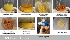

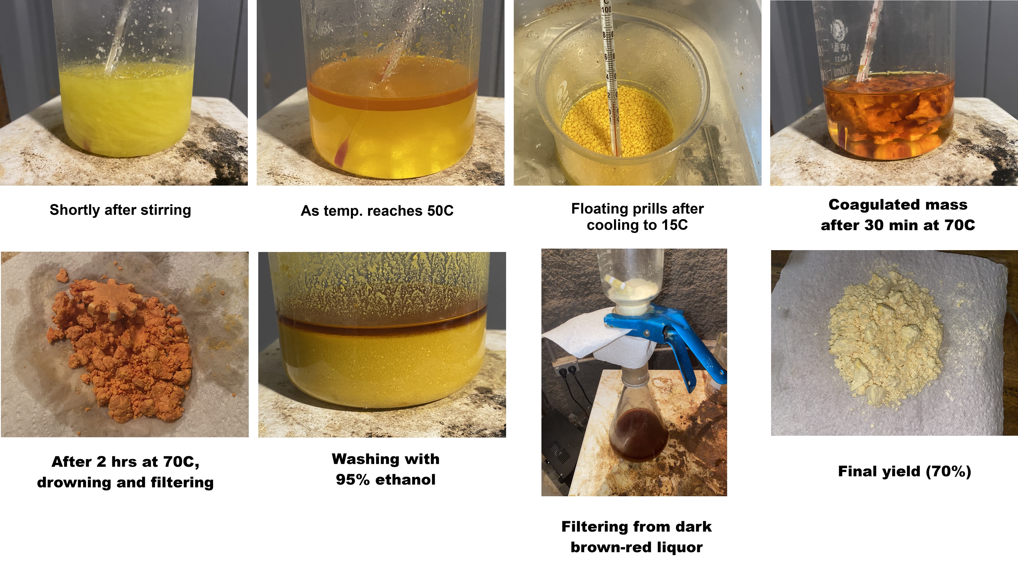

Here's naphthalene to dinitronaphthalene. The article attached is the follow-on article from the translated Chinese one above for mononitro product. It worked fine, however the product straight from nitration was bound into orange resinous balls which was easily separated by an ethanol wash (dinitronaphthalenes have very low solubility in 95% ethanol.) Article claims a >95% yield, mine was an honest and clean 70%. The melting point was within the range stated in Urbanski vo. 1, pg. 427 for the commercial dinitronaphthalene (140-170C) and should primarily be a mixture of 1,5 and 1,8 isomers in a ratio of 40:60.
The article gives a simple acetone extraction to separate these isomers, 1,8 being a lot more soluble, but I haven't done this.

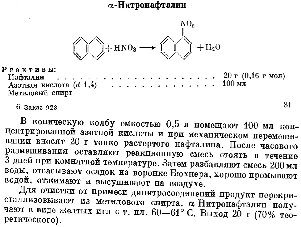

Here a method from Golodnikov - Praktikum po organiceskom sintezu 1976, pages 81-82:
Into 500 ml conical flask pour 100 ml conc. HNO3 (density 1,4 g/mL), while mechanical stirring add 20 g of powdered naphthalene. After stirring for 1 hour let it to sit for 3 days at room temperature. Pour into 200 ml of water, filter on Buchner funnel, wash well with water on filter, let to air dry. For purification from sideproducts (dinitroderivates) recrystalize from methanol. Yellow needles, m.p. 60-61 C. Yield 20 g (70% of theoretical amount).
