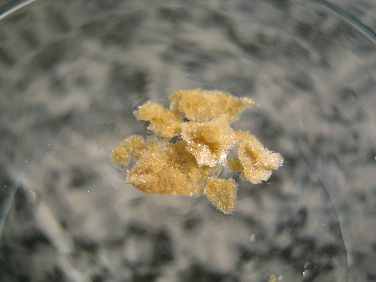

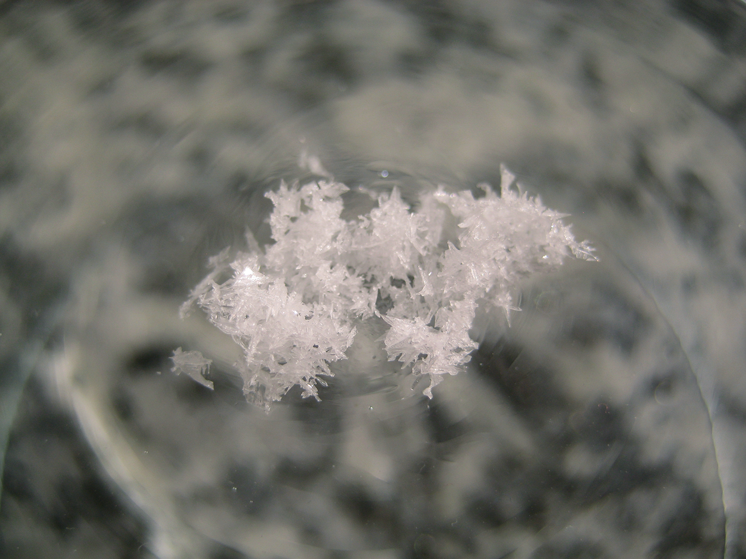

Progress report 1:
Improvements to GB1153483, in lieu of GB392845 on the manufacture of Hydrazine Sulfate: A Chlorourea-Ketazine Process not involving Cl2.
I decided to give GB1153483 a try, just to see whether their 75% claimed yield held any vestiges of truth.
12.6g (0.2 mol) urea was dissolved in 18.9g water. 1.6g of 50% NaOH (0.01 mol) was stirred in and the mixture was placed in the freezer.
When the mixture had dropped to -10C (it froze), 125g of 12.5% commercial NaClO (0.2 mol) at 0C was added in roughly 10ml portions evenly over an hour. Vigorous stirring and re-chilling followed each addition. The reaction is not very exothermic but any rise in temperature above 5C results in bubbling, undoubtedly signalling the decomposition of the chlorourea intermediate. The bubbling was most pronounced on the first and last additon, suggesting that thermal control is difficult with a low reaction mass, and decomposition of the intermediate is fast at high concentrations. The mixture does not foam.
After the last addition of NaClO, 30.4g of 50% NaOH (0.38 mol) with 0.1g Knox gelatin was added with rapid stirring, causing the light green mixture to begin foaming. The reaction was heated as quickly as possible, reaching 60C in about 10 minutes and causing foam to add another 1/3 to the volume of the reaction mix (total about 300ml incl. foam at peak). The color of the liquid gradually became orange/amber. After approximately a minute of exotherm the foam rapidly subsided, leaving a straw colored, foam-free, hot liquid characteristic of a hydrazine prep.
This was allowed to cool with stirring with a watch glass over the top of the erlenmeyer until it reached approximately 30C. 28.8g (0.4 mol) methyl ethyl ketone was added and the mixture was allowed to stir for an hour for the azine to form, cooling to room temperature in the process.
The azine layer was extracted and immediately run into 19.6g H2SO4 in 20.9g H2O at about 30C. Hydrazine sulfate precipitated immediately. This was stirred for 10 minutes, then heated with stirring for about 30 minutes to drive off the MEK. After a loss of 1/3 of its volume, the mixture was placed in the freezer and chilled to 0C. It was then vacuum filtered and washed twice with 30ml portions of ice water.
The dried filtrate weighed 6.26g, or 21% of theoretical yield, and consisted of dense, pearlescent crystals consistent with hydrazine sulfate.

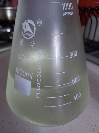

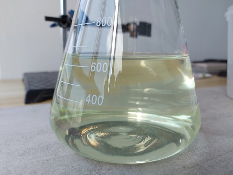

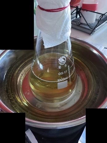

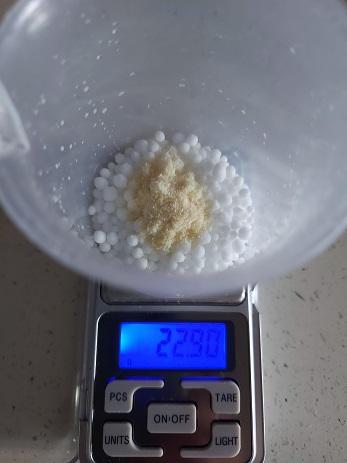

Hydrazine Sulfate synthesis with Calcium Hypochlorite
Reagents:
50g Ca(OCl)2 (granules, pool chlorine)
100g KOH (90%)
40g Urea (granules, deiceing agent)

hydrazine from chlorourea, failure report
Based on the posts by garage chemist and ordenblitz as well as patent US3454361A I attempted the chlorourea process with the change of using MEK instead of direct neutralization with sulfuric acid.
Disclaimer:
I found this process unreliable, but maybe I am just missing a crucial detail.
Silver mirror test:
A small sample is dissolved in 9% ammonia with some drops of silver nitrate solution. After a while a silver mirror forms and confirms the reducing agent.
Attempt 1:
Following garage chemists post, I used the same amounts and just adjusted for using sodium dichloroisocyanurate (NaDCCA) instead of TCCA.
Chlorine: 15.2 g NaDCCA, 30 g 30% HCl
Urea: 20.5 g CO(NH2)2 + 0.2 g gelatin in 40 ml
Sodium hydroxide: 16 g NaOH in 40 ml of water
Extraction using MEK, yielded 33 g of ketazine phase
The gelatin was first dissolved into the boiling hot water, which was dumped onto the urea, instantly dissolving and giving a luke-warm solution which was left to cool to room temp. for a bit.
The chlorine absorption was great and even tho the chlorine bubbled fast through the solution, no chlorine smell was observed, as well as next to no suckback. After all acid was added, the chlorine generator was heated until no more gas evolved.
The chlorourea was added into the lye solution inside a 1000 ml erlenmeyer flask, the foam only filled up about 200 ml. It was left stirring then heated, turing yellow and then more clear again, was left cooling in the water bath and then stirred with the MEK for a short time.
Yield was about 4.56 g of hydrazine sulfate after hydrolyzing the ketazine with 38% sulfuric acid, 25% based on chlorine (the limiting reagent).
Then I attempted the procedure from the patent.
Attempt 2:
Slightly modifying the procedure from the patent, I increased the ratio of chlorine to urea to about 1/1. I also added some NaHCO3 to catch some of the HCl that forms. The foaming was unbearable and the addition of chlorine took almost 3h when it took half an hour before.
Chlorine: 36.4 g NaDCCA, 63 g 30% HCl
Urea: 20 g urea + 0.2 g gelatin + 9 g NaHCO3 in 40 ml
Extraction using MEK, yielded 44 g of ketazine phase
The chlorourea solution had an unpleasant chlorine-like smell, somewhat sweeter, possible the smell of chloramines. It evolved gas on its own, nearly blowing out a stopper once. It foamed strongly when pouring it into an addtion funnel.
Addition into the hydroxide produced a massive amount of foam and lots of white smoke and a lot of heat. It had to be added in several small amounts, yet the foam almost reached the top of the 1000 ml erlenmeyer flask several times.
After the hydrolysis nothing could be recovered from the hydrolyzed ketazine.
Upset about this I thought about giving this a last chance.
Attempt 3:
Following garage chemists post again but on 2x scale and with some modifications I used these amounts:
Chlorine: 30.4 g NaDCCA, 60 g 30% HCl
Urea: 41 g CO(NH2)2 + 0.4 g gelatin in 40 ml
Sodium hydroxide: 32 g NaOH in 80 ml of water
Extraction using MEK, yielded 22 g of ketazine phase
This time I cooled the urea solution in the freezer before passing the chlorine into it.
The reaction flask for the final addition was a three necked 1000 ml RBF with addtion funnel and reflux condenser. Both the chlorourea and the lye solutions were cooled to about 5 °C beforehand. With strong stirring, the chlorourea solution in the addition funnel was drained into the lye, heating the soltion to 40 °C instantly and foaming up to roughly about 2x the liquid volume. The solution was stirred for a bit, but no change in bubbling seemed to occur, so the mix was heated to about 80 °C for a few minutes. Still barely any change, it was cooled to 70 °C before I added the (ca. 40 g) MEK via the addition funnel. The mix turned first yellow and then red. Cooling in the water bath to 20 °C and stirring strongly for 2h (I suspected the earlier attempt to fail because I didn't stir long enough to form the ketazine) gave a very red solution (should have let the solution cool more) and a yellow layer on top. To improve the recovery of ketazine, some K2CO3 was added and 25 ml of washing gasoline which gave 30 ml of slightly yellow liquid, another washing gave 27 ml from 24 ml. The gasoline washes were processed separately.
On hydrolysis the this time very yellow ketazine phase gave nothing but a deeply red, awfully smelling solution. The gasoline washes deposited a small amount of what looked like hydrazine sulfate which was confirmed using the silver mirror test.
Attempts at saving the hydrolyzed ketazine solutions:
I suspected I added not enough sulfuric acid, so I added some more and boiled the ketazine from attempt 2 and 3 down even further. This yielded bigger crystals that didn't look like the small crystals of hydrazine sulfate.
However, the silver mirror test confirmed both crystals to contain hydrazine.
Conclusions:
A big issue is the self-heating when mixing the chlorourea and the lye.
I have found this method to be unreliable and low yielding, giving 25%, 0% and 0% in the three attempts as well as something that doesn't seem to be hydrazine sulfate but still reducing somehow.
Maybe there is also some issue with the ketazine extraction. Maybe the crystals are some different salt of hydrazine, maybe they just look different. Maybe the gelatin gets destroyed by the chlorine and should be added later. Overall I think making bleach from the chlorine is more worthwhile.
However, urea seems to at least work as a good chlorine scrubber.
Left to right: Samples of the products of attempt 1, 2 and 3.
hydrazine_attempt1.jpg - 1.1MB hydrazine_attempt2.jpg - 1.1MB hydrazine_attempt3.jpg - 1.1MB

Synthesis and Questions

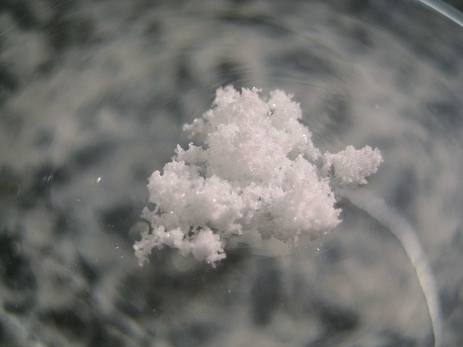

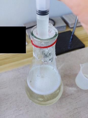

My hydrazine sulfate synthesis using the standard urea+bleach+sulfuric acid method. This is the 2nd run, I was too scared during the 1st run to take any pic :)
Pic 1 30g of NaOH is first dissolved in 30ml of DW
Pic 2 (which is then added to ) ~550ml cold household bleach (assumed 5% concentration)

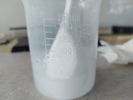

Pic 3 ~22g of urea and <1g of gelatine is dissolved in 20ml of warm DW

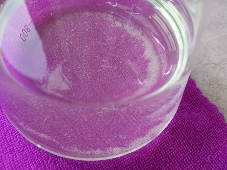

Pic 4 the initial foaming started in about 5 seconds after combination of reactants

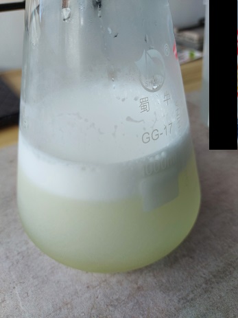

Pic 5 heating in water bath after initial foaming died down; solution turned a darker shade with more foaming
Pic 6 stop heating after foaming ceased; solution is pale yellow
Pic 7 ppt before neutralization; NaCl? Na2CO3?
Pic 8 neutralization with 110ml of 55% cold sulfuric acid; ppt disappeared!; extra sulfuric acid will not affect yield right?
Pic 9 "yield" from 1st run; very fine crystals, frankly I can't tell if it's hydrazine sulfate, Na2SO4 or NaCl ...
I am assuming there will be Na2SO4 impurity, this will not affect the freebasing of hydrazine with NaOH/ethanol right?
Cheers. It was fun.

[*] posted on 8-4-2020 at 02:53
What was your percentage yield?
You can use the silver mirror test if you have silver nitrate (or can readily make it) http://www.sciencemadness.org/smwiki/index.php/Hydrazine_sul...
As long as you filtered before it got too cold you won't get much Na2SO4.

artemov
Posts: 181
Registered: 22-8-2018
[*] posted on 8-4-2020 at 03:58
Na2SO4 is what you will be filtering out after the freebasing so it does not matter.
edit, fixed the link
[Edited on 8-4-2020 by B(a)P]
Unfortunately I dun have any silver salts, too expensive lol ....
I haven't dry them yet, and I'll be combining yields from both runs. Hoping to get >30g (with impurity) for the azide synthesis.
I'm cooling them down to ~5C in the fridge, since Na2SO4 doesn't matter in the freebasing, I'll try to get as much hydrazine sulfate out of the solution as possible. Too tired to do a 3rd run :P
Thanks, will update with the final yield.
