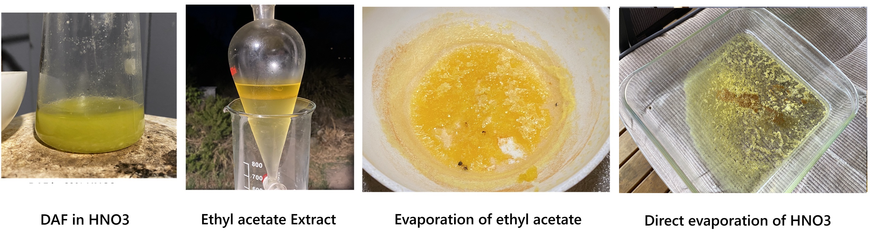

Recently I have been looking at furazan derivatives again. There are a number of procedures for diaminofurazan (DAF) from hydroxylamine hydrochloride and glyoxal which does not require a pressure reactor. The dehydration/cyclization step is done either in a high boiling polar solvent such as ethylene glycol, or in concentrated aqueous urea solution with reflux for 12 hours. I have not had much success with the EG processes, but I suspect there is some additive in my EG that is the culprit. The H2O/urea system works fine but I have noticed a fairly large amount of white crystalline sublimate that collects in the condenser.
This compound puzzles me. It is non-flammable, water soluble and does not melt on application of heat from either above or below but rather sublimates. When heated from below on a piece of Al foil this creates a sort of Liedenfrost effect that makes it skate around on the foil without melting.
I initially thought it might be hydroxylamine freebase, maybe as an adduct with water, but that doesn't track with the non-flammability.
Does anyone have an idea as to what it might be?
No idea, but you could check its pH in water, then see if it reduced AgNO3 solution. Or just throw it in a nitration bath and see what happens :D
Just a thought, probably thinking too exotic. Ammonium carbonate would likely act like that.

Ammonium carbonate is probably the most likely. It is a very substantial amount and may provide insight into why the yield is not so good for these preparations (especially if calculated from hydroxylamine basis).
And, yes, I am considering nitrogen rich salts of furazan derivatives such as dinitraminofurazan or dinitraminoazoxyfurazan. I found a reference to the coupling of DAF to DAAF using just Oxone rather than H2O2/H2SO4 that worked quite well, and since it should be fairly straight forward to nitrate DAAF, it seemed natural to invetigate the salts.

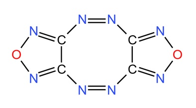

I had some DAF from ages ago, so I treated 1 gram with TCCA in acetonitrile (1:2 molar eq. in 50 mL solutions). This is the literature route to the bicyclic "difurazanotetrazocine", so 2 furazan rings joined through two azo bridges. I mistakenly added the TCCA slowly to the DAF whereas as published it should be done the other way around, this may be important.
The lit runs a 2hr soxhlet extraction with hexane, this sounds like a pain in the arse so I just evaporated the acetonitrile and digested the remains with NaOH/water and filtered the orange suspension. It seems to have worked.
You have to be careful with this stuff, it flashes violently on ignition, a fair comparison on the vehemicity scale would liken it to NHN or dinitrobenzenediazonium perchlorate. It detonates easily and strongly under the hammer and when briskly rubbed with the hammer on rusty steel. I wouldn't be surprised if C4N8O2 has initiating properties.
Testing the mp it was way off, lit gives 54C mine kind of beads up a bit at 100C then more major melting at over 200C. This may be the result of adding the TCCA to DAF instead of DAF to TCCA. May also be because I didn't extract it with hexane. I checked the lit for higher oligomers and found the props for the tetramer and its mp was 212C.
Both the dimer and tetramer have similar densities and heats of formation thus would be expected to have similar detonation properties. The tetramer has published values of 8550m/s and 31.9GPa. No sensitivity data for the tetramer but the dimer is 4 cm with 2.5 kg weight where HMX was 25 cm.

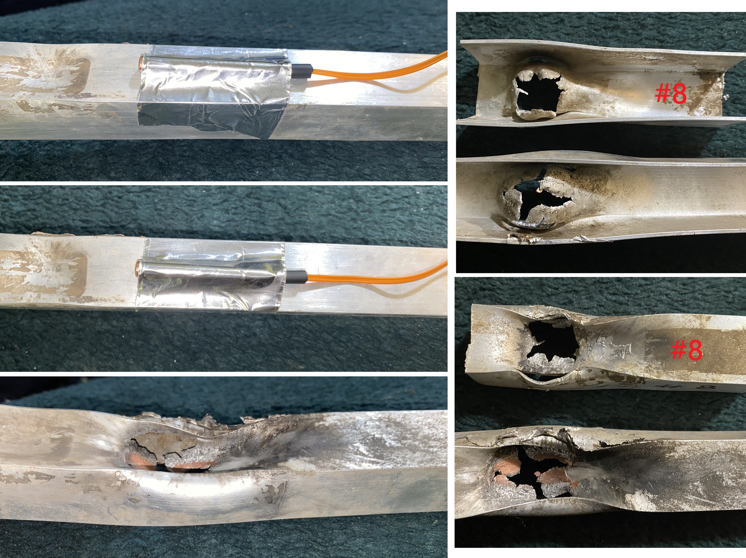

Difurazanotetrazocine (DFT), 40 mg in a single layer of foil was negative to DDT, just flashed with a pop.
100 mg of DFT lightly pressed over 600 mg hand pressed PETN was positive with full detonation. Below compares the DFT initiated charge with a commercial #8. The #8 should be around 800 mg PETN with ASA primary and reinforcing cap.

Yeh I did stir some DAF in oxone and received a high yield of DAAF, it will respond with a weak snap to a very strong hammer blow. The reduced azo (non-oxy) bridged compound is meant to be just as insensitive. I've been trying to find reference to the sensitivity of the larger azofurazan macrocycles but have not found anything. I'll attach the article on DFT that mentions its sensitivity. I referred to this back in the 19yo thread but mentioned it's too old to be available online, its online now.
"DFT is a dangerous primary explosive with a drop height of approximately 4 cm (2.5 kg. Type 12, HMX=25 cm). We believe the sensitivity is due to the boat configuration as the azo-group's n-electrons are orthogonal to the x-electrons in the furazan rings, and thus no stabilization through delocalization can occur."
They do refer to an attempt at oxidising the DFT to azoxy but received only a low yield of monoazoxy compound and gave up. I have seen reference to oxidation of the tetramer to tetraazoxy yes very dense very powerful but it required oleum/persulphate ie. super Caro's acid.
I tried sodium dichlorisocyanurate (1.2 g DAF, 10.2 g SDCIC, 10. g 90% acetic acid / molar ratio 1:4:16) It turns orange instantly but left stirred for an hour then digested with 12 g NaOH whereby the solution turned dark brown. Filtering this leaves the same orange highly sensitive DFT. Its annoyingly fine and difficult to filter, I digested my filter paper with NaOH in the process.

I tried nitrating DAF as follows:
1.8 g DAF was added in small portions to fuming nitric acid (10 ml double distilled, free of NOx) at 0 C. Stirring was continued at this temp for two hours.
At this point the mix was poured on crushed ice. Nothing precipitated so the soln was extracted with 3 times 8 ml ethyl acetate. The combined extracts were evaporated in an air stream without heating. A small amount of gas evolution was observed during this procedure. I couldn't get the products to crystallize and the mix seemed fairly unstable, so I resolved to form salts directly. I did this by dissolving the product liquid in ethanol and then added this to ethanolic solutions of bases.
I began with simple KOH, the idea being that I could then react this with acid, extract into ethyl acetate and precipitate with other bases as needed. A large amount of orange precipitate was instantly formed when the two solutions were combined, but I had the suspicion that some of the crystals might be KNO3 if some of the nitric acid had been extracted into the ethyl acetate, or if decomposition of the nitrated product had produced HNO3 during evaporation.
To see if there was something other than HNO3, I added some of the product solution to an ethanolic solution of hydrazine hydrate. This also gave an instant precipitate that was slightly darker in colour than the potassium salt.
I also wanted to try the carbohydrazide salt whic I haven't seen mentioned in the litteraure. Carbohydrazide is not soluble in ethanol, but I dissolved some in a small amount of water and then added an equal amount of ethanol. This did not cause the CHZ to crystallize, so I added the purpoted DNAF solution to the CHZ soln, and after about half of the DNAF soln had been added, a large amount of beige precipitate had formed.
All of the salts were isolated and are air drying at time of writing.
On re-reading the "Taming DNAF" paper, I saw that they worry about over-nitrating the DAF substrate by substituting one of the nitramine hydrogens. This substance is obviously much less stable than DNAF. They resolve this problem by using a very small amount of WFNA (2 ml per 1 g of DAF), running the reaction at -10 C and only for 30 minutes.
This means that I likely have made a mixture of di- and tri-nitramines which may explain the instability.

After working this past month on optimizing the preparation of DAF, I have done a few more runs of DNAF and its salts.
I first suspended 1 g DAF (10 mmol) in H2SO4 (96 %, 5 ml) and then added a mix of HNO3 (62 %, 2.24 g, 22 mmol) and H2SO4 (96 %, 2 ml) dropwise with stirring. I kept temp at 7-8 C using a salt/ice bath. After end of addition, I stirred another 30 minutes. At this point, some foam had formed, but there was no active off-gassing. The mix was poured on ice, and the clear solution was extracted with 3x10 ml ethylacetate. A little of the extract was combined with hydrazine hydrate. No precipitate formed, but after evaporating the solvent and excess hydrazine, a waxy crystalline substance remained. In a flame it melt and then burns with a hissing flame. It may be a hydrate, I will try drying it at some point.
The rest of the extracts were combined with CHZ-nitrate solution. This resulted in an immediate off white precipitate which was isolated.
The dried product puffs off at 198 C without melting. The yield was about 90 % from DAF.
I haven't done any sensitivity or performance tests yet.
I also tried the nitration using acetic anhydride and fuming nitric acid. My nitric had developed some NOx staining, and I think this may have caused some of the DAF to be oxidized (to DAAF probably) based on a marked orange colouring of the reaction. The advantage of not using H2SO4 is that the CHZ soln can be added directly when the mix has been diluted with water. This is problematic with the mixed acid nitration since CHZ-sulfate is only slightly soluble in water (about 25 g/L in hot water), and might compete with the precipitation of the product.
It might not be a big issue since the CHZ-DNAF salt has an extremely low solubility.
Edit: I have done a few tests of CHZ-DNAF. Firstly, I tested impact sensitivity by hammering on a cheap anvil. It required sustained full power strikes, but I was eventually able to set it off in this manner. I would say that it is considerably less sensitive than RDX.
I also compressed 1.000 g into the usual 7 mm ID brass tube with reinforcing block. I used my vice, but wasn't able to get the density to more than 1.70 g/cc. This is not so great, but might be caused by less than ideal crystal morphology. I do not have access to methods to measure crystal density, so it is possible that it is simply not much higher.
Finally, I made a plate dent test (20 mm Al block witness plate using the aforementioned 1.000 g in 7 mm tube at 1.70 g/cc). The dent was 4.2 mm deep placing it at 98 % HMX, 102 % RDX at their respective maximum achievable densities in my setup. This is quite decent at this relatively low density.

Are you saying you did receive a precipitate from pouring the water/nitration mixture directly into carbohydrazide solution?
I've tried the prep I posted above, just stirring DAF into 70% HNO3 for 2 hrs at room temp until it dissolved, then poured this yellow solution into a CHZ solution but there was no precipitate. I neutralised it with NH3 but still nothing bar a little sediment that settled out, not enough to bother filtering. I might try again but follow the script to see if it works at all.
What Al grade witness plate are you using?
Interesting though, there's very little that can beat RDX while being less sensitive than it.

Yes, after nitration in Ac2O/HNO3, the mix was diluted with water and then combined directly with carbohydrazide dissolved in acetic acid. The acetic acid was probably not necessary since the nitration mix contained that in abundance.
The product from the Ac2O nitration is not as thermally stable as that from mixed acids, puffing off at 180 C. I haven't done any experiments to improve the stability, and it is definitely possible that it stems from nitrosamine compounds (or something else entirely) from the dissolved NOx. Maybe boiling for a while could decompose any unstable impurities.
The Al is ordinary extruded AW-6060. I get it in 20x40x2000 mm bars and then saw small blocks off as needed.

I tried again, 5 g DAF was stirred in room temp. 68% HNO3 for 2-3 hrs until it dissolved, then either evaporated out directly or poured into 200mL water and extracted with ethyl acetate. The ethyl acetate extract seemed to stay very wet with at least 20 mL water/HNO3 coming over with it I attempted to dry with CaCl2 but it was just too much.
Neither dried to dry crystals rather the ethyl acetate extract stayed slightly waxy, and that evaporated from HNO3 was oily. It dissolved readily in water but neither off these extracts produce precipitates when combined with carbohydrazide (1g extract with 1 molar eq. CHZ in 50 mL water).
The extracts are energetic, deflagrating similar to RDX and responding to the hammer in a similar fashion. Melting point for the obviously impure EA extract was low 60-70C.
EA extract dissolved readily into acetonitrile, there was an initial pale yellow precipitate on addition of 80% hydrazine hydrate for which I accidently added 2x to much (4 molar eq.), but it turned into a yellow solution with small orangish brown oily precip. Currently evaporating out the acetonitrile.
All in all, its pretty ugly.

I have never isolated the free acid. When I tried evaporating the ethyl acetate extracts the first time I nitrated DAF (and my product was probably contaminated with a lot of the dinitramide derivative) it started bubbling ominously even a room temp, so I stopped concentrating any further and just added the protonated bases in ethanol. Subsequently, I just haven't bothered to evaporate before precipitating the salts. I did find that the CHZ salt doesn't precipitate from ethyl acetate unless the CHZ is protonated first. I have used both CHZ nitrate and acetate which I would dissolve in a small amount of water and then dilute with ethanol.
When this is added to the ethyl acetate extracts (still wet and probably containing some HNO3) with rapid stirring, immediate precipitation is observed. Over the course of a few seconds the precipitate seems to mostly redissolve but as more CHZ-NO3 soln is added, the precipitate persists. The hydrazine salt seems to not precipitate as easily, and I had to evaporate to dryness (room temp airstream) to get the somewhat waxy salt. I did use straight hydrazine hydrate in this case, not a hydrazine salt.
