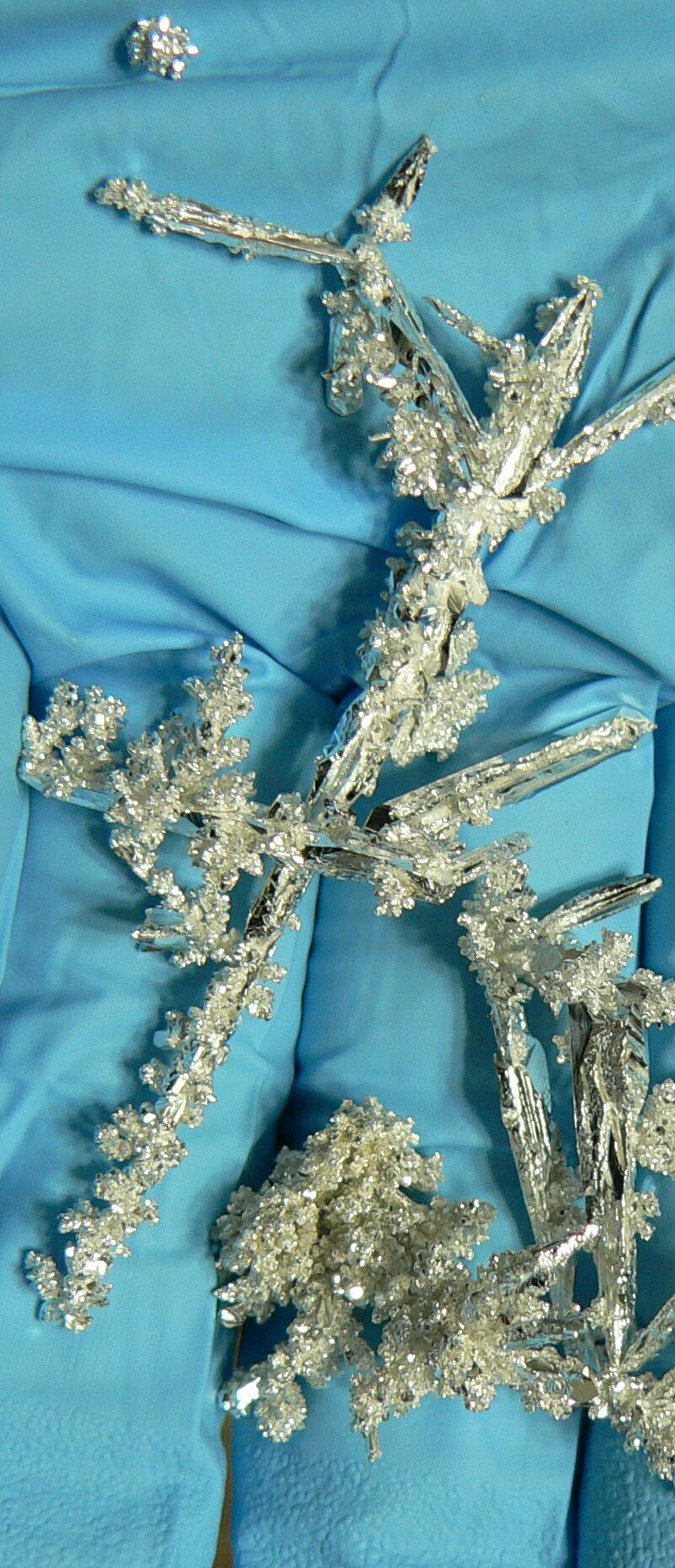

Chunky Pure Silver Crystals
Large elemental silver crystals grown in my silver cells.
To see the cells that produced these crystals, please see the technochemistry forum - post titled Electrolytic Silver Cells.

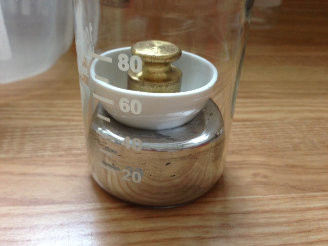

So long as we are on the Hg topic, here is a 50g brass weight floating in a small crucible boat, on mercury of course :) (need to clean the mercury at some point..)

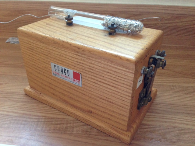

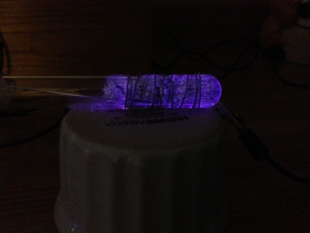

Ozone generator... Made with a test tube stuffed with Al foil and a wire coiled around the outside. Connected to an induction coil it makes enough ozone to be uncomfortable...

Ozone generator
could you give a more detailed description of your setup? would be worth a try if only for the evil glow =D

Quote: Originally posted by tetrahedron
Ozone generator
Oh...suuuuuuure......... It was supposed to be proprietary and top secret, but what the hell ;)

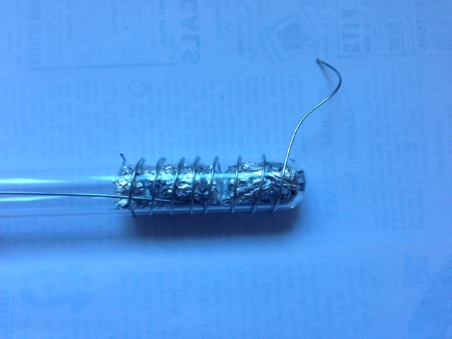

It's a rather crude set up I made in about 15 minutes. Anything similar to this set up will work, whether its a test tube, glass plate with foil on either side etc. I used a test tube because it allowed me to coil wire on the outside and fill the inside with foil which has lots of sharp corner and edges which seems to be where the plasma concentrates itself.
The more blue glow you see, the more ozone you are making.

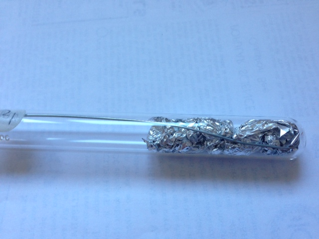

First a metal wire with a hook with roughly the same curve as the test tube bottom was stuck into the tube. Then aluminum foil was jammed in in small pieces and compacted quite a bit with a metal rod. This forms one electrode.
ozone1.JPG - 82kB
Then wire was tightly wound around the tube as shown here. It helps to wind it around the tube, remove the "spring" of wire and tighten it to make it have a smaller diameter and then push it onto the tube to ensure it stays on tightly without needing tape etc.
ozone2.JPG - 86kB

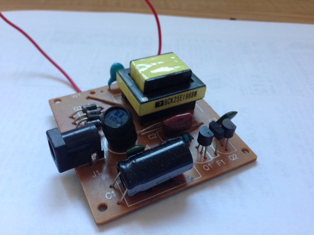

At first I tried to use this small transformer chip that came from a small neon tube display... It produced no glow or ozone. Im not sure what voltage these things operate at but obviously not high enough. The output wires do arc though and give nasty little shocks.
ozone 4.JPG - 93kB
So instead I took out the bigger guns and used a real induction coil (which does give a wicked shock...), this thing easily makes 3 inch long sparks through the air. I'm not entirely sure of the output voltage but the only power supply I have is 6V, 3A. Just connect the output terminals of your HV source to either of the electrodes on the tube (doesn't matter which one) and you have a crude ozone generator.
ozone3.JPG - 120kB

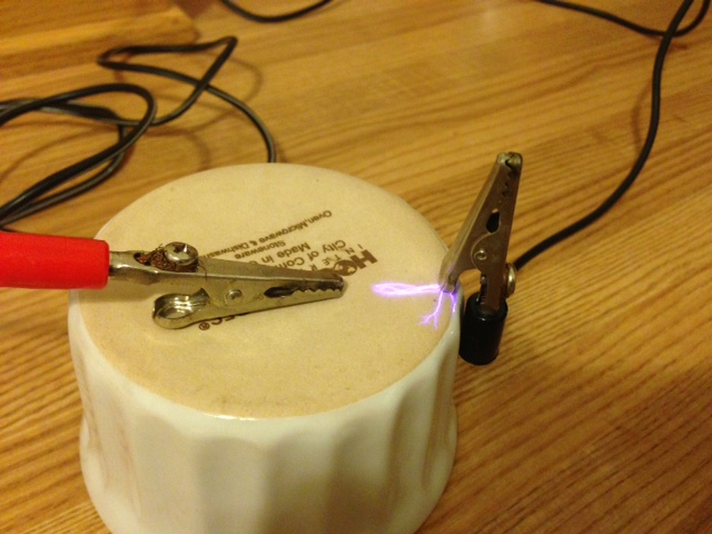

This is just running the coil with alligator clips on a porcelain dish...
acr.JPG - 111kB
PS: If somebody could enlighten me on how to calculate the output voltage of this induction coil it would be appreciated. Im not a big electronics guy and this was just something I bought on eBay due to good pricing.
I plan to place this tube into a larger glass vessel and use an air pump to circulate air through it and have a dilute source of ozone. This test alone gave me a horrid sore throat the next morning... which I am directly blaming having my face too close to the damned thing for so long. Nonetheless.
You can do this too... http://www.bigclive.com/oz.htm
[Edited on 27-11-2012 by Mailinmypocket]

[*] posted on 27-11-2012 at 14:09
great info. this deserves its own thread. a quick question: since the corona discharge can be intensified by making the electrode more 'spiky' (ideally a needle), is the dielectric really necessary?
