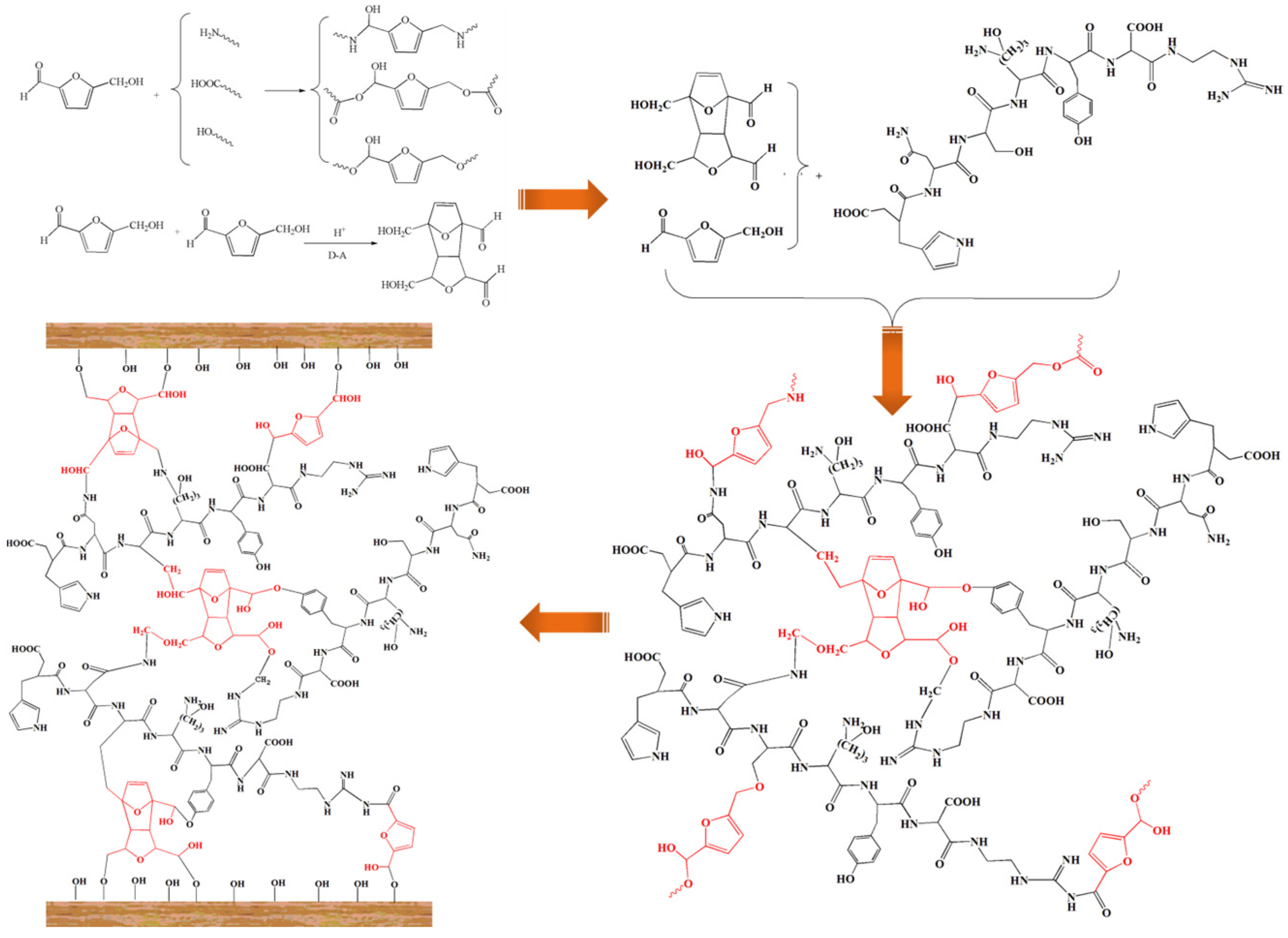

More images showing how the sugar-amine binder works with the addition of acids or amine salts.
Don't forget: for carbon electrodes, you need to use a large excess of sugar to produce mesoporous carbon(3-5mol excess).
The resulting composite resembles glassy carbon and gives a residue in which you can even see a reflection.

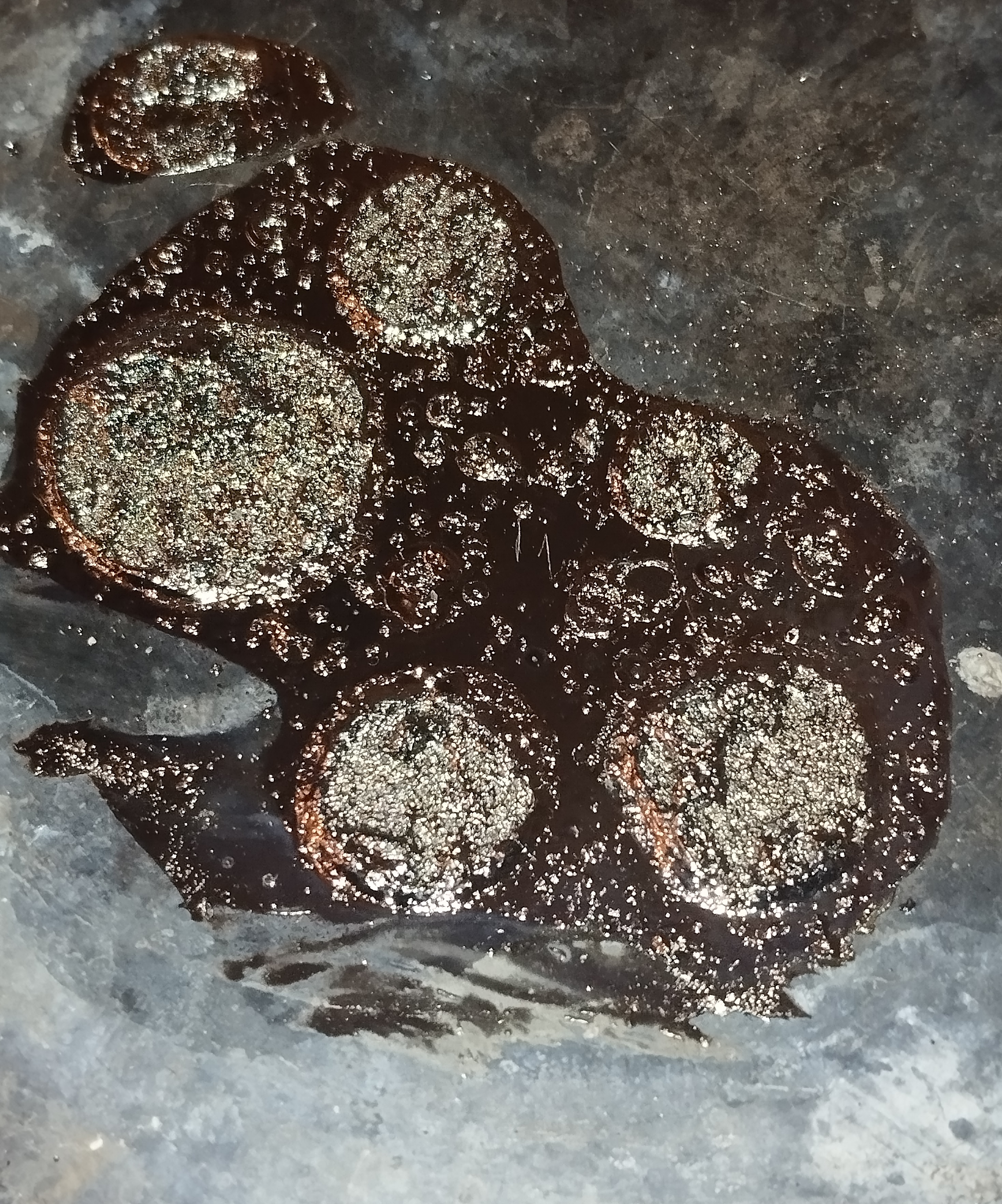

[*] posted on 7-2-2026 at 09:50
I'll be working on carbon electrodes soon.
This new photo shows the result of carbonization of the best binder ever made. Carbonation was carried out on a glass plate.
Hydrolyzed polyamide 66 in hydrochloric acid plus sugar. The exact ratio isn't known, as I had a solution, but it's possible it was 1:3 to 1:5, with excess sugar, of course.
You can see the precipitate, like glass. It's very hard.
