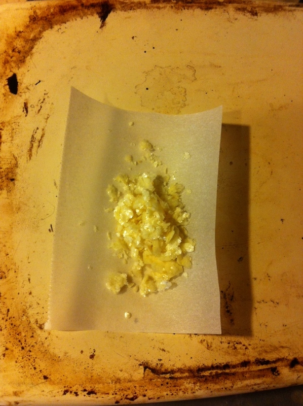

I finally got around to trying a few things to purify my tryptamine that has been busily oxidizing since I made it nearly four months ago. The pale yellow powder/chunks had since turned an orange-brown color, similar to rust. I tried recrystallizing from n-pentane, but tryptamine is very sparingly to completely not soluble in it.
Boiling in ethyl acetate (EtOAc) and triturating with pentane gave a foggy solution, but no crystals. So, I went about doing an acid/base purification, very similar to the one that I posted up thread.
1.0 g crude tryptamine was dissolved in about 20 mL EtOAc and 10 mL n-pentane, then extracted with 30 mL then 10 mL 5% acetic acid (made with 99% acetic acid and distilled water). The aqueous layer was extracted twice with a mixture of 30 mL EtOAc and 2 mL pentane*. The aqueous layer at this point was a tiny bit turbid and just ever-so-slightly yellow. It was slowly and carefully basified with 25% NaOH solution with stirring, just until cloudiness persisted. The container with the solution/suspension was capped and placed in the freezer for about 15-20 minutes. I was pleasantly surprised when I was greeted with a suspension of shimmering crystals! These were vacuum filtered, washed with ice-cold ammonia and dried over NaOH to give 0.90 g of waxy, nearly colorless crystals.
Unfortunately I am out of melting point capillaries, so no analysis until I get more in a week or two. Here's a picture, though. :D
photo (598x800).jpg - 305kB

Very nice result and an excellent yield from recrystallization. Did you record the PH before recrystallation?
I have extracted again the remainder of the 1g of unpurified tryptamine using a second heptane extraction and sure enough I have more pure tryptamine. The problem for me seems to be not using enough heptane and of course not checking the solubility.
[Edited on 4-9-2013 by hive3]
Crowfjord
Posts: 390
Registered: 20-1-2013
Location: Pacific Northwest
Mood: Ever so slowly crystallizing...
[*] posted on 4-9-2013 at 15:25
I did not check the pH, but in retrospect I should have. When I get the time I will do another run and take detailed notes. I'm really hopeful that I can make a good reproducible method.
