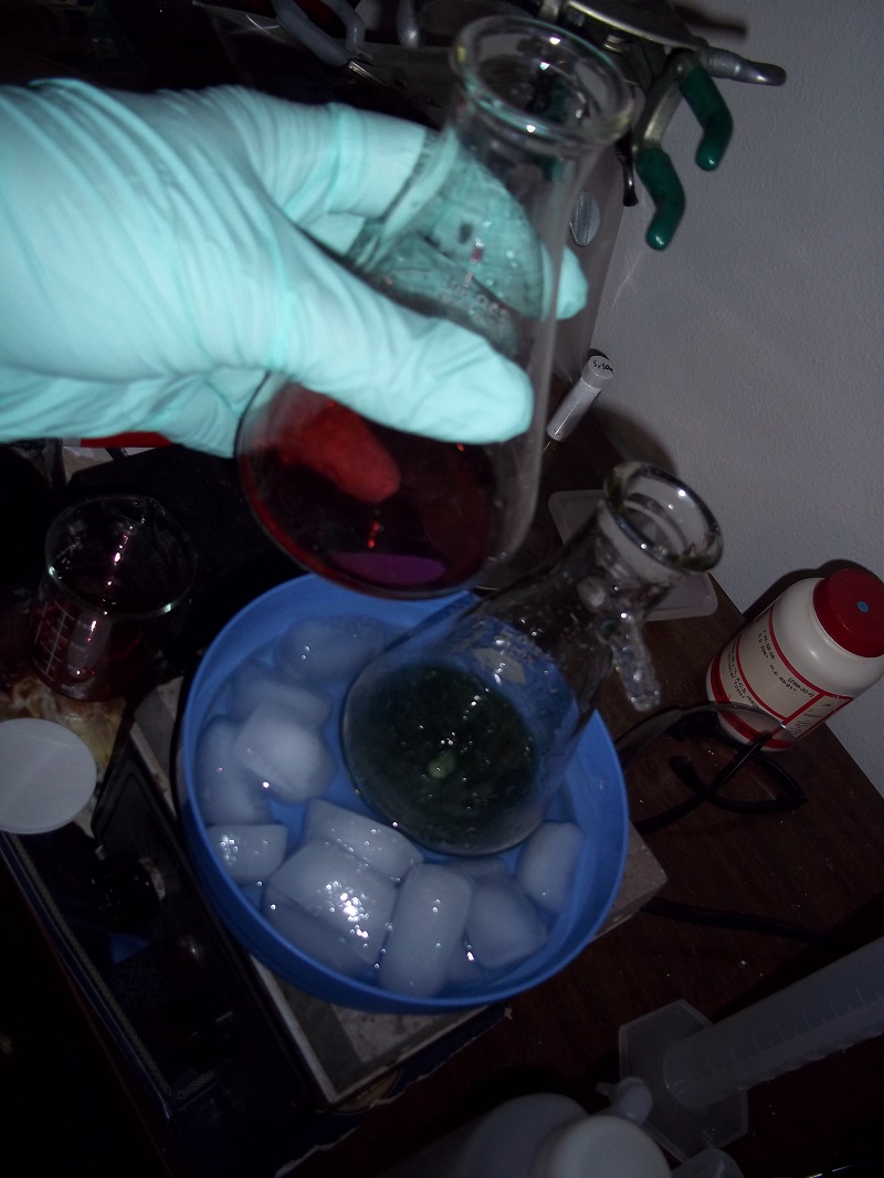

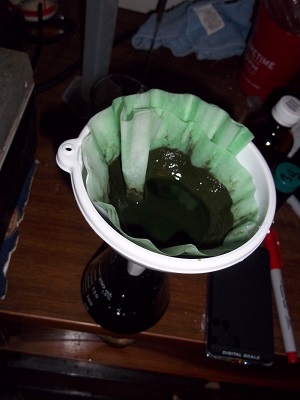

Synthetic updates!
The green cobalt complex:
Sodium Tris-carbonatocobaltate (III) Trihydrate
(The procedure is given in the above paper: Bauer & Drinkard, 1960).
This is cool since most cobalt III compounds are unstable :D

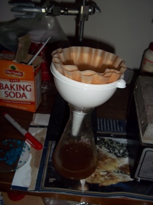

The brown stuff is the iron aspirinate, not great for gravity filtration setup due to the fine particle size. The procedure is given in Lynch, et. al. 1982.
100_1196.jpg - 105kB

Very cool!
