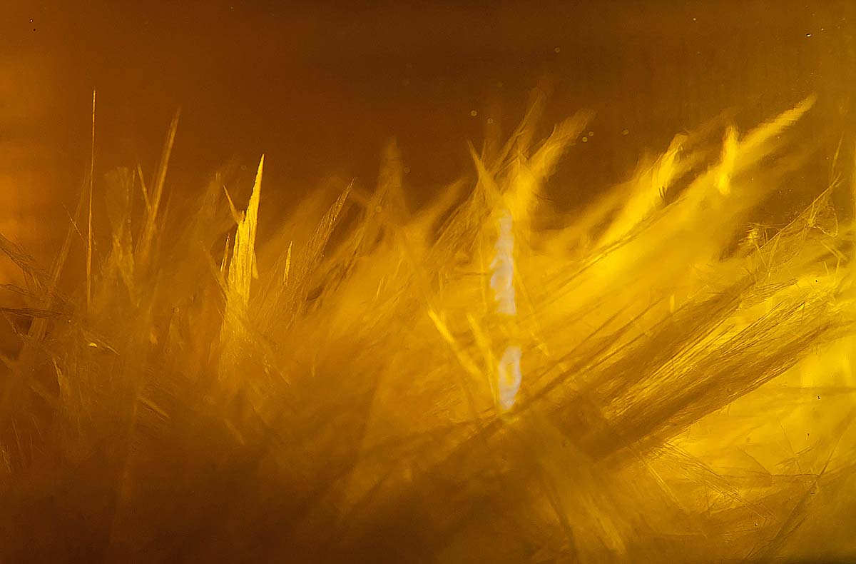

Just an observation that I wanted to share, not really of added value to this thread.
Just recrystallized a batch of PA for picramic synthesis, Normally I let the water solution cool and don't give it a closer look untill the next day or so. I never noticed how beautifull this process is. Upon a closer look the feather like crystals beginning to grow also introduced pronounced turbidity (dont know if this is the right word), probably due to the energy of their formation. Almost looked like the solution was on a hotplate, or mixing ethanol and water. Reminded me of a black smoker. It is somewhat visible in the top right of the photo. :-)
Maybe I just inhaled too much NO2... :D

Things that have been seen cannot be unseen :D On page 1 of this thread
http://www.sciencemadness.org/talk/viewthread.php?tid=4457&a...
In near saturated solutions very near the boiling point , I have observed nascent crystals of picric acid first appearing as merely a pinpoint of reflected light grow to flat rectangular plates with pointed ends attain 10 mm length in 5 minutes . In bright light , a spiraling ribbon " mirage effect " in the liquid off the pointed ends of the crystals can be observed as the telltale sign of current in the liquid dragged along by the depositing molecules which build the crystal larger at a barely perceptible visible rate . The rate slows down drastically at lower temperatures and you cannot actually watch an individual crystal grow in length .
