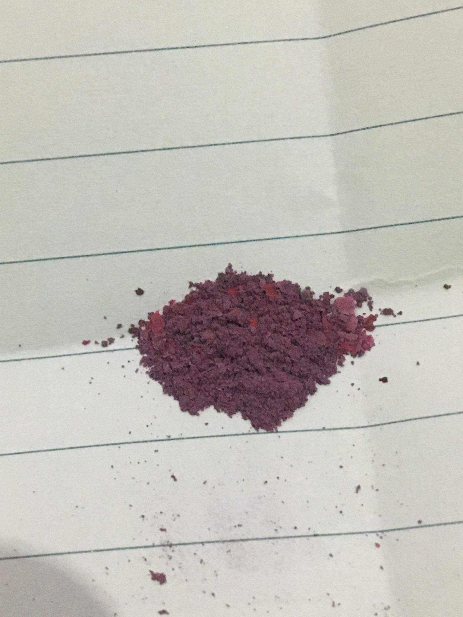

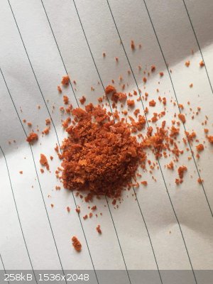

Lithium violurate
received_3396237413810175.jpeg - 258kB

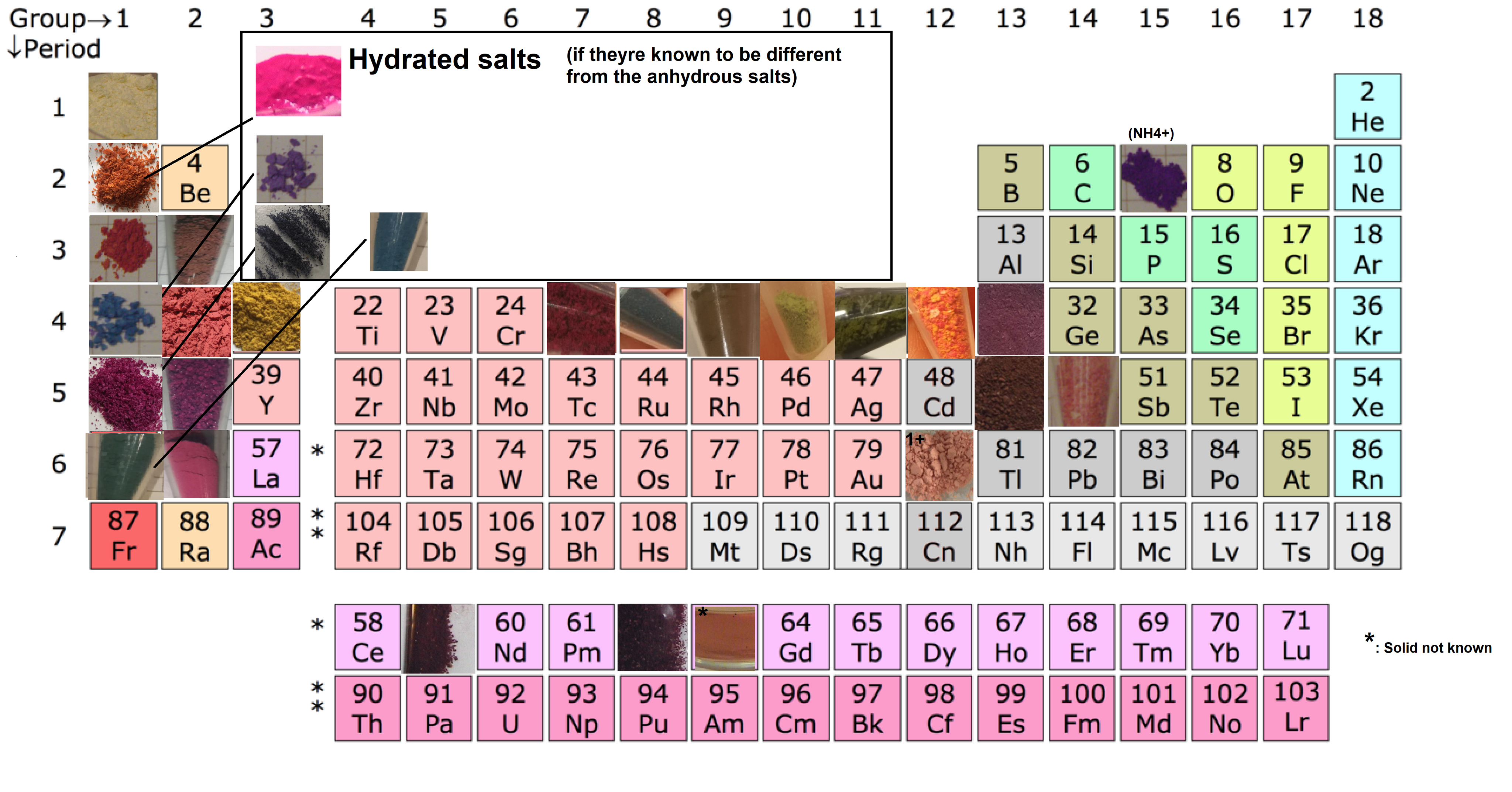

Since there have now been so many metal salts made, i put together a periodic table . There is still a lot of them to be made :)
group 1 is complete!
for group 2 only beryllium is missing.

samarium14
Posts: 661
Registered: 22-3-2019
Location: Georgia
[*] posted on 27-3-2021 at 08:23
Perfect. I have beryllium i will make it

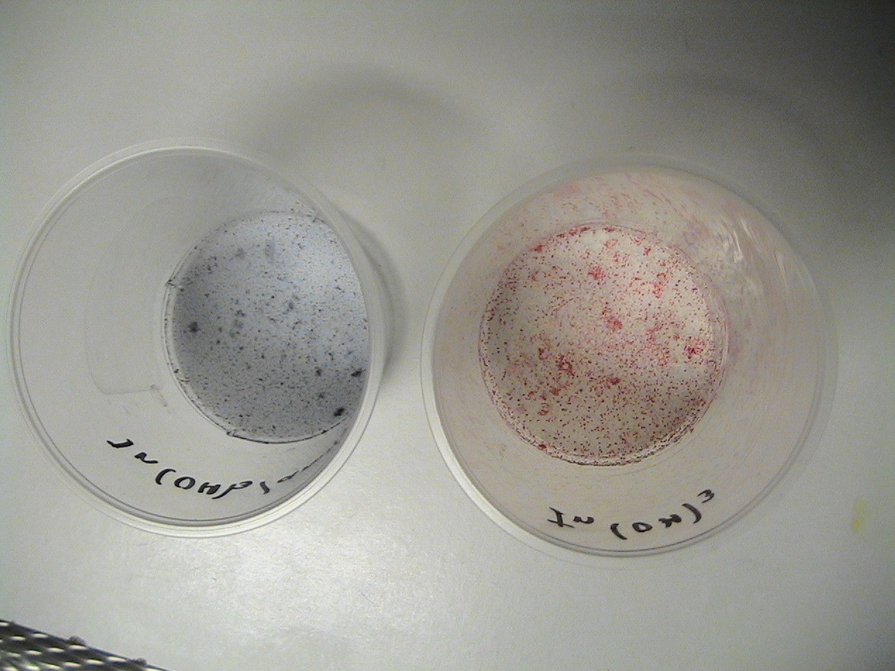

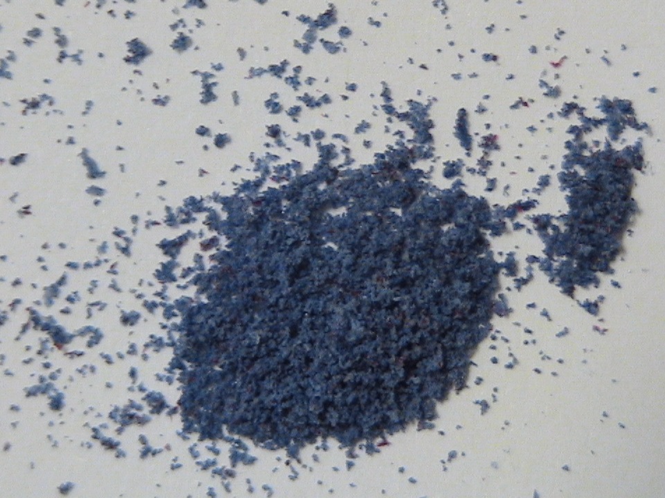

[*] posted on 27-3-2021 at 16:01
Indium
It seems that indium is chemically too basic to easily form a salt with violuric acid. My estimate is that this will count all the more for Re, Mo and W. I decided that I will not make the uranyl salt, because of the precautions necessary to safely work with it. I consider cerium, which is interesting because it is a coloured RE and also has a stable +IV oxidation state, and aluminium.
I did it easily, dissolving the carbonate in acid
I find it odd to say the least that the carbonate dissolves easily, whereas the hydroxide takes quite some time to fully dissolve. In particular, my hydroxide was not heated and was always in a liquid, so it never dried. It should be easily reacting.
Quote: Originally posted by RustyShackleford
Shame that the indium didnt form a solid, the solution looks real nice though. Also im quite suprised the Sm and Pr are so similar in color, from all the other salts i woulve expected a bigger difference. They both look quite nice though, thank you for taking the time to produce the salts and post pictures!

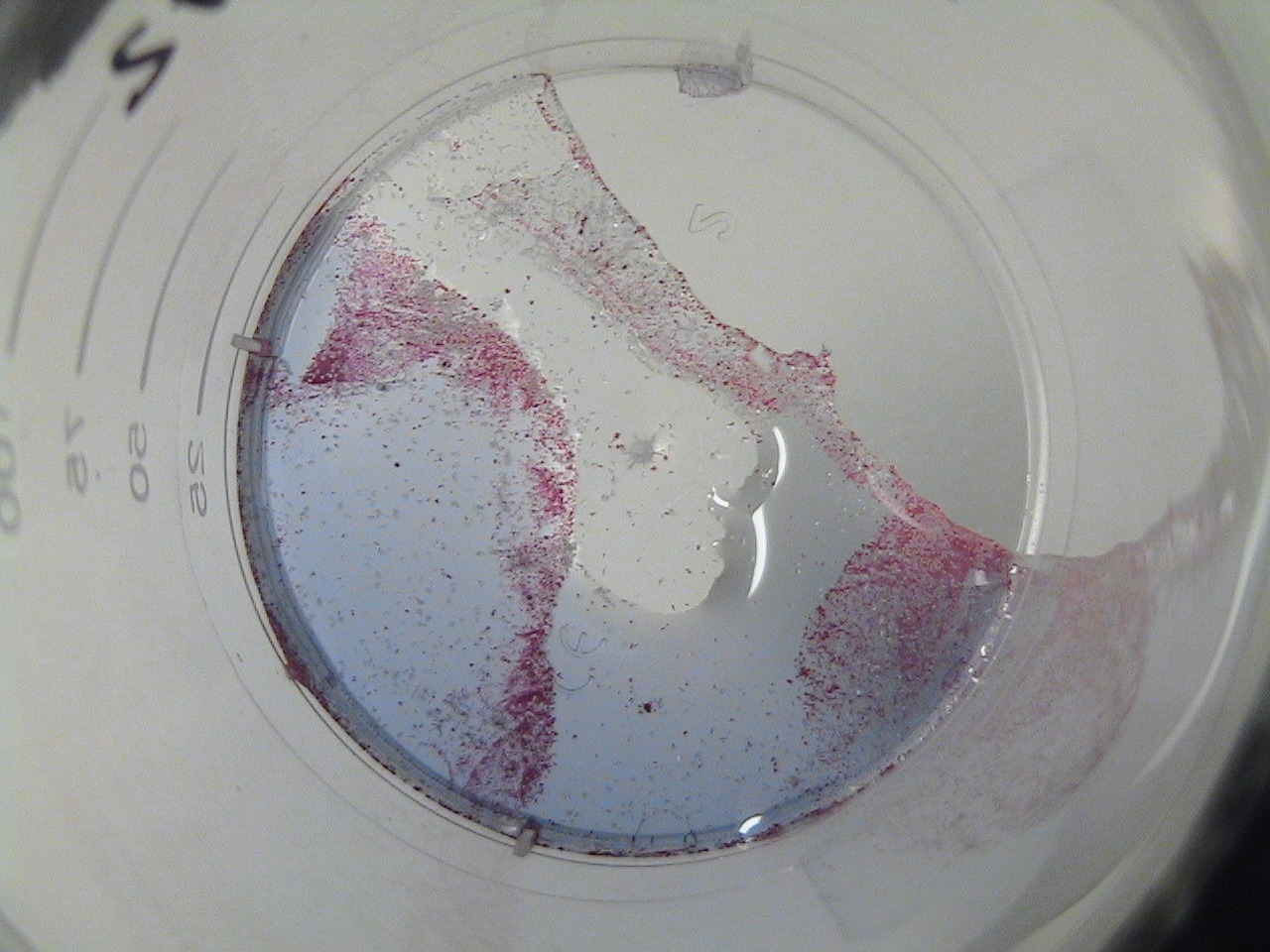

It did form a solid. Two, actually. After filtering off the excess of indium hydroxide, the solution first gave a crop of bright red coloured crystals, while the solution turned from purple-blue to a deep dark blue.
IMG_3674_adj.JPG - 375kB
At one point I noticed that no more crystals appeared, although more of the liquid had evaporated. I then poured off the blue liquid and continued to evaporate the dark blue liquid over NaOH (as before). When almost no liquid had remained, dark blue crystals formed. When standing longer in the desiccator, they turned off-white, like the colour of violuric acid itself. On standing outside the desiccator for a few days, the dark blue colour came back. The photo below shows the red and blue compounds I obtained.
IMG_3704_adj.JPG - 314kB
I was unsure whether the blue or red compound maybe was ammonium violurate, since I used ammonia to make the indium hydroxide. To double check, I took the indium hydroxide which had not dissolved in the experiment. It was rinsed on a filter, until almost all of the colour from the dark blue liquid had washed out. A spatula tip of violuric acid was added to the washed hydroxide and water was added to obtain a purple solution. After stirring on a 70C hotplate for 1 hour, the colour had darkened to a more intense purple. The mixture was poured into a pointed flask to let the residue settle.
IMG_3695_det_adj.JPG - 156kB
The purple liquid was evaporated in a desiccator over NaOH, as usual. To my surprise, this time also red crystals and a blue solution were obtained, just as in the first experiment.
IMG_3730_adj.JPG - 316kB
I don't believe that either the red or the blue compound is an ammonium compound, but I haven't done any testing.

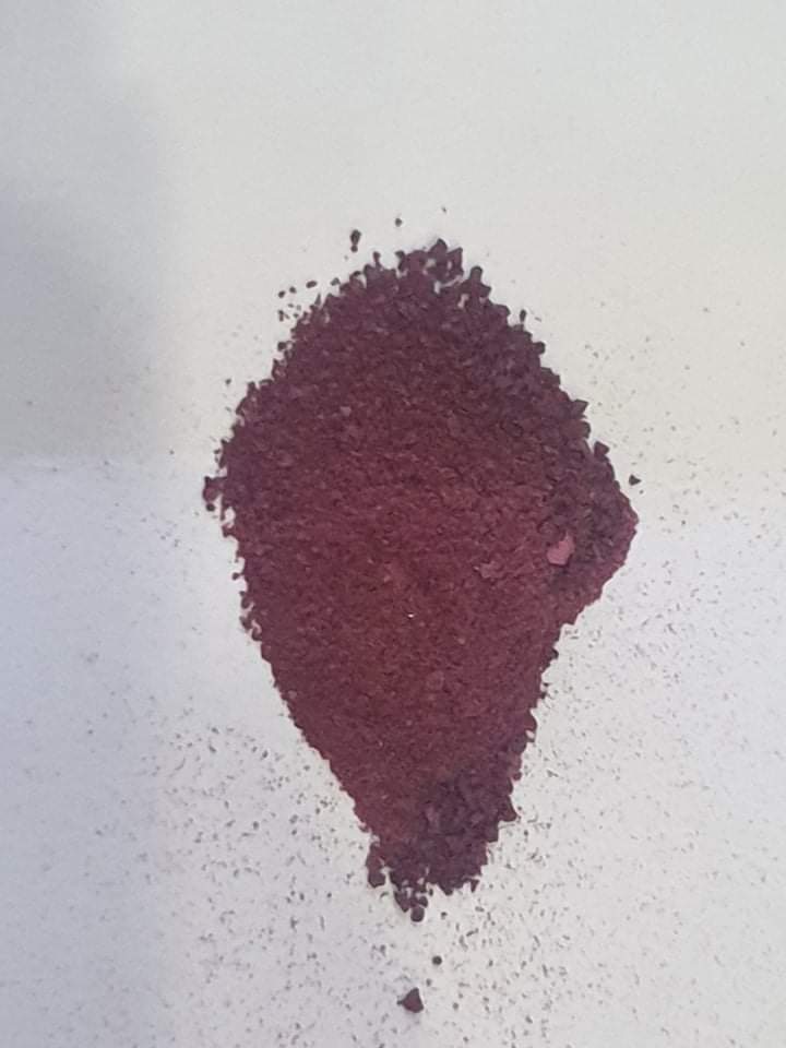

Thanks. This is indium violurate. Brown- dark red colour. I used indium carbonate. Carbonates are better.

Could it be that you have a mix of the red and blue solids I got? Is your sample anhydrous?

[*] posted on 27-3-2021 at 22:02

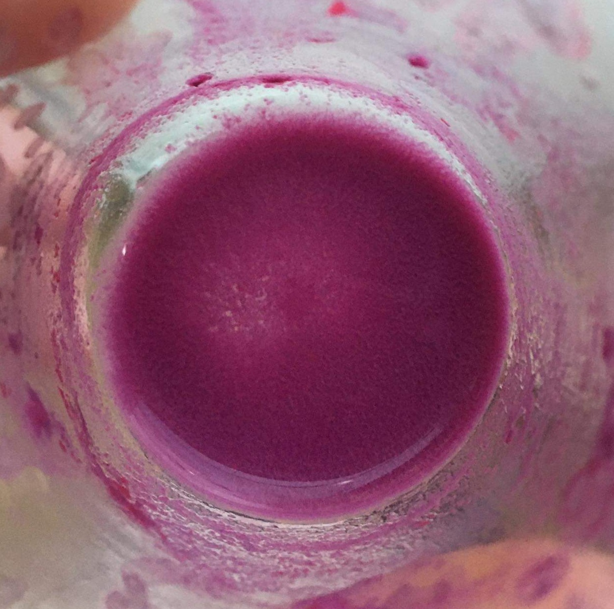

I had indium nitrate solution and i made carbonate from it. Also some metals for example indium produce hydroxyindates and this is why I prefer carbobate. I also avoided the presence of other cations in the solution as much as possible

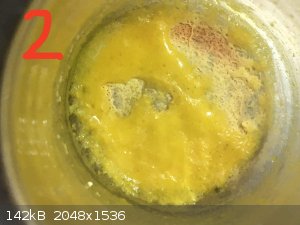

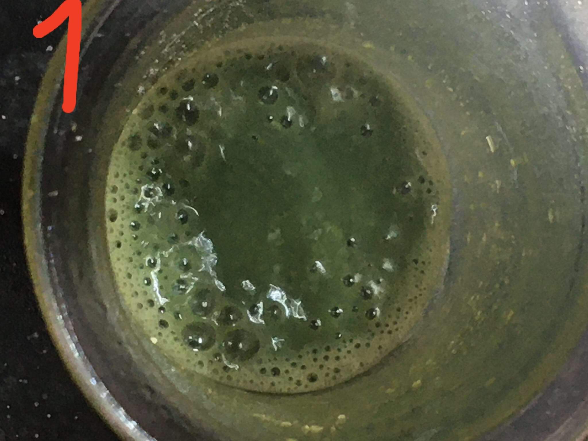

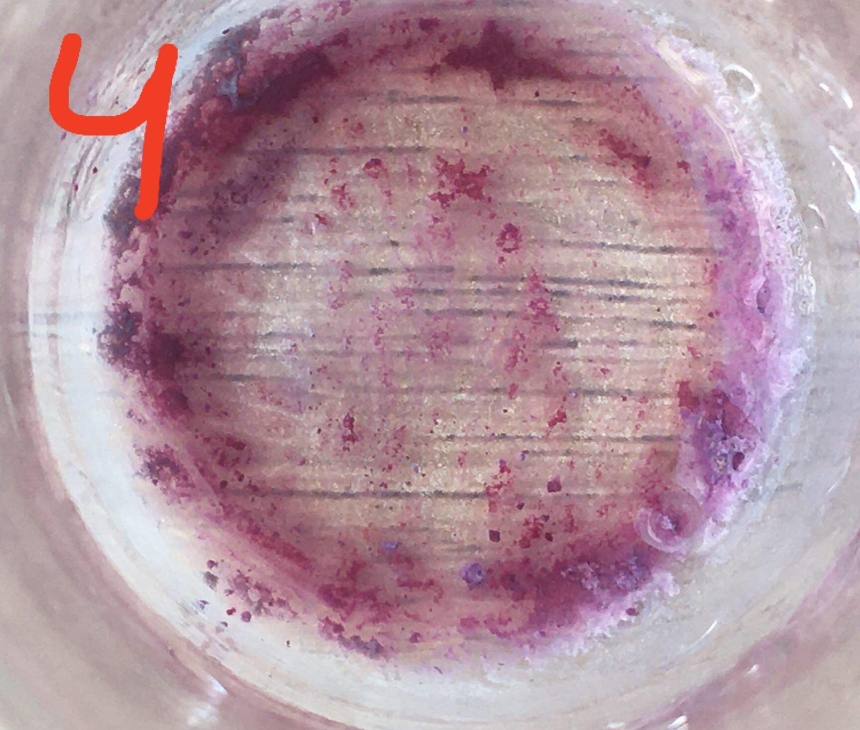

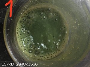

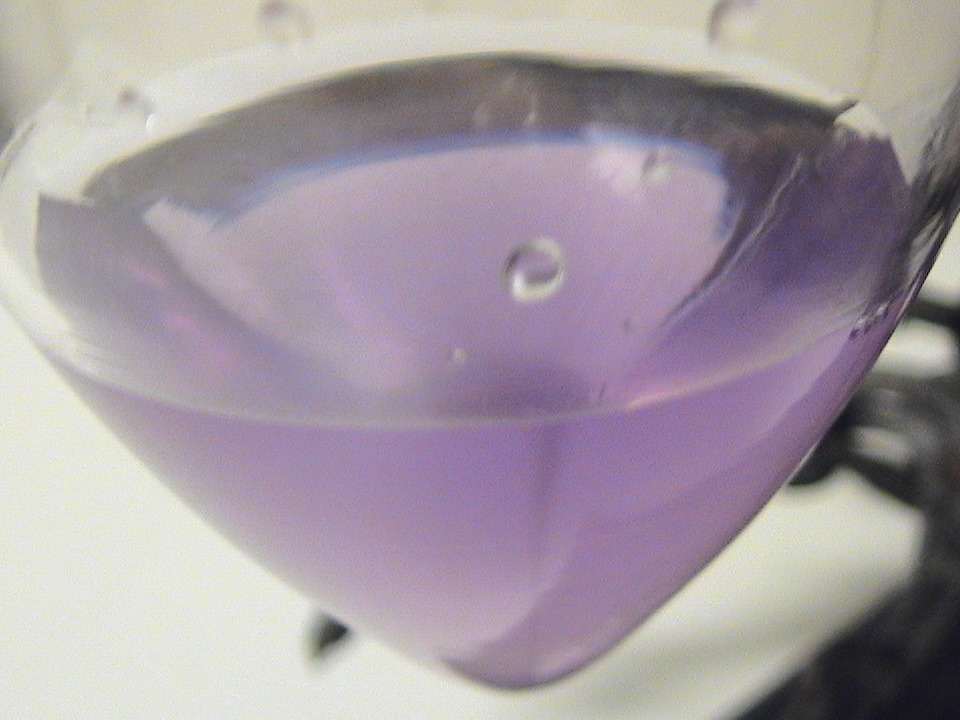

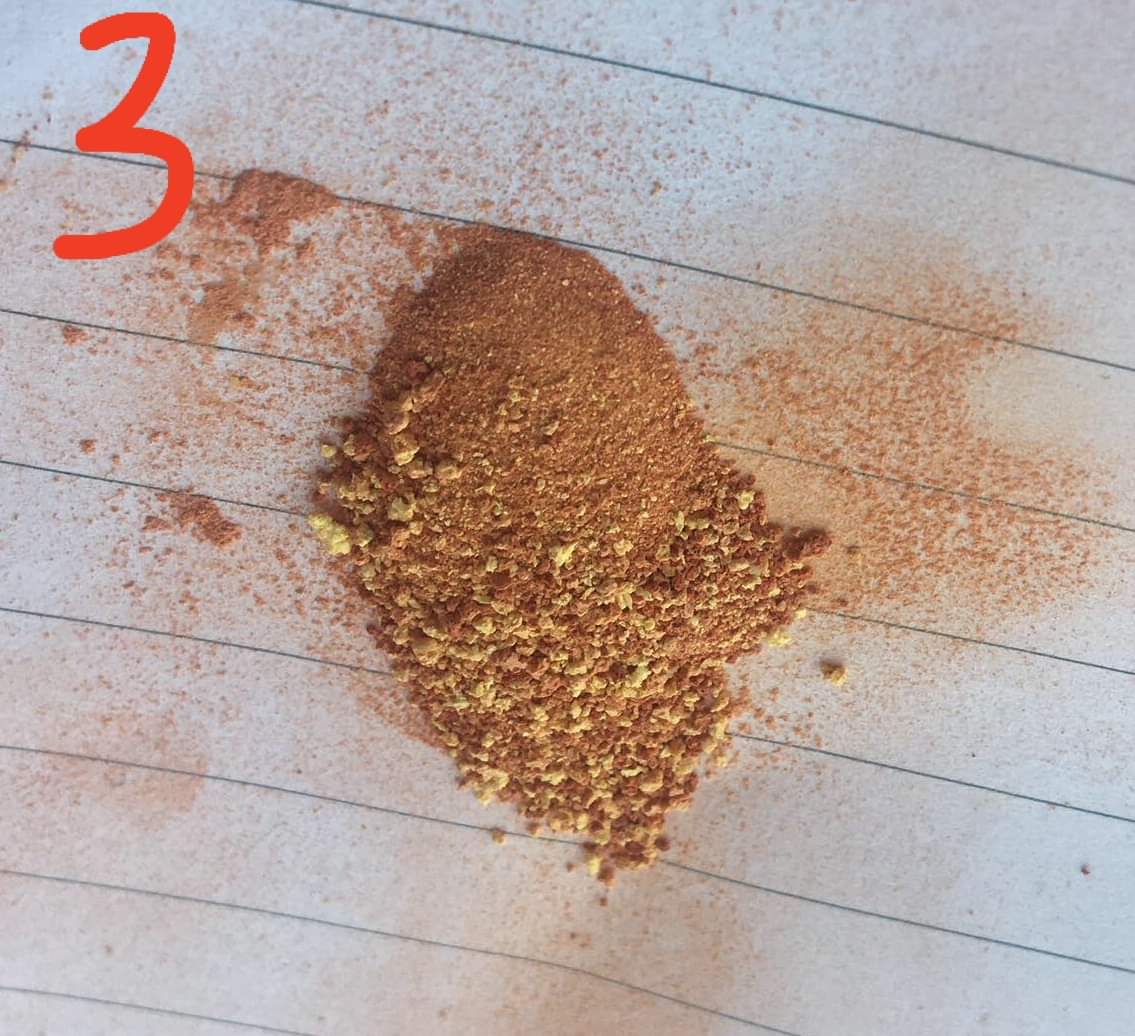

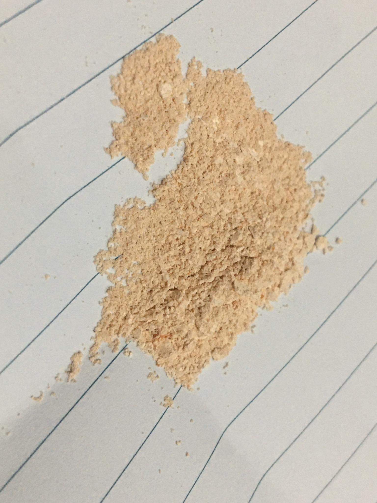

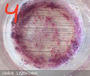

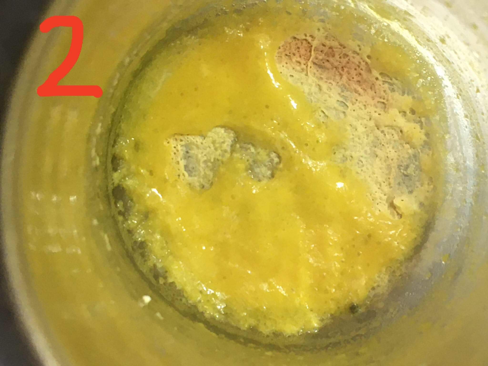

[*] posted on 30-3-2021 at 03:47
Beryllium violurate.
1)Solution was green
2) hydrated salt was yellow
3) anhydrous is brown
4) When I finished synthesis, I decided to wash the flask, but when I poured water it turned purple. It's pretty weird.
received_135842071808916.jpeg - 157kB received_920649712034662.jpeg - 142kB received_444734296750483.jpeg - 140kB received_560091088240420.jpeg - 184kB

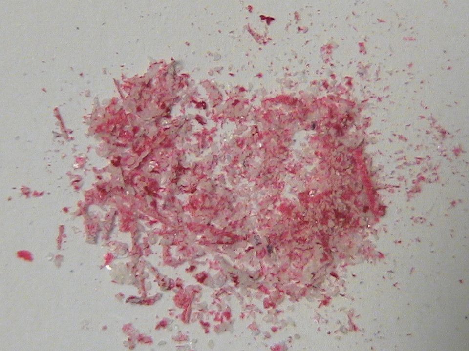

[*] posted on 30-3-2021 at 07:53

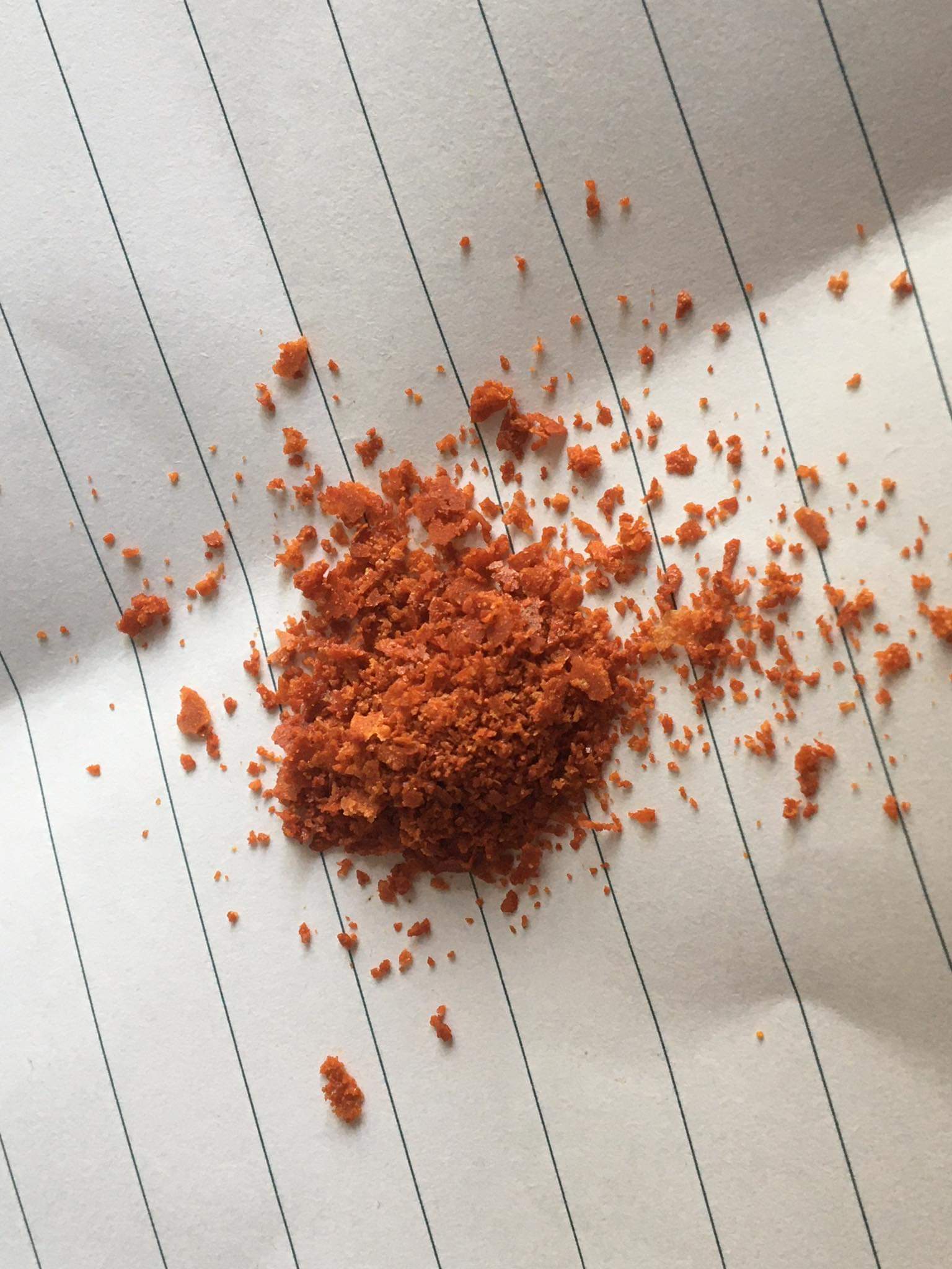

Silver violurate. Solution and anhydrous. I think red particles are hydrates.
PicsArt_03-30-07.49.33.jpg - 324kB received_878483599379459.jpeg - 189kB
Posts: 4751
[*] posted on 30-3-2021 at 08:40
Beryllium is a strange element. It doesn’t follow the same trend as other alkaline earth metals. Its compounds are covalent rather than ionic, and readily undergo hydrolysis. Most, if not all, of the pictures that you posted are probably not “beryllium violurate” in the sense that you’re describing.
samarium14
Posts: 661
Location: Georgia
[*] posted on 30-3-2021 at 09:06
Yes you are right. I think 4 is hydrolyzed compound.
Bedlasky
Posts: 1253
Registered: 15-4-2019
Location: Period 5, group 6
Mood: Volatile
[*] posted on 30-3-2021 at 09:07
I think that green and yellow colours are due to some complex formation. Hydrated salt is purple according to behavior in point 4.
How can you be so sure that silver salt is anhydrous? Red colour can be caused by different particle size.
samarium14
Posts: 661
Location: Georgia
[*] posted on 30-3-2021 at 09:12
The color changed and faded. We have talked about the size and color of the particles before, in this case the red particles were on the walls of the flask, while the dark bottom, i.e. the red, lost less water.

[*] posted on 30-3-2021 at 09:16
I think its hydrolyzed. I may try to make hydrate in the future as well. This time bivalent mercury and cadmium are in the queue.

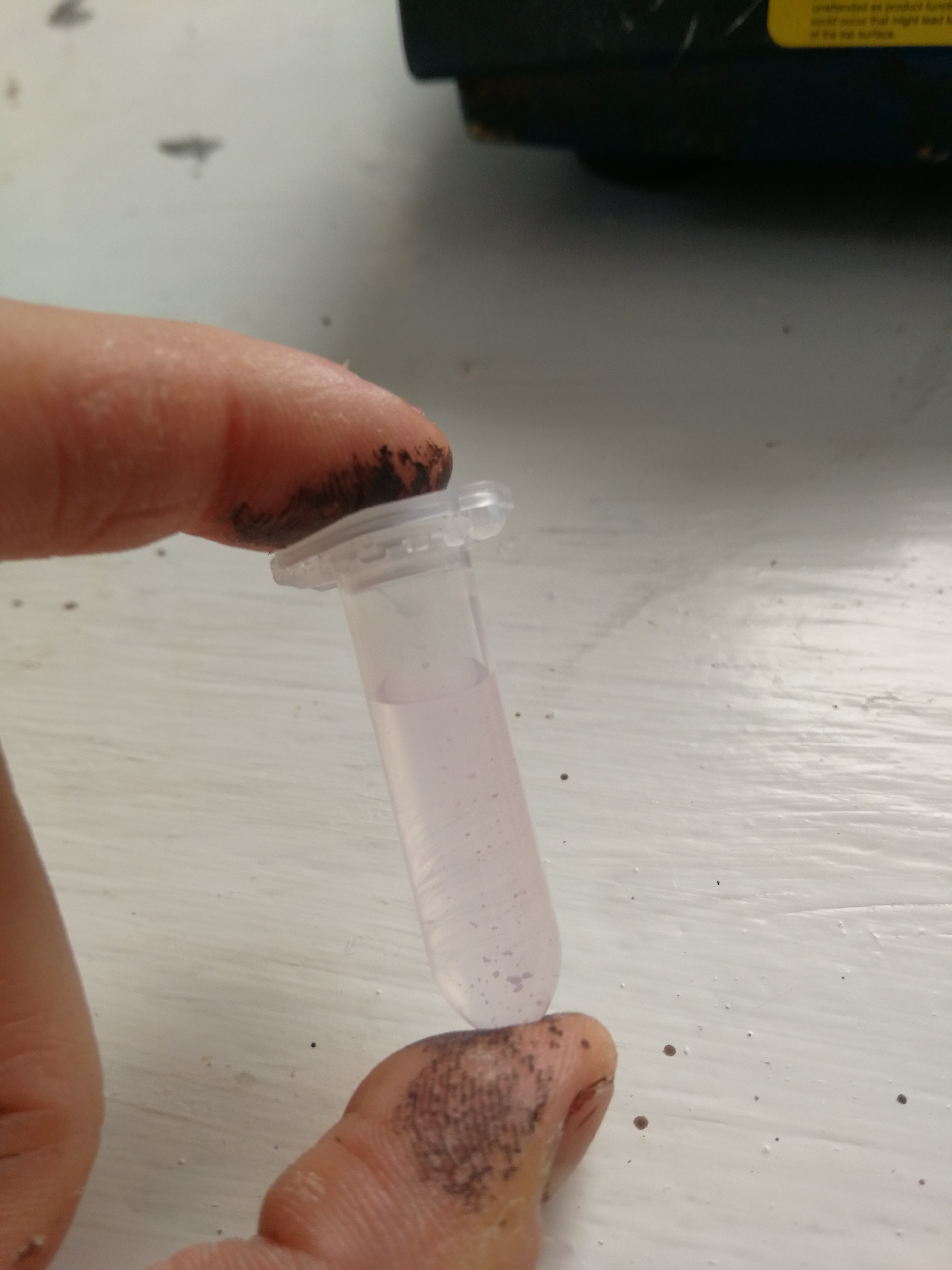

[*] posted on 31-3-2021 at 09:43

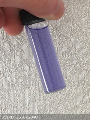

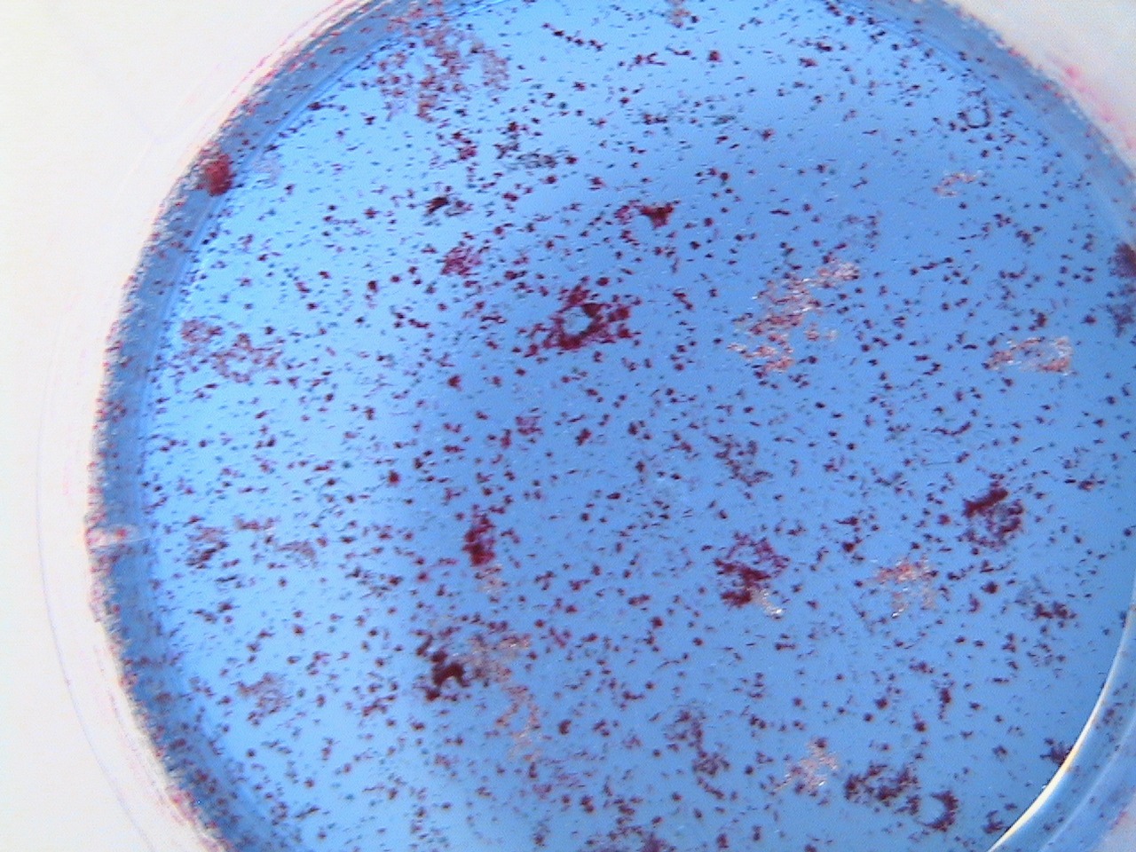

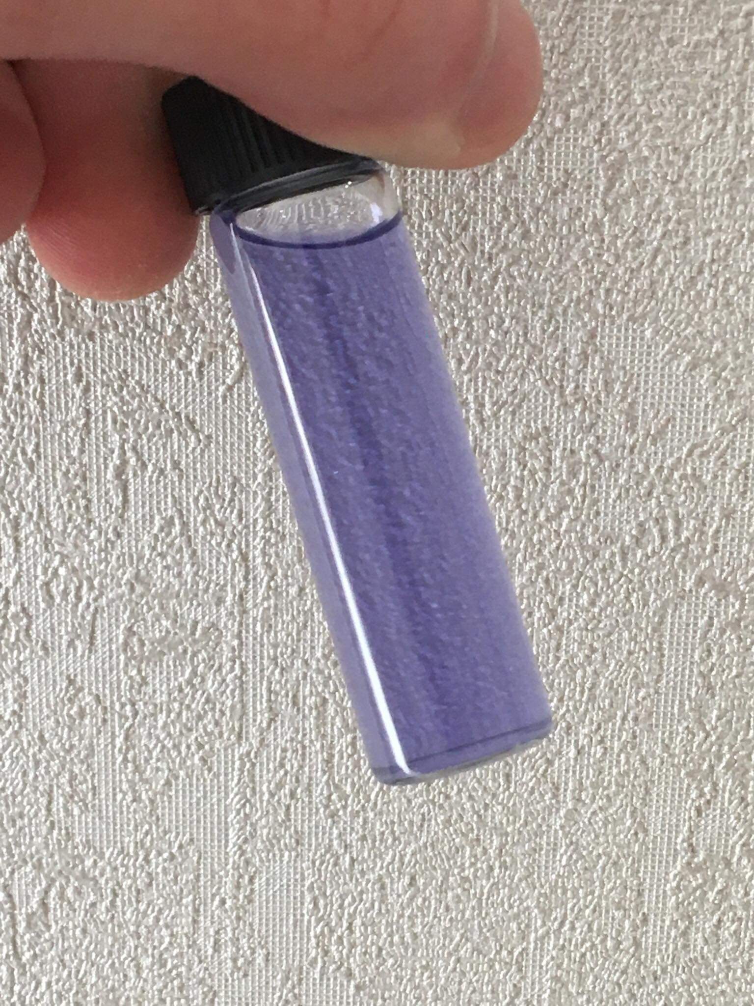

Just dilute solution of the acid
There were acid particles on the walls of the package. I added water and got this color, then poured it into a vial. The color is well visible on a white background. I think the sharp change in color during hydrolysis is also caused by this.
received_1176326226136615.jpeg - 252kB received_487190279134709.jpeg - 351kB
RustyShackleford
Posts: 202
Registered: 10-12-2020
Location: Northern Europe

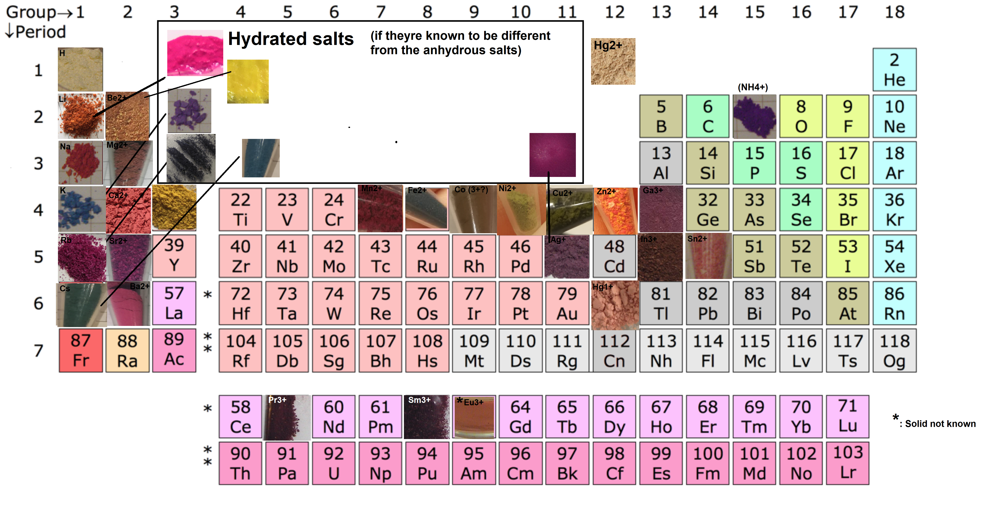

[*] posted on 1-4-2021 at 07:48
Strange, I just tested dissolving some of the very same batch i sent you and its an almost completely clear solution, slight hint of pink (likely some residual sodium contamination). Perhaps you used a metal spoon or a contaminated plastic one at some point, or maybe the baggie i sent had some contaminant dust on the inside.
IMG_20210401_173534.jpg - 730kB
Also here is the updated perodic table of violurate salt.
Thank you Vano for your tremendous contribution!
periodic.png - 4.3MB
[Edited on 1-4-2021 by RustyShackleford]

[*] posted on 1-4-2021 at 09:07
Thank you! It was a good experience. I have never used metal spoon. I always pour the powder directly from the package onto a sheet of paper. If this was caused by the plastic, since it was inside for a long time, then it is interesting. I rule out the presence of sodium ions in the solution as I have not used any sodium compounds.
Did you spill silver nitrate on your hand?
[Edited on 1-4-2021 by vano]
RustyShackleford
Posts: 202
[*] posted on 1-4-2021 at 09:12
yes haha, ive been purifying some teeth amalgam powder recently, i think i touched the inside of the beaker while washing it.
samarium14
Posts: 661
Location: Georgia
[*] posted on 1-4-2021 at 09:28
:D. Once almost half of my hands became black, in the past I was very fond of separating pure silver from alloys. You know there are ways, but from personal experience it takes about 4 hours to put your hand in the water to remove the black layer from the skin.

[*] posted on 1-4-2021 at 16:17
I consistently get the same results. I use a nickel spatula, but I can hardly believe that nickel oxide would indeed react with the violuric acid.
Great - thanks Rusty!

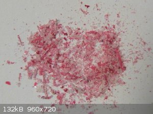

In the meantime I prepared aluminium violurate, which is another medium red compound, and reddish pink in solution (photos to follow).
I also retested the indium compounds I obtained and it gave me the same results as before. First a crop of red crystals is deposited and after this has stopped and the solution is left to crystallise in a separate beaker, a crop of blue crystals is formed. On re-dissolving these red and blue compounds, the same red and blue compounds are formed, so they do not exists in equilibrium with each other. Together with the red compound, some violuric acid also seems to crystallise out. My guess is that I obtained basic indium compounds and that vano has obtained the normal, non-basic indium violurate.
IMG_3775_adj_detail.JPG - 132kB IMG_3772_adj_detail.JPG - 219kB
