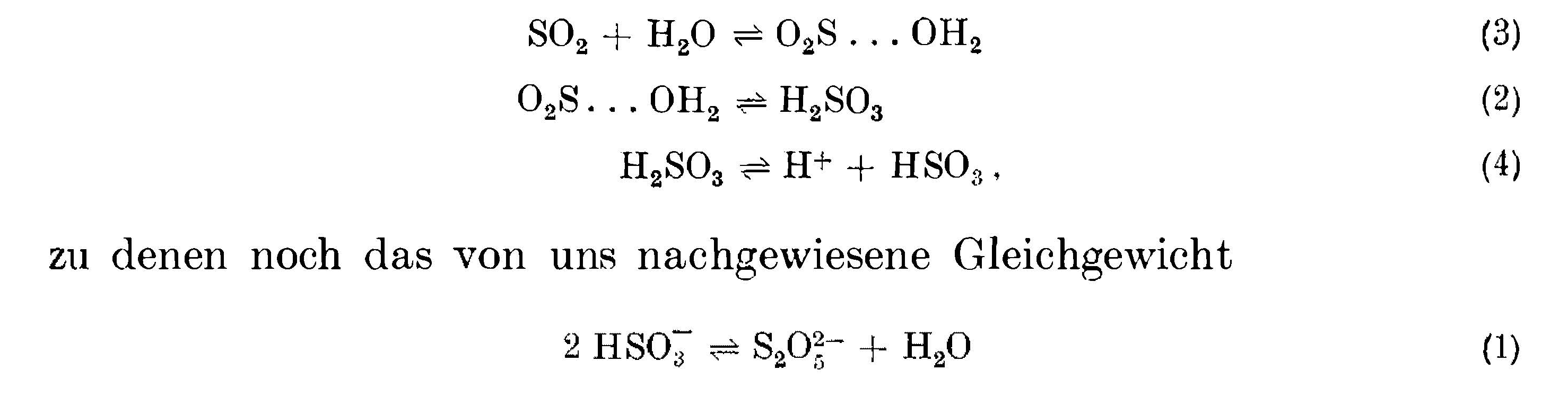

P.S. The equilibrium 1)-3) is not quite right for the understanding of the solution mechanism of SO2 in H2O.
According to spectroscopic study of water by Simon & Waldmann (ZAAC publication in 1956) there are 4 detectable equilibriums:
Here O2S...OH2 is some hydrated form of SO2.
[Edited on 24-2-2026 by teodor]

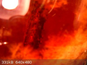

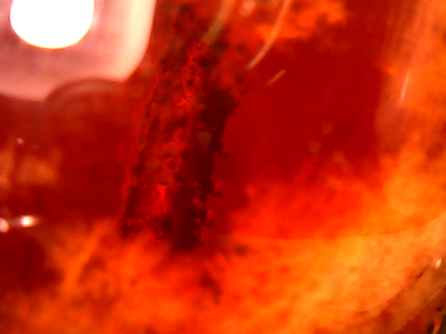

Control reaction test: This post is attempt at an electrolytic displacement reaction to get sulfite ions in solution and remove (most) sodium atoms.
Question: Is a tan-yellow color consistent with a titanium sulfite salt ?
What I did:
1st step, see if titanium would dissolve in a chloride salt or produce a passive chloride layer/anodization:
~1 [cc] melted calcium chloride (dry z-air ) roughly pentahydrate.
1/2 [cc] Methyl sulfonal Methane ( hopefully inert )
1 [cc] kerosene.
Melted at 125 [°C] ran 80 [mA-AC] + 4 [ma-DC] through a titanium electrode and a graphite electrode. This slowly produced a green colored solution
and the titanium electrode dissolved in certain places (deep pitting) rather than evenly.
The MSM would melt when at the bottom of the test tube and recrystallize as a colloid when cooler. This was a bit disappointing. I added alcohol to
see if color changed, it didn't.
I am reasonably confident the green color is hydrated titanium chloride.
I did not see any calcium hydroxide building up on the cathode as I expected.
Calcium hydroxide is not very soluble.

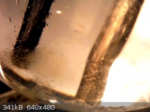

2nd step, I decided to use a weaker chloride salt, with a sulfite mixture, to get a displacement reaction going and hopefully cause
precipitation/electrodeposition of low-solubility alkali-metal hydroxides.
0.1 [cc] -- Sr·Cl₂ ( partially dehydrated from hexahydate, using microwave heating )
0.5 [cc] -- 1,3 propan-ol
0.1 [cc] -- 1,2,3 propan-ol
1 [cc] -- kerosene
The strontium chloride totally dissolved into the alcohol, which means it wasn't completely anhydrous.
Add:
1 [cc] -- ethyl-citrate, inert dilutent.
At first the solution separated into a trilayer, with salt/alcohol at the bottom, ethyl citrate in the middle, and kerosene on top.
I then added 0.1 [cc] of sodium meta-bisulfite.
This sank to the bottom and did not dissolve.
I melted salts together at 125 [°C], and allowed to sit until bubbling/steaming stopped.
The sodium meta-bisulfite expanded but did not dissolve appreciably.
I then put a titanium electrode into the metabisulfite, and a graphite electrode into the ethyl citrate. I ran 20 [mA-AC] and 4 [ma DC] with
graphite as nominal cathode.
Immediate bubbling started at cathode, with initial build up of black residue (water caused, undoubtedly) on cathode. With time residue became grey,
and then white. I'm hoping this is strontium hydroxide or alkoxide.
The solution did not turn green, but instead is turning yellow-tan.
So, I don't have 'hydrated' titanium chloride, this time.
Not sure what causes the yellow complex color, but it might be a sulfite salt with titanium which was my goal.
My hope, here, is that NaCl is not very soluble in 1,3 propanol and will stay at the bottom with un-dissolved sodium meta-bisulfite because of common
ion effects; If so, then I should get dissolved Titanium to displace Strontium in solution; eg: leaving a Titanium chloride-sulfite solution in
alcohol.
I'm thinking I succeeded, but I'm not sure how to verify my result.
semiconductive
Posts: 438
Registered: 12-2-2017
Mood: Explorative
| Quote: | Do you familiar with Richard Feynman's theory of electroplating?
View user's profile |
I'm familiar with everything in his lectures on physics books, and also I know about "plenty of room at the bottom" being attributed to him. But,
I've never heard of a 'theory' of electroplating from him. Rather, I know he worked at a company that used electroless methods to deposit metal on
plastic, and then plated the result. He improved their process. eg:The problems he dealt were mostly centered around "making it stick" but when he
left, they made silver pens that 'blistered'.
eg: The company sort of failed without him there...
why?
[Edited on 8-3-2026 by semiconductive]
semiconductive
Posts: 438
Mood: Explorative

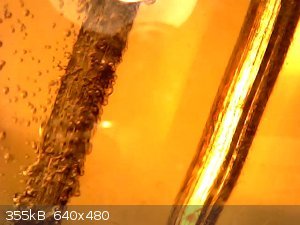

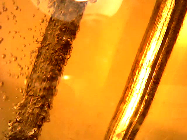

I'm going to see if I can get the yellow color with just a chloride. If I can, then it's not necessarily the sulfite which is acting as a ligand.
1 [cc] - 1,3-propan-ol
0.1 [cc] -- granular Ammonium Chloride
Titianum anode + Graphite cathode, 0.5 [mA D.C.] + 10 [mA A.C.]
Heated to 127.5 [°C] at bottom of test-tube, under 1 [cc] kerosene.
Very faint color change noticed as ammonium chloride dissolves (slowly).
After an hour:
Add 0.2 [cc] 1,2,3-propan-ol
Rapid dissolve of remaining few crystals of Ammonium-Chloride.
Lemmon Yellow color immediately begins to show up in the liquid, not the same tan shade as before.
So, yes -- there is more than one reason the yellow color might be forming.
Weird Note: Slow electro-deposition of silvery substance is beginning on graphite cathode.
I think the temperature, 127.5 [°C] is too low to form significant amounts of acrolein by dehydration. If acrolein is forming, then something has to
be acting as a catalyst, and I wonder why it doesn't smell bad.
On the other hand, it's pretty obvious that the yellow substance is produced most easily from 1,2,3-propanol.
Doing some research at ACS -- I think there are two ways for 1,2,3-propanol to break down without oxygen burning it:
Either I get, vinyl alcohol + formaldehyde: CH₂=CH-OH + CH₂=O
Or, I get water + Acrolein: H₂O + CH₂=CH-CH=O
Vinyl alcohol will tautomerize into more stable acetaldehyde in around a half hour. The odor of acetaldehyde is supposedly like green apples.
When I smell the test tube, I do get a weird odor that is reminiscent of fruit and sugar. It could be apples or cookies. It's not a really bad
smell, like acrolein is supposed to have.
I'm also sure that trace amounts of fomaldehyde, acrolein, or water will slowly boil out of solution.
Of the possible decomposition products, the only substance that is said to be yellow is polymerized acrolein. A little more research shows that
polymerized-acrolein reacts like an aldehyde. Therefore, polymerized-Acrolein would form an adduct with sodium meta-bisulfite even though pure
acrolein would not.
That's consistent with what happened in an earlier experiment in this thread. Polymerized Acrolein's presence is not ruled out just because the
yellow color fades when sodium-metabisulfite is added.
I am going to let the heated test-tube sit for a few days and see if the yellow precipitates. Acrolein polymer supposedly becomes insoluble (with
time).
But: Permanently dissolved yellow likely indicates a complexing color.
eg: Vinyl alcohol apparently easily complexes metals.
Vinyl complex of titanium dioxide is supposedly blue, though. But I don't see references explaining what non-oxidized titanium's color ought to be.
