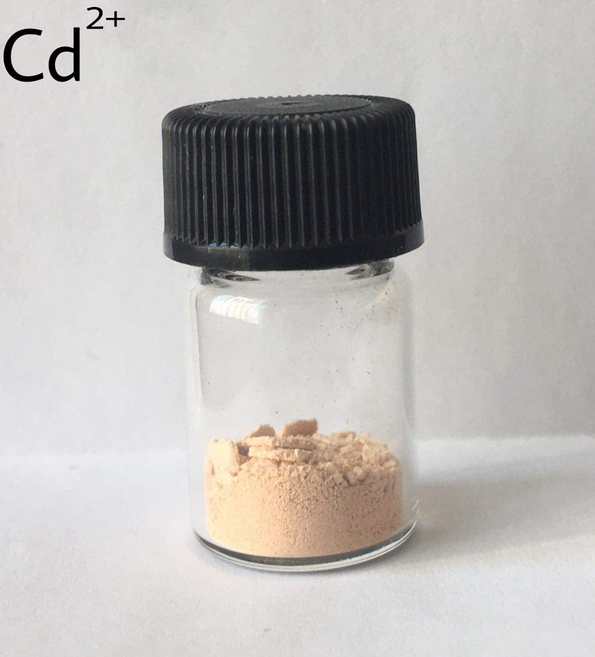

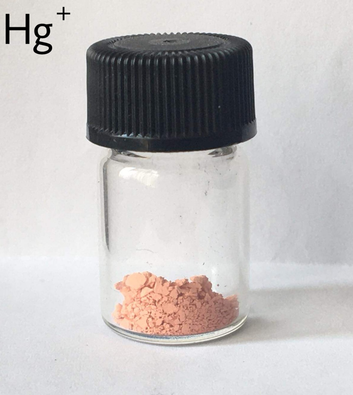

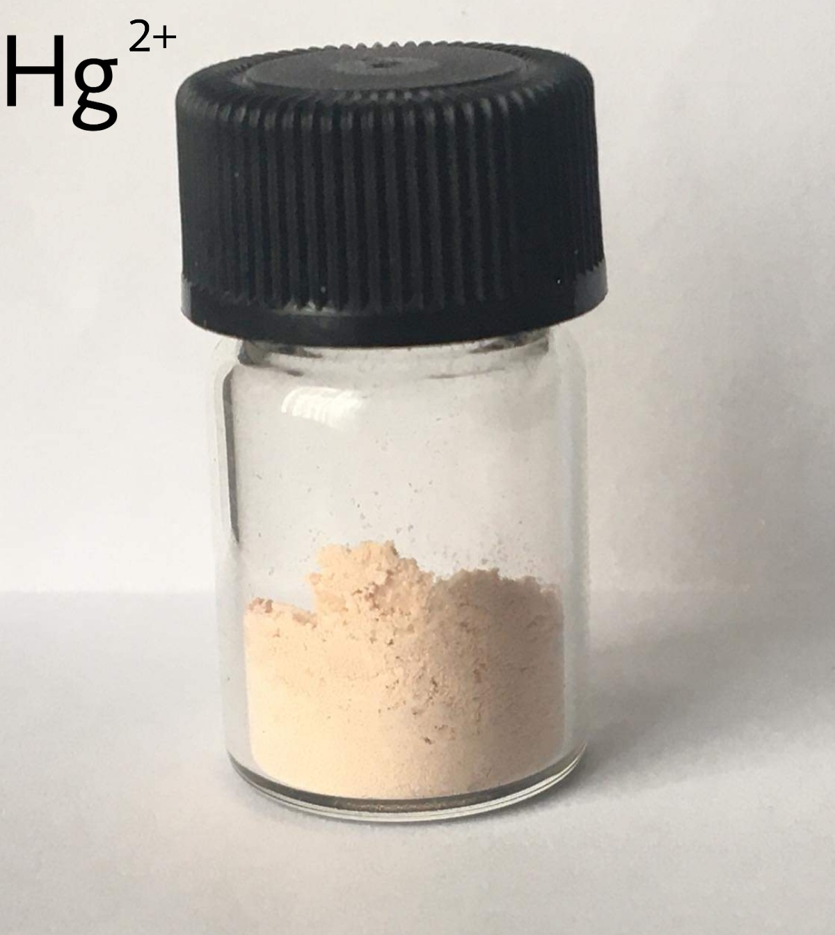

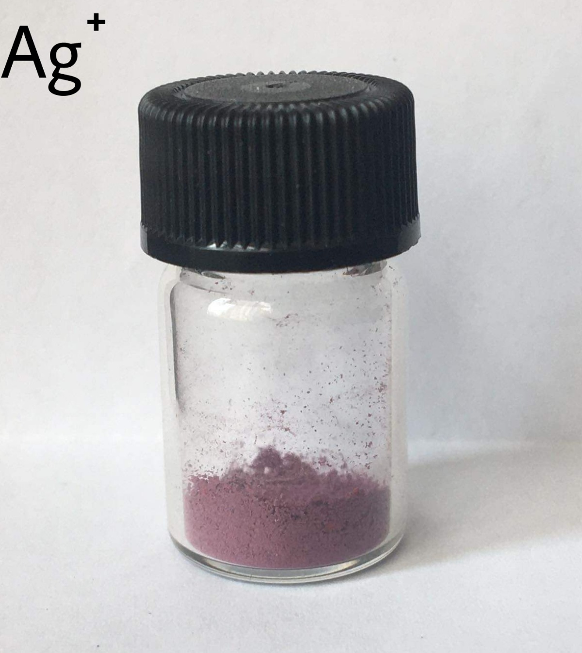

Hi. These photos are better. Last one is new (cadmium violurate). Unfortunately the indium violurate powder was spilled. I have so little right now that it is nonsense to stuff it in a vial.
PicsArt_04-02-01.21.02.jpg - 211kB PicsArt_04-02-01.23.48.jpg - 196kB PicsArt_04-02-01.22.28.jpg - 213kB PicsArt_04-02-01.19.15.jpg - 188kB PicsArt_04-02-01.17.38.jpg - 211kB PicsArt_04-02-01.15.33.jpg - 214kB PicsArt_04-02-01.14.00.jpg - 191kB PicsArt_04-02-01.39.50.jpg - 202kB

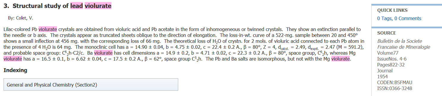

Haven't seen lead mentioned, so here is some. Made from about 0.11 g of the sodium salt (dihydrate) and about 0.17 g of lead acetate trihydrate, from mixing the two as solutions (added lead to the violurate). Instant precipitate from the warm solution, but no complete discoloration. Filtered, washing water was colorless. A portion was dried at about 180 °C on a hotplate.
Left is the tetra/pentahydrate (still a bit wet), right anhydrous
lead_violurate_tetra_or_pentahydrate.jpg - 2.3MB lead_violurate_anhydrous.jpg - 2.2MB

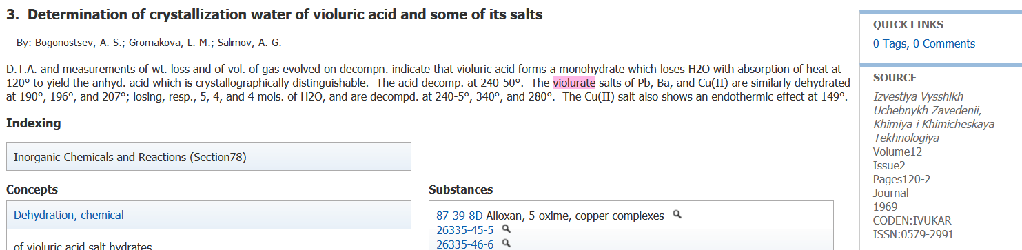

Didn't find much information, and some conflicting on the hydration. Can't access the original source so I'll attach the scifinder screenshots.
Screenshot 2021-04-02 095035.png - 66kB Screenshot 2021-04-02 095215.png - 71kB

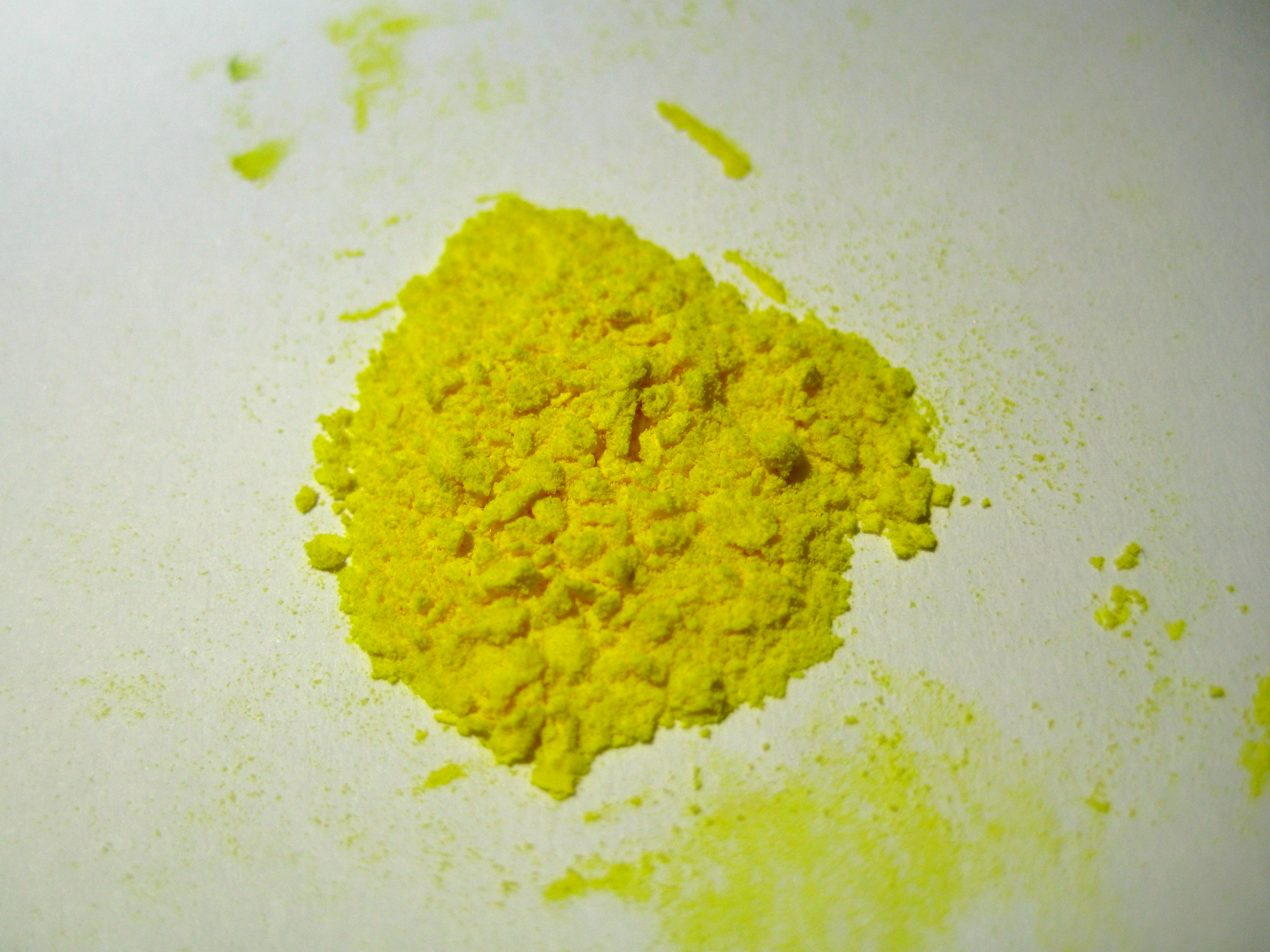

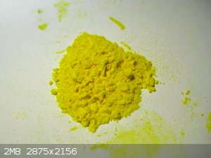

Yttrium is generally not very interesting, but it's violurate is brightly yellow.
I dissolved about 0.5-0.7 g of violuric acid monohydrate (mine was freshly made and still wet so I don't know exactly, it's an excess of over 3:1 to the yttrium used however) in 50 mL of boiling 95% ethanol - had some insoluble grey-brown stuff so I filtered that off. To that solution was added about 0.25 g of YCl3 (it should be noted that YCl3 is very hygroscopic and mine was slightly wet so this amount is also lower than I measured out here) in about 1 mL of water to the boiling ethanol solution while stirring. It turned yellow and after about a minute of strong stirring and boiling the solution became turbid, it was boiled for five minutes longer and left to cool until luke warm. The yellow precipitate was vacuum filtered off and washed with some 95% ethanol. The solution that passes through is slightly yellow and deposits only small amounts of additional precipitate with more yttrium chloride solution. The solid was then air dried. Yield was about 0.166 g. (Because this was all done a bit sloppy I didn't bother to calculate a % yield.)
[YVio2(H2O)2]Vio+6H2O.jpg - 2MB
The product is of the composition [Y(Vio)2(H2O)2]Vio · 6 H2O where HVio is violuric acid.
The preparation comes from Gad, A. A. M., Farag, I. S. A., & Awadallah, R. M. (1992). Synthesis and Characterisation of Scandium (III)-, Yttrium (III)-, and Lanthanum (III) Violurate Complexes. Crystal Research and Technology, 27(2), 201–210. doi:10.1002/crat.2170270210
Attachment: gad1992.pdf (421kB)
This file has been downloaded 510 times

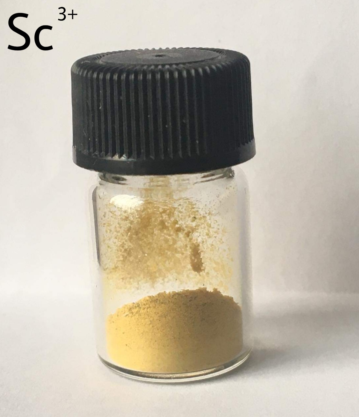

Nice. Now there are two yellow violurates Sc and Y. Where did you buy yttrium chloride?

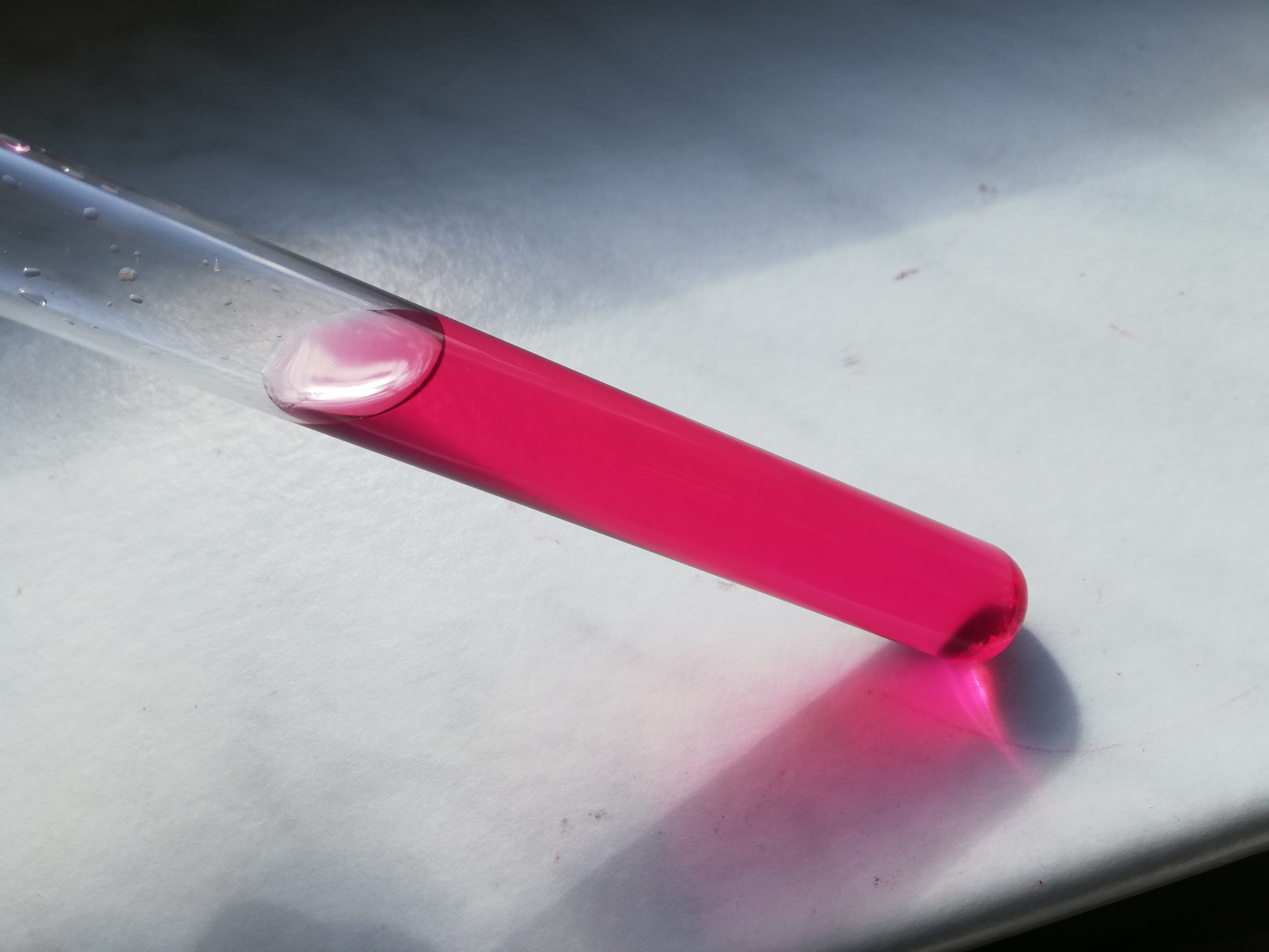

I found no literature on bismuth violurate, so here is a small test tube scale experiment. It seems fairly soluble.
Some bismuth nitrate pentahydrate was dissolved in some water with some sulfuric acid (bismuth hydrolyses to basic salts with annoying ease...), to this some sodium violurate solution was added. The color turned orange. When acetic acid and sodium acetate were added, the color became purple. Whether this is because the sodium is competing with the bismuth or something else, I am not sure, the color is somewhat different from pure sodium violurate however, which is more purple. If anyone wants to prepare the solid, I would suggest using a bismuth oxide/hydroxide and the free acid since I didn't get precipitation.
IMG_20210403_112718.jpg - 2.3MB IMG_20210403_112934_1.jpg - 2MB

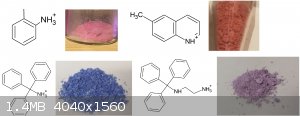

ortho-toluidine violurate, this one I did as a proof of concept in a very small unmeasured scale, I will now make more to vial up.
o-toluidinevio.jpg - 1.3MB

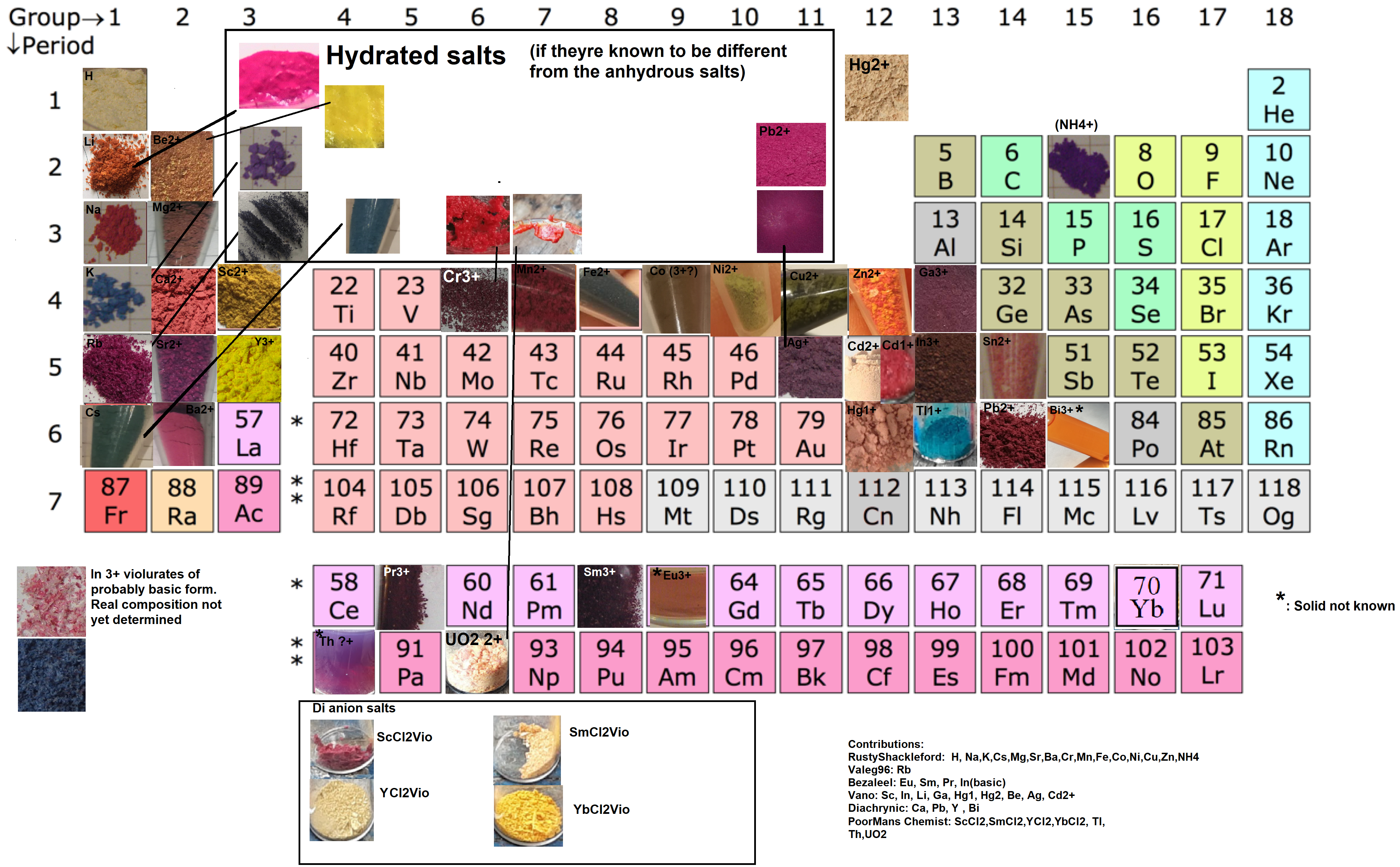

Update on the subject of violuric acid:
Thanks to the help of PoorMans Chemist (who i sent some violuric and barbituric acid to) videos about the subject have been produced, aswell as many new salts for our collective viewing pleasure.
Especially big thanks to him for producing the Thallium and Uranyl salts, super cool to see!
Also thanks to user H0lx for giving me the idea to put these tables together, aswell as making many of the organic salts of violuric acid (pyridine, ethanolamine, methylamine, ethylenediamine, o-MePhNH3, Guanidine and Aminoguanidine)
I decided to put together 2 new tables to better show all (i think) organic salts created thus far, aswell as update the periodic table. Unfortunately i had to cut up the organic one due to file size limit
periodic.png - 5.3MB
org1.png - 2.9MB
org2.png - 3.8MB
org3.png - 1.4MB
aminoacids.png - 2.9MB
If you can find a pattern in these colors, please inform me.

I am loving this project -- at least watching from the side lines.
About your periodic table graphic, surely it is Sc3+?

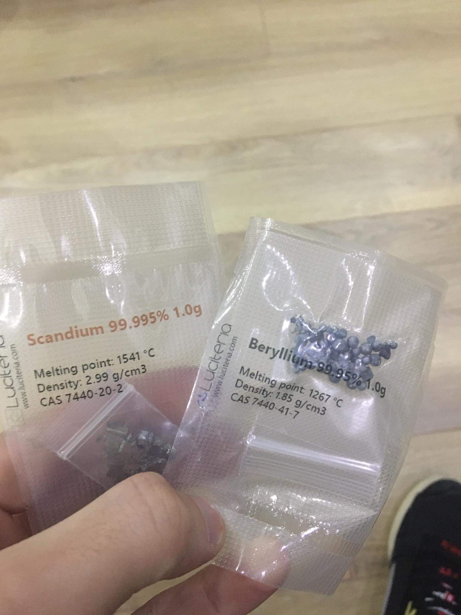

[*] posted on 7-7-2021 at 11:15
I love this project too. Yes it's really scandium salt. I don't have much scandium because it has high price. I bought 1 gram scandium and i used very small amount for this reaction.
received_282665669589082.jpeg - 185kB

[*] posted on 7-7-2021 at 13:12
damn, and i thought i fixed the errors in the image. Ofc it is and should have been obvious to me. ill fix it in the next update when ive done the Al3+ salt and Ti3+ salt. I already tried Al twice but with no success.

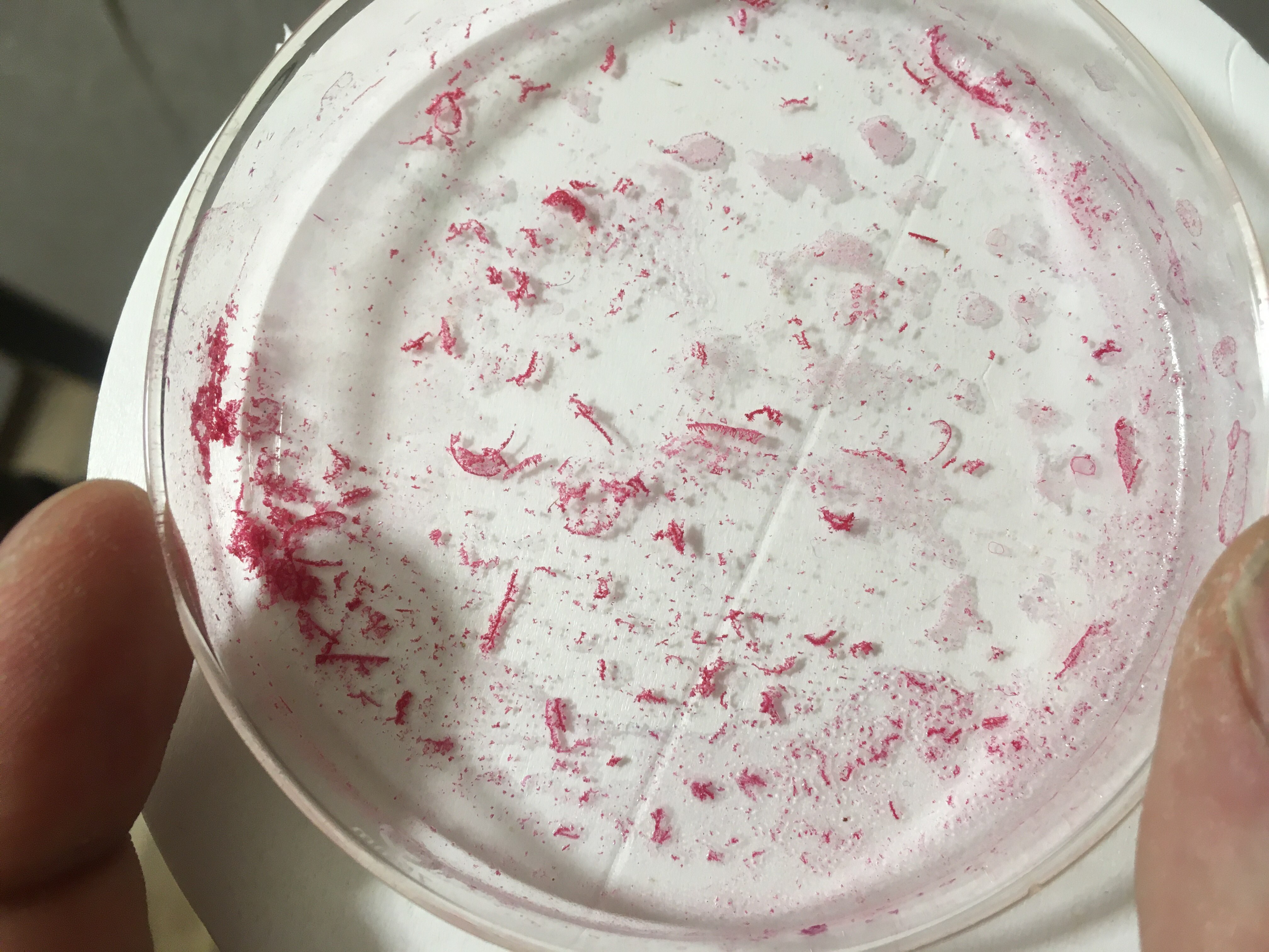

[*] posted on 10-7-2021 at 07:44
Im having trouble getting a pure sample of Al(OH)3 to react w the acid. precipitating the hydroxide and washing it didnt work, and using hydrolysed then dried AlCl3 gave some wierd product that evaporated to a white solid (purple/brown in solution), very strange.
[Edited on 7-7-2021 by RustyShackleford]

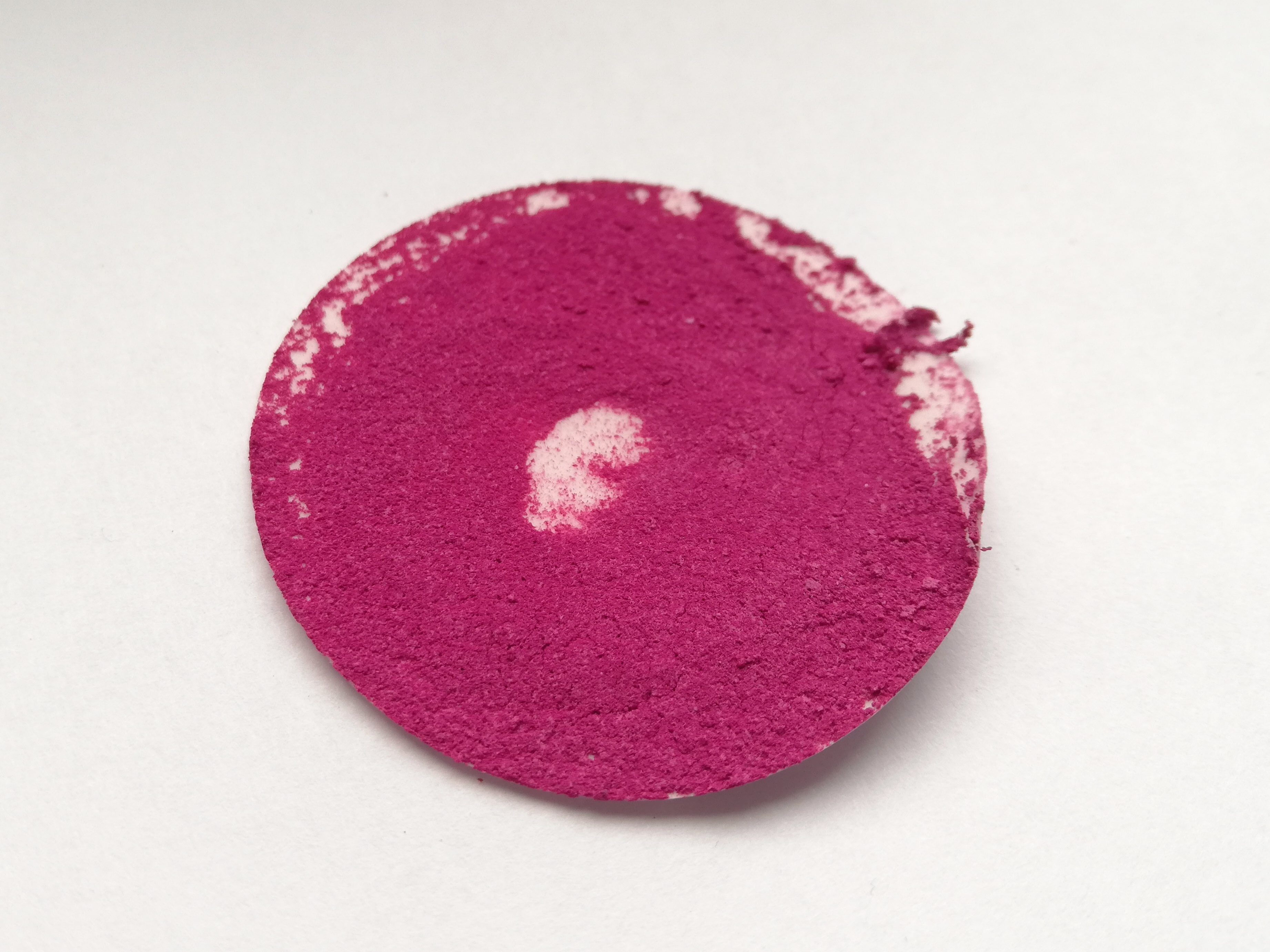

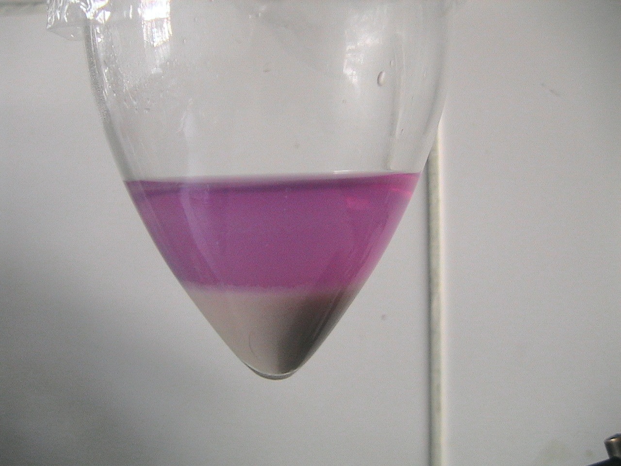

I tried the Al3+ salt too. Solution and crystals are fuchsia-like, similar to a number of other violurates:
IMG_3742_adj.JPG - 267kB IMG_3831_adj_det.JPG - 268kB
Preparation via Al2(CO3)3 from alum with sodium bicarbonate solution and filtrating/rinsing twice. Stir the carbonate with the violurate for 1 hour on 1200rpm at 70C. Let stand for a day and using a pipette to suck off the solution.
I don't exclude that a larger portion of the violuric acid hasn't even reacted.
Posts: 4514
[*] posted on 10-7-2021 at 08:04
Alum and sodium bicarbonate don't give you aluminum carbonate- it gives aluminum hydroxide.
Still, a pretty colour.

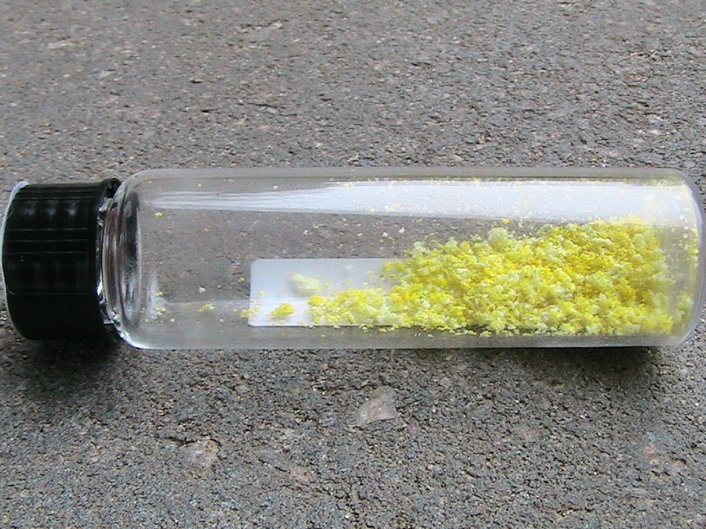

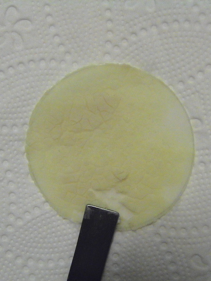

[Edited on 2-4-2021 by Diachrynic]
I have some doubt whether you really got the salt you say you got, [Y(Vio)2(H2O)2]Vio · 6 H2O. The rare earths tend to form yellow violurate salts which contain chloride when prepared from rare earth chlorides, so it may have played a trick on you.
I prepared a yellow salt from EuCl3.6H2O (pictured). However, with Sm2(CO3)3 and Pr(OH)3 I obtained dark red salts.
IMG_3916_det.JPG - 328kB

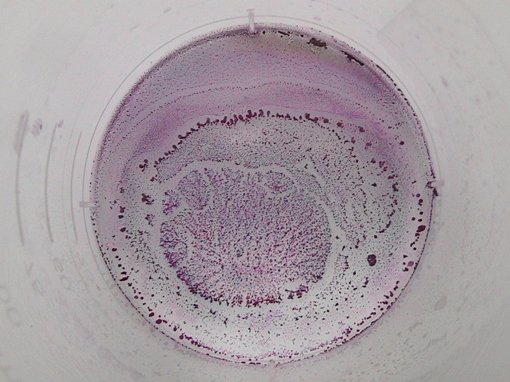

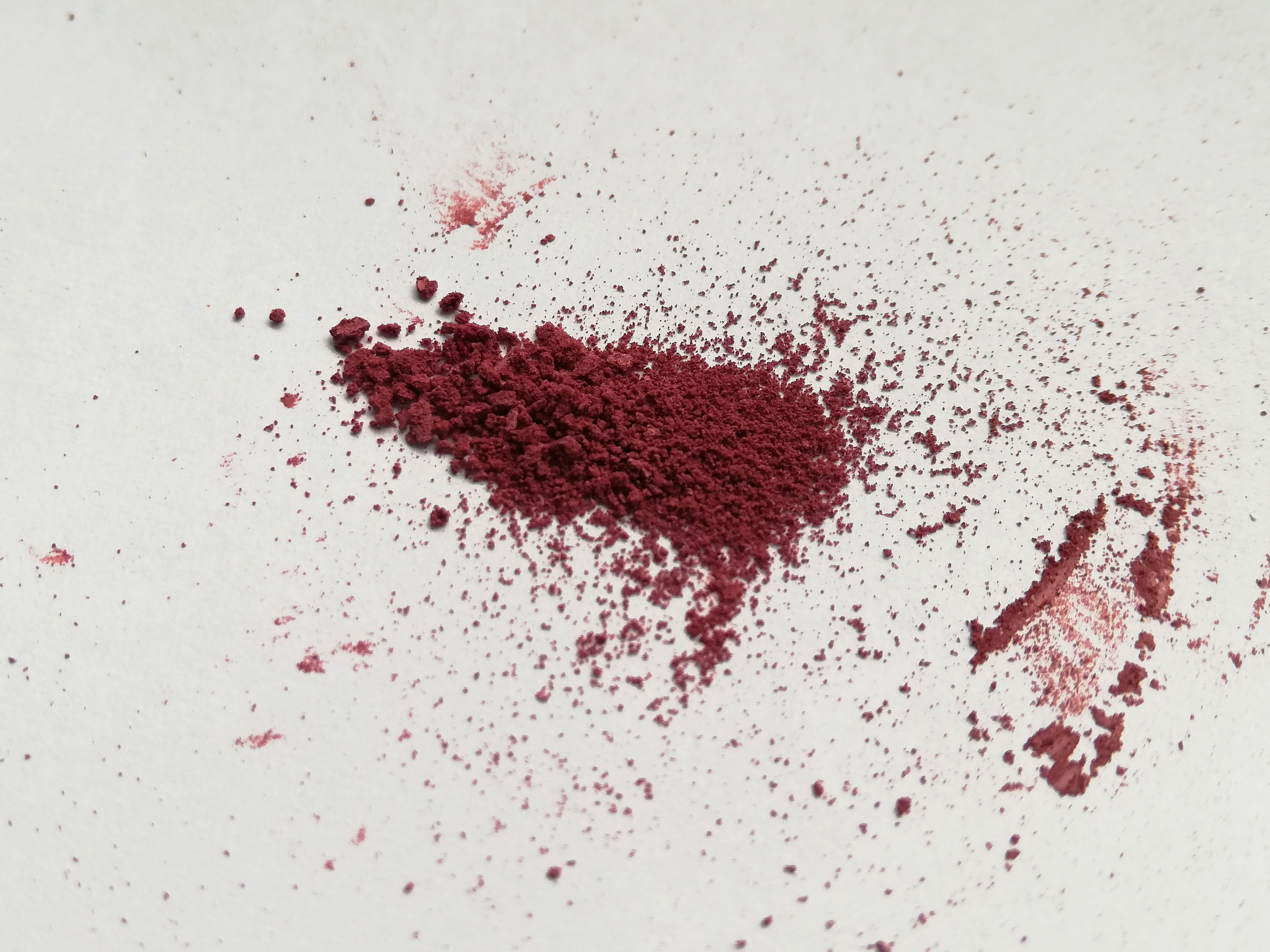

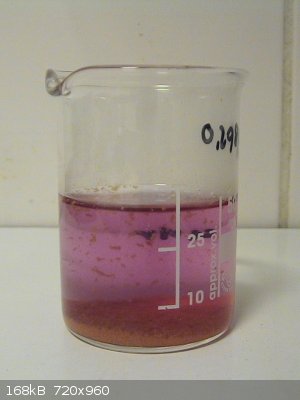

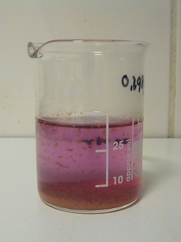

[*] posted on 18-7-2021 at 16:44
Cerium violurate
0.374g of (NH4)4Ce(SO4)4 were dissolved in water and Ce(OH)4 was precipitated by adding an excess of NaOH solution. The precipitate was washed 4 times and then scraped of the filter and added to a warm (pink/lilac) solution of 0.298g of violuric acid. The light yellow precipitate of Ce(OH)4 turned dark orange immediately but the solution retained its colour of dissolved violuric acid.
IMG_4001_det_adj.JPG - 165kB IMG_4006_det_adj.JPG - 168kB
This is a bit mysterious, since the Ce(OH)4 was present in excess (0.300g (NH4)4Ce(SO4)4 would be stoichiometric, assuming no losses). It did react with the violuric acid, but it did not dissolve nor use up all the dissolved violuric acid. I presume that a basic Ce-salt has formed, like Ce(OH)2(vio)2.

- Adding the solid to 10% NaOH leads to dissolving of the solid, just like in water, but the solution is not red with a purple tinge, but it is more orange/red. Still a bright color, but definitely different from what you get, when the solid is dissolved in water. I already noticed that at high pH, the solution tends to shift to orange.
- I added excess solid NaOH to the colorless solution in dilute H2SO4. Around the granules of NaOH you see pale orange liquid. The solid NaOH dissolves, producing a lot of heat. At the lower, strongly alkaline layer, the liquid becomes orange, then there is a very dark purple/blue layer and on top of that is a pink acidic layer. On shaking all of the liquid, the final color becomes red with an orange hue, just like the solution, obtained when dissolving sodium violurate in dilute NaOH.
