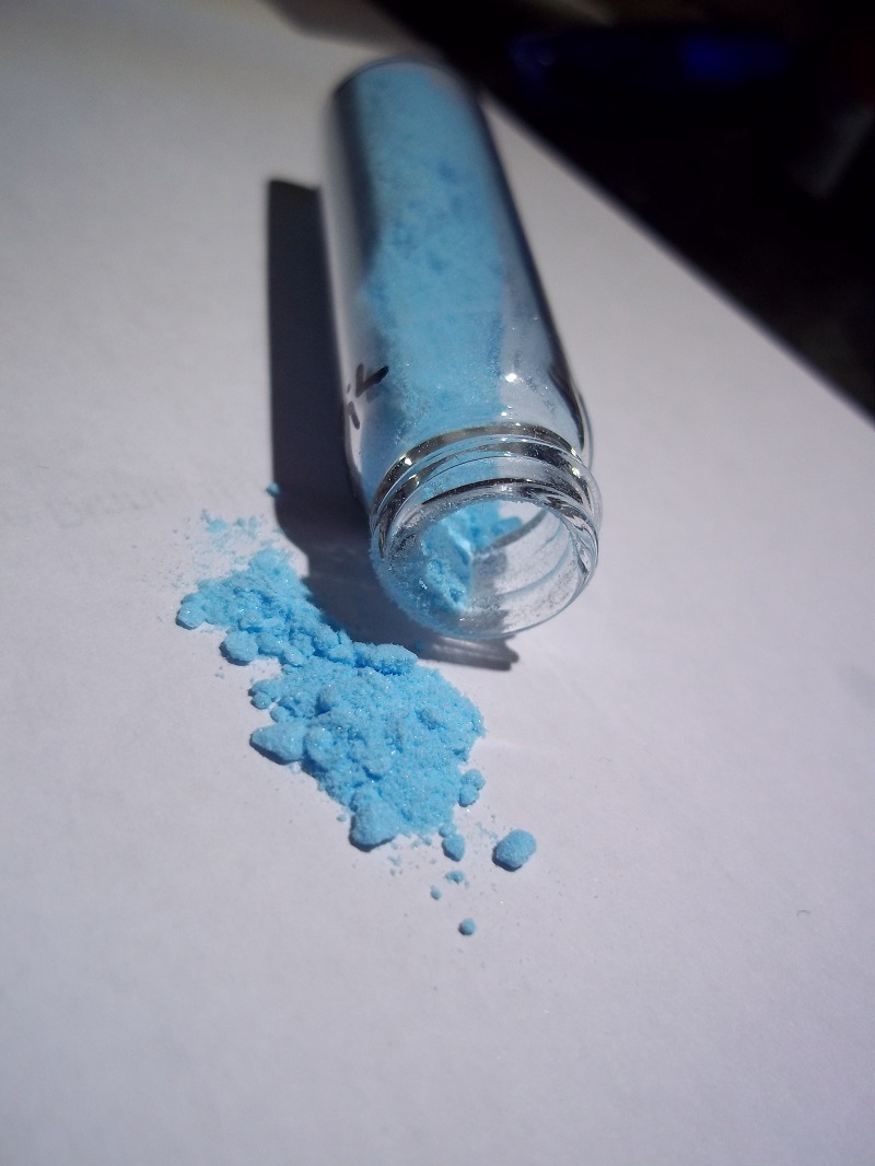

Second, a little copper benzoate!
100_1254.JPG - 198kB

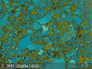

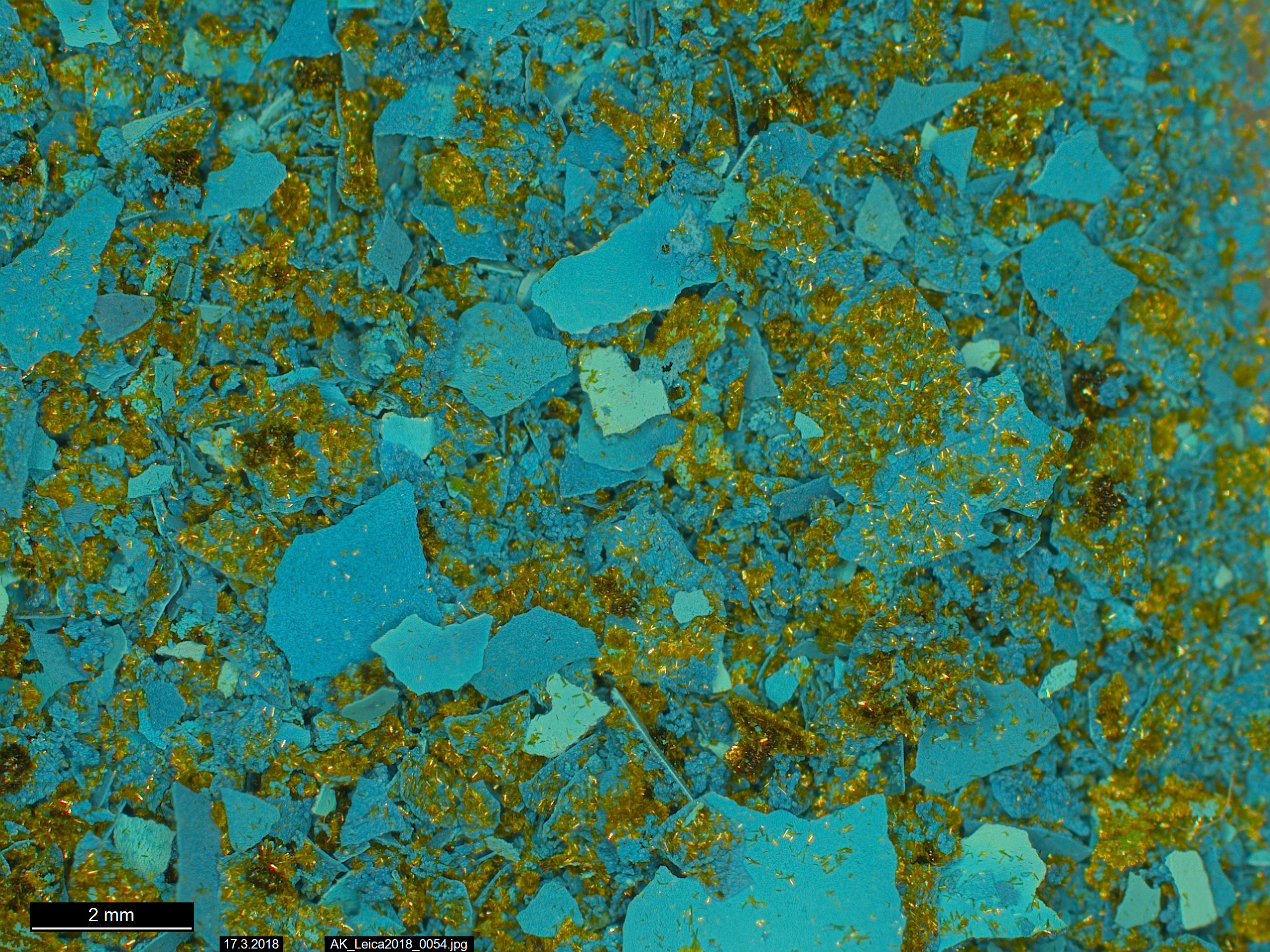

[*] posted on 24-3-2018 at 02:02
after crystalising, the copper aspirinate deposited on the walls of the flask, as it can be seen from nice smooth shards. however, we got these goldish needle-like crystals that don't really fit any description.
the synthesis was done with copper sulfate and pure ASA
an EDS analysis was done and it shows the blue aspirinate and the needle-like golden crystals to have a somewhat similar composition (the gold needles contain less copper and more organic)
AK_Leica2018_0054.jpg - 5.9MB

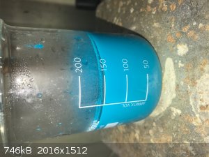

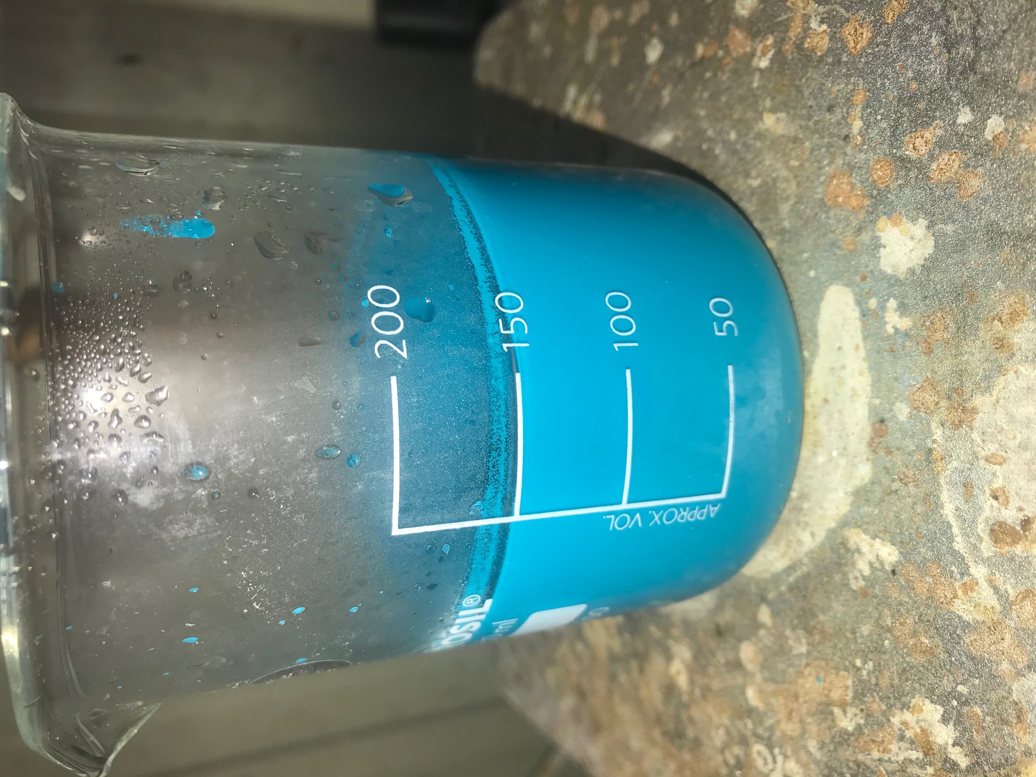

- 6g CuSO4.5H2O in 20ml water, heat a bit to fully dissolve. Slowly pour the CuSO4 solution into the sodium aspirinate solution to get the double displacement:
4C9H7O4Na + 2CuSO4*5H2O = C36H28O16Cu2 + 2Na2SO4 + 10H2O
- Stir for some 20 minutes, dark blue solution. Photo below.
1 color after double displacement.jpg - 746kB

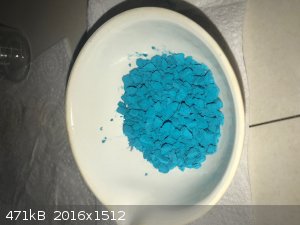

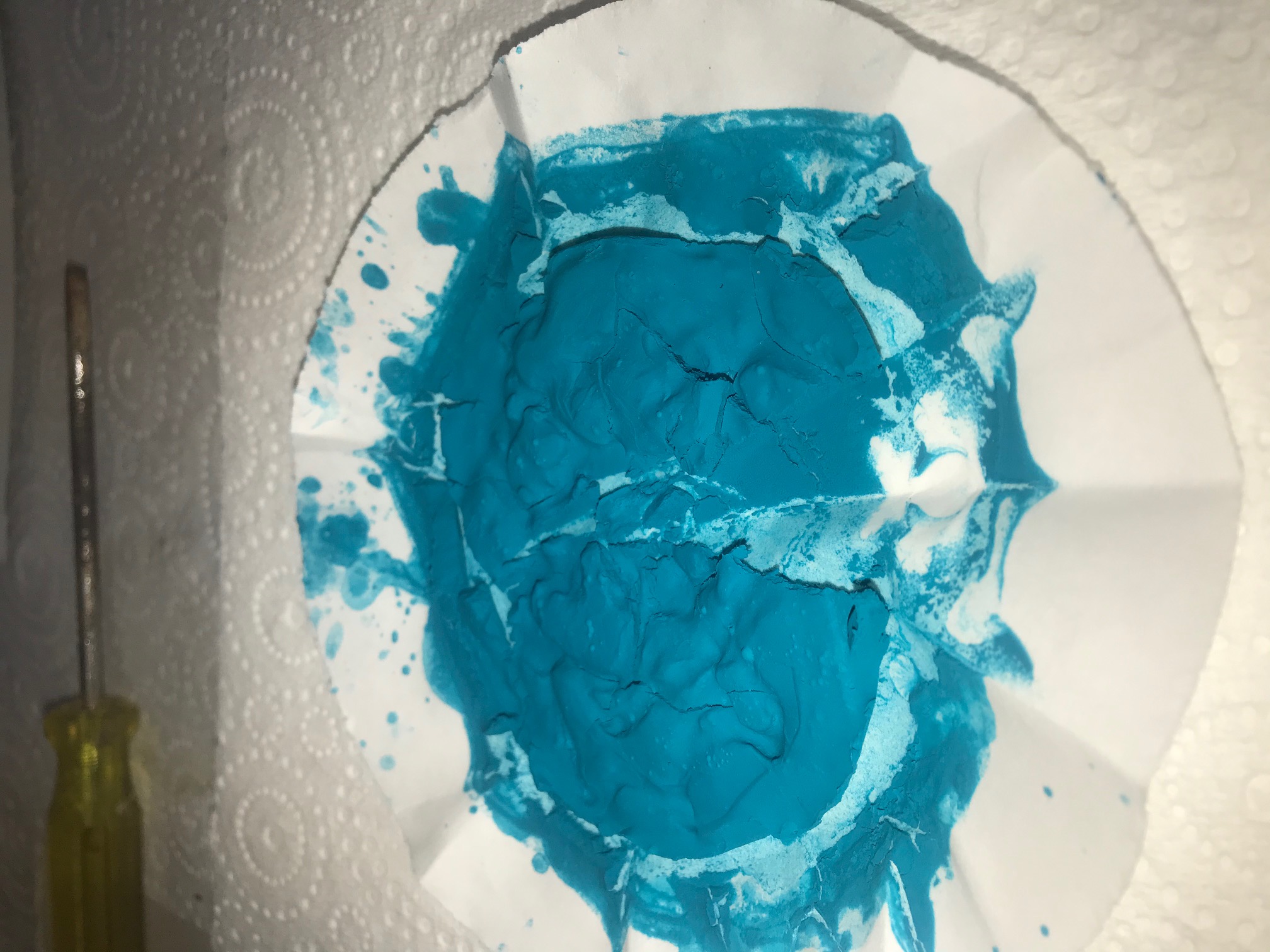

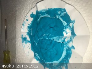

- Vacuum filter and wash once with excess of cool water in the funnel. Photo below of the wet remainder. The filtrate had a very pale magenta color.
2 wet remainder.jpg - 490kB

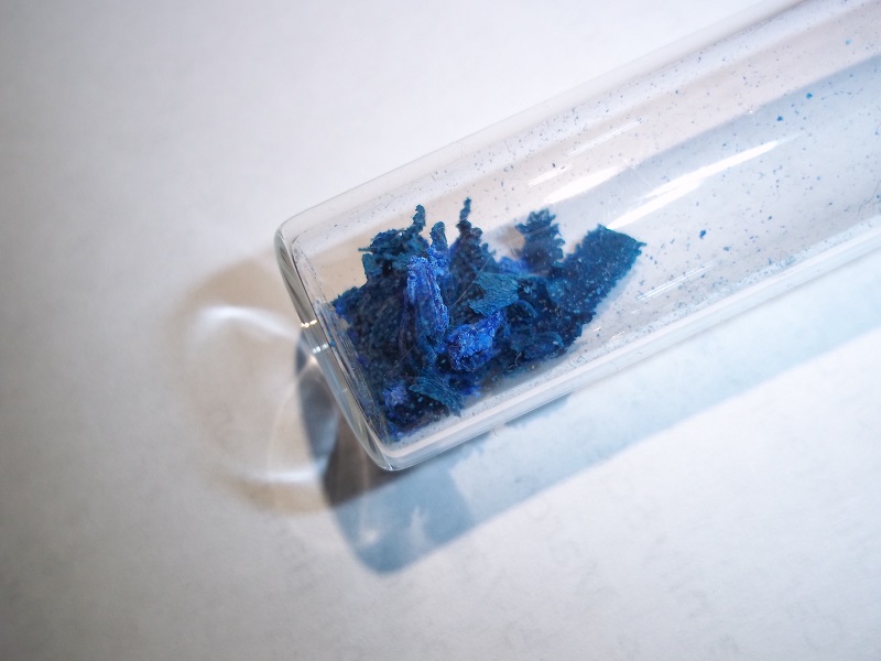

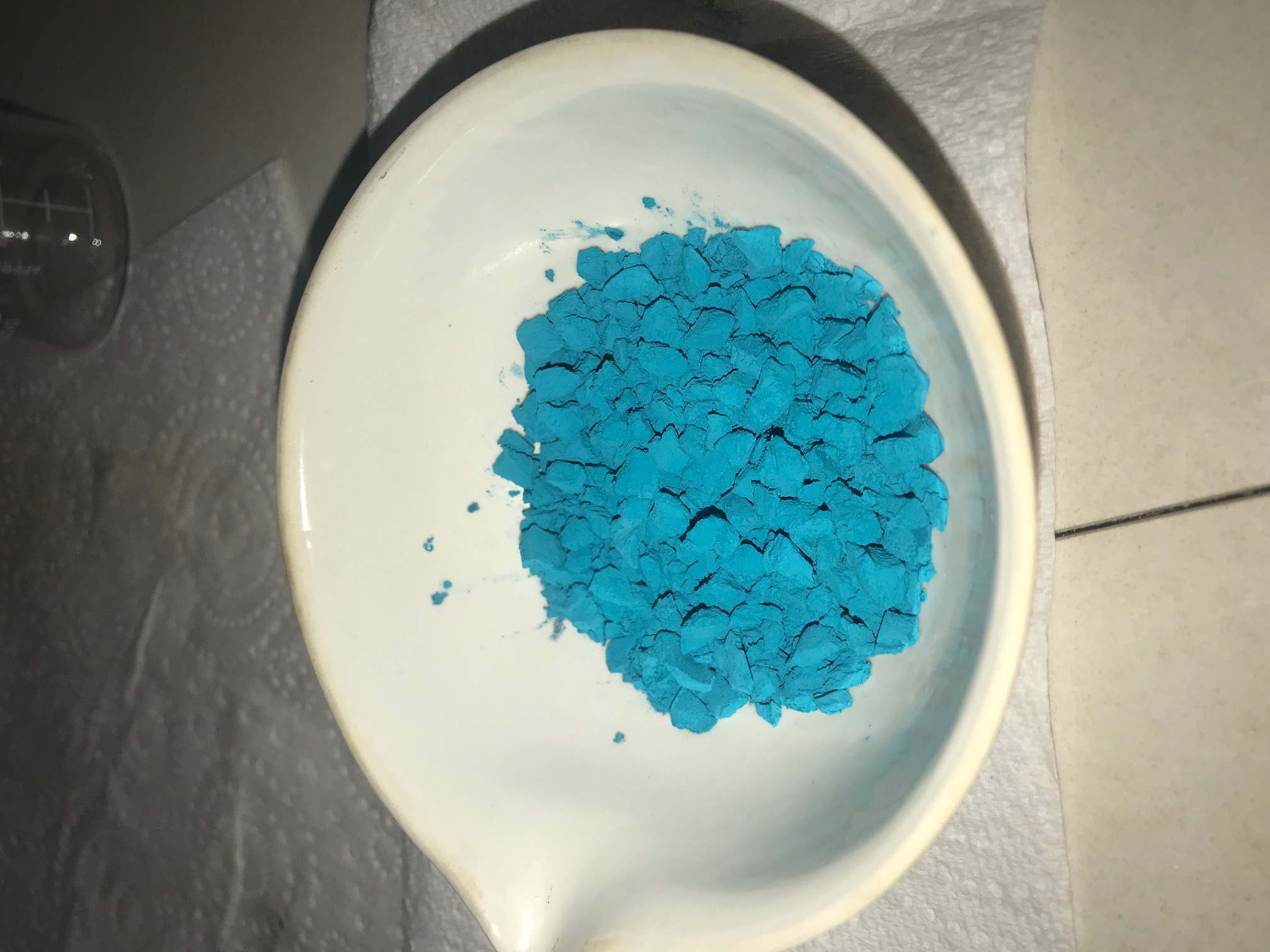

- Dry remainder on steam bath till weight reduction slowed to near nothing. Dry dark blue powder, 10g recovered. Photo below.
3 dry copper aspiorinate.jpg - 471kB
