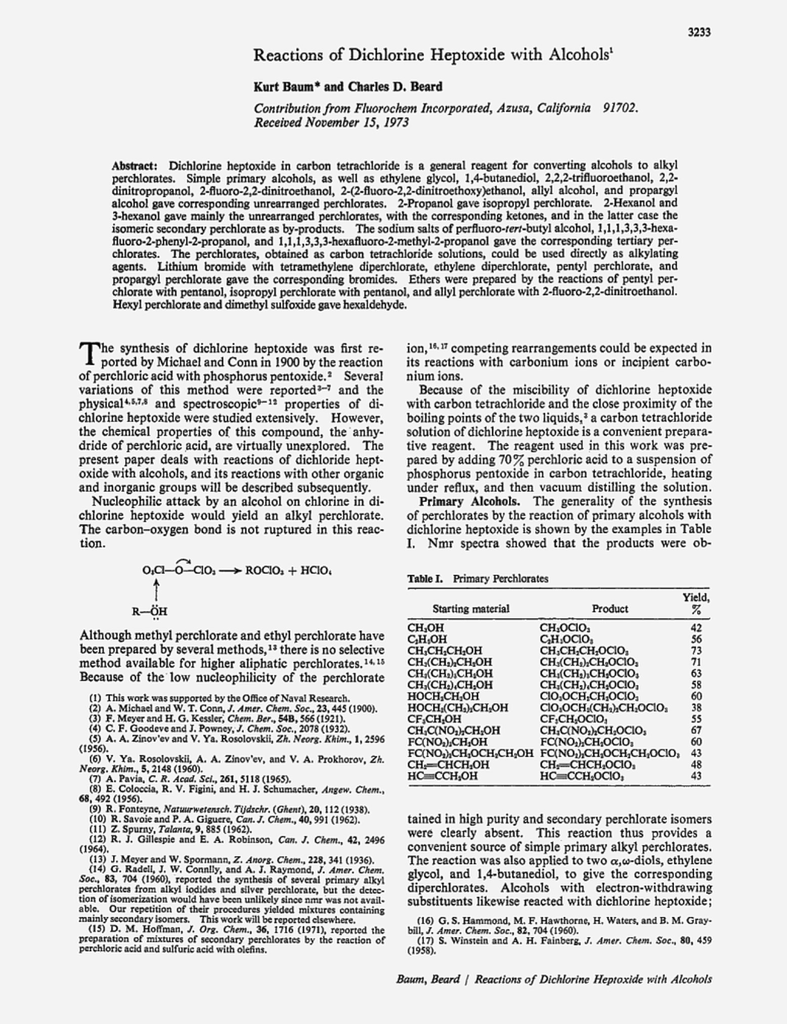

Perchlorate polymers
Reactions of Dichlorine Heptoxide with alcohols
J. Am. Chem. Soc. 1974, 96, 10, 3233-3237
https://pubs.acs.org/doi/pdf/10.1021/ja00817a033
https://doi.org/10.1021/ja00817a033
Reactions of dichlorine heptoxide with alcohols.jpg - 547kB
Dichlorine Heptoxide in Carbon Tetrachloride is a general reagent for the facile oxidation of alcohols to alkyl perchlorates.
It's preparation from Perchloric acid obviates subsequent handling of the acid itself.
Propargyl alcohol H-CΞC-CH2OH for example is thus made in situ into Propargyl Perchlorate. H-CΞC-CH2-ClO4 => 3 CO + H2O + HCl .
Propargyl alcohol polymerizes , presenting the prospect of producing a perchlorate polymer.
Chloroethene monomer commonly known as Vinyl Chloride , H2:C=CH.Cl polymerizes into the familiar PVC plastic ( Poly Vinyl Chloride ) [CH2.CHCl]n
Ethenol known as Hydroxylethylene commonly known as Vinyl alcohol H2:C=CH.OH
may suitably be made into Vinyl Perchlorate H2:C=CH.ClO4 => CO2 + CO + H2O + HCl
and subsequently polymerized in the same way ( barring steric hindrance ) into a Poly Vinyl Perchlorate [CH2CHClO4]n
The highest density of PVC plastic is ~ 1.45 . Higher density can be anticipated in the perchlorate variant.
1,3,5-Trihydroxybenzene also known as 1,3,5-Benzenetriol commonly known as Phloroglucinol C6H3(OH)3
should readily be liable to form the Perchlorate , C6H3(ClO4)3 => 6 CO2 + 3 HCl
