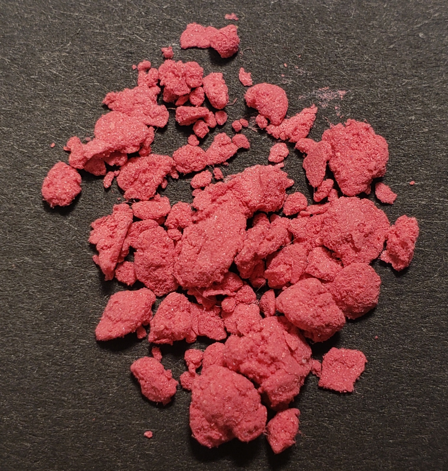

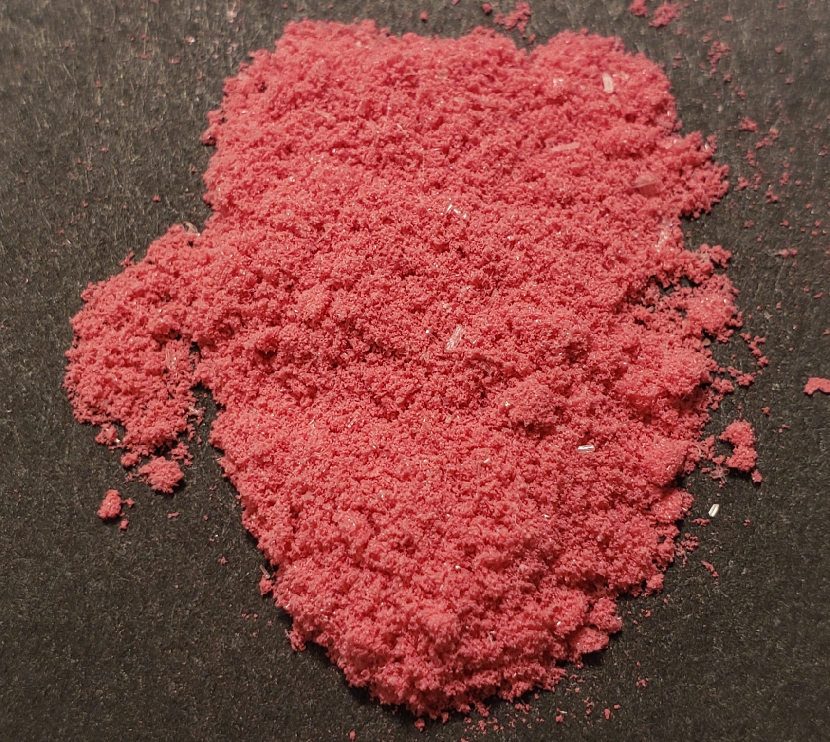

[*] posted on 4-8-2021 at 11:22

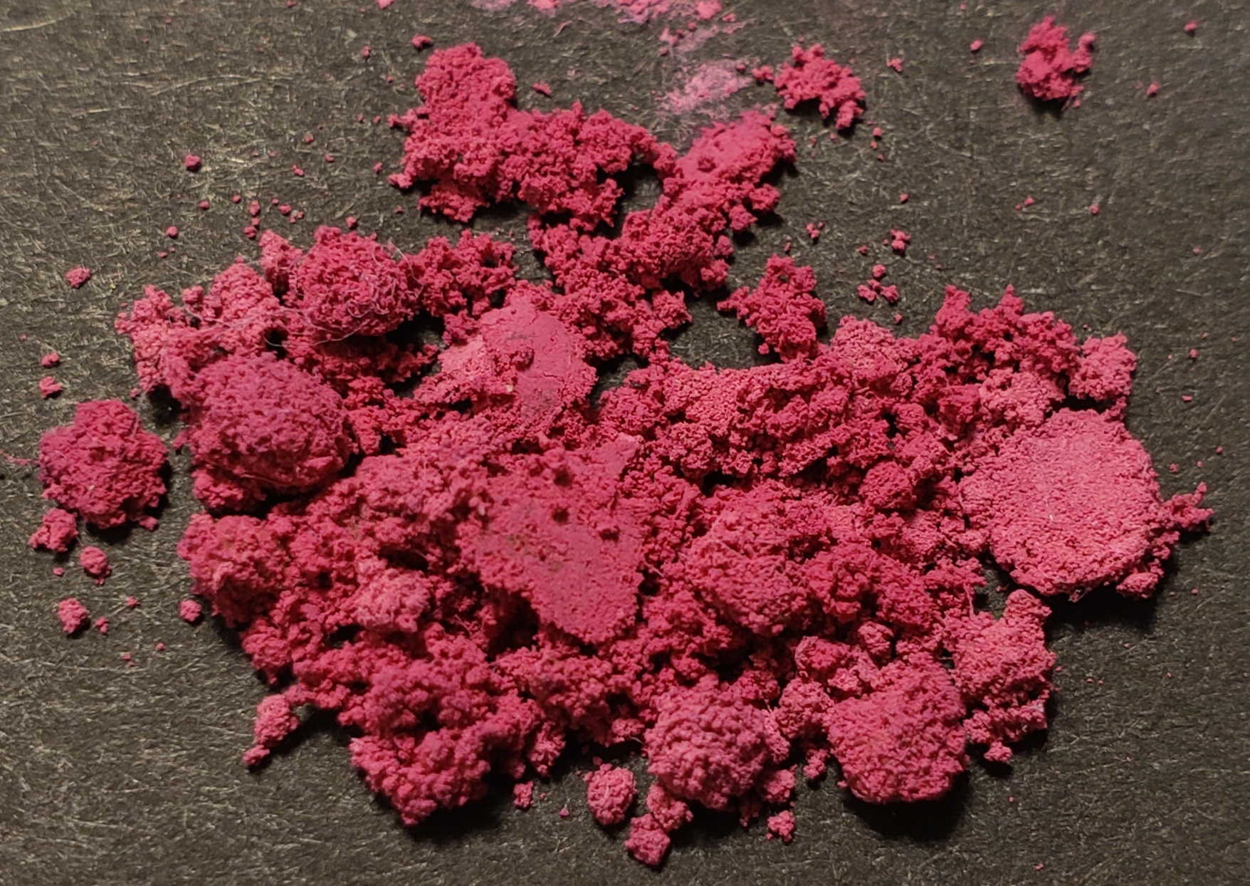

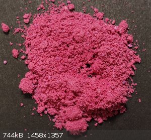

A picture of the dried powder in a watch glass. The material has a beautiful bright color, it really looks like it is in the picture with a deeply saturated color.
na_violurate_dry_powder.jpg - 828kB

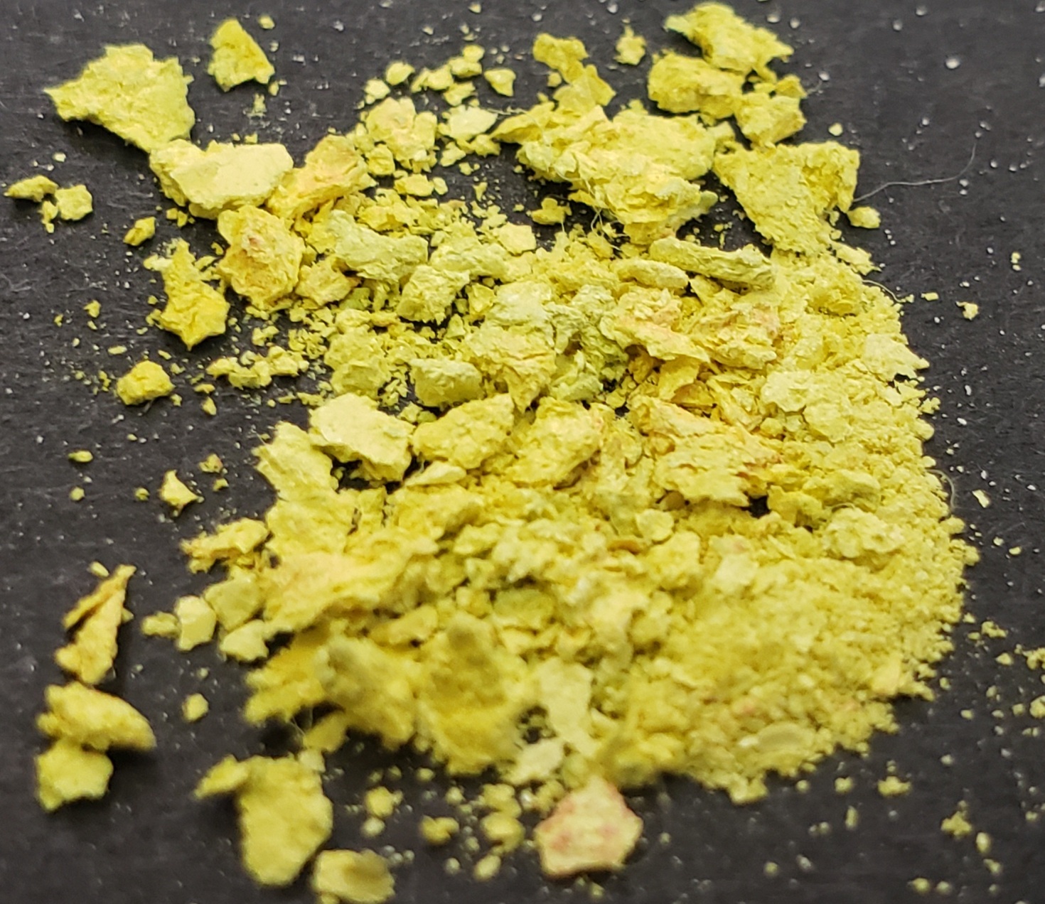

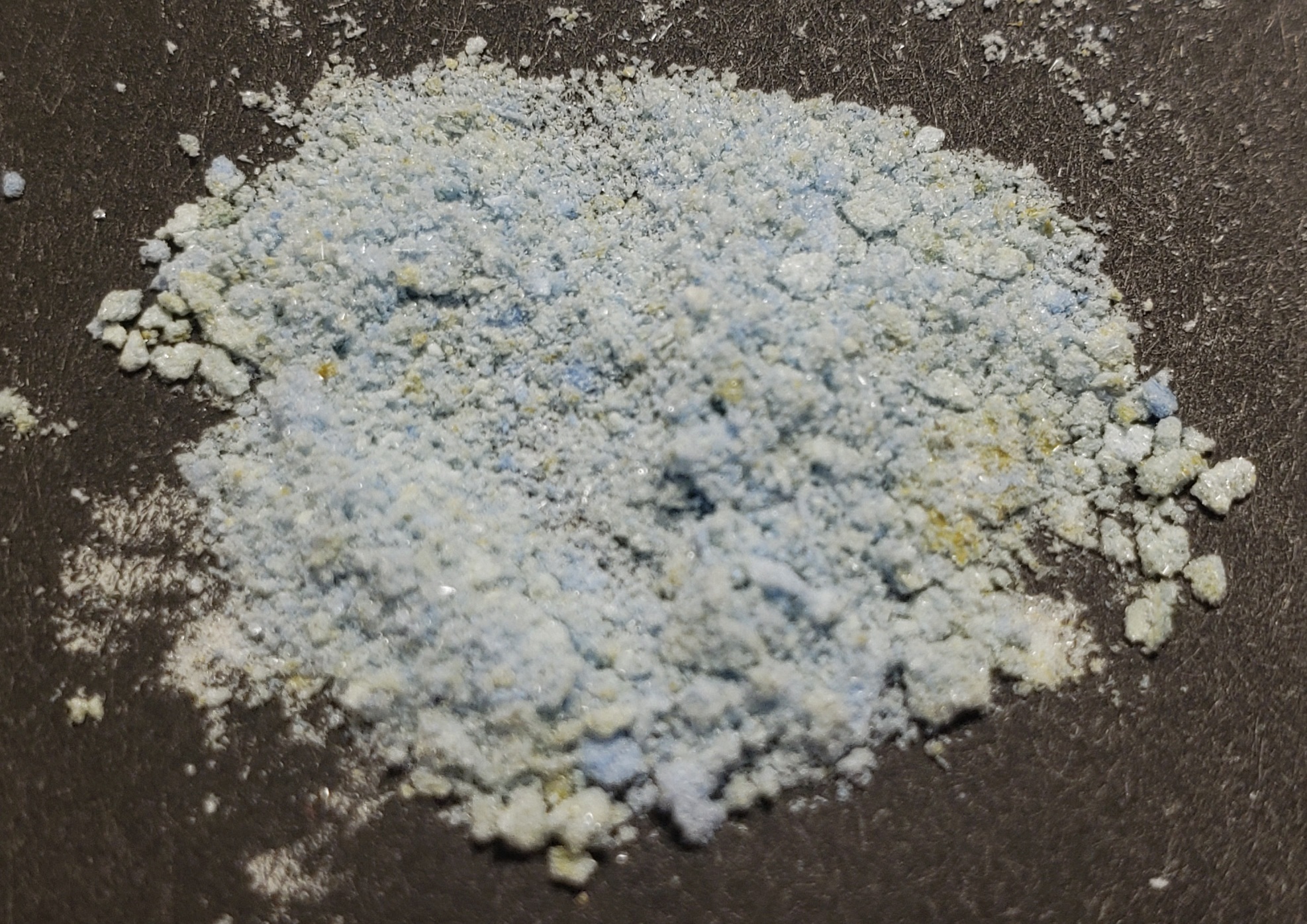

[*] posted on 31-8-2021 at 08:33

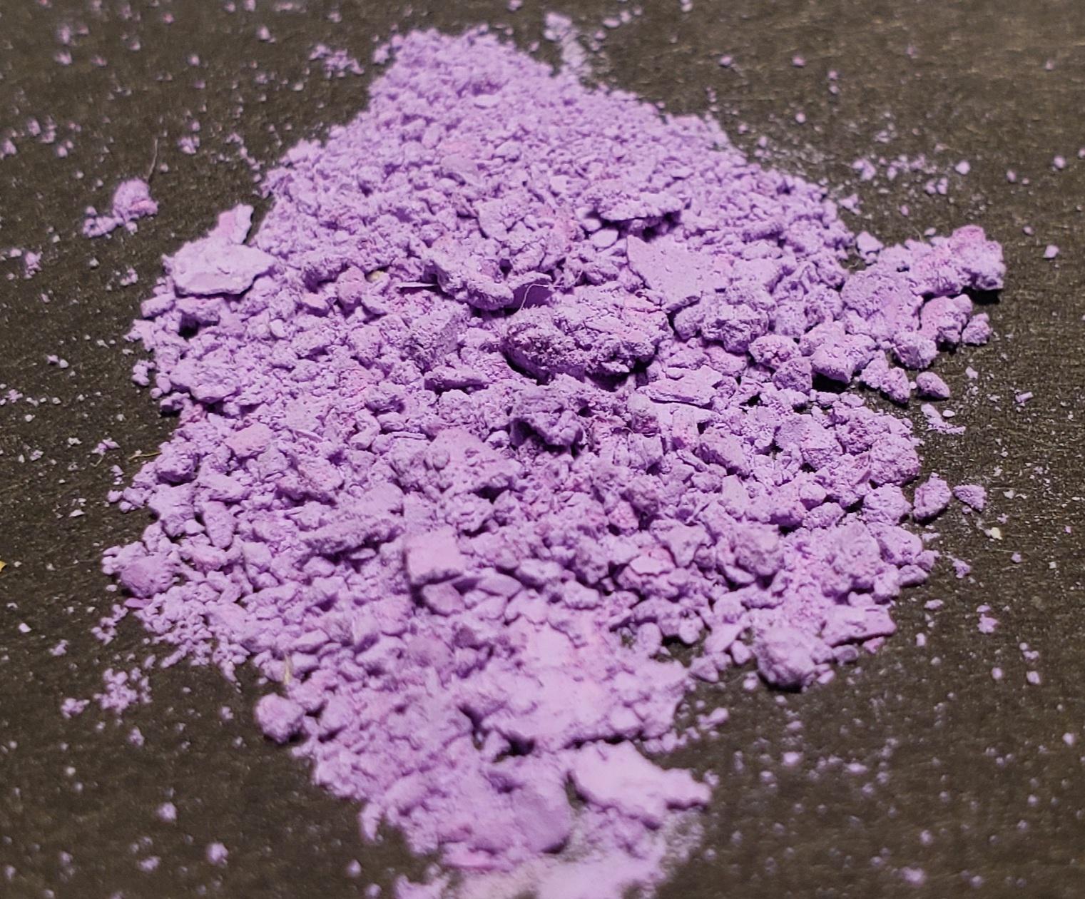

Hello everyone! Im back with another few violurates to add to this growing collection.
Thanks to Ormarion for making and sending me pictures of dimethylaniline, 2,2 bipyridine violurates and the zirconium salt. Ormarion has produced their own violuric acid from diethylmalonate, and is working on a video about the process, although it will be in french, i think video documentation will be great for those looking to attempt the reactions.
And thanks to h0lx for making and sending pictures of 2-amino-4,6-dimethylpyrimidine and 3,5-dimethyl pyrazole salts.
Myself i havent had time to do more than triisopropanolamine since ive been busy with exams. But i do have some exciting news, thanks to an extremely generous offer 13C, 1HNMR and FTIR analysis will be done on the violuric acid i have produced aswell as possibly some high end microscope pictures of a few of the salts. Its possible that even COSY and HSQC scans will be performed. I will update with results when i get them :D
The new organic salts
noname01.png - 2.9MB
Zirconium salt
Zr.jpg - 2.3MB
[Edited on 31-8-2021 by RustyShackleford]

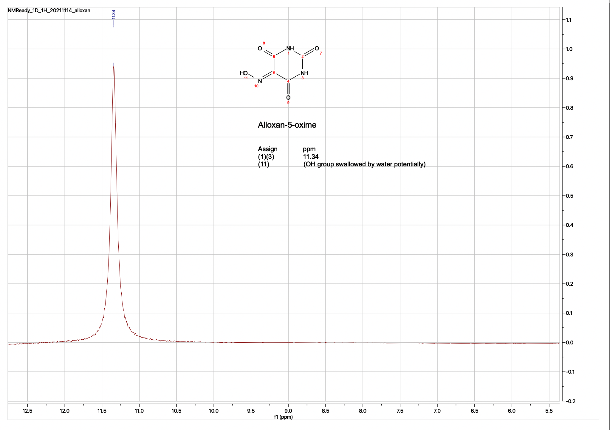

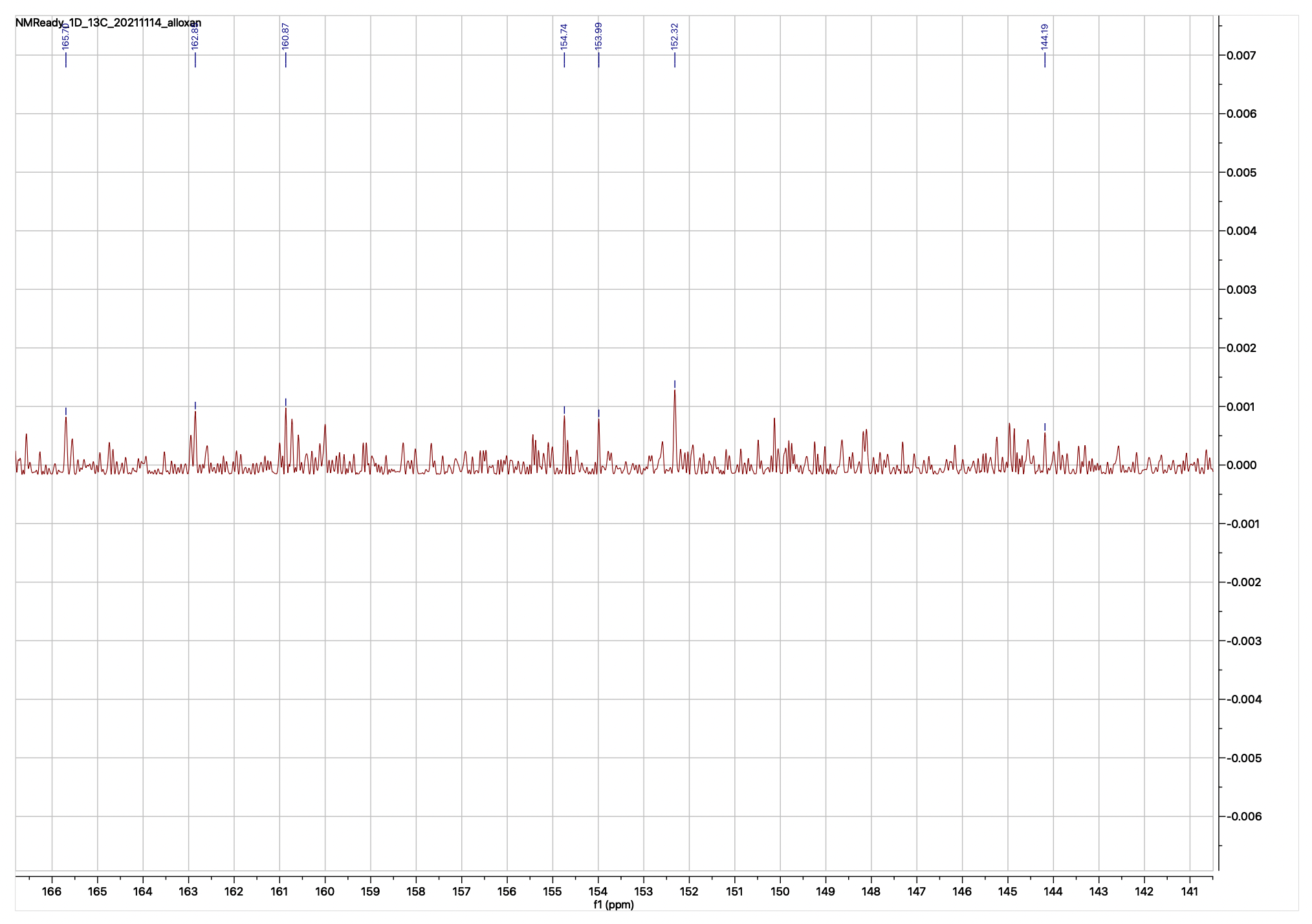

[*] posted on 19-11-2021 at 11:18

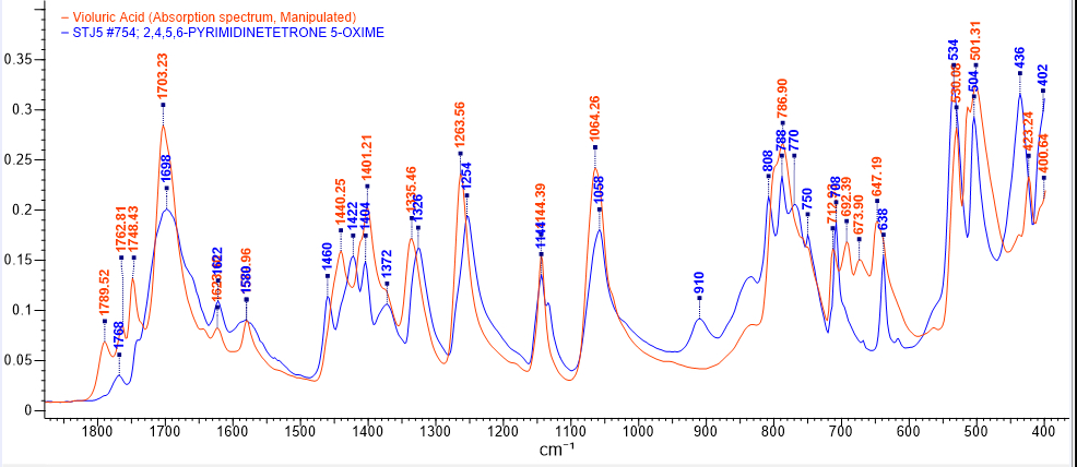

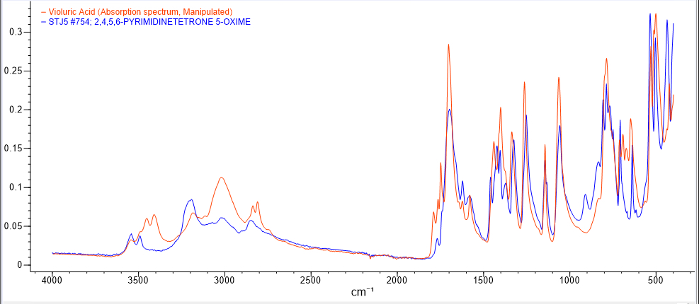

Im back with analysis results from 1H, 13C and FTIR :D
orange = sample, blue = bruker spectra. a respectable fit i think, good enough to confirm the compound
FTIR_comparison.jpg - 194kB
Zoom-ins
FTIR_high_comparison.jpg - 180kB
FTIR_low_comparison.jpg - 288kB
1H performed in DMSO-d6, OH peak probably gone due to water in solvent.
1H.png - 1000kB

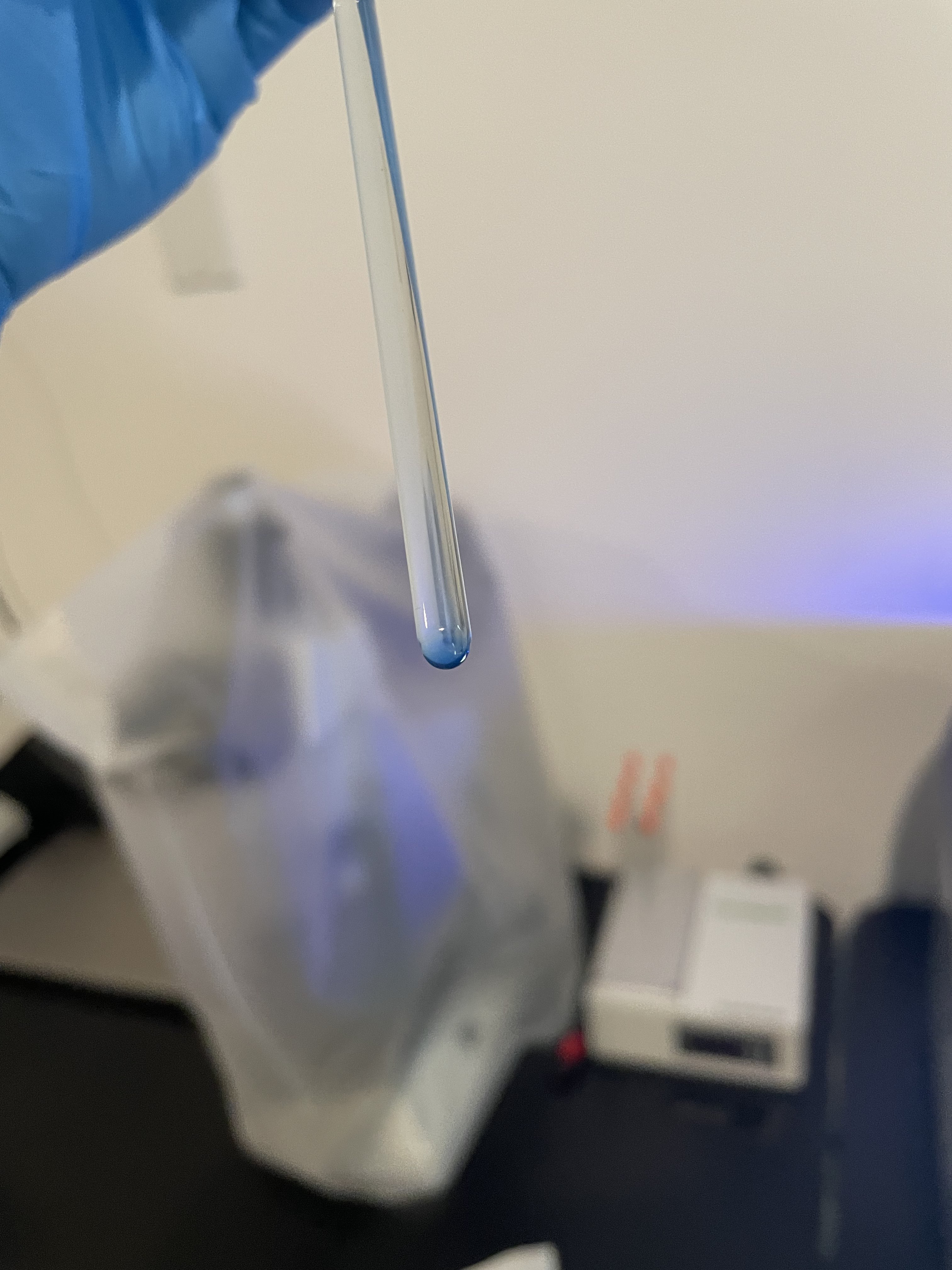

evidence of water in the solvent, the DMSO turned blue at the bottom.
IMG_0059.jpg - 1.5MB

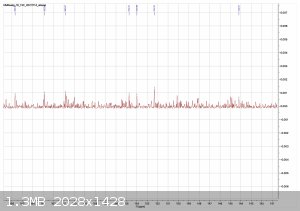

13C. was not soluble enough to provide a good sample solution with chloroform nor DMSO.
13C.png - 1.3MB

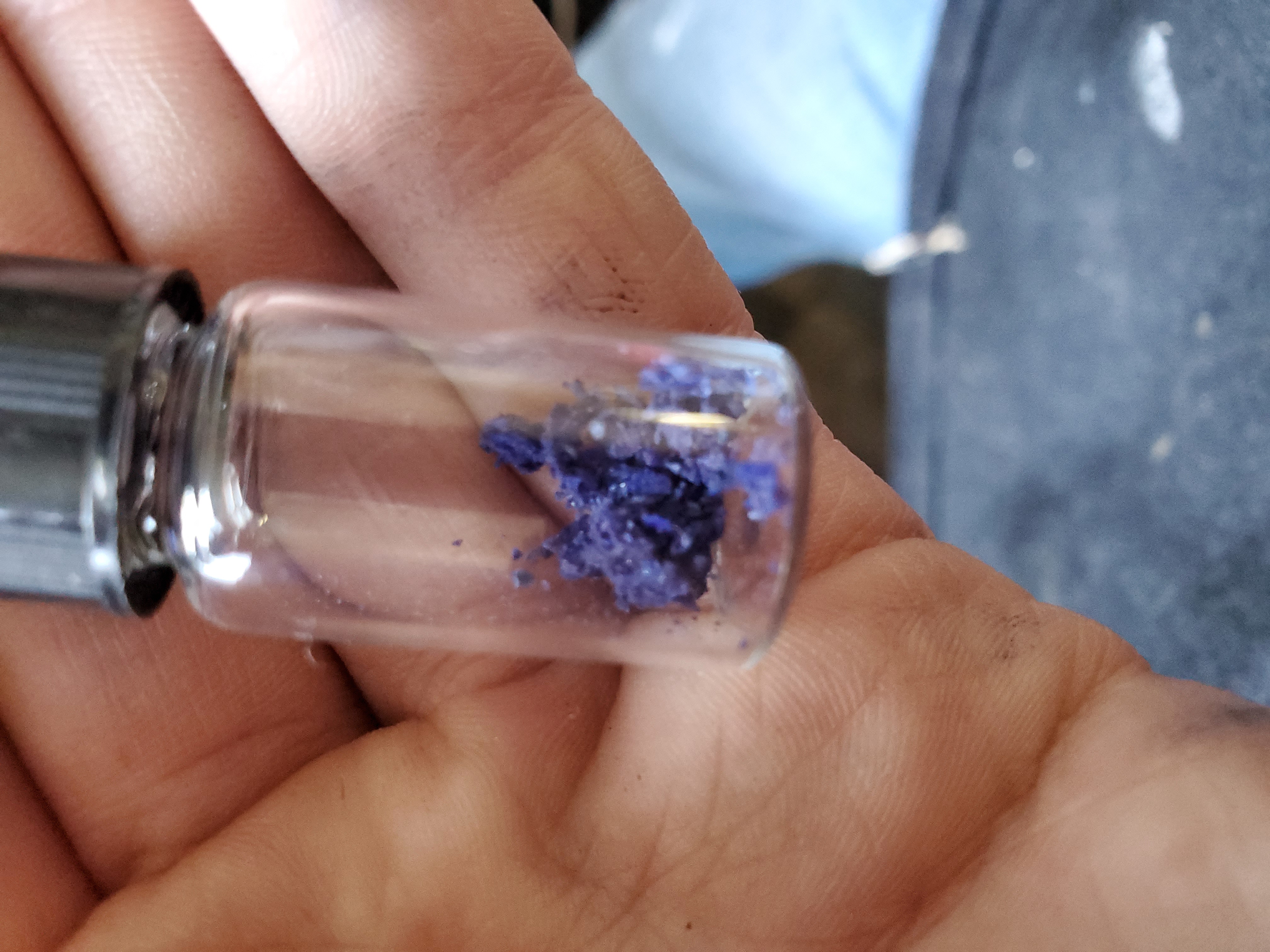

[*] posted on 2-3-2023 at 14:18
Violuric acid salts (fantastic colors and variety)
Hey everyone, I'm new here, so apologies if I mess up this post.
I have been getting deep into violurates lately and would like to talk about a few things I've done with them, starting with a mostly otc synthesis to a derivative of violuric acid which makes colors at least as vibrant as the normal violuric acid, if not better in some cases, it is called 1,3-dimethylvioluric acid and I was able to make it with semi-decent yields in a few steps starting with caffeine. Which I will outline the procedure for below.

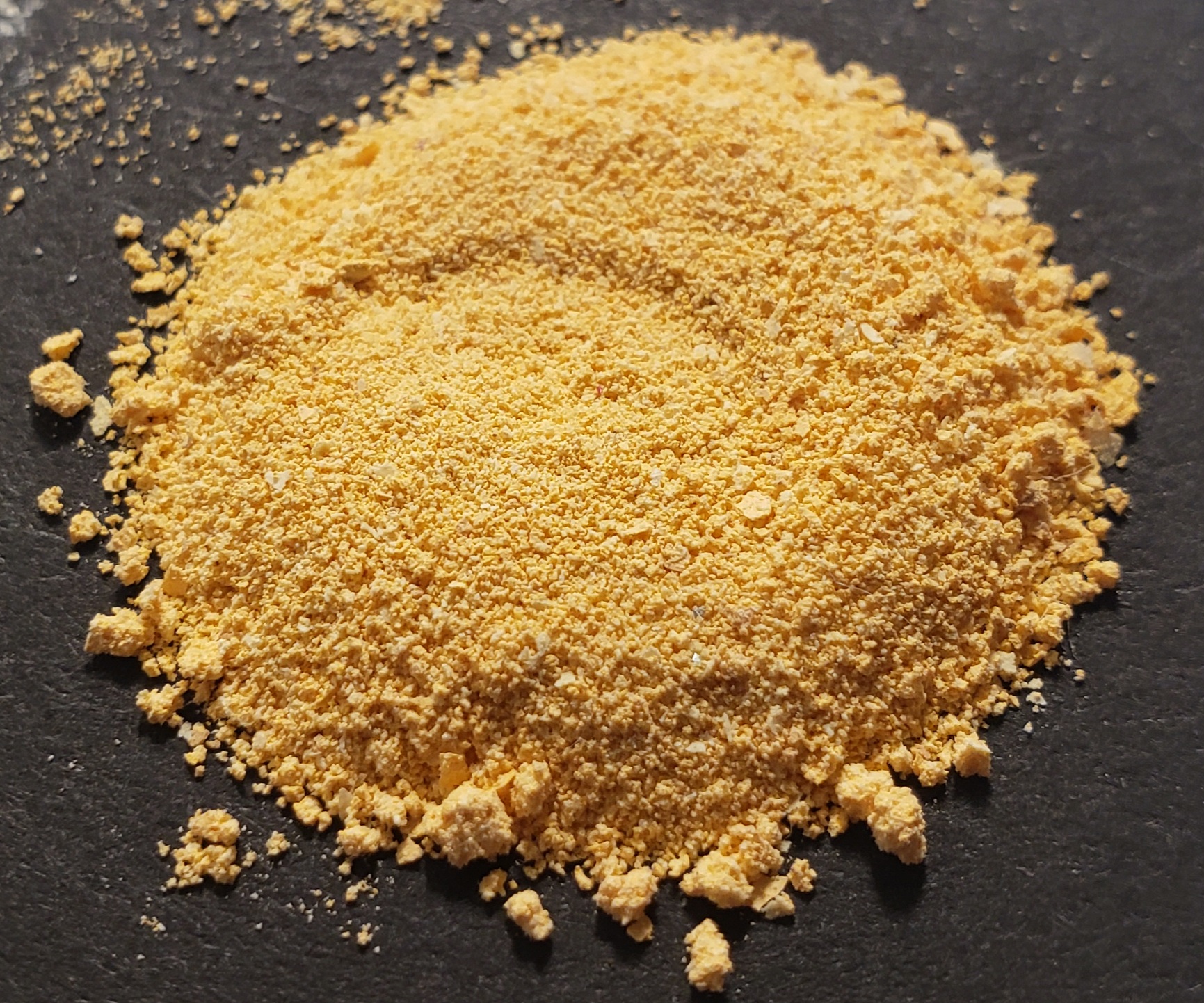

All that is happening in the reaction is an oxidative cleavage of caffeine to yield 1,3-DimethylAlloxan and Monomethylurea, however the desired product is the dimethylalloxan. Because this reaction is a little messy we need to isolate our dimethylalloxan by reducing it to generate its insoluble dimer, tetramethylalloxantin which will precipitate out of solution. The tetramethylalloxantin is then treated with RFNA to isolate the dimethylalloxan again which will crystallize out and can be treated with hydroxylamine which will install an oxime group on the position 5 of the ketone, which will yield the 1,3-dimethylvioluric acid.
I followed this procedure from illumina to obtain the tetramethylalloxan needed with just a few modifications: https://illumina-chemie.de/viewtopic.php?t=5375
Caffeine to Tetramethylalloxantin:
25g of caffeine is placed into a 2-neck 500ml round bottom flask with a condenser. With stirring on 35ml of conc HCl and 75ml of water is added to the caffeine until it is dissolved. The flask is warmed in a water bath kept at 50-55C and 10g of potassium chlorate is added in small portions over a period of 1.5-3 hours, patience is key for better yields and it is important to add the chlorate slowly with small additions, if you add too much at one time or add it too quickly it will overoxidize your product. Upon addition of the KClO3 the solution will turn yellow and a thick precipitate of 8-Chlorocaffeine will form which may make stirring difficult, it is reccommended to have a way to manually stir the solution if your stir bar becomes stuck. Small amounts of presumably Cl2 and ClO2 are formed, however the amount of the gases formed were very small for me and weren't too concerning. You can know when to add more chlorate based on how yellow your solution is, after a certain interval of time between additions of chlorate the solution becomes a more pale yellow which is when you can add more KClO3 in small increments. After most of the KClO3 is added the precipitate of 8-chlorocaffeine will dissolve, at the end of addition the solution is left to stir for 15-30 more minutes and air is blown through the warm solution for another 30 minutes to remove excess chlorine in solution. The reaction mixture is then cooled in an ice bath and the reflux condenser is exchanged for a dropping funnel with a solution of 14.1g SnCl2 in 20ml of 18% HCl, which is slowly dripped into the solution. After complete addition a white powder of tetramethylalloxantin begins to precipitate out. To increase the amount of precipitate 5ml of 35% H2O2 is added and the solution is stirred for another 30 minutes on the ice bath. The precipitate is then suction filtered to yield 12.4g of tetramethylalloxantin.
1,3-DimethylAlloxan monohydrate from TetramethylAlloxantin:
This reaction is surprisingly very clean and doesnt really require measuring in exact amounts, however you can also follow the procedure from orgsyn that kmno4 already posted: http://www.orgsyn.org/demo.aspx?prep=cv3p0037
I usually just measure out the desired amount of TetramethylAlloxantin, wet it slightly with distilled water, put it on a hotplate with stirring and heat the solution so it is slightly warm to the touch, then slowly pipette drops of fuming nitric acid. NO2 will evolve and the TetramethylAlloxantin quickly dissolves. Once all the TetramethylAlloxantin is dissolved and no more NO2 is generated the solution is taken off the hotplate and is cooled for over 10 hours. 1,3-DimethylAlloxan monohydrate crystallizes out during this time in large, clear/colorless crystals as seen here.

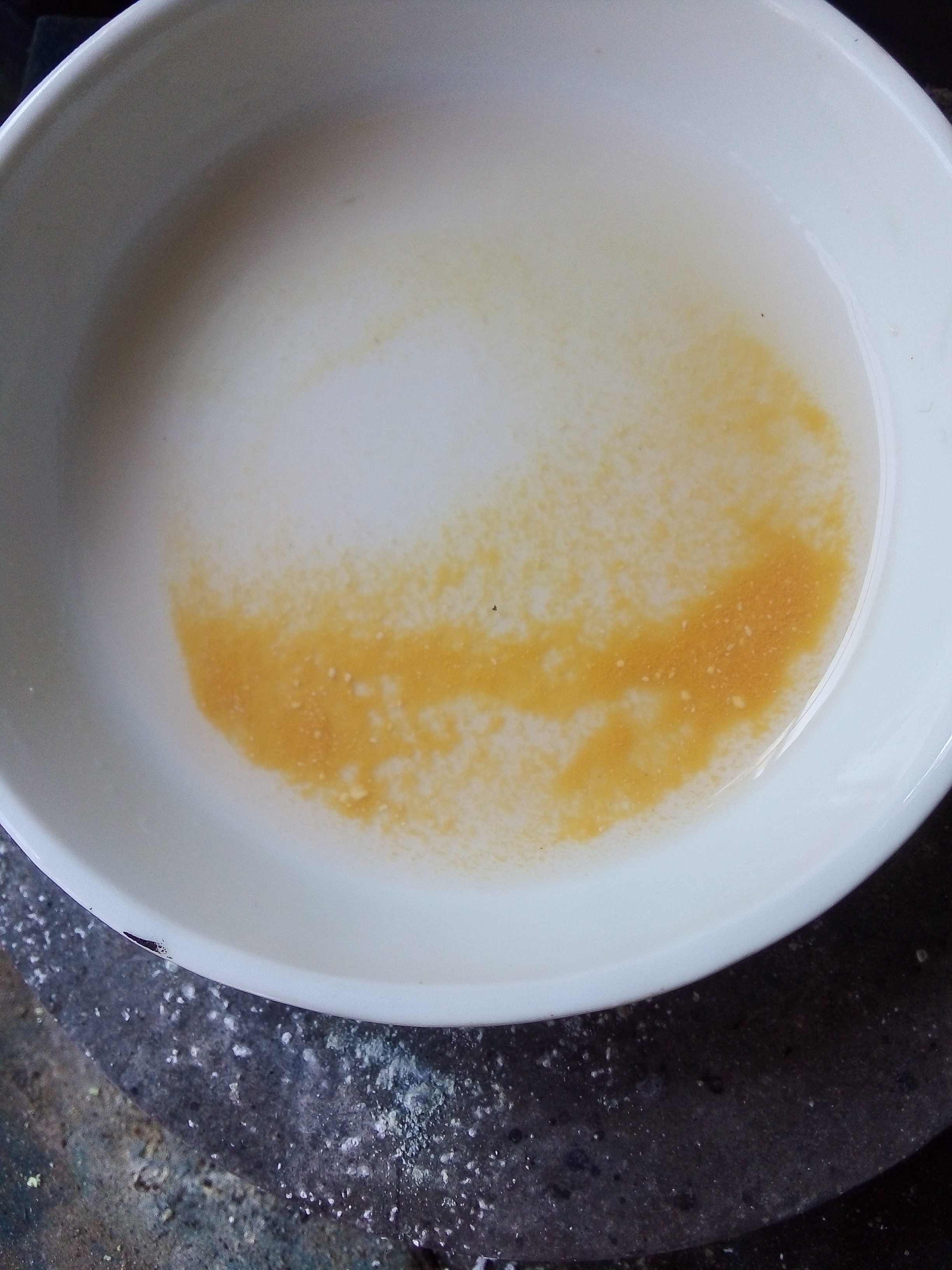

1,3-DimethylAlloxan.jpg - 290kB

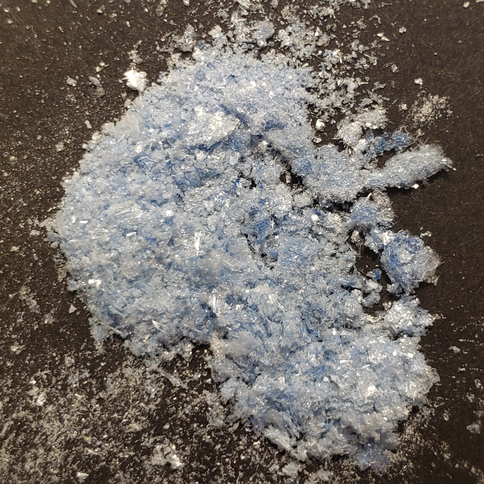

1,3-DimethylVioluric Acid monohydrate from 1,3-DimethylAlloxan monohydrate:
2g(10.63 mmol) of 1,3-DimethylAlloxan is dissolved in 3-4ml of distilled water and 0.87g(12.5mmol) of Hydroxylamine HCl is added with heating and stirring. After ~5-10 minutes a large amount of 1,3-DimethylVioluric acid crashes out. The reaction mixture was then cooled and filtered off to yield 2.241g of white/cream colored 1,3-DimethylVioluric Acid monohydrate.
To make the salts the 1,3-DimethylVioluric Acid is dissolved in ethanol and an equimolar amount of the base is added, the salt will typically immediately precipitate upon addition of the base.

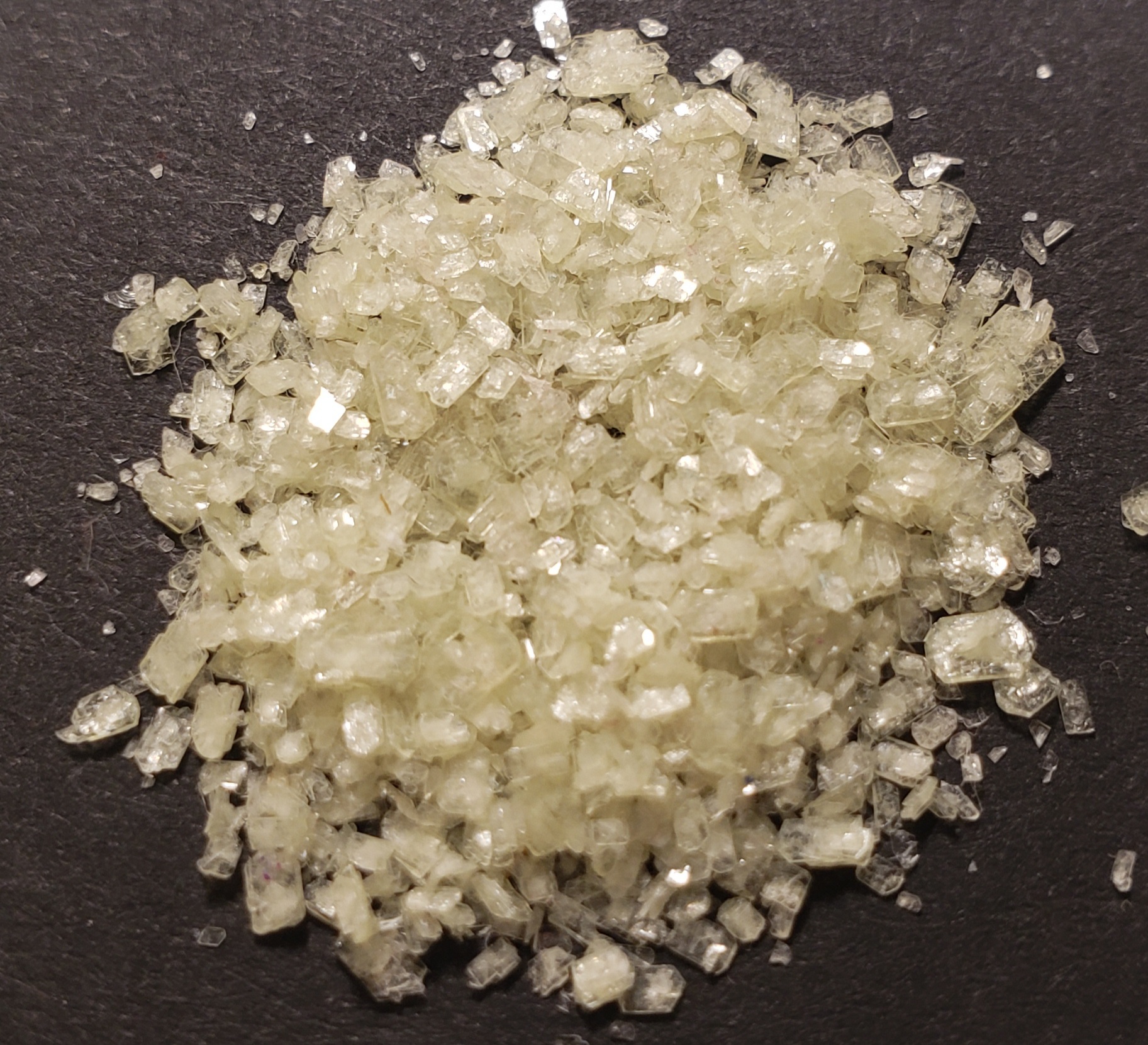

To prove that I have made the 1,3-DimethylVioluric Acid I made the Potassium salt which can be seen below.
Potassium 1,3-DimethylViolurate.jpg - 317kB
Anyways, this post is getting a little long, so I should probably end it here, but as a side note I have also made about 12 amino-acid violurates, most of which haven't been made before, so if you would like to see another post about those let me know.
[Edited on 2-3-2023 by Cakethegrate]

Anyways, here are the amino-acid violurates as promised. (From left to right) Is Alanine Violurate, Arginine Violurate, Asparagine Violurate, Aspartic Acid Violurate, Histidine Violurate, Isoleucine Violurate, Lysine Violurate, Methionine Violurate, Phenylalanine Violurate, Proline violurate, Threonine Violurate, and Valine Violurate.
I especially like the colors of the Lysine, Phenylalanine, Valine, Histidine, and Arginine salts. If anyone wants any of the violurates absorbance spectra(in water) I can provide that upon request.
Alanine Violurate.jpg - 744kB Arginine Violurate.jpg - 895kB Asparagine Violurate.jpg - 827kB Aspartic Acid Violurate.jpg - 926kB Histidine Violurate.jpg - 832kB Isoleucine Violurate.jpg - 904kB Lysine Violurate.jpg - 1.2MB Methionine Violurate.jpg - 1.1MB Phenylalanine Violurate.jpg - 841kB Proline Violurate.jpg - 776kB Threonine Violurate.jpg - 933kB Valine Violurate.jpg - 988kB
Here are a few amino acid salts made with the 1,3-Dimethylvioluric acid, its interesting how different the same amino acid violurates and dimethylviolurates can be, those two methyl groups seem to make a surprising difference. so far I have noticed that the amino acid dimethylviolurates tend to be more shifted towards the blue/green end of the spectrum rather than the red/pinkish that seems typical for the normal amino acid violurates. I'm planning on making the dimethylammonium
1,3-dimethylviolurate salt(I know, a lot of methyl in the name lol) however, I haven't gotten around to it yet.
In order from left to right is Proline 1,3-Dimethylviolurate, Phenylalanine 1,3-Dimethylviolurate, Niacin 1,3-Dimethylviolurate, Tryptophan 1,3-Dimethylviolurate, and Leucine 1,3-Dimethylviolurate.
Proline(Me2VIO).jpg - 267kB phenylalanine(Me2VIO).jpg - 820kB Niacin(Me2VIO).jpg - 891kB Tryptophan(Me2VIO).jpg - 540kB
Leucine(Me2VIO).jpg - 991kB

Hey everyone hope you doing alright. I recently wanted to share some of the pics of thiovioluric acid i made after talking about it with Cakethegrate, i used exactly the same procedure as i made a video about to make the barbituric acid but replacing urea with thiourea. Synthesis seemed faster too as well as for the thiovioluric acid (it is also way less soluble in water than violuric acid).
To make those thioviolurate i dissolved the acid in warm acetone and slowly added the base , and then let it stirred for a bit.
I recommend you do not heat them as when i tried for some they decomposed releasing stinky sulfur smell.
Im not rly aware about how to share pics on post already made and as there is quite a lot of pics here is a little google drive link to look at them, enjoy and feel free to ask anything :3
(if im braveenough i might try making the selenium and tellurium ones)
https://drive.google.com/drive/folders/1gM-DAlawAKPvivxLLaQt...
