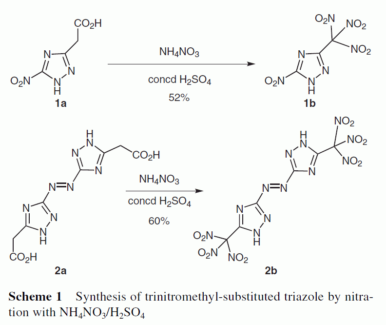

Someone might find this article interesting:
Synthesis of Trinitromethyl- and Dinitromethyl-Substituted Azoles Using Nitrate Salts in Sulfuric Acid
Venugopal Thottempudi, Jean'ne M. Shreeve
Synthesis 2012 (in press)
DOI: 10.1055/s-0031-1289736
Abstract
Synthesis of trinitromethyl and dinitromethyl-substituted azoles employing a mild and efficient nitration method has been developed using a mixture of sulfuric acid and an inorganic nitrate salt XNO3, where X = NH4+, Na+, K+. This methodology exhibits clear advantages over the more popular mixed acids nitration approach. Various nitro functionalities such as C-trinitromethyl, N-trinitromethyl, and dinitromethyl ester containing azoles were prepared in moderate to excellent yields with reduced reaction times using this method.

A big THANK to Nicodem and Rosco Bodine :) for this little golden nugget!
:D:P
I especially like the comparison and effect of extra groups or heteroatoms (nitrogen) onto the yield...
Introducing electrowithdrawing groups increases the yield...
Special attention can be set on the Ethyl 5-Tetrazolyldinitroacetate over 95% yield in less than 2 hours!
This opens me a lot of new ways of investigation....

That is a gem of a paper.
The essential reaction scheme irrespective of the *azole , is the oxidation of the
acetic acid functional group into trinitroformate in a rather fascile manner. It begs
the question if this will work generally on any R-CH2COOH. A likely candidate to
investigate would be aromatic derivatives such as ,1,3,5- benzene triacetic acid.

The electrophilic nitration of fairly active methylene groups is quite general, but the alpha-position of carboxylic acids is not generally considered as particularly "active". That kind of triazole rings activate the methylene group more than a phenyl group does, so the nitration of phenylacetic acids would not necessarily lead to the nitration of the benzylic position, at least not without first achieving the ortho and/or para ring nitration which activates the benzylic position (an exception would be the radical nitration which should proceed readily on phenylacetic acid to give the corresponding oxidation products).
The alpha-position of carboxylic acids can be activated also from the other (carbonyl) side - carboxylic acid anhydrides and halides enolize much more easily and are thus way more activated than the corresponding acids. This is how acetic anhydride can be nitrated under relatively mild conditions: http://www.orgsyn.org/orgsyn/orgsyn/prepContent.asp?prep=cv3...
The nitration of active methylene groups can be achieved with HNO3 like in the discussed article or the Org. Synth. example above. It can also be achieved by the nitration of the preformed enolate by using certain nitrating reagents such as Me2C(CN)ONO2, alkyl nitrates, tetranitromethane, or FC(NO2)3 like in the example of alpha,2,4,6-tetranitrotoluene synthesis described in the 1.8.1.3 chapter of Organic Chemistry of Explosives (Agrawal & Hodgson, 2007). See its chapter 1.8 for a review of the nitration of active C-H groups.
PS: Those interested in the nitromethyl substituted triazoles might also want to check another article (DOI: 10.1007/s11172-009-0285-y) where another ingenious methylene group activation strategy is used.

1.gif - 3kB
Recap from an earlier post in this thread
Synthesis of an Energetic Nitrate Ester
http://www.sciencemadness.org/talk/files.php?pid=141343&...
Thanks to 4 9 7 for this
PHILOU Zrealone
