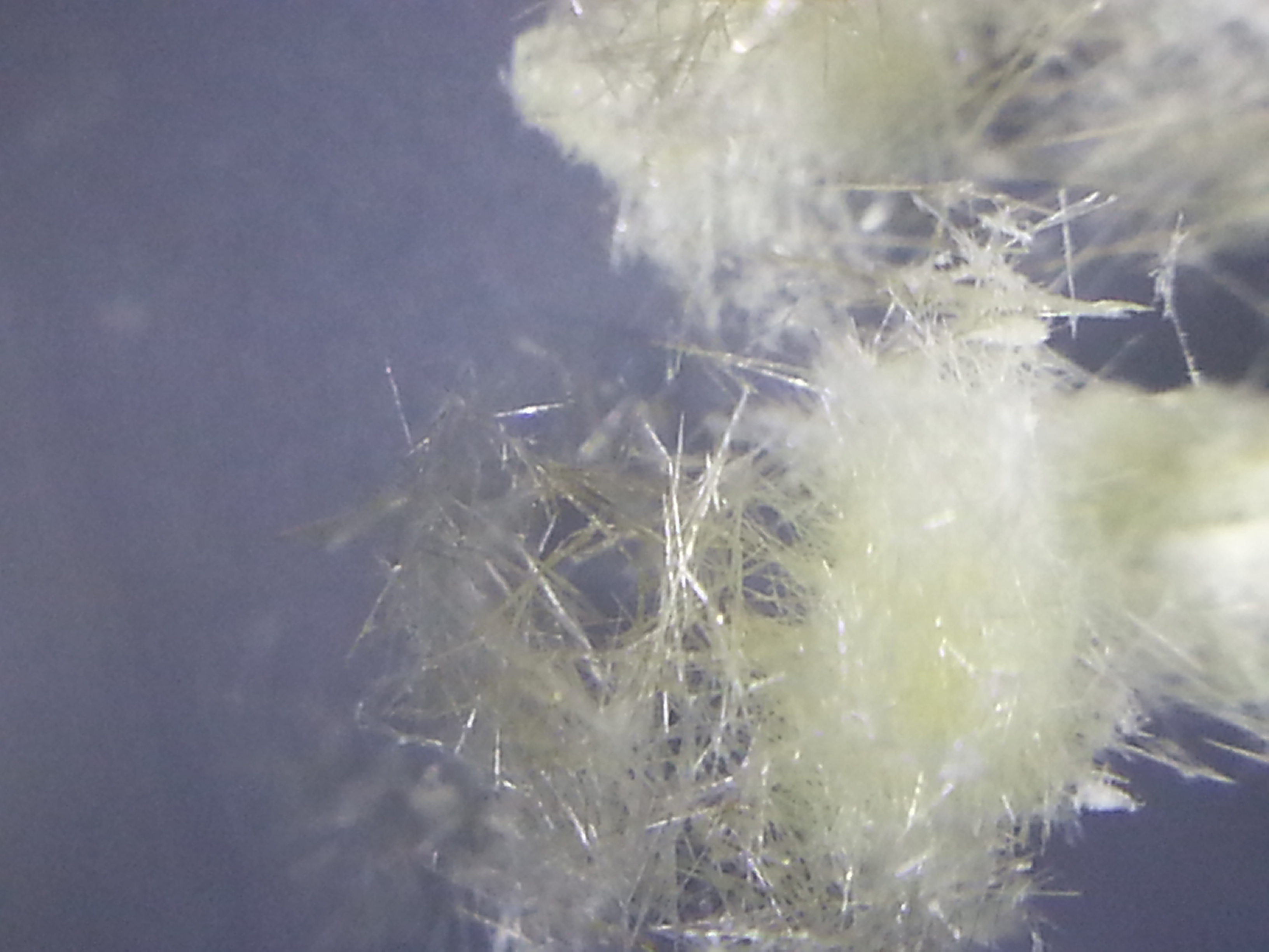

So I attempted a "poor person's sublimation" out of curiosity. This works very well for caffeine with a much higher mp/bp, so I figured I'd give it a go:
0.05g crude tryptamine was placed in the bottom of a glass petri dish and the lid placed on top. On the top of that lid was placed a beaker full of ice water. All of this was put on a hot plate on low. After a few minutes, the inside of the dish filled with white smoke, and the heat was turned off and the appartus allowed to cool.
0.0035g of white, spectacularly formed crystals were collected from the underside of the lid, and which smelled like a richer, more aromatic version of the crude extract. I figured the yield could be explained by the small amount of starting material (static is annoying!) plus oxidation (a certain amount of charring occurs, which could be limited by doing this in an inerter atmosphere). Regardless, this looked like a great way to make a very pure analytical standard, and I was so happy to share it with you...
Until I took the MP, which is less than 100c! I will further investigate, but unless my thermometer is just screwed up, I am very confused.

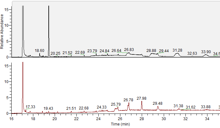

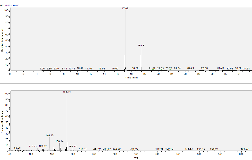

Here I present 2 pictures:
a) TA_raw.png: GC-MS raw TA, purity 82%. 17.09 min is TA, 19.43 min is the only impurity, which I observed. Rest of the peaks are
methyl siloxanes from septum and column. Spectrum of inpurity @19.43 min is on bottom picture. Library suggests following reasonable hits:
1,7-Trimethylene-2,3-dimethylindole
10,10-Spirocyclohexanotetrahydropyrimido[1,2-a]indole
Cycloheptan[a]indole
2-Methyl-1-(4-methylamino-1,3,4,5-tetrahydrobenzo[cd]indol-5-yl)-prop-2-en-1-ol
Carbazole, 1,2,3,4-tetrahydro-3-methyl-
1H-Indole, 4-(3-methyl-2-butenyl)-
b) TA_purification.png:
Here you can see what changed by oxalate purification. Impurity @19.43min from raw TA (above) was (almost) completely removed.
As before, peaks like 25.79, 26.78, 27.98, 29.48... are cyclic siloxanes (m/z 207, 281 and many other with difference always 74 = Si-O-(CH3)2).
I integrated area for TA (17.09min) and rest of impurity (19.43min) => purity of TA was 99.5%
My conclusions:
1) Even very bad raw TA (82% is really shit) can be converted to excellent purity by simple reaction with cheap
oxallic acid with reasonable yield.
2) There is still space for application of charcoal. My final TA was very lightly brown. Probably in the point 3a) when TA is
dissolved in CH3OH or in 3b) when TAox is dissolved in water.
3) Yield of TA. There is still space for optimizations. In point 3b) where TAox is dissolved in ~130 mL water, it will be probably better to reduce amount of water and use higher temperature (up to 70C).
Was not successful with purification of TA via carbonate salt. And lazy to buy vacuum pump / apparatus. Hope this will help someone and you will share experiences with TAox method here.
Enjoy your pure TA :cool:
TA_raw.png - 10kB TA_purification.png - 7kB
[Edited on 25-1-2018 by joe_chem]

Half a year ago I was making tryptamine by decarboxylation of tryptophan in acetophenone (at 150-180° bath temp).
Tryptamine was isolated and purified via oxalate salt (~50% yield).
Since melting point of obtained product was at 103-105°C, I decided to do futher purification by extraction with boiling hexanes.
It gave product that has a look of absolutely colorless crystals but it still melts at around 105°!
$#@#$?!1! :mad:
I am very confused as the literature gives melting point for tryptamine in ranges from 111 to 118°. Definitely not 105°C.
And I have no idea how to purify this obtained product further.
Recrystallization from MTBE and various aromatic hydrocarbons didn't helped with melting point at all. And vacuum distillation is not an option for me as I have no access to good vacuum pump.
[Edited on 29-3-2019 by bipolar]
