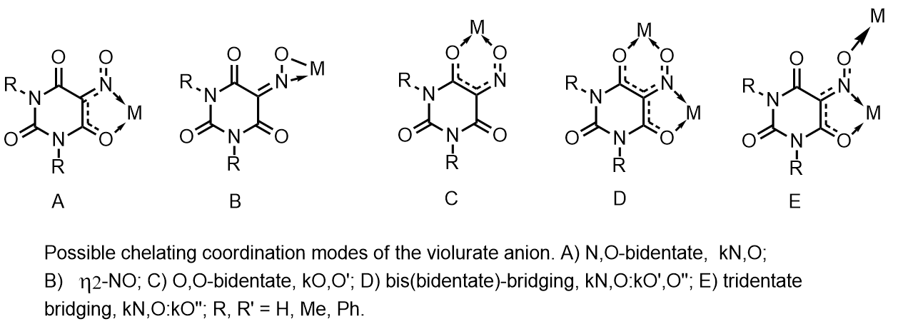

Violuric acid and its derivatives are very interesting and peculiar in many ways, for example, it very often forms supramolecular compounds, especially its organoammonium salts, which entail vast networks of complex hydrogen bonded networks. It is also a chelating acid which can be either monodentate, bidentate, or tridentate(depending on the counterion that it is reacted with) and has many different chelating modes which I will show with the structures below
Violurate_Coordination_modes.PNG - 41kB

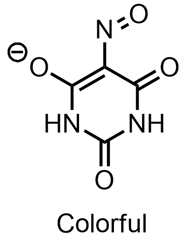

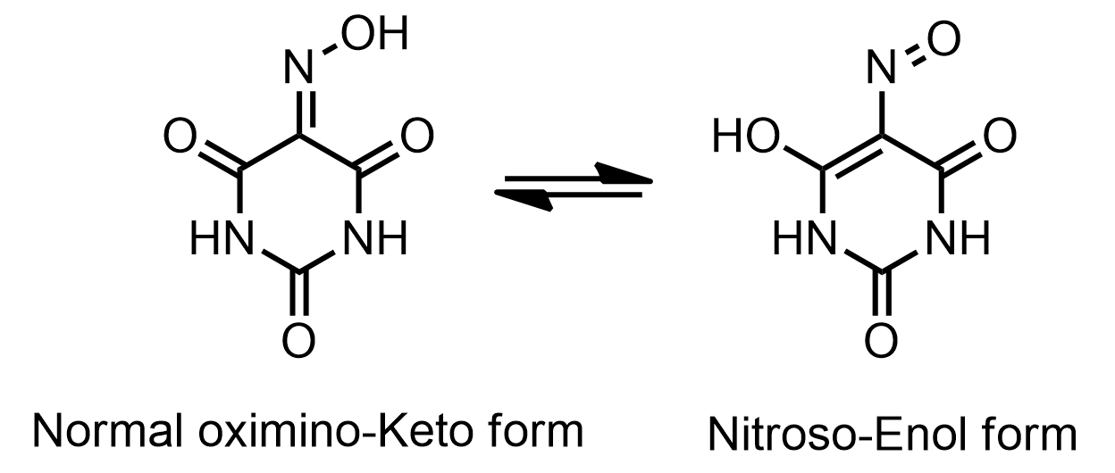

If you have ever made violurates before you have likely noticed a very odd interaction happens when the colorless acid is dissolved in water(or any protic solvent for that matter), it immediately turns the solution a very pleasing pastel pink color. I have heard many people think that this sudden color change is due to some sort of contamination being introduced, as the violuric acid is seemingly reacting with nothing, however that is not true. This light pink color is in actuality caused by the proton from the oxime(NOH) tautomerizing to one of the surrounding two ketones creating a nitroso group(N=O), and a COH group, as seen below.
Violuric_Acid_Tautomerism.PNG - 28kB

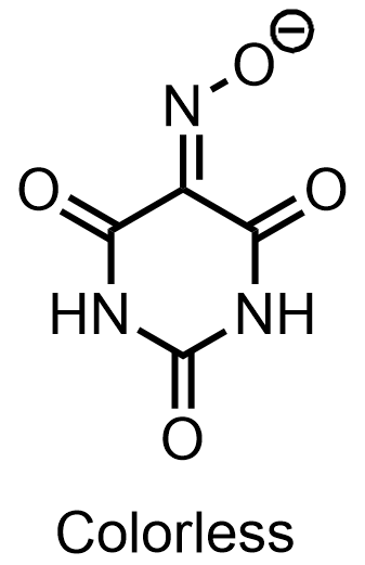

This more acidic nitroso-enol tautomer is indeed also responsible for the color that we observe with violurates. If you were to make a violurate salt that was only composed of a salt made from the normal oximino-keto form, it would likely be colorless, yellow or a dim orange.
Salt_of_Oximino-Keto_Form.PNG - 11kB Salt_of_Nitroso-Enol_Form.PNG - 11kB
Normally this more colorful, acidic, and strained nitroso-enol form is not favored(which is why it doesn't exist/isn't observed in the solid state in violuric acid and it is definitely the less occurrent tautomer when dissolved in water, though enough is still formed in solution to produce an observable color change) When a base is added to the solution on the other hand, this pushes the equillibrium towards the more strained, yet more acidic nitroso-enol form. Naturally, because of the nitroso-enol form's strain, it completely alters the absorbance of the salt that is formed, which equates to the highly varied and vibrant colors that we all know and love.

Those last two structures you've drawn aren't tautomers, but resonance structures, and you can't convince me that they'll have different colours.
Posts: 6239
Location: Unmoved
Mood: Organised
[*] posted on 18-3-2023 at 21:39
Let me paraphrase and see if I have this right.
The colour of volurate salts come from the conjugated double bonds when it resonates into an enolic form. The precise hue depends on both the geometry and the strength of the cation. The geometry is further affected by the possibility of differing chelation states and may also be affected by variations in crystalline structure arising from the conditions under which it crystallised.
I am not sure whether to agree with DA that we are talking about resonance not tautomerism here. Tautomerism involves movement of protons with the solvent as an intermediary in my understanding.
The ketone structure does not jump out at me as one that is likely to be coloured. But that could well be my ignorance.

Yeah, my mistake, what I was trying to show with the last two are the different salts that would form resulting from the tautomerization, even though the bonding is certainly more complex than that. Trust me, the last two would very much be different colors, although nitroso compounds are often very unstable and carcinogenic, they also have some of the most vibrant and beautiful colors resulting from this instability, again, because of the strained bonds. Whereas the oxime normally isn't a very colorful group. It is well known that the compounds which have true and stable nitroso bonds(N=O) are often very colorful and vibrant, and is known to influence compounds absorbance greatly, whereas the oxime one moiety(=N-O) which would otherwise be formed is typically colorless. So yes, their colors would be very different, because bond strain matters a lot with the colors of violurates. The crystallographic studies on violurates only proves this and that when reacting violuric acid with a base, it is the nitroso-enol tautomer that is forming the salt which is what gives violurates their color. I would recommend reading these papers that mention this phenomenon with violurates.

Edit: Sorry I wrote this post before I saw yours j_sum, and my reply was in response to DA, and yes, all papers I have read claims it is tautomerism, this is supported based on the fact that the violuric acid changes color(from the shifting of the protons) only in solution, and is colourless in the solid state. So the solvent is an intermediary and plays a large role in the color of the violurates, and it even matters which solvent you use.
Also, I dont believe the ketone form to be colorful either, I think it is the niitroso-enol form that is the main reason for the violurates color. However my view could certainly be wrong, but the literature I have found on it seems to support it. Your paraphrasal of my proposal is also very good lol, thanks for helping with clarity.

Well, I try to explain my opinion regarding tautomerism. It's actually a very good and important question.
This is clearly tautomerism. Why: Tautomerism is a special form of isomerism. So we have actually two different compounds that may also have different properties and show different behavior like e.g. colors but with the same empirical formula. But what classifies tautomerism is that one tautomeric isomer transforms relatively easy into the other but the molecule has to rearrange and is different as such and oxidation states usually change.
Sometimes the tautomers cannot be separated at all, sometimes one of them is more stable under certain conditions and the "pure substance" consists of only one of them. Best example is the keto-enol tautomerism where the keto form is usually (not always) more stable.
In this case the hydrogen atom (or the negative charge) changes its location to a different atom. That's what happens with violuric acid.
Resonance structures on the other side try do depict a more complex reality that could not be drawn by one single simple formula in certain cases with delocalized charges. Or you draw it as a so called hybrid structure. But the most important to note there is: It's always about the same molecule with identical properties and the oxidation states do not change (we have even kind of partial oxidation states, the concept of oxidation states is only a model anyway). Most prominent examples are aromatic compounds like benzene or the carbonate anion and so on.
Posts: 4282
[*] posted on 19-3-2023 at 09:09
The two forms of the acid are clearly tautomers.
files.php.jpg - 8kB
You've moved the hydrogen from one oxygen to another.
Once you take that hydrogen off, then the negative charge gets delocalized, and you have resonance structures. It's not tautomerism- you're not moving any atoms around. That's just resonance.
