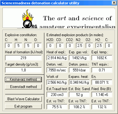

[*] posted on 27-7-2013 at 04:12
8100 m/s = HN3
3400 m/s = NH4N3
Hydrazine is detonable on it's own so the Azide is much more energetic than
Ammonium Azide. Guessing ∆Hf to be + 219 kJ/mol , and density of 1.8 g/cc
entering into Engager's Detonation Calculator Utility ( this link )
www.sciencemadness.org/talk/viewthread.php?tid=11195&pag...
obtains 7950 m/s for N2H4•HN3
According to this paper the vod of N2H4•HN3 is comparable to that of RDX at
the same density.
www.chemie.uni-muenchen.de/ac/klapoetke/content/research/pos...

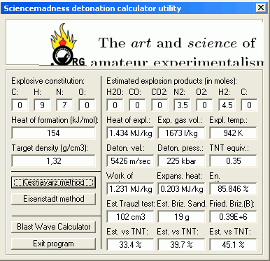

The Hydrazine adduct will have lower overall energy so the vod must be
substantially less. The density is given as ρ=1.32 g/cc here _
http://onlinelibrary.wiley.com/doi/10.1002/1521-4087(200110)...
Guessing ∆Hf to be + 154 kJ/mol and entering into Engager's Detonation Calculator Utility
obtains 5426 m/s for (N2H4)2•HN3
(N2H4)2HN3.gif - 14kB

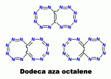

On a similar line as what PHILOU Zrealone proposes here _
www.sciencemadness.org/talk/viewthread.php?tid=1970&page...
Tetrabromoethylene with Lithium Azide should yield an aromatically stable
Br2C=CBr2 + 4 LiN3 => 4 LiBr + (N3)2C=C(N3)2 / / => N6C=CN6
Dodeca aza octalene.gif - 15kB
From what I understand his type direct substitution generally only applies to carbon
single bonded to another carbon , a primary alkyl. Secondary alkyl , those carbons
bonded to two other carbons are much less active for this type reaction. Tertiary
alkyl carbons are not susceptible at all. It is also the case with alkenes , carbon
with a double bond to another carbon. Alkenes are instead susceptible to breaking
a bond to add more atoms or groups. Aryl ( aromatic benzene ring ) carbons have
been demonstrated as alkyl carbons to be labile to substitution induced by catalytic
action of for example copper.
We know diatomic molecular Bromine and Lithium azide react violently on contact.
Bromine substitutes the azide and the bromyl azide formed dissociates. It seems
that minor activation energy would be required to induce a metathetical exchange
with Tetrabromoethylene a Colorless crystal that Melts at 55 ~ 56 °C ,
Boiling point 226 to 227 °C Insoluble in water, soluble in alcohol , ether and other
organic solvents. Bond dissociation energies indicate the reaction to be exothermic.
Approximate values are , C-Br = 80 kcal/mol , LiBr = 100 kcal/mol , LiN3 = 50 kcal/mol
C-N3 = < 80 kcal/mol
[Edited on 11-8-2013 by franklyn]
What I exposed was N4C2N4 with a naphtalene structure or N4C=CN4 with a bistetrazolene structure.
Both are fully aromatic and this means each N-N or N=N is nearly equivalent in bond lenght and in the aromatic plane of the molecule. The aromatic resonance has a stabilizing effect as seen with tetrazoles (heteroaromatic pentaring).
In your N6C2N6 molecule the octacycles are no more really aromatic (bended out of the plane and twisted) and some of the N-N or N=N becomes unequivalent what is the weakest link... This is very detrimental to the stability of high nitrogen content molecules with >3 polynitrogen atom chains.
So a site with -N=N- will more likely expell N2 (N#N) generating a lot of energy probably sufficient to trigger the detonation of the rest of the product...if the molecule survives the decomposition, there would be a chance it rearranges into the putative stabler molecule I thought about.
N6C2N6 --> N4C2N4 + 2 N2
Or the molecule will simply remain uncyclized as tetraazidoethylene. Tetraazidoethen would be (like tetracyanoethene or tetranitroethene) a good scavenger of electrons...electron charge transfer and it can be trapped by dienic structures CH2=CH-CH=CH2 (Diels-Alder reactions).
If tetrahaloethene is not reactive enough for the substitution, alternatively tetrahalo-1,2-dinitroethane will be...leading to a sensitive perfect OB HE...
O2N-CH2-CH2-NO2 --Br2 or Cl2/mild base--> O2N-CBr2-CBr2-NO2 or O2N-CCl2-CCl2-NO2
By vitue of the close relationship to chloropicrine, those nitro-halogenated compounds must be considered highly toxic agents.Their halogen are labiles because of the nitro group vicinity.
O2N-CX2-CX2-NO2 --NaN3/solvent--> O2N-C(N3)2-C(N3)2-NO2 + 4 NaX
Those polyazido-nitro compounds will probably display the same kind of hydrolysability than their halogen cousins leading to toxic HN3 gassing and be hell friction/shock sensitive. Azido group being a pseudohalogen...
[Edited on 27-8-2013 by PHILOU Zrealone]

Franklyn: Take a look at the introduction of my article here (http://pubs.acs.org/doi/abs/10.1021/ja310384y?journalCode=ja...) for a quick overview of why such a system is unlikely to be stable and for general considerations in the design of long-chained nitrogen species.
The electron-rich nature of such a ring allows the donation of electron density from the N-lone pairs into the N-N sigma antibonding orbitals, destabilizing the ring to the point of (likely) non-existence. This is why unsubstituted 1,2,3,4-tetrazines are so rare (1 example lit). However the key to long-chain nitrogen systems is the removal of LP electron density on alternating N atoms within the chain, increasing the energy difference between these orbitals and stabilizing the system. This is why 1,2,3,4-tetrazine-1,3-dioxides are so much more stable.
Your species is likely analogous, so in the event that 3 oxides can be introduced to each ring, it may be more stable. It would also then have a positive OB.
