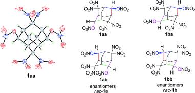

[*] posted on 20-2-2015 at 11:33
4,4,8,8-Tetranitroadamantane-2,6-diyl Dinitrate: A High-Density Energetic Material
Yifei Ling, Xiaoli Ren, Weipeng Lai and Jun Luo
European Journal of Organic Chemistry, 2015; An ASAP article first published online (22. Jan. 2015)
DOI: 10.1002/ejoc.201403449
PHILOU Zrealone
Posts: 2894
Registered: 20-5-2002
Location: Brussel
[*] posted on 22-2-2015 at 12:23
Thanks Nicodem,
Just for those curious about it:
Quoted from the link:
Abstract:
The novel high-performance energetic material, 4,8,8-tetranitroadamantane-2,6-diyl dinitrate has been synthesized and fully characterized. The synthetic strategy features the construction of the adamantane skeleton with different functional groups at adjacent methylene carbon atoms to overcome the problems associated with the ortho effect and steric crowding, and is amenable to the synthesis of other polynitroadamantanes. The experimentally determined physical properties as well as the calculated detonation properties indicate that this compound exhibits high thermal stability (220 °C), high density (1.852 g /cm³), and excellent detonation velocities (8529 m /s) and pressures (33.43 GPa).
And for those who likes it with images:
4488-Tetranitroadamantane-26-diyl-dinitrate.jpg - 14kB
I think the 2,2,4,4,6,6,8,8-octanitroadamantane would be also interesting and there are two methylene left free that would render possible the making of a tetranitroadamantane-tetrayl-tetranitrate or a dodecanitroadamantane with each methylene holding two nitro groups...
PH Z (PHILOU Zrealone)

[*] posted on 20-3-2015 at 12:03
Thanks Nicodem,
Abstract:
The novel high-performance energetic material, 4,4,8,8-tetranitroadamantane-2,6-diyl dinitrate has been synthesized and fully characterized. The synthetic strategy features the construction of the adamantane skeleton with different functional groups at adjacent methylene carbon atoms to overcome the problems associated with the ortho effect and steric crowding, and is amenable to the synthesis of other polynitroadamantanes. The experimentally determined physical properties as well as the calculated detonation properties indicate that this compound exhibits high thermal stability (220 °C), high density (1.852 g /cm³), and excellent detonation velocities (8529 m /s) and pressures (33.43 GPa).
Article is to be found here
4488-tetranitroadamantane-26-diyl dinitrate
Thanks to Mayko via request in References/ Wanted References :D
[Edited on 20-3-2015 by PHILOU Zrealone]

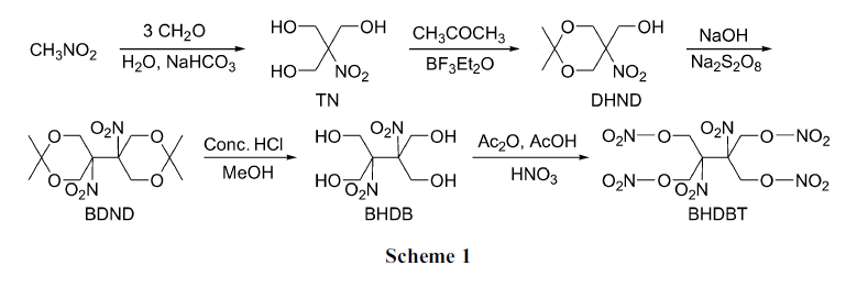

Mr.Greeenix
Posts: 40
Registered: 8-4-2015
[*] posted on 10-4-2015 at 09:25
hi community
somebody mentioned the Energetic Nitrate Ester : / 2,3-Bis-hydroxymethyl-2,3-dinitro-1,4-butanediol tetranitrate / the synthesis isn't that difficult if you have / 2,2-Dimethyl-5-nitro-1,3-dioxan-5-yl)methanol / needed for the first synthesis.
I found a chinese PDF about this explosiv Attachment: phpJ8WtHo (540kB)
This file has been downloaded 2630 times
started from Nitromethan nitromethan-.PNG - 22kB
Maybe someone is able to write a synthesis???:)
Star from 2,2-Dimethyl-5-nitro-1,3-dioxan-5-yl)methanol
Attachment: Synthesis of an Energetic Nitrate Ester.pdf (2.5MB)
This file has been downloaded 1368 times
[Edited on 10-4-2015 by Mr.Greeenix]
Microtek
Posts: 994
Registered: 23-9-2002
[*] posted on 10-4-2015 at 12:47
Synthesis of 2,2-Dimethyl-5-nitro-1,3-dioxan-5-yl)methanol is very easy if you have nitromethane and 2,2-dimethoxypropane (the dimethyl acetal of acetone) along with some (para)formaldehyde and a few common reagents. There are patents for making the 2,2-dimethoxypropane from acetone and the alcohol, but I never got it to work beyond trace amounts (enough to smell, but nothing more).
PHILOU Zrealone
Posts: 2894
Location: Brussel
[*] posted on 10-4-2015 at 14:25
The synthesis is even easier from 1.2-dinitroethane and formaldehyde...
O2N-CH2-CH2-NO2 + 4 CH2=O -base-> (HOCH2)2C(NO2)-C(NO2)(CH2OH)2
Based on the same principle as nitroisobutyl-triol from nitromethane and formaldehyde...
CH3-NO2 + 3 CH2=O -base-> (HOCH2)3C-NO2

I put the detailed syn. of / 2,2-Dimethyl-5-nitro-1,3-dioxan-5-yl)methanol / from the chines paper in a translater.
That's my result.
(sorry for the realllly bad English) Maybe someone can translate it into good English;)
methyl nitro-methane (TN):
In the bottom flask fitted to 37% of the formaldehyde in water (327.5 G, 4
mol), and water bath heated to 50 degrees C, add the appropriate amount baking soda to adjust
pH 8.0 sites, increase the temperature to 55 degrees C, drop the nitro-methane (76.9 G, 1.25
mol), and maintain pH sites 8.5, the contribution that the agitation response 40 min to drop to a 10%
of the sulfuric acid adjustment response fluid pH sites 5, heating the reaction fluid temperature up to
80 degrees C, reducing enrichment, cooling, and by a large white needle-like crystals, the
Filter, vacuum drying, and in 3 of methyl nitro-methane 160.8 G / yield 85.2%. / m.p. 152~153 Celsius / C4H9NO5
2,2-Dimethyl-5-nitro-1,3-dioxan-5-yl)methanol:
Adds three methylol nitromethane in the round flask (120.8 g, 0.8 mol), acetone (176.4 mL), stirring,
heating in water bath to 60 degrees Celsius. After three hydroxy A base nitromethane dissolve
completely, ices the water bath to make the solution cool to 10 degrees Celsius by below, the
separation massive acicular crystals. Adds by drops the boron trifluoride etherate solution
(189.8 g, 0.84 mol), Canada finishes, responded 5 min the heating in water bath to
50~55 degrees Celsius, will respond that the fluid poured into the sodium hydrogencarbonate in the
ice water saturated solution, stirring, regulator solution pH close neutrality, pulled out filters
the white solid, the ice water washed 2 times, after the vacuum drying,
2,2- dimethyl - 5- methylol - 5- nitro groups - 1,3- two oxygen mixed hexamethylene 133.1 g,
yield 87.1%. m.p. 130~131 degrees Celsius; C7H13NO5
The only problem is "Boron trifluoride diethyl etherate" but I think some are able to buy it.

Oh, OK. Tris-nitro (tris(hydroxymethyl)nitromethane) is easy to make in high yield. It is used as a biocide, and there are lots of patents on its preparation.
The second step, I found to be not so easy. In the end I just ordered the 2,2-DMP through Sigma-Aldrich after having tried (unsuccesfully) to synthesize it myself. There are patents about that part also, but in my experience they didn't work as advertized.
