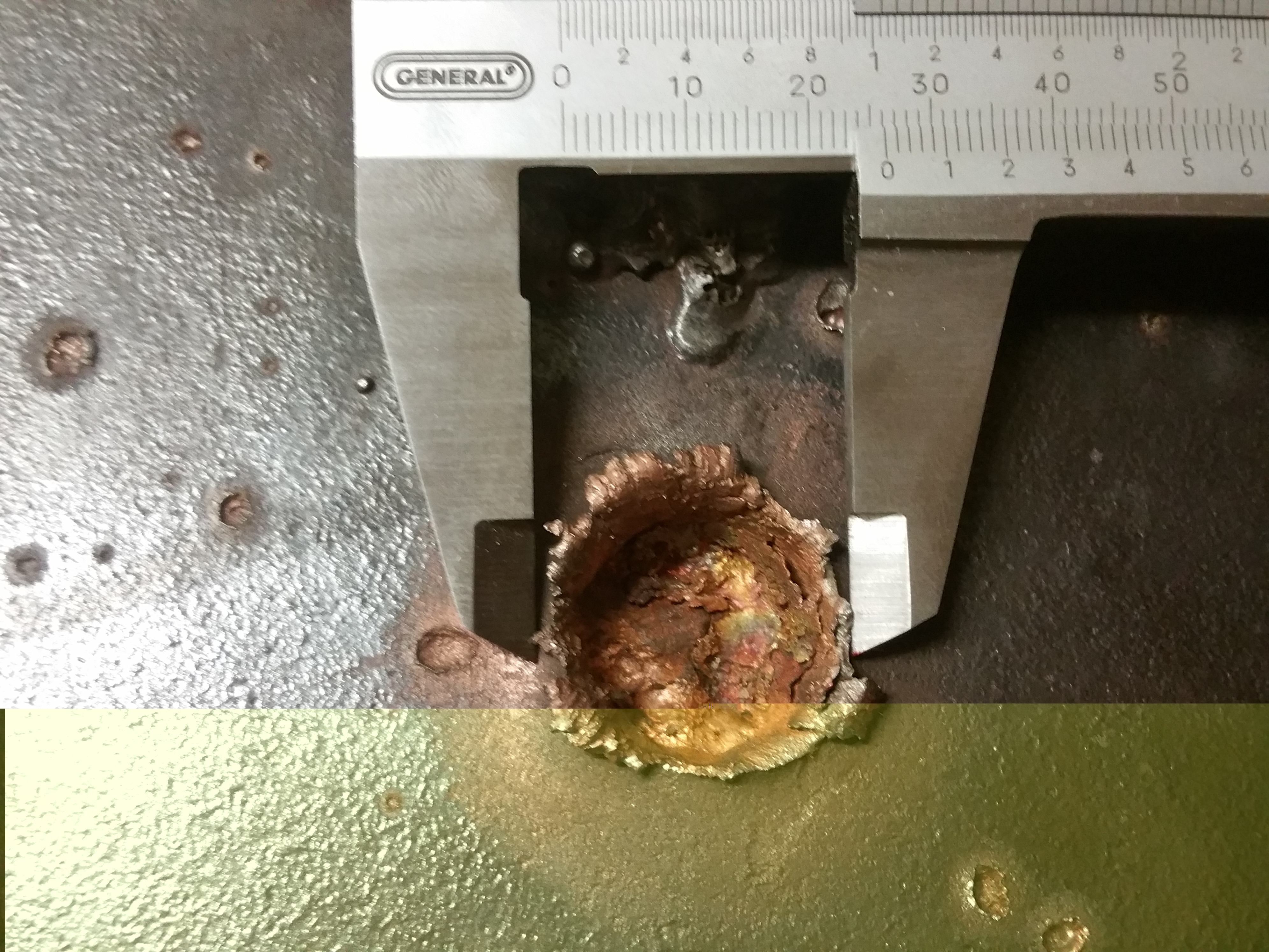

Attempted penetration of a 19mm steel plate with a new batch of plastic explosive but no good effect.
EFP was 30mm diameter 60 cm standoff and 17 g charge weight.
Only 12 mm penetration. I even placed some ballistics gel behind the plate to see effects on the other side:mad:
I think it is bad plastic because I added the PETN/acetone mix too fast to ice water whereas I usually add slowly. The fast addition resulted in still a fluffy non-granular product which didn't roll easily. This meant I used more binder/plasticizer which has affected VOD quite badly. There is a visible flame for a second during detonation that is not usually there.
I rolled 150 grams too which is a shame, maybe I can use it to attempt to catch the EFP slug in the next test as it looks like it is still forming the slug okay.
[Edited on 1-10-2015 by greenlight]
20150929_152604.jpg - 9.7MB 20150929_152622.jpg - 7.5MB
20151001_200015.jpg - 3.6MB

Too bad greenlight, looks a nicely formed efp though, it would have made a mess of that gel if it had made it through I'm sure, are you going to bump the charge weight up by much for the next try?.
greenlight
Posts: 767
Registered: 3-11-2014
[*] posted on 1-10-2015 at 05:22
I think I will use 20 to 24 grams next time but I think it should have penetrated more than 12mm. The last EFP with the same specs went straight through the 10mm steel with hardly any sign of loss of velocity.
I am convinced it is the plastic explosive having too much inerts and fluffy PETN as you should be able to see the flame on camera at normal speed.

I know that curvature of the liner and the head height of the explosive affect the elongation of the liner. I think I am getting quite wide slugs instead of more elongated shaped because the explosive height in the charge above the liner is only .75 the diameter of the liner. This is because of the density of the PE though its rollled for several hours to about 1.45-1.49.
This metal cross idea sounds interesting. I will look for patents documenting it if it too affects the elongation of the liner it could be useful. I always thought altering the back of the liner having it thicker in parts would make it break up when subjected to a detonation wave.
The projectile in the picture you just uploaded is the perfect shape for penetration and is the most well-formed I have ever seen. I wonder how they caught it in that state:o

Try a little more curvature greenlight it will push the efp more towards a jetting formation and will make a smaller projectile and more penetration .
