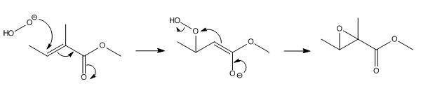

I know the mechanism for epoxidation of olefins with peracids - the problem is that this alkene is electron deficient (due to the carboxylic acid group - its a,b-conjugated) and so should react best with basic H2O2. Steve's suggestion of using methoxide is a good one - with a large excess of methoxide the reaction should work nicely, but as hydroxide is a product of the epoxidation then it begins to hydrolyse the ester - keeping the methoxide concentration high will minimise this (I'm thinking >5 eq.?). I'll attach the mechanism for this reaction:

I'm sure I have a couple, I'll check my books in a sec. Arrhenius - I think you will find that m-CPBA will not work here, the substrate is an a,b-unsaturated ester meaning that the "alkene portion" is electrophilic rather than nuclephilic - as such it will not attack the m-CPBA (thats the first step of the concerted reaction - the alkene "reaches out" and attacks the oxygen). I have already mention this upthread.

I trust you are capable of getting these yourself - they seem to be for a,b-unsaturated acids and ketones, but esters should react the same as departure of the alkoxy group would yield a ketene (follow the mechaism and you'll see what I mean).

Arrhenius - I see your point. However a nucleophilic HO-O(-) species is likely to react with the michael acceptor at a much higher rate - the long reaction times should not be needed, and if NaOMe is used as the base then hydrolysis should not be that much of a problem. Albeit still a problem.
