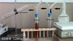

So for example if im reacting KMnO4+ConHcl to produce Cl2 gas and collect it using a tube fitted into a sealed rubber cap of test tube how can i make sure if the gas gets out it goes into NaOH and thanks for the lovely reply

You could use a 2-hole stopper instead, so the gas would come in one hole and exit out the other to end up in the neutralizing solution. Here's a screenshot from my latest video to illustrate:
example.png - 499kB
The arrows are the direction of gas flow. That's for a different experiment than yours, but hopefully you get the point. I was producing nitrogen in the generator, drying it in the gas wash, and collecting it on the left. The suckback trap is an empty test tube between the different containers, in case the pressure changes and liquid is "sucked back" through the system. That stops the contents of the test tube from getting into the gas generator, and vice versa.
Edit: It's not very clear in the picture, but the glass tubes going through the stopper in the suckback trap don't go very far past the stopper. The right tube in the gas wash goes all the way to the bottom of the liquid, and the left tube stops right at the stopper. This forces the gas to bubble through the whole column of liquid in the gas wash. The short tubes in the suckback trap prevents anything from leaving the trap if it happens to get in there.
Your own setup depends on what exactly you are trying to do, of course! What "halide test" are you doing? Can you describe the procedure?
