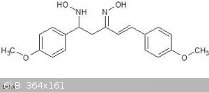

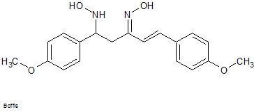

I am trying to prepare the reagent for tungsten described in this paper:
Attachment: Tungsten with Anti-1,5-di(p-methoxyphenyl-1-hydroxylamino-3-oximno-4- pentene JAnalChem Yoe & Jones 1944 p45-48.pdf (632kB)
This file has been downloaded 301 times
Tungsten reagent.jpg - 6kB
As you can see from the paper, they have not published the preparation but on examination of the structure it looks like it is the oxime of di(4-methoxybenzal)-acetone with an extra hydroxylamine group added across one of the double bonds. I can imagine all sorts of complex routes to this compound but my gut feeling is that it simply results from the treatment of a dibenzalacetone type compound with excess hydroxylamine.
Has anyone ever come across such a reaction before or have any ideas about this possible reaction and the conditions which might favor it? Alternatively can anyone see an alternative route that looks realistic?

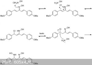

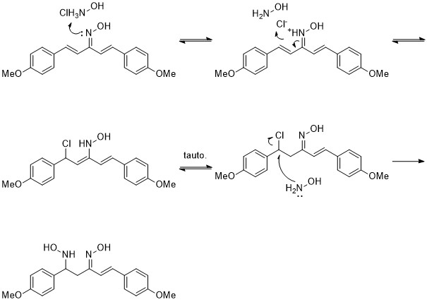

[*] posted on 31-8-2019 at 14:41
That could be possible. Nitro-aldol condensations occur easily with amine bases. Maybe you could even do an acid condensation using hydroxylamine hydrochloride, see attachment.
