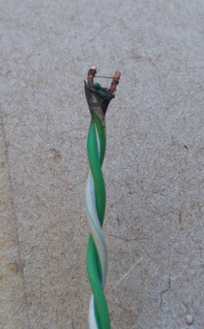

I use Nichrome doped with lead styphnate and Nitro cellulose.
Going to make a spot welding rig for welding the bridge wire, I have all so used steel wool strands soldered on, but much more delicate to apply doping mixture to some times.

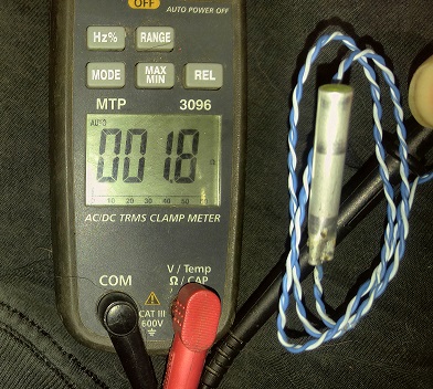

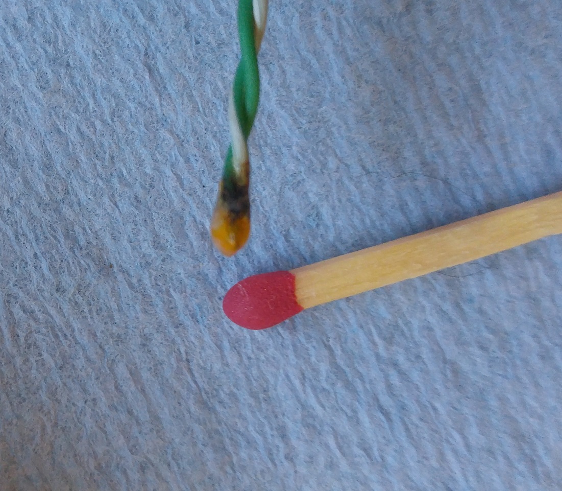

it fires with a very solid crack
My preferred doping method is to have a thin gel, dip assembly in that, then dust with priming agent, then dip in a thicker gel to coat the priming compound. this protects every thing from moisture, air, movement. Makes for a very sturdy and reliable E-match.
NL dip 3.jpg - 366kB Primed wire.jpg - 309kB 1.5ohm bridge wire.jpg - 255kB
[Edited on 28-9-2019 by XeonTheMGPony]

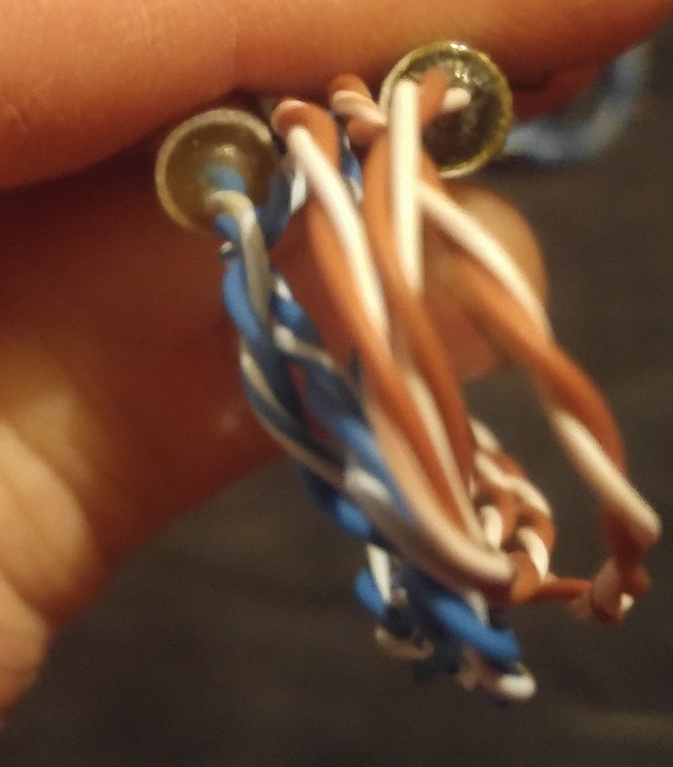

[*] posted on 28-9-2019 at 20:23
I was never a fan of fuses for the most part, so all ways preferred electrical, so much more reliable and safer.
20190928_220107.jpg - 85kB20190928_215741.jpg - 104kB
