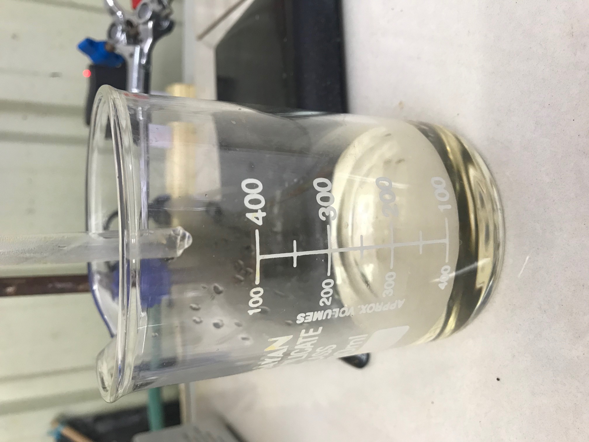

Continuing the quest to make a pink compound (on request of my daughter!) I had a go at Manganese iodide.
I first tried reacting Mn powder with I2 in Xylene (as I recently made Antimony Iodide) but after 90 minutes nothing seemed to have happened. Poormans Chemist then suggested I try in water. And this worked.
- 100ml water in 500ml beaker
- 2g Mn powder
- 5g I2 granules (or should I say crystals??)

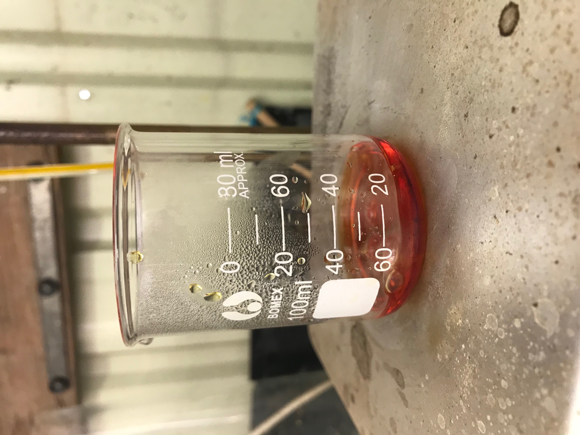

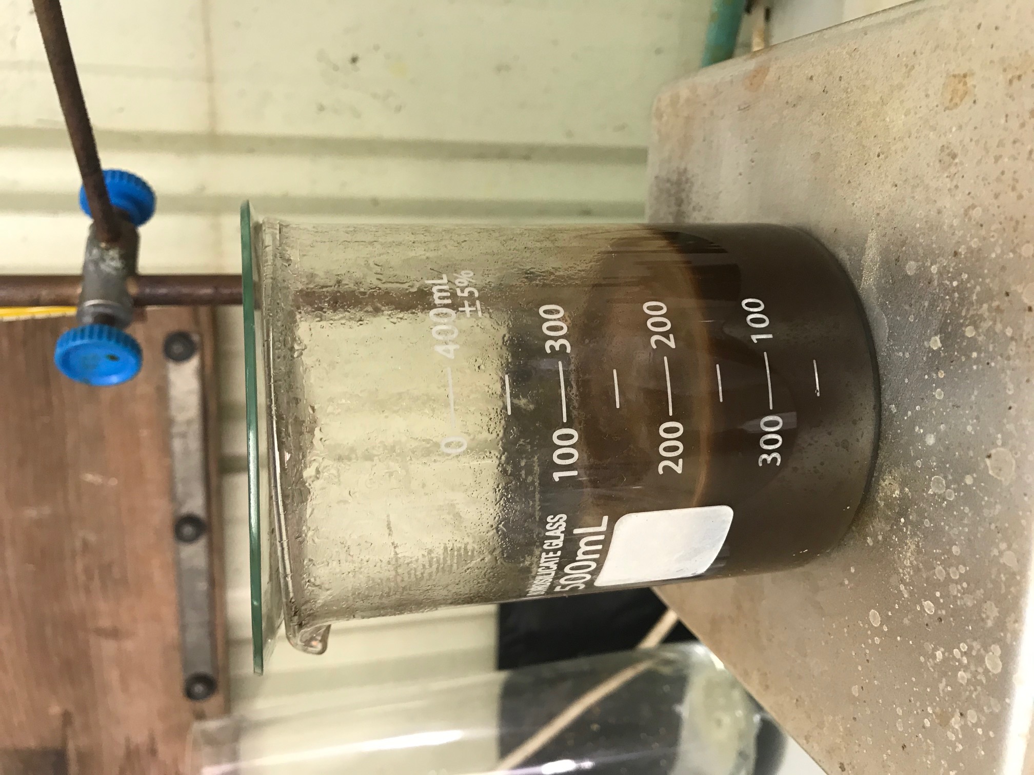

The reaction started even before I started to stir or heat up the water!
- Stirred at high speed and heated to around 50 deg C. Solution was initially dark grey / almost black but turned dark brown after 8 minutes.
- Decided to add more now that it appeared to be doing something. Added 6g of Iodine first; some purple Iodine vapour observed. Added another 3,3g Manganese powder, Iodine vapor stopped almost immediately and after a few minutes solution turned dark brown again.
- Stirred for another 10 minutes. Increased the temperature to near boiling to see if any more free Iodine was present but no vapors.

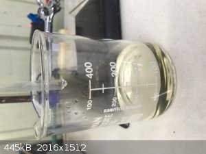

- Filtered the hot solution. Filtrate was clear, like water.
- Started to boil down and also tested a few ml of the clear filtrate in a test tube with a solution of lead nitrate. A bright yellow precipitate of lead iodide, happy days!!
- Solution color became more yellow-pinkish as it was boiled down. Volume less then 10ml when some crystal film started to form.

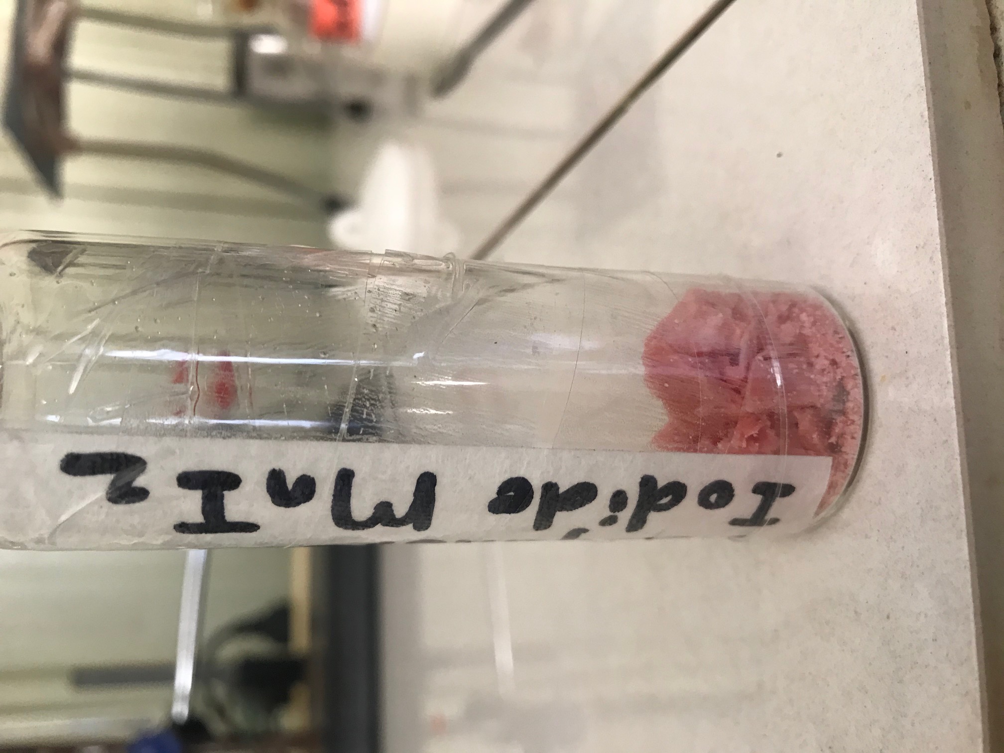

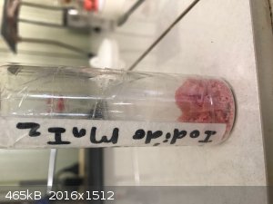

- Transferred to an ice bath. It very quickly solidified in to a pink layer that was as hard as a rock! Heated up again till liquid and poured onto a mortar. Agitated with a stainless spatula while it cooled down but it again became rock hard. Used a big flat screw driver and brute force to break up the MnI2, Transferred to a small vial.
- Final recovery 9.6 gram.
The MnI2 is hygroscopic. Small pieces around the bench that spilled during the breaking up each became wet after some time.
If anyone can advise a technique to use when working with salts that dry rock hard to avoid the struggle of having to get it out from the drying dish please share.

Nice synthesis. Given the pink color of your product, you also succeeded in getting a product of decent purity.
Most likely this is not MnI2, but some hydrate of it, MnI2.nH2O (I don't know n).
The color of this compound is darker than that of MnCl2.4H2O, but this is quite common with colored iodides.
Rather than crashing out crystals,
why not let the salt crystalise slowly by room temperature evaporation of the water ?
(start with the solution slightly less than saturated at RT)
this way you get larger, purer crystals - eventually.
Depending upon conditions it could take several days,
and your daughter can watch the crystals growing day by day.
This method will normally produce the fully hydrated form.

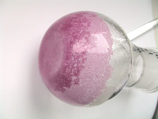

Further to pink compounds, I can advise you take some Cr(III) solution and add a slight excess of ammonium paramolybdate, (NH4)6Mo7O24, which goes through a spectacular series of colour changes and ultimately crystallises as deep pink crystals of (NH4)6[Cr(MoO4)6].

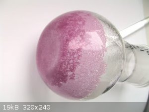

Cr(III) hexamolybdate IMG_4257_adj.JPG - 19kB
bis ethylenediamine Ni(II) IMG_9273_adjFM.JPG - 14kB

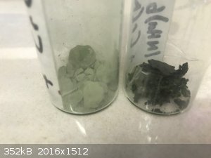

Bezaleel I gave it a go but with unexpected results. But let me immediately add that I did not follow the procedure as per the link you supplied all that well:
-The app I use for stoichiometry did not accept the equation so I just took a stab as a first try: I dissolved 3g of (NH4)6Mo7O24 in 60ml water and 2g of Cr(NO3)3.9H2O in 50ml water. Note this was at room temperature which is my shed was 32C yesterday.
- Mixed the solutions. Color briefly went lighter green then very dark green again.
- Waited some 20 minutes while stirring but did not see a color change to grey.
- Heated to 70 for a while but the color more or less stayed very dark.
- Cooled down to room temp (32), still very dark.
- Boiled off until signs of precipitate appeared
- Cooled and filtered.
- Left on the filter paper was a light green powder, this dried quickly at room temperature. Dry light green powder was 1.9 gram.
- The filtrate was a beautiful dark green. This quickly semi-dried to a dark green sticky paste but did not dry any further overnight. Placed on watch glass on boiling beaker the next morning and ended up with 1 gram of dry very dark green product. I wonder if this is just unreacted Cr(NO3)3, seems a similar color.
What I find interesting is that the post you reference also says a apple green precipitate resulted, but that others were not able to replicate this color (if I understand the Dutch correct); but it seems mine went the apple green way.
Any thoughts what the light green and the dark green compounds can be? I also half expected to smell acid or maybe see nitrous oxide fumes during the boiling off but nothing else was obvious apart from steam.

Hi Lion850, what seems to have happened is that you used an excess of Cr3+. The ratio Cr : Mo = 1 : 6 in the final product. Excess molybdate or Cr3+ stay in solution. I never tested properly what happens when you use different ratios, but I obtained the deep green solution also, when I used too little heptamolybdate.
Taking a molar ratio of 6 heptamolybdate (dihydrate) to 7 chromium, you will need 2.65 g of heptamolybdate for each gram of chromium(III)nitrate nonahydrate. (Molar masses are 1235.86 and 400.21, the latter taken from the English Wiki.)
One thing to note is that if you heat the solution, and Cr is not longer present as Cr3+(aq), it has a tendency to passivate (at least, for this particular complexation reaction). This may explain the green powder you obtained (probably Cr2O3 or a hydrate). I suspect that this is also what was obtained in the early publication and what the authors named "apple green", although I would not personally call this colour apple green.
