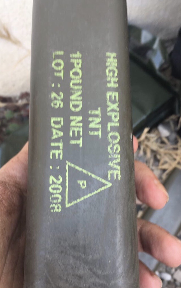

My new 1 pound TNT
This is my new TNT
now I will be able to test composition B and pentolit!

I am jealous

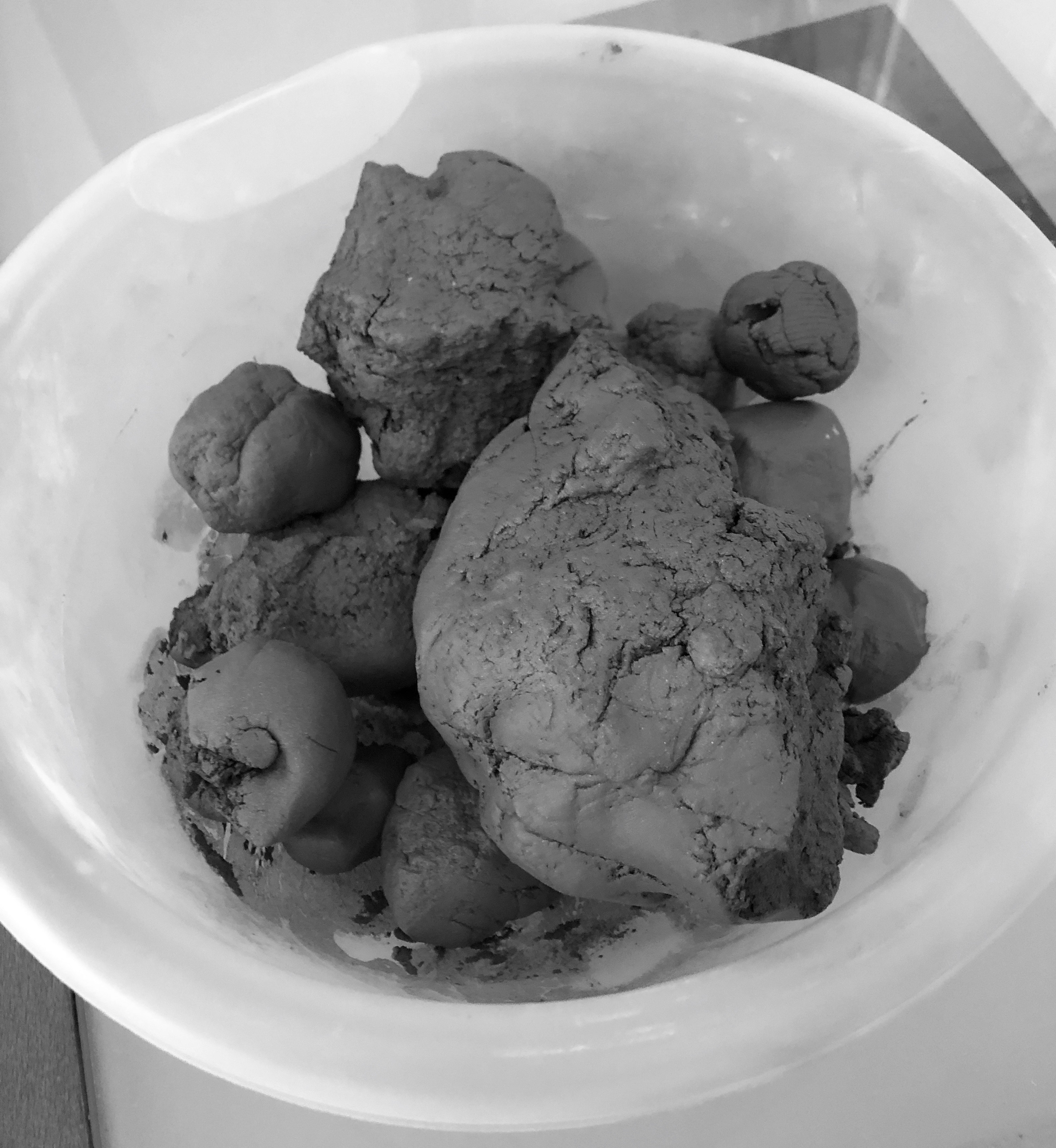

I see your 1 lb of TNT
and raise you 2 lbs of 1.9 RE Thermobaric Composition.:)

Woow
looks cool , what is this?

It's my Thermobaric Comp.
ETN 55.00 (g)
Al(3μm/) 12.00
Mg/Al(44μm/325mesh) 18.00 (50/50 mix)
Soy Lecithin(liquid) 0.300
lmwHTPB Resin 11.69 (lmw=Low Molecular Weight)
Isodecyl Pelargonate Plasticizer 0.73
Modified MDI Isocyanate Curative 1.84
CAO-5 Antioxidant 0.44
