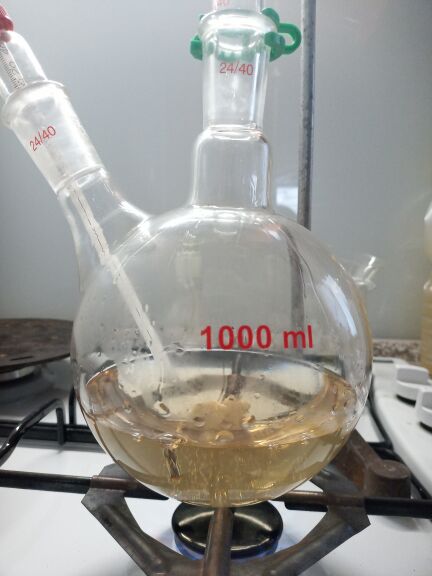

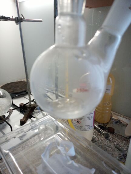

I would like to write my own opinion.
The inert gas is probably unnecessary. Seems water steam expels air and oxygen quickly. Keeping T below 260 C seems to be more important.
I will post more when completing everything, here just a few pictures (after 6 rounds still no tar, just orange color).
Writing this with still tears in my eyes, secretion from nose and irritated throat (though I even led a hose from the apparatus output to outside of building) :-D
Now I know why the commercial allyl alcohol I've bought recently came in a sealed ampule.
After 3 rounds:
IMG_20200217_135928_8_sm.jpg - 41kB IMG_20200217_135935_9_sm.jpg - 28kB
After 6 rounds:
IMG_20200217_193553_6_sm.jpg - 39kB IMG_20200217_193600_2_sm.jpg - 30kB

Reagents: Glycerol (anhydrous, I used pharma grade 99,5%), formic acid 85% (I used analytical grade, but technical grade should work too).

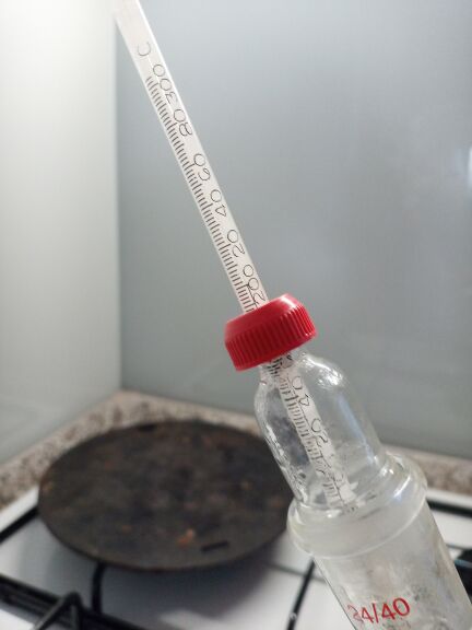

Apparatus: 2-neck 1000 ml RBF round bottom flask, 300 mm vigreux colum, 75' thermometer distillation adapter, thermometer adapter, thermometer upto 110 C, thermometer upto 300 C, 300 mm Liebig condenser, VACUUM TAKE-OFF ADAPTER (!!! THIS IS VERY NECESSARY !!!), A HOSE LONG ENOUGH FROM THE VACUUM TAKE-OFF ADAPTER TO THE OUTSIDE OF BUILDING (!!! THIS IS VERY NECESSARY !!!), 2-neck 250 ml RBF + 1 stopper (to open the flask only when removing the distillate, the distillate is removed by such a way that the stopper is removed, rotating the vacuum take-off adapter holding the flask, the distillate poured from the side arm of the flask, the flask quickly stoppered again and the adapter with the flask rotated back).
Method:
To the 1000 ml RBF were placed boiling chips, 330 g of anhydrous glycerol and 100 g of 85% formic acid (the amout of acid ranged in 96-104 g it is not critical), mixed well. A HOSE WAS CONNECTED TO THE VACUUM TAKE-OFF ADAPTER AND WAS LED TO OUTSIDE OF BUILDING.
The thermometer upto 300 C was placed in the side arm of the RFB and submersed into the liquid with its bulb close to the flask bottom so it stays submersed even when the volume of reactants decreases due their consumption during the reaction. The thermometer upto 110 C was inserted into the 75' thermometer distillation adapter.
The flask was heated with strong flame using gas burner. It is suggested that the first distillate (water and formic acid) distills in 15 minutes and the T inside flask reaches 195 C in 30-45 minutes when the product (allyl alcohol) starts to distill. It is hard to estimate the intensity of heating because it is different for the first round when all glycerol present and certainly lower flame required during the third round when a lot of glycerol already used up. When the heating is too strong (boiling in 5 minutes and product distillation in 15 minutes) it seems to have negative impact on the yield too, apparently less glycerol formate esterified and more of formic acid just distilled out of the reaction mixture.
The distillate coming when the T in the reaction mixture is below 195 C contains mostly water and formic acid, perhaps it is worth to recycle formic acid from it.
When the T of reaction mixture reaches 195 C the dropping from condeser ceases temporarily and T inside reaction is increasing, at some point the distillation resumes again at a speed of 1-2 drops per second (the product). It is hard to estimate this point just from the 110 C thermometer in the distillation head which is unstable at this point - if the heat is too strong the CO2 coming from the reaction is too hot so the T could reach even 110 C which is undesirable (I tried that) although b.p. of allyl alcohol is 97 C and azeotrope of allyl alcohol with water b.p. 88,89 C (72,3% alcohol). On the other side when the rate of distillation is too slow the T could indicate even less than 80 C which is caused by a condensation above the thermometer bulb so then by cooled drops running down to the thermometer bulb. Don't rely on the thermometer in the distillation head too much, the more important thermometer is the one submersed in reaction mixture (thermometer upto 300 C) - without this thermometer it is almost impossible to determine the point when water stops to distill and product starts and when the formic acid is used up and the flame should be turned off (though I tried that - no success, every round has different amount of reactants, different flame strength, some air blowing or with different temperature around unisolated column caused by different hour of the day, etc).
So when the T of the reaction mixture reaches 195 C, remove the water+formic acid (about 45-55 ml) from the flask capturing the distillate (without detaching the flask - just rotating the take-off vacuum adapter with the flask and using side arm of the flask to pour off the distillate) and start to collect the allyl alcohol, when the T reaches 260 C turn the heating off and let the mixture to cool down (few drops of the product will still pass through the condenser on cooling down the reaction mixture). About 65-105 ml of the product obtained (less product when heating was too strong and also when the heating too week then acrolein formation with negative impact on the yield too).
When the T decreases to 100 C, add second portion of the formic acid (100 g) and repeat.

reactants
IMG_20200217_092708_7_sm.jpg - 42kB
apparatus - !!! note the hose from the vacuum take-off adapter must lead to the outside of the building !!!
IMG_20200217_082227_1_sm.jpg - 33kB IMG_20200217_082309_4_sm.jpg - 41kB
first round: 330 g glycerol + 102,3 g formic acid
IMG_20200217_085758_7_sm.jpg - 32kB

already collecting allyl alcohol as a distillate
IMG_20200217_092218_7_sm.jpg - 20kB
allyl alcohol still passing as a distillate
IMG_20200217_093111_5_sm.jpg - 19kB IMG_20200217_093542_6_sm.jpg - 27kB IMG_20200217_093559_1_sm.jpg - 16kB
allyl alcohol distillation going to finish for this round No. 1
IMG_20200217_103500_4_sm.jpg - 19kB IMG_20200217_103518_8_sm.jpg - 15kB IMG_20200217_103532_5_sm.jpg - 23kB
