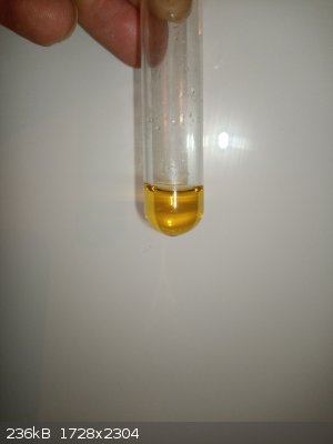

[*] posted on 5-1-2020 at 12:26

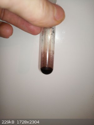

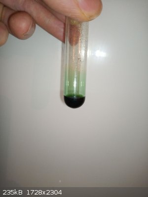

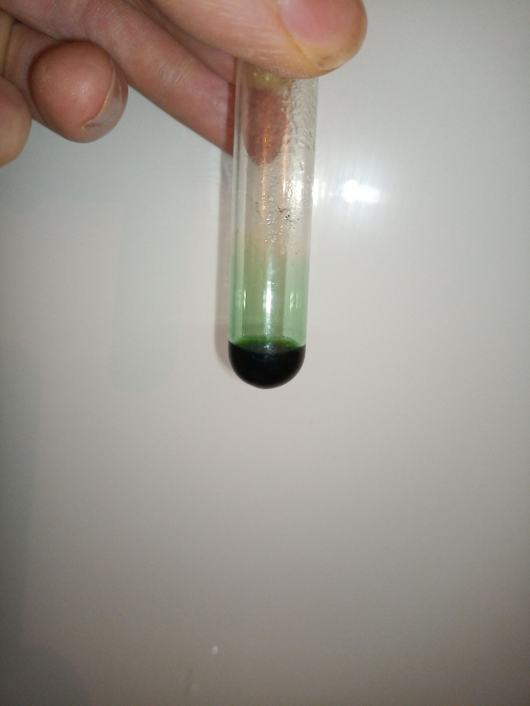

[0]
0,633 g 48% HBr + 0,020 g CoO very dark, thin layer on glass wall of test tube reveals green color, this should be [CoBr4]2- complex
IMG_20200105_183207_7_sm.jpg - 235kB
[1]

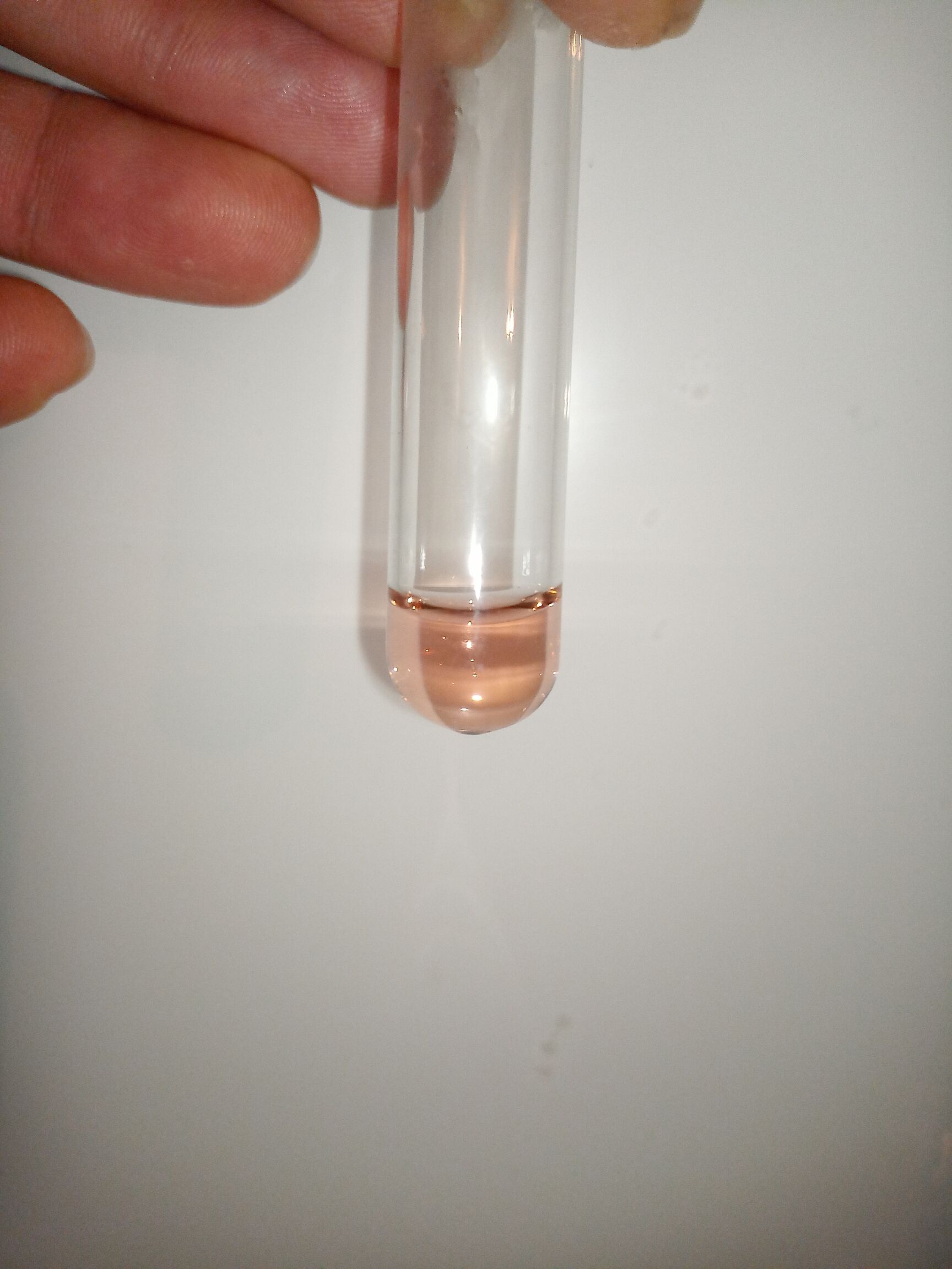

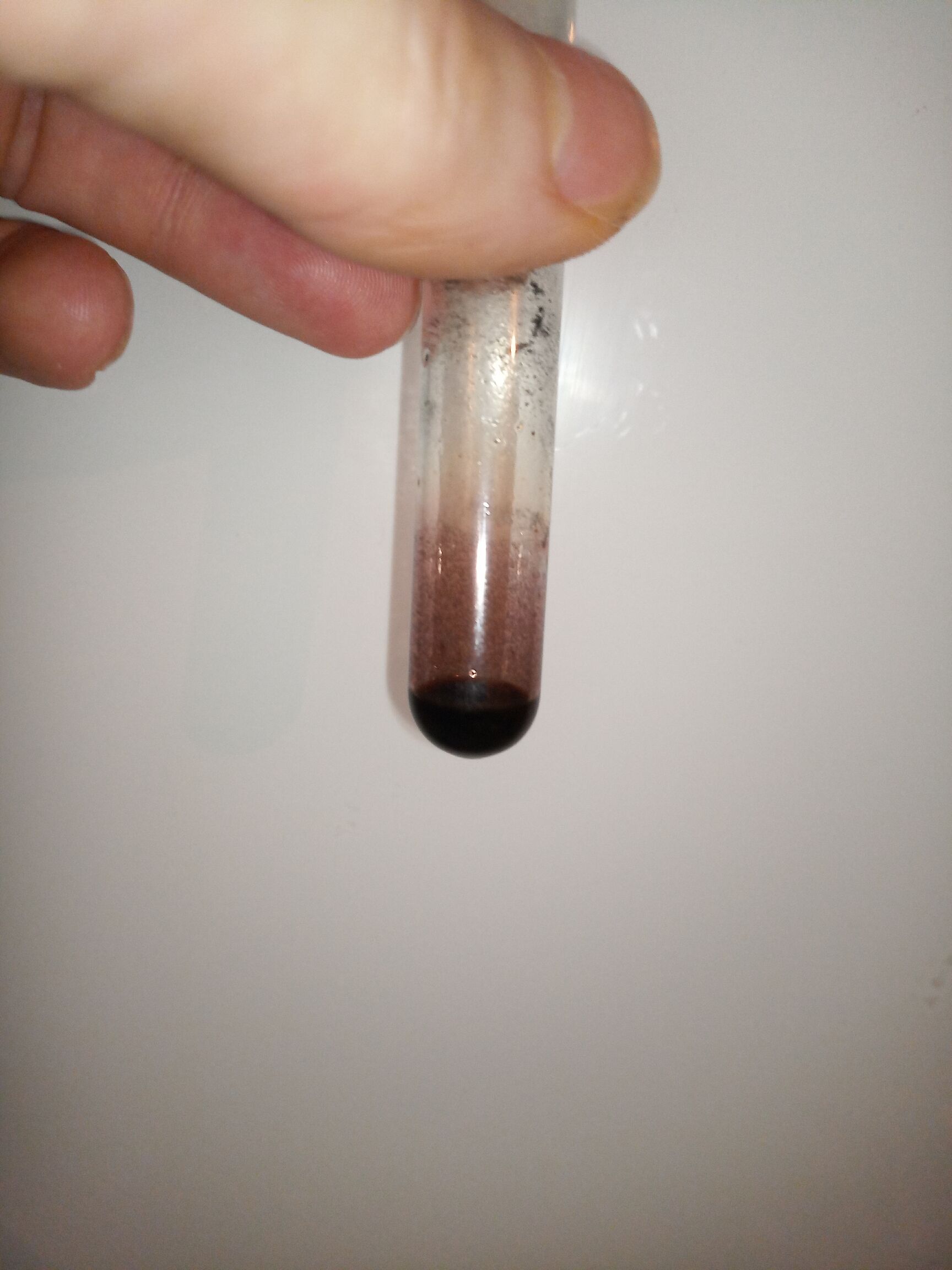

1 ml of H2O + 3 drops of the dark green solution [0] (dilution by approx 10 times)
IMG_20200105_183920_5_sm.jpg - 236kB
[2]
boiling the [1] for a short time, a little of Br2 vapor formed above the solution and I had to blow it away, I did not use freshly distilled HBr for preparation of [0] so it was slightly contaminated with Br2... maybe boiling expelled also some HBr???
IMG_20200105_185818_3_sm.jpg - 236kB
[3]

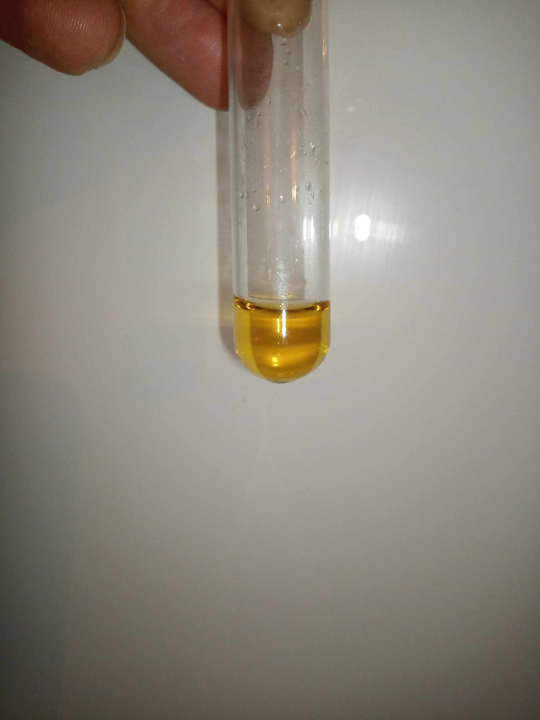

the dark green solution [0] after adding excess of CoO and boiling for a short time
IMG_20200105_190026_6_sm.jpg - 229kB
