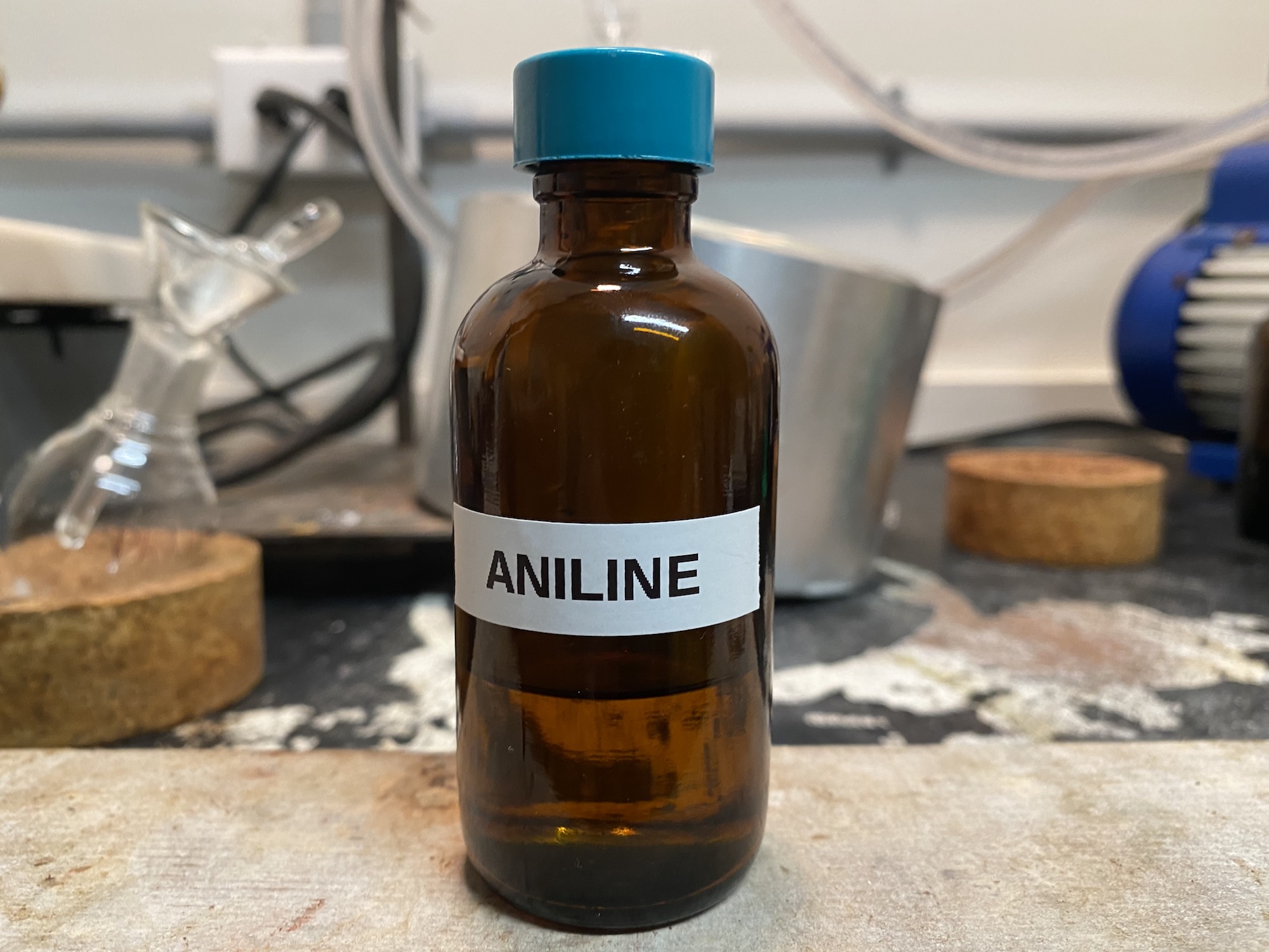

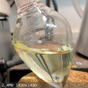

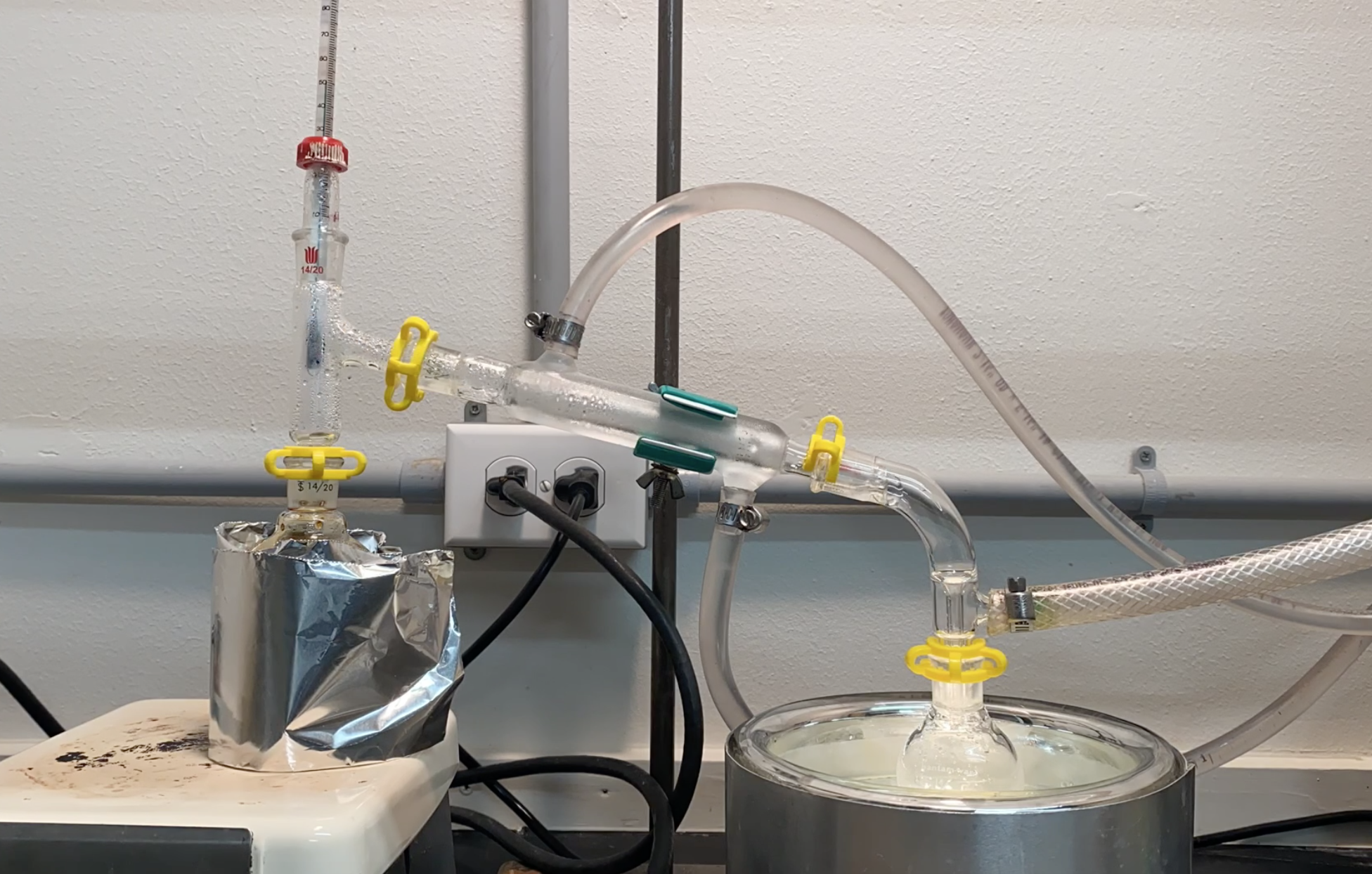

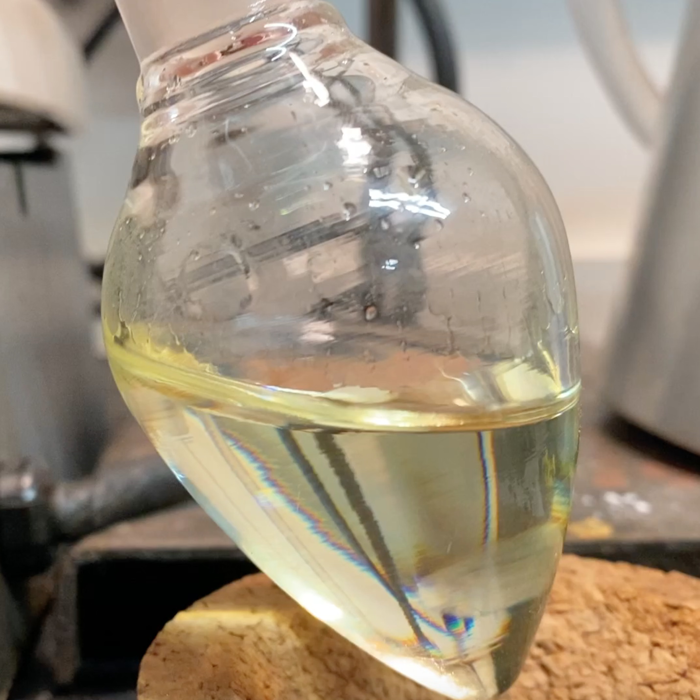

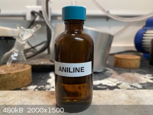

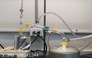

I successfully distilled some old, dark red, commercial aniline under reduced pressure.
The full write up is on my blog here.
I also posted a quick time-lapse video of the distillation to YouTube, which can be viewed here!
Screen Shot 2020-06-03 at 12.40.18 PM.png - 3.3MB Screen Shot 2020-06-03 at 12.47.38 PM.png - 2.4MB IMG_8362.jpg - 480kB
Putting pretty liquids in little brown bottles is always so satisfying.

Hi Texium, I read you blog where you described a problem with bumping. In vacuum distillation there is a big temperature gradient between bottom layers and surface of the liquid in the distillation flask (bottom heated, surface cooled by evaporation). When these layers mix accidentally it causes bumping. To prevent that, it is necessary to insert a capillary which introduces steady stream of tiny bubbles into the bottom which mixes the flask content, or using magnetic stirring also prevents bumping. I see on your picture that you distillation flask is not in the center of the heating plate so assume I correctly that you didn't use magnetic stirring (otherwise you would place it into the center) ? Boiling stones do not work in vacuum sufficiently (you used them according your blog).
Posts: 4745
[*] posted on 3-6-2020 at 15:10
Yes, it’s true that I did not use stirring, and that I should have. The reason that I didn’t use stirring was because I didn’t want to ruin any of my PTFE stir bars by permanently staining them with the polyaniline gunk. I don’t have many stir bars right now and most of them are very nice. If I had a pack of small cheap ones on hand I would have definitely used one.
