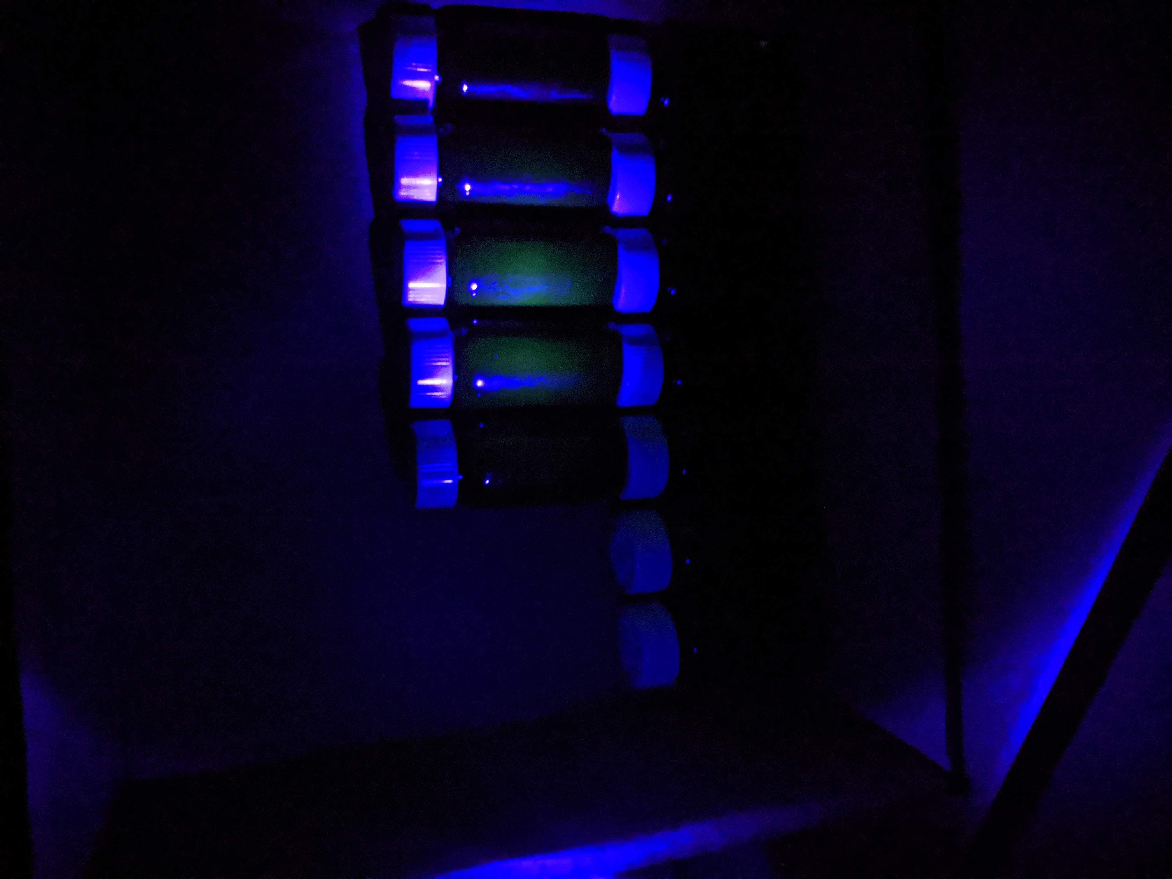

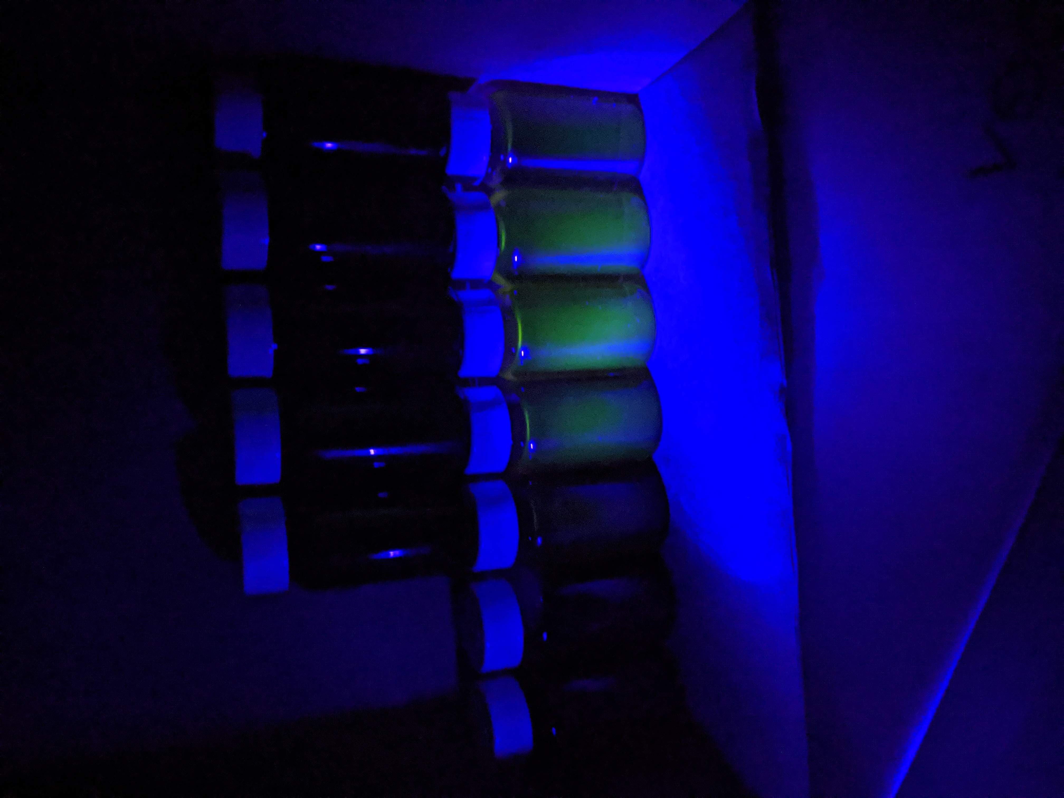

Today I managed to make green carbon quantum dots by dissolving 3g of sucrose in 10ml of water and 1ml of 30% HCl was added to make it acidic. It was then heated at 80-90C for 10 minutes and the water was allowed to evaporate. After 5 mins the solution turned yellow and it got steadily darker. After the 10 mins a distinctly sweet our could be smelt.
It was take off the heat and allowed to cool. The remaining black solution was dissolved in 150ml of water and then filtered, a dark filtrate was collected. This was made neutral by addition of NaOH. These are quantum dots but to see them clearly i diluted them. In the pictures the range on the lower level is 2 fully concentrated then 5 vials going from 25% to 5% in 5% increments. Feel free to ask any questions. The glow is poor as the light is a cheap UV invisible ink pen, I will do better pictures on request.

More pictures
IMG_20200617_225748.jpg - 330kB IMG_20200617_225753.jpg - 402kB IMG_20200617_225820.jpg - 2MB
