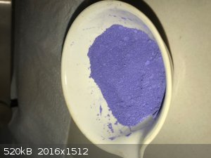

Part 2.
The next step following from the above was to add sodium to the reaction to see if I get a purple compound. I did quite a few trial runs with various
results. Eventually the below ratios and method gave consistantly a similarly looking product.
The first step was to make sodium cyanurate in solution:
NaOH + C3N3H3O3 = C3H2N3NaO3 + H2O
- 16.5g of cuanuric acid was added to 450ml water, stir and heat.
- At boiling the solution just about cleared up, still slightly cloudy.
- Add 4g solid sodium hydroxide while stirring and keeping hot.
** These quantities was to allow for the cyanuric acid possible being a hydrate - if dehydrated, the acid is in excess. Important not to have the
sodium hydroxide in excess as this then yields unwanted copper hydroxide during the next part.
- As the NaOH is added the solution cleared up and again the very slight golden tinge was seen.
- After 20 minutes of stirring the solution turns white due to a suspension. I assume this is sodium cyanurate, whith low solubility in hot (bit not
near boiling) water?
- Stirring was continued for a total of one hour. pH was checked with my swimming pool test kit and found to be 8.
* This should have given some 15g of sodium cyanurate in solution (or rather suspension)
Next step was to add copper sulphate. But, I could not find a formula for copper-sodium-cyanurate (without the chloride) anywhere. The below equation
was one of a few that my app would allow, but the one which seems to best fit the amounts of reactants used and product yield:
2C3H2N3NaO3 + CuSO4 = Cu(C3N3NaO3)2 + H2SO4 + H2 ???
- 6g CuSO4.5H2O was added. The solution immediately turned purple. See photo. There seemed a bit of fizz for a few seconds but whether this was
hydrogen as per the formula I do not know. After 15 minutes stirring was stopped. A purple ppt settled, and the supernatant solution was very pale
blue. Another 2g of CuSO4.5H2O was added abd stirred for an hour, the supernatant solution was now more strongly blue indicating that copper sulphate
was now in excess. See photo.
- Vacuum filter. The filtrate was slightly blue, and the remainder purple.
- Wash a few times in the filter with room temperature water, until run-through is clear.
** The first time I tried to wash with boiling water, as I knew sodium cyanurate and cyanuric acid is much more soluble in boiling water. But the very
top layer of the purple compound turned green when in contact with the boiling water, plus the purple compound itself becomes soluble at boiling
point! See photo. I will investigate the formation of this green compound further.
- Dry the remainder on the steam bath for hours until the weight stabilised. See photo. The color slightly lightened as it dried.
- Final recovery was 15.1g of the fine dry light-purple powder. The color is a bit lighter than the better known copper-sodium-dichloroisocyanurate.
See photo of the 3 products together: the (suspected) copper cyanurate, the copper-sodium-cyanurate, and the copper-sodium-dichlorocyanurate.
So I got the purple color I was after, but a lot of assumptions and guessing what is actually going on. Please comment and correct as required! Links
to relevant literature will also be appreciated as I found very little.

My understanding is that the purple is a complex involving the NaDCCA salt. This indeed does form in swimming pools and is probably what is being
described.
I don't know anything about the copper cyanurate product you are after. But with the inclusion of HCl in your first procedure it is easy to imagine
you getting a mixture that includes a purple substance and appears grey as a consequence.

Nice looking product.
This isn't redox reaction, so there isn't any hydrogen formation.
[Edited on 20-6-2020 by Bedlasky]

Quote: Originally posted by j_sum1  | My understanding is that the purple is a complex involving the NaDCCA salt. This indeed does form in swimming pools and is probably what is being
described.
you getting a mixture that includes a purple substance and appears grey as a consequence. |
Hi J_sum1 I think I was not clear. In the first procedure there was only cyanuric acid and copper carbonate. HCl was only involved to crudely test the
old copper carbonate and give me some assurance it is indeed a carbonate prior to using it

Over the last week or so I reacted cyanuric acid with fine copper powder and finally got a lovely deep purple compound:
- 5.1g copper powder, 6g cyanuric acid, and 70ml water added to a small beaker (cyanuric acid in excess).
- Stirred with magnetic stirrer. Heated to near boiling once to dissolve the cyanuric acid and heat then switched off.
- Solution was initially copper colored due to the suspended copper powder
- After 24 hours still the same and I was just about to stop but then saw it was slightly less copper colored. Started to heat the beaker to around 50
degrees. Still some copper visible when stirring stopped.
- After 48 hours the copper color was much faded and it appeared to be heading to white-grey. Still copper present.
- After 72 hours it was starting to look purple. Mo more copper to be seen.
- Once it started to become purple the change was faster and after some 84 hours it was deep purple.
- After 96 hours the color was still the same deep purple and the stirring was stopped (4 days!)
- The solution was vacuum filtered. The filtrate was clear and the remainder a dark purple. The remainder was washed in the filter with excess water.
- A few gram of the remainder was dried on a steam bath to see if the color changed - it did not, and all was then dried on the steam bath.
- Final product was 10.6g of dark purple color.
The document I referenced and linked higher up "Cyanuric Acid and Cyanurates by GB Seifer" mentions only 2 salts for copper reacting on its own with
cyanuric acid: a trisubstituted salt Cu3C3N3O3.xH2O or a basic salt (CuOH)H2C3N3O3.2H2O; I do not know which one I ended up with but I am happy I
managed to get a purple copper cyanurate without any other metals included), which was the original target.
Below photos shows the color change from copper to dark purple and the final dried product.
