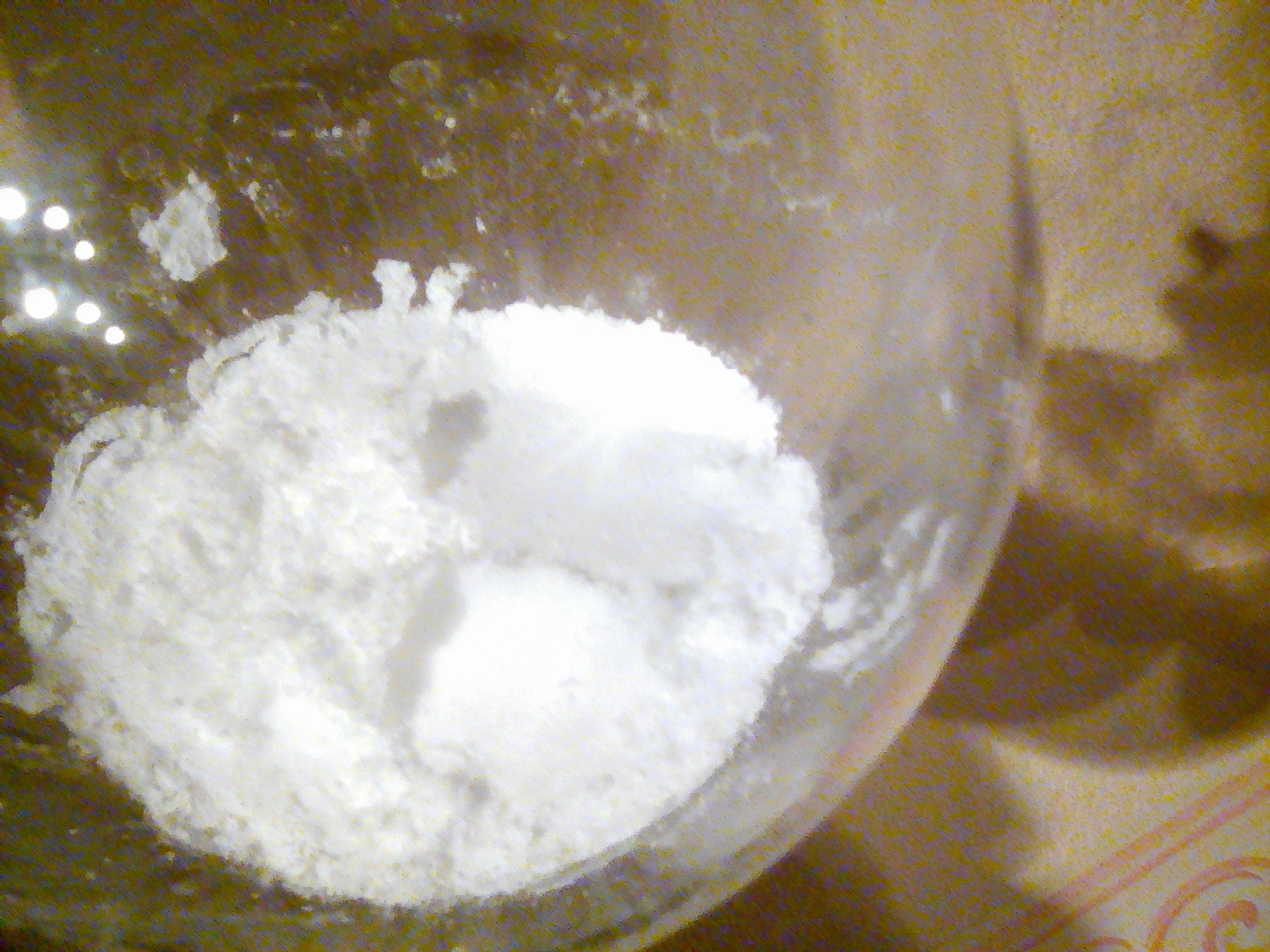

I totally relate to this! Took me 3 days of refluxing 5-7 hours a day to make like 100 grams of isopropoxide. It was just as laughably slow as you describe. Me with a flask of sodium, adding a mL and waiting with stirring, then adding another mL, and adding heat, and thinking it was going to take off anything second. Then 3 days later finding out that my flask is etched.
[Edited on 7/1/2020 by BromicAcid]
I know, right!
I wish I had that much sodium to turn into superbases :P
I suppose your flask is etched because hot sodium alkoxides dissolve glass similarly to NaOH?
Quite a few of my flasks are etched yet I can recall no reactions involving NaOH, HF, or H3PO4; its very curious.
The isopropoxide seems to have a lot of volume; I should only have 3g but it looks more like 30g
I don't think its fully dry, but I can't imagine traces of alcohol being an issue; Still, I'll probably end up trying to dry it further
Here's a pic, sorry about the low resolution
IMG_20200702_001559.jpg - 926kB
[Edited on 2-7-2020 by SplendidAcylation]
